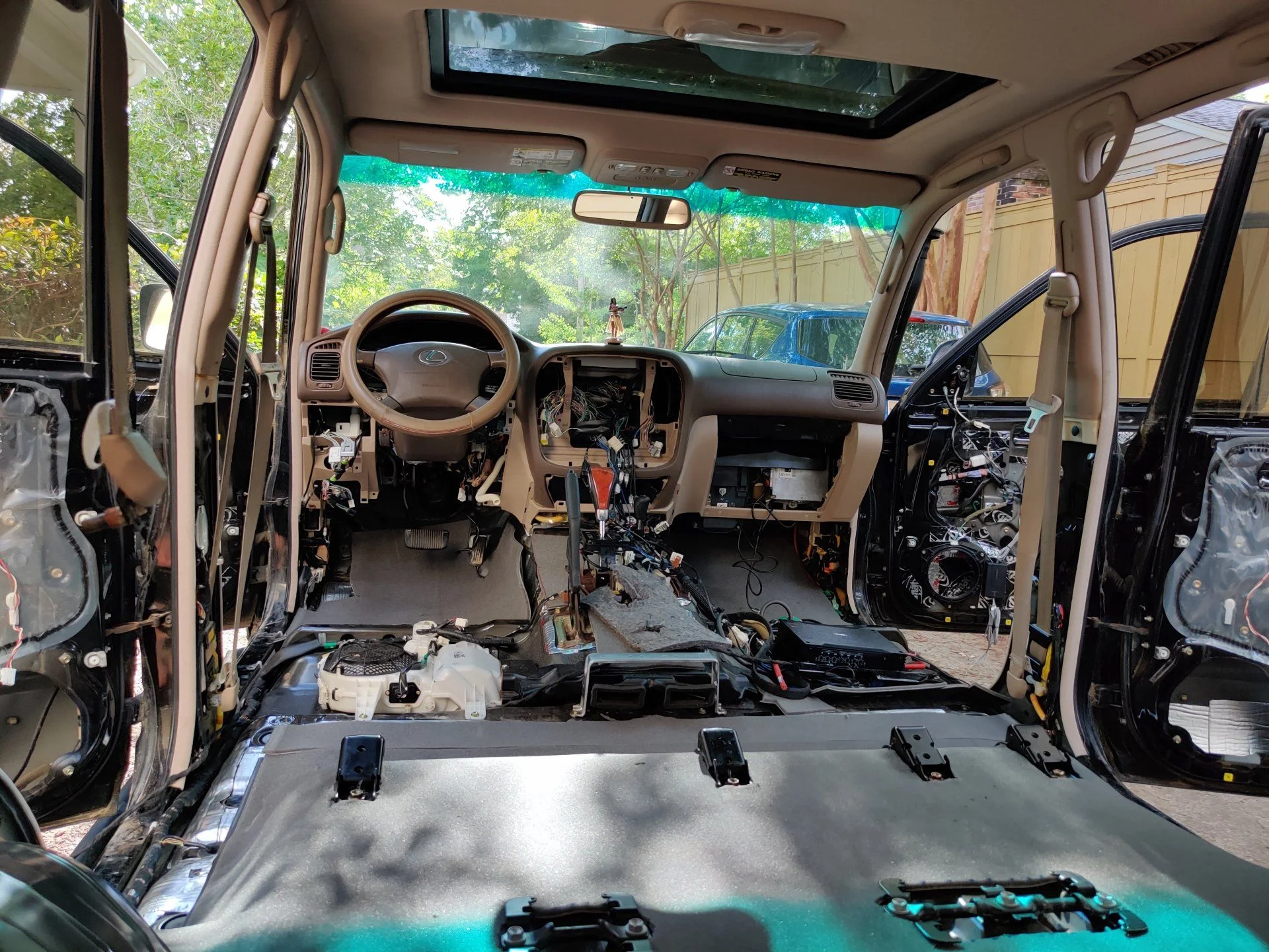

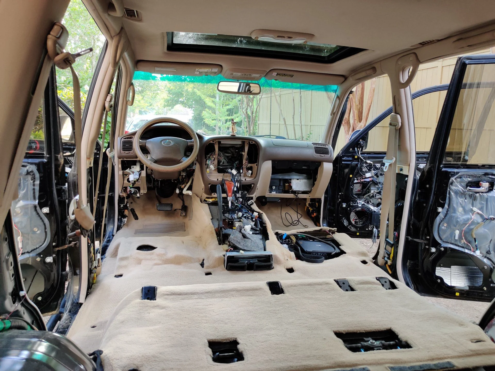

This current project has dragged on for weeks. Spent lots of time gutting, cleaning, removing useless wiring, running new wires for speakers, fabbing an amp mount, removing rust/painting parts, cleaning carpets, and applying sound dampening. Really got kind of boring, and everytime I looked at the car, it felt like I would never complete this one.
So today was a great day. Finished up the sound deadener and composite up front and got the carpets in. What. A. Difference.
I went with B-Quiet for the materials. Price was right, and I love that they're upfront about their acoustic specs. Took way too much research to find Dynamat's specs. If you're telling me you're the best, but hide the proof, I'm not about it. Heck, turns out this stuff's specs are comparable to or even better than Dynamat at certain temps. So no brainer. Did the Ultimate and covered it with VComp.

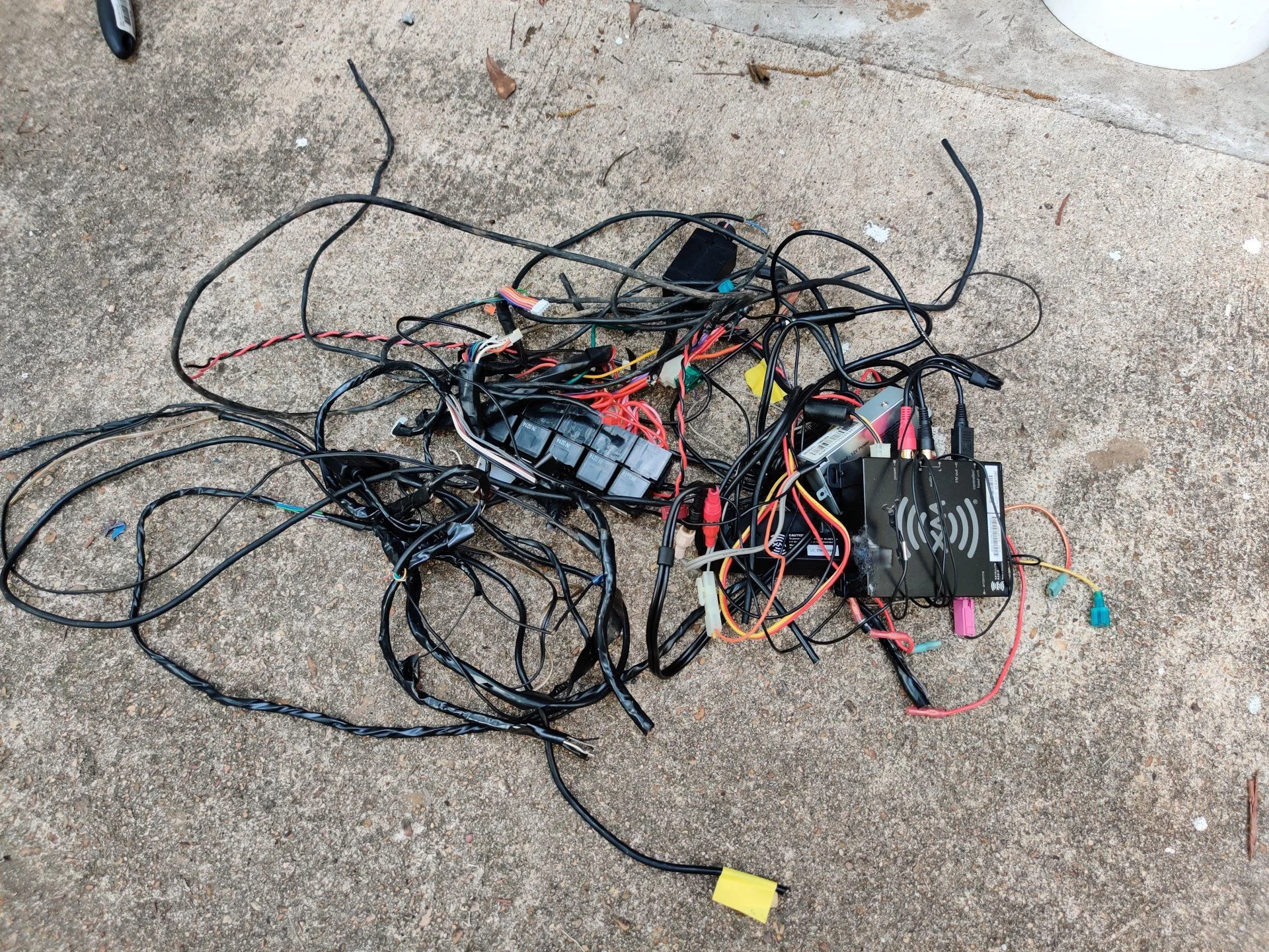

And may I present what appears to be wiring for a Viper alarm system, a hardwired radar detector (that the PO kept the good parts of), Sirius XM w/ FM transmitter, and who know what else.

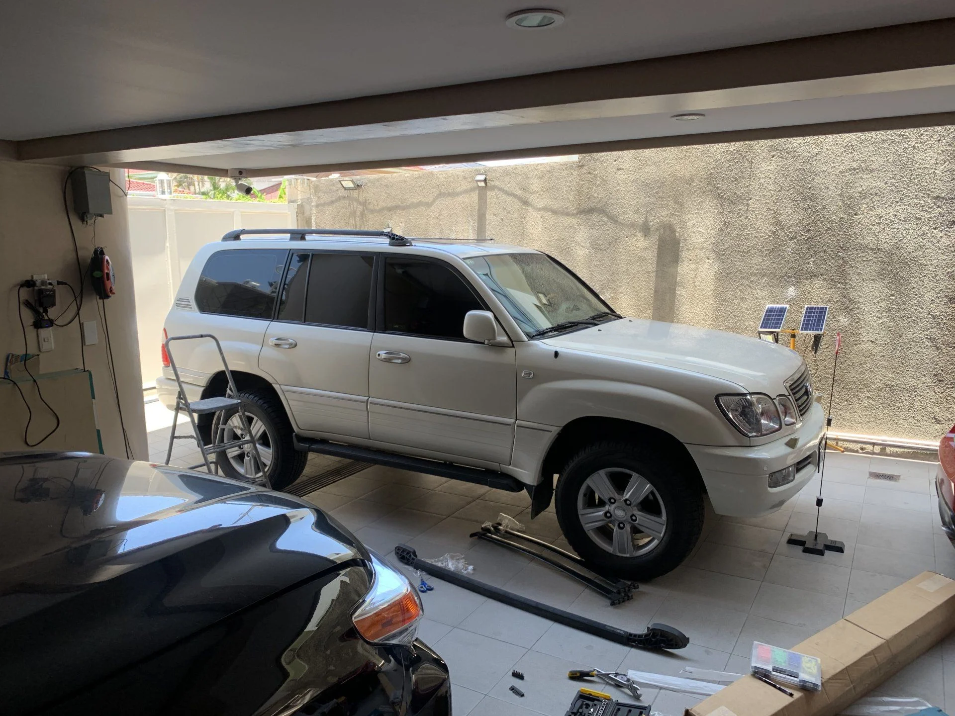

A little late to the party but over the last weekend I completed installing my Ironman 2" lift kit.
IM TB
IM Shocks
IM Springs
Control Arm Reinforcement Brackets
New OEM Tie Rod Ends
Lower Ball Joints
Trail Tailor Extended Sway Bar Links
Trail Tailor Diff Drop
Alignment

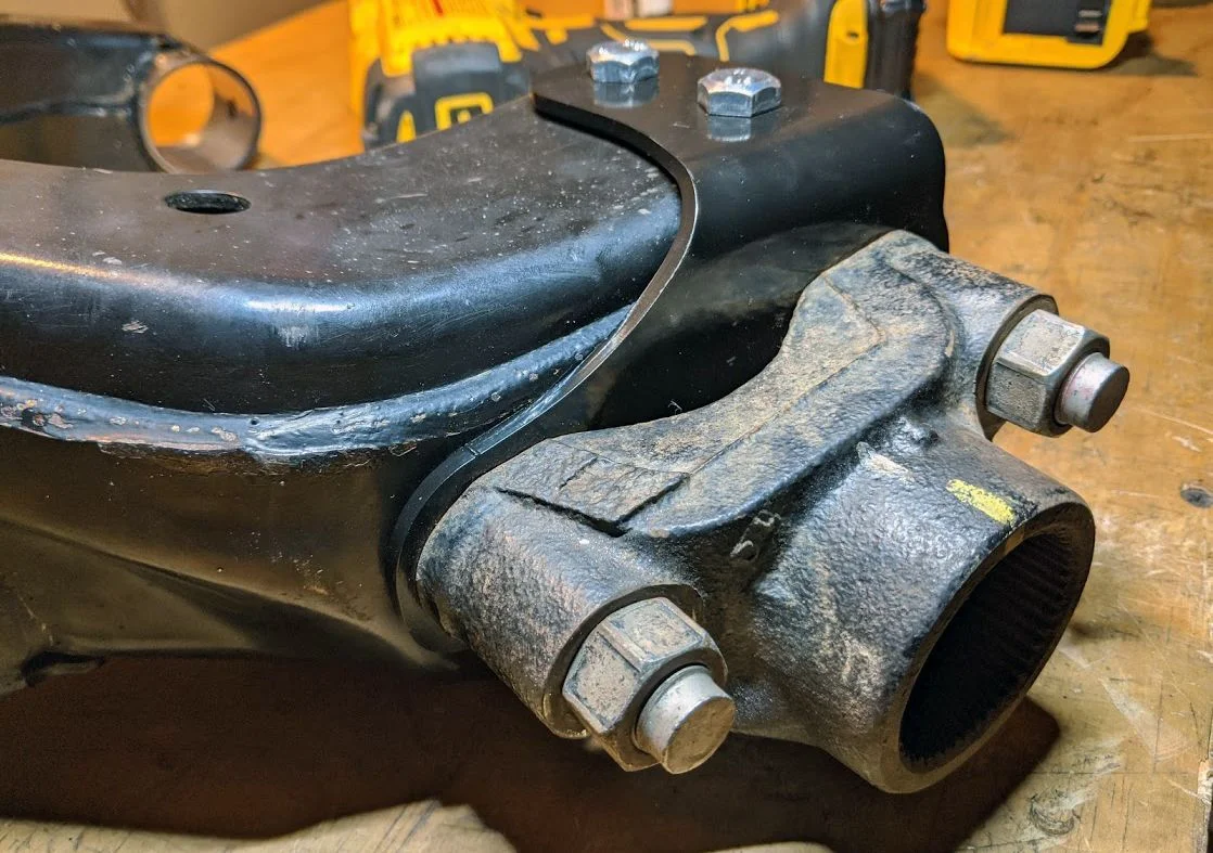

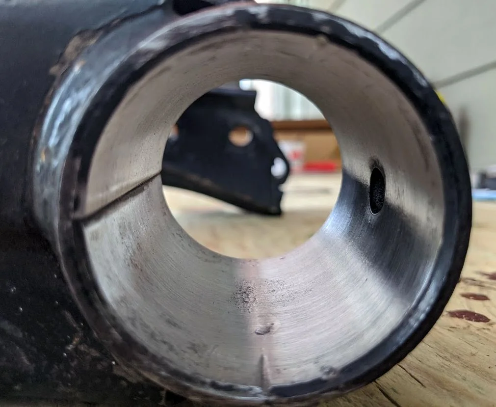

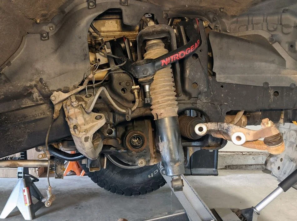

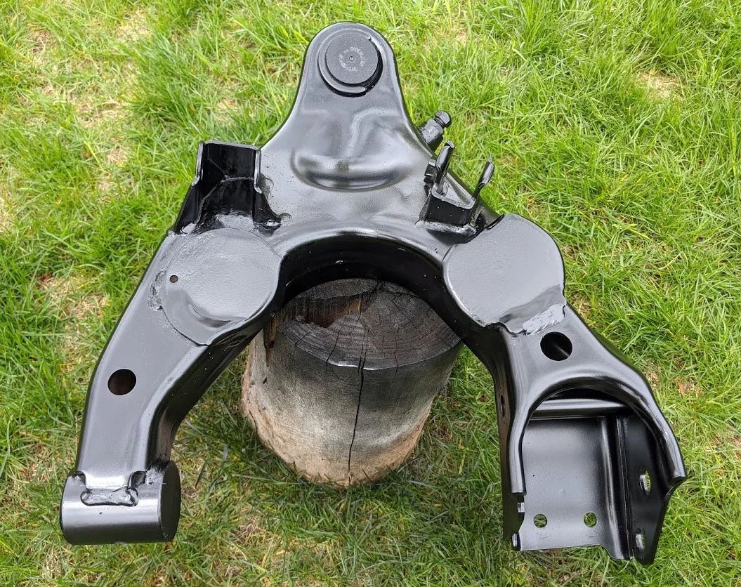

This will definitely be a multi-day project. The old axle is out, which wasn't hard at all. I did have to rotate my tires to get the c-clip to let go first. A 3lb mini-sledge and big brass drift made it easy.
Lower control arm is off, old bushings are out of the frame and LCA. I've wire wheeled off the rust and painted it. Tomorrow I'll install the poly bushings, reinstall the LCA, then install the new axle, gasket and flange and put everything else back together.
While the LCA was off, I drilled the holes for the tbar reinforcement bracket too, then took it off so I could paint it.

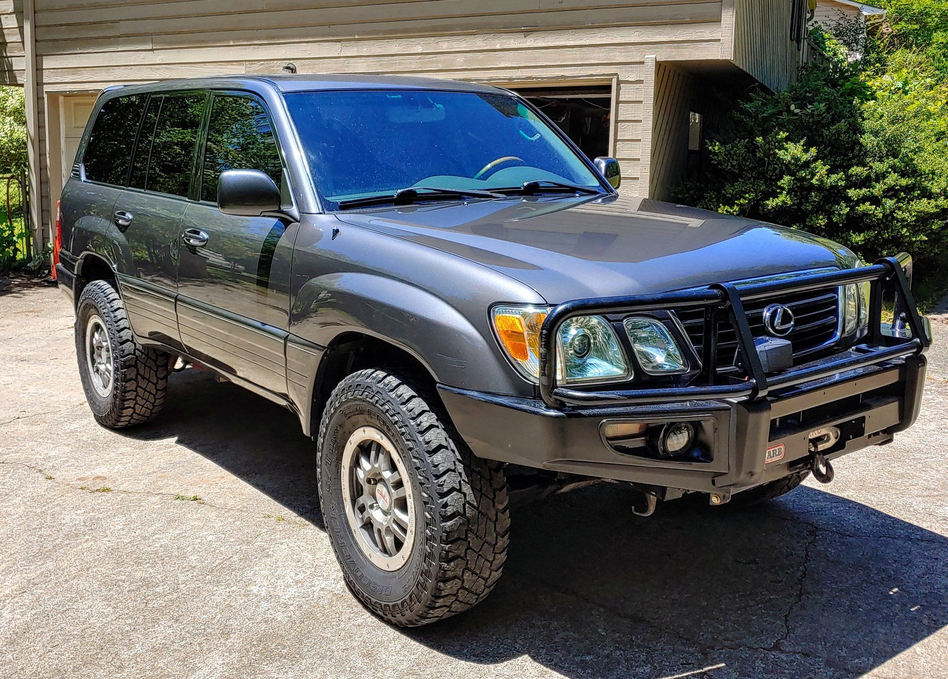

Man your LX looks amazing. I desperately need to have a good detail done lol.

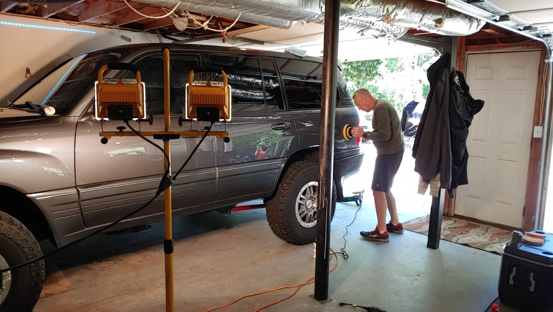

Also had my buddy @JT4runner over on Saturday for a paint correction. A recent trip to the mountains yielded me a ton of new cosmetic character. It's cool to an extent, but I'm not into a rough looking daily driver if I can help it. Did some Alabama pinstripe removal, wet sanding, glass polish, and finished with 2 coats of ceramic coating. She turned out beautifully!

I'm not sure if you mean you're replacing the differential seal along with your new axle, when you say gasket, but if not I would definitely recommend it. It's pretty easy to replace WYIT, and a super bummer if you have to pull your axle again due to it leaking.
I agree with you, but it appears to be in excellent condition with no signs of degradation, so I'm going to leave it where it is. I plan to lock this pig in the next year or two and if it's leaking then, I'll have Slee replace it while they are in there.

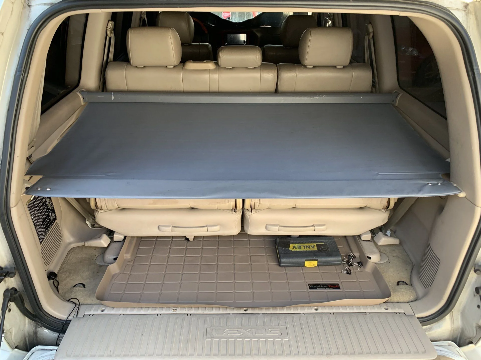

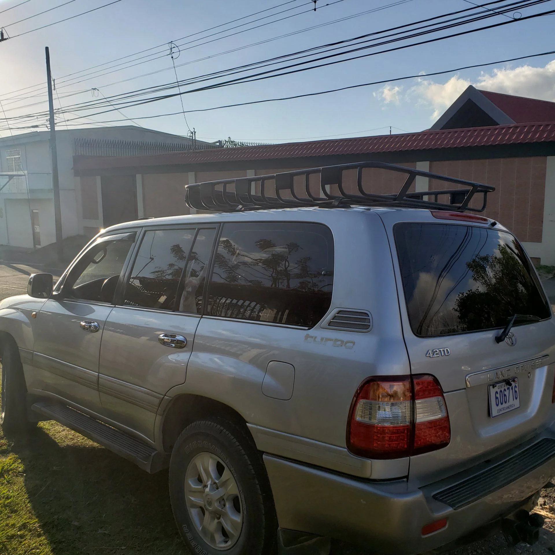

Installed the factory USDM roof rack. It’s nice to finally be able to grab onto something when washing/waxing the roof. Also installed the cargo cover. It’s grey and doesn’t match but I can live with it. Thanks @DrDenge for the flawless transaction
