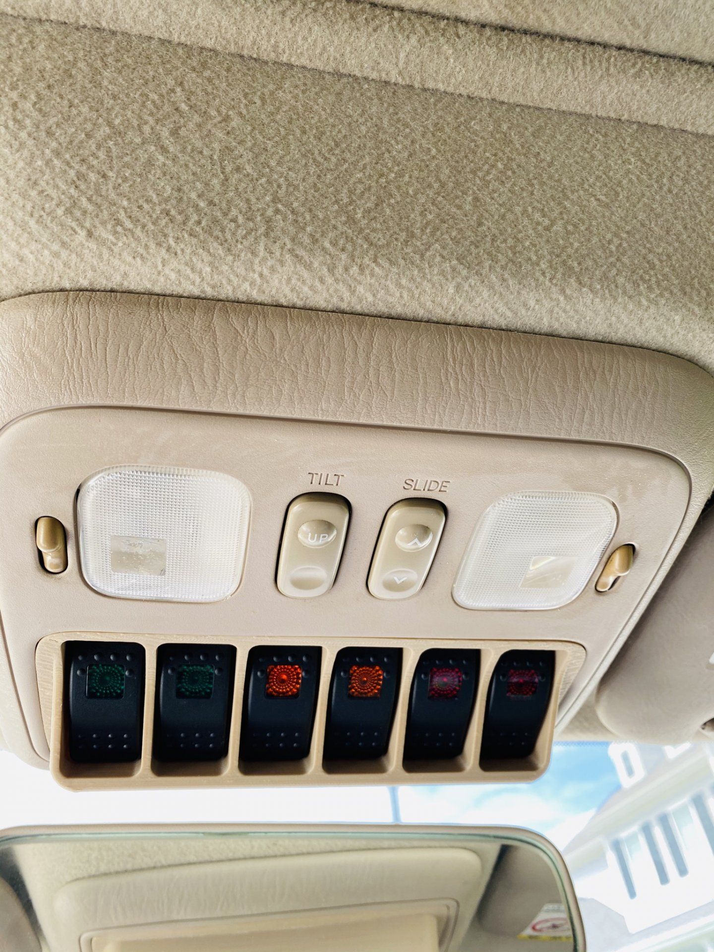

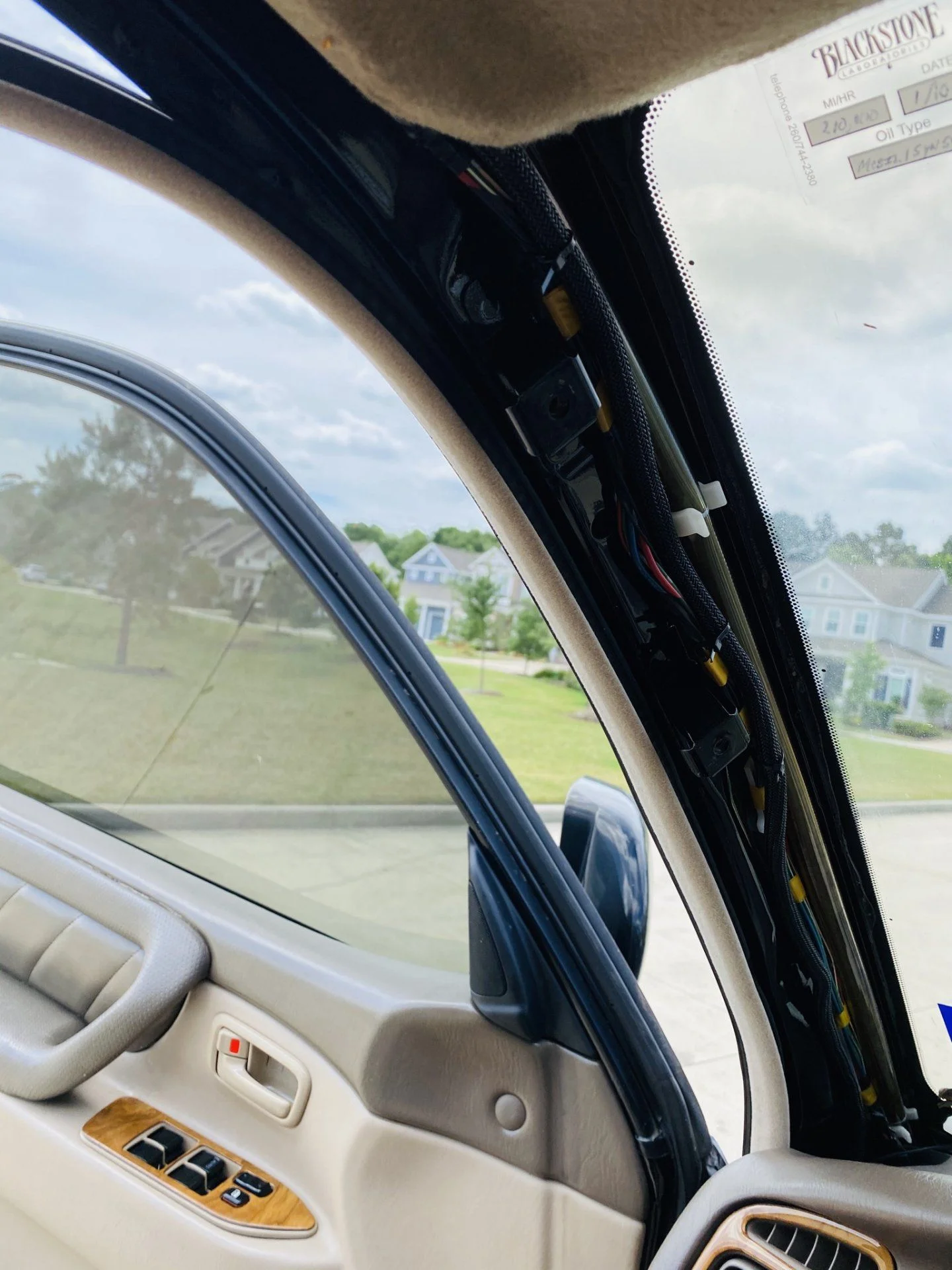

Installed my new six panel switch from @BenCC
Next will be hooking everything up to my SPOD

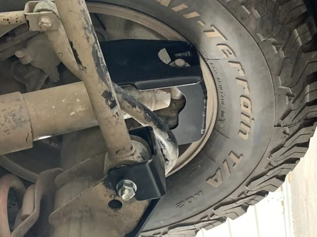

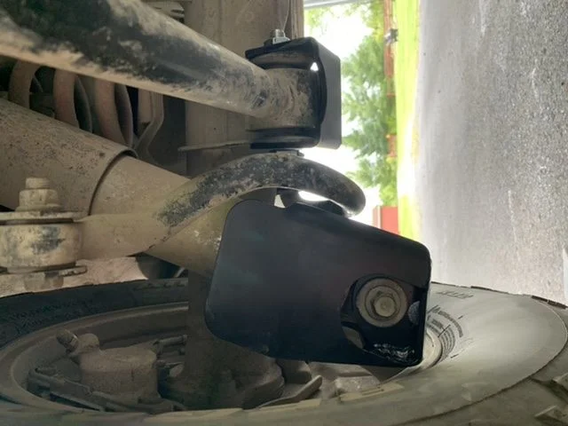

Based on @dogdaysindurham post earlier I remembered I had a few @TRAIL TAILOR parts that still needed installed.
Got the rear LCA skids and shock guards installed. View attachment 2309737View attachment 2309738
I am confused by your rear lower control arm skids. You sure you installed them in the right place? I think they are meant to attach to the frame brackets, not the axle brackets. Surprised that even fit.

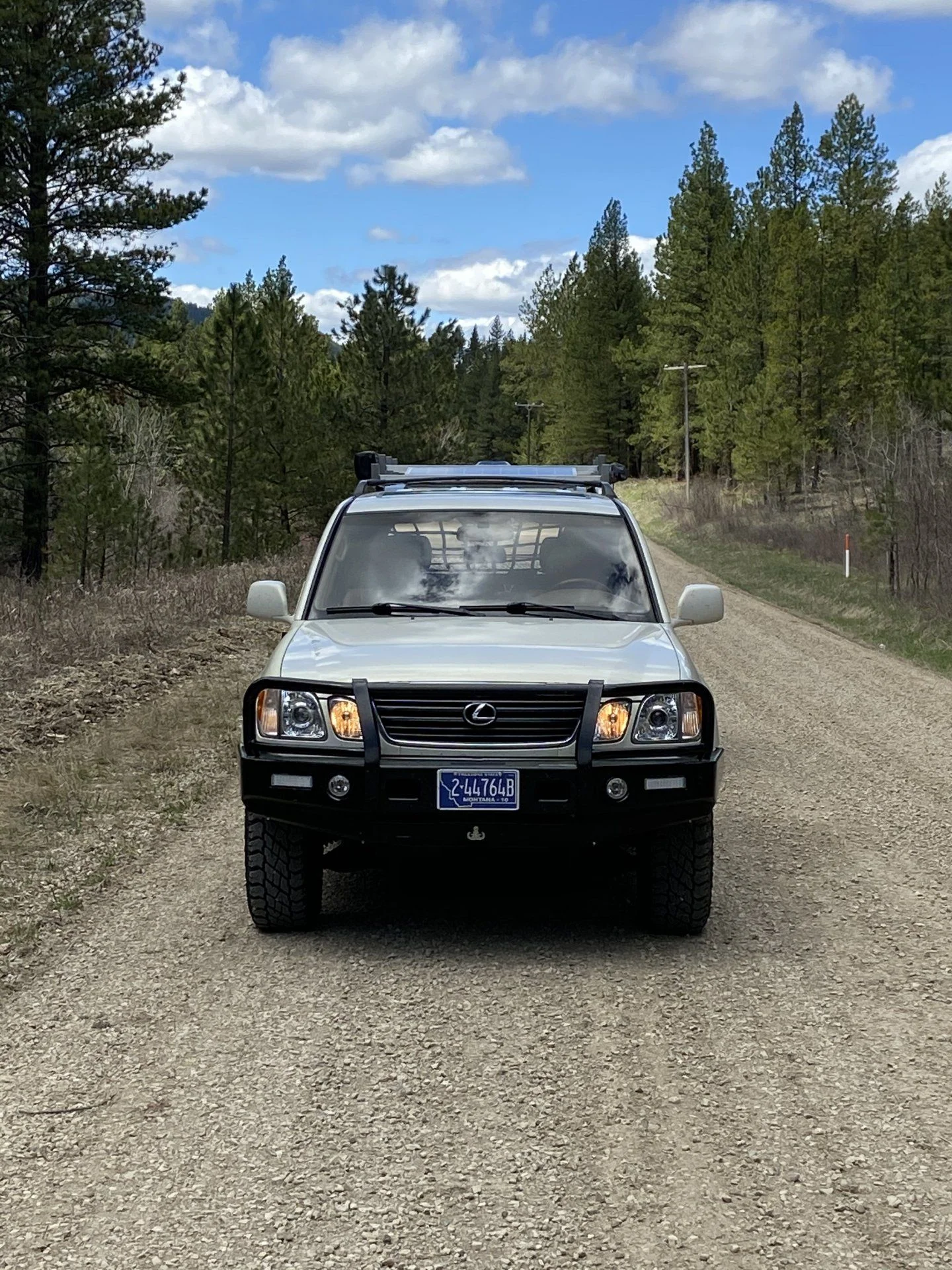

@Bigsky80 what area/park in Montana is this? Beautiful.
It's National Forest in the Little Belt Mountains. Tons of trails and free camping:cool:. Only downside it the area tends to be a bit busy with ATV's and dirt bikes.

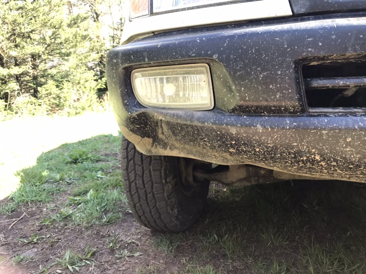

Took the family camping off grid in GW National Forest.
Did some trails there and explored the limits of the factory bumper approach angle. View attachment 2309907
And camped two nights—nice not to worry how loud the kids were being, which is a concern in campgrounds with other humans around....
On the interstate headed home: bang! Whap whap whap—initially thought we’d hit something in the road and gotten a flat. Pulled over and spent some time jacking up wheels, turning them, checking driveshafts etc. noise went away after driving (slowly) a total of about a mile to a gas station parking lot to diagnose. Drove around a quiet neighborhood—yup, still gone.
Got back on the highway and hit the brakes to allow folks to merge, only to have my wife ask way that noise was. I thought it was a car ahead of us accelerating but it turned out we had a vibration (like a very quiet jake brake) when braking or even in overrun, any time the wheels weren’t actively pulling the truck forward.
We limped home, staying off the interstate, and now I’m losing my mind trying to figure out what the bang was and what the vibration is, and whether they’re related....
The sound on overrun reminds me of my Volvo when I failed to properly torque a new tie rod end and it got progressively looser, so I’ve been thinking steering related stuff might be to blame.
I have checked rack (some movement in the bushings but nothing crazy and no clunk), ball joints, inner and outer tie rod ends, wheel bearings, axle shaft half snap rings—nothing seems obviously loose, although there’s definitely some play in the rack but I confirmed by pulling back the boot and asking my long suffering wife tomove the wheel that it’s not the inner TRE, as I’d suspected.
Any thoughts??? Arrrgh.
I'd pull the front drive shaft and the hub flanges to see if it eliminates the vibration. Both cv axles or the front drive shaft could have been impacted during the fun time proceedings.

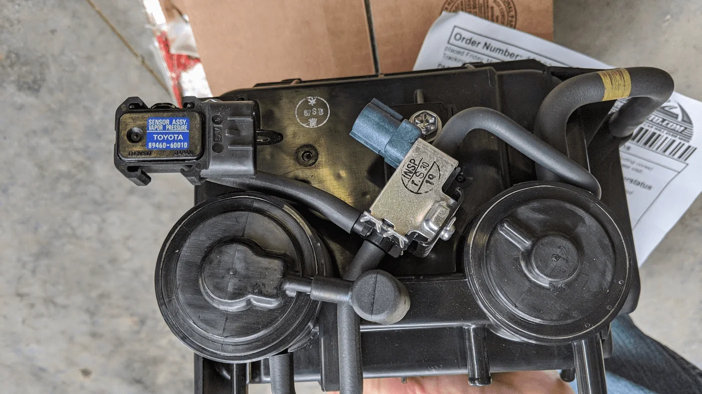

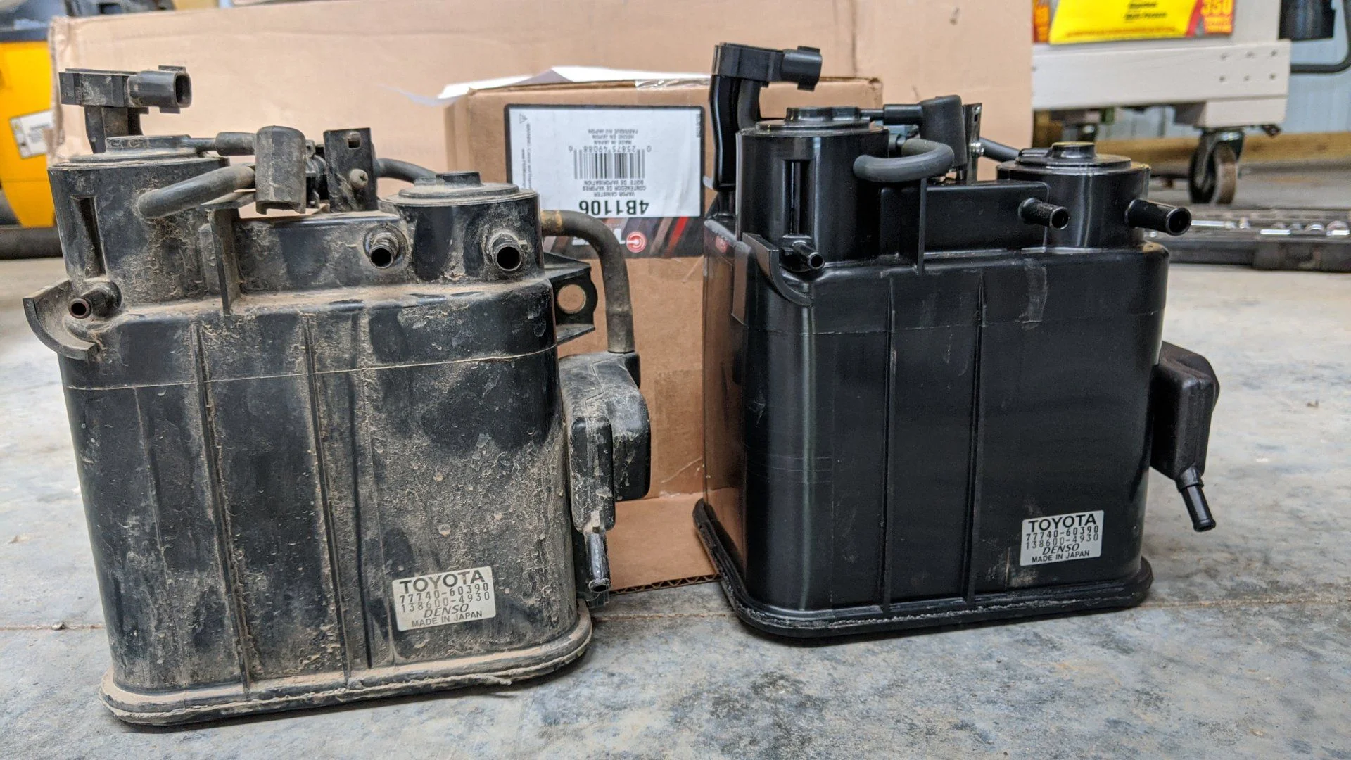

Since I have always had excessive fuel vapor and pressure with the 100, I decided to replace the Charcoal Canister. I opted for the the cheapest option RockAuto had since it was the cheapest option I could find anywhere. What I received seemed like an OEM Denso replacement. It even has the Toyota sensor on top.
The old 334k mile canister was twice as heavy as the new one. I speculate the charcoal was saturated with gas.

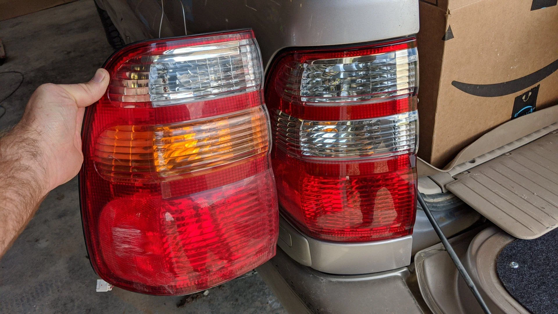

I also upgraded the tail lights. I picked up a like new set of later model tail lights from @Gdub216 last year and finally finished the install. I needed amber bulbs 90981-15011 and the harness 81555-60680. The tailgate lights were done a few weeks ago when I installed the Huracan storage lid. These are a huge improvement from my stock faded, cracked and scratched tail lights.

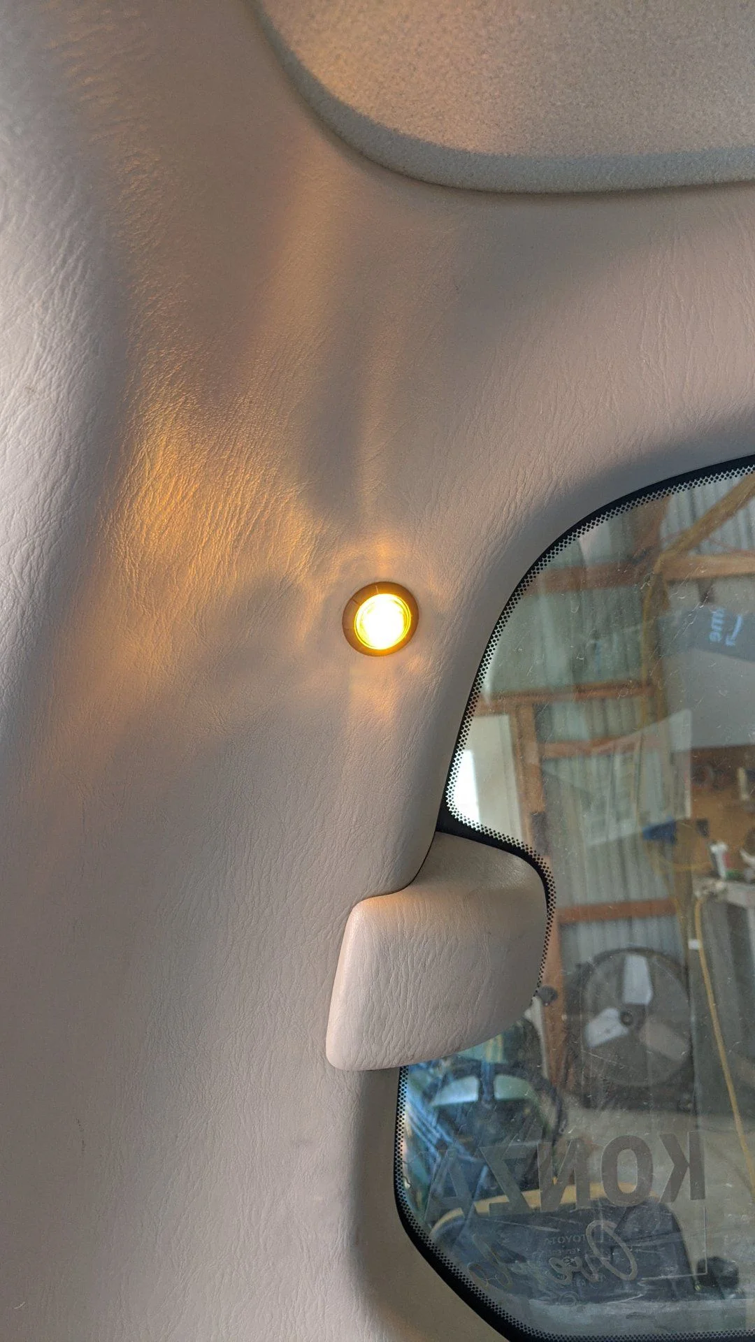

Lastly, I plugged the holes in the rear trim where the 3rd row seatbelts used to be. Used amber LED trailer clearance lights on a switch in the back. These put off a light glow which will be great for illuminating my cargo when camping without wrecking night vision.
Since I have always had excessive fuel vapors I decided to replace the Charcoal Canister. I opted for the the cheapest option RockAuto had. What I received seemed like an OEM Denso replacement. It even has the Toyota sensor on top.
I also completed the trail light upgrade. I picked up a like new set of later model tail lights from @Gdub216 last year and finally finished the install. I needed amber bulbs 90981-15011 and the harness 81555-60680. I did the tailgate lights a few weeks ago when I installed the Huracan storage lid. These are a huge improvement from my stock faded, cracked and scratched tail lights.

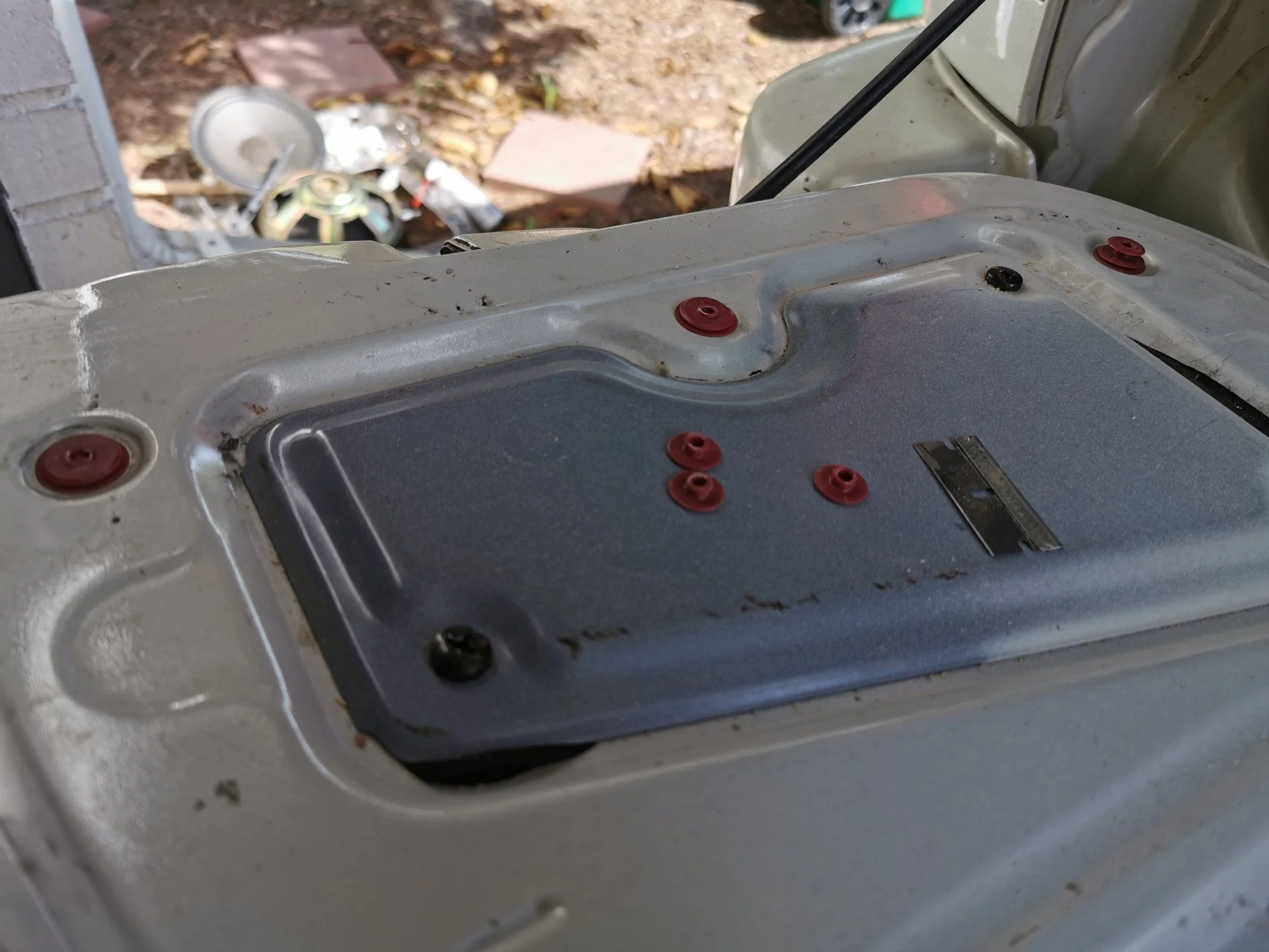

I also plugged the holes in the rear trim where the 3rd row seatbelts used to be. Used amber LED trailer clearance lights on a switch in the back. These put off a light glow which will be great for illuminating my cargo when camping without wrecking night vision.
Is that the WVE brand on Rockauto?
