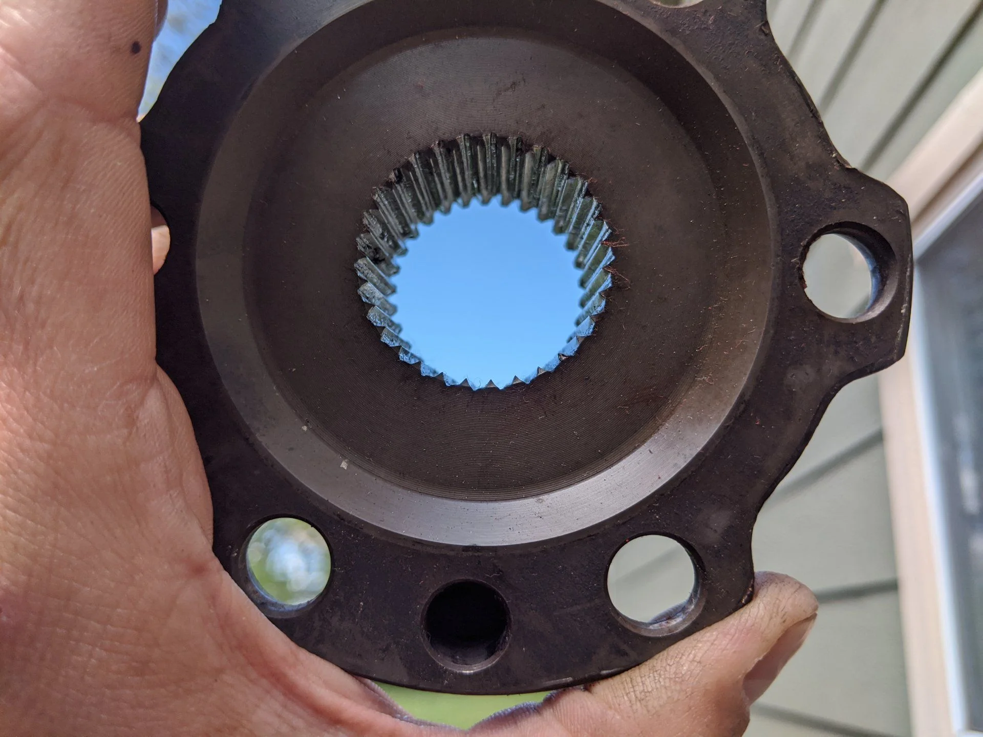

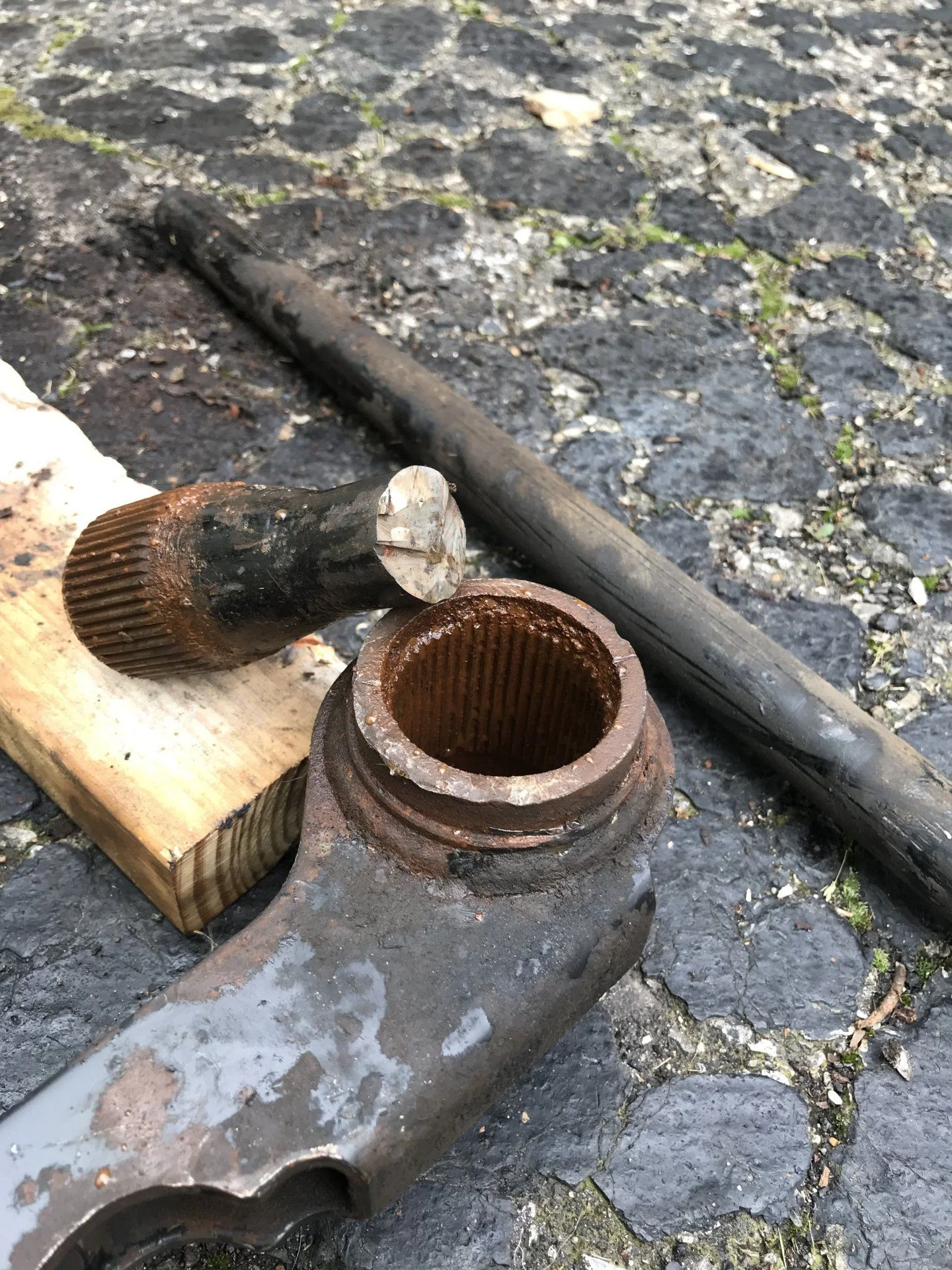

I'm also pretty sure I found the source of my drive line clunk.
New flange vs old flange. The splines on the old flange had been worn to a point!

50 pumps oh my, some will say you have a ticking time bomb... but the forum is split in opinion about this so you should be good.. i like to pump until i see new grease as well pumped 20 times when first got it, don't think it had ever been done.
Drove it straight after, warmed it up and put it through some tests. Everything normal , however, seems like it doesn't downshift a gear as easy as it used too. No feeling like jolting , really smooth. If grease can escape under the pressure of the grease gun, it makes no sense that it would stay in the shaft under heavy forces from driving.

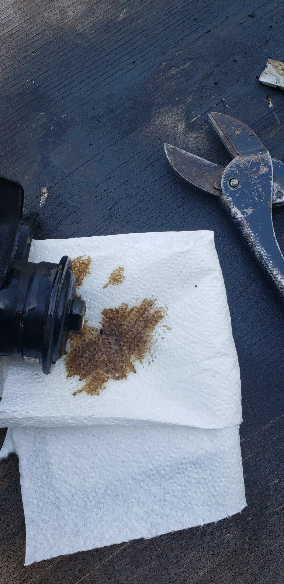

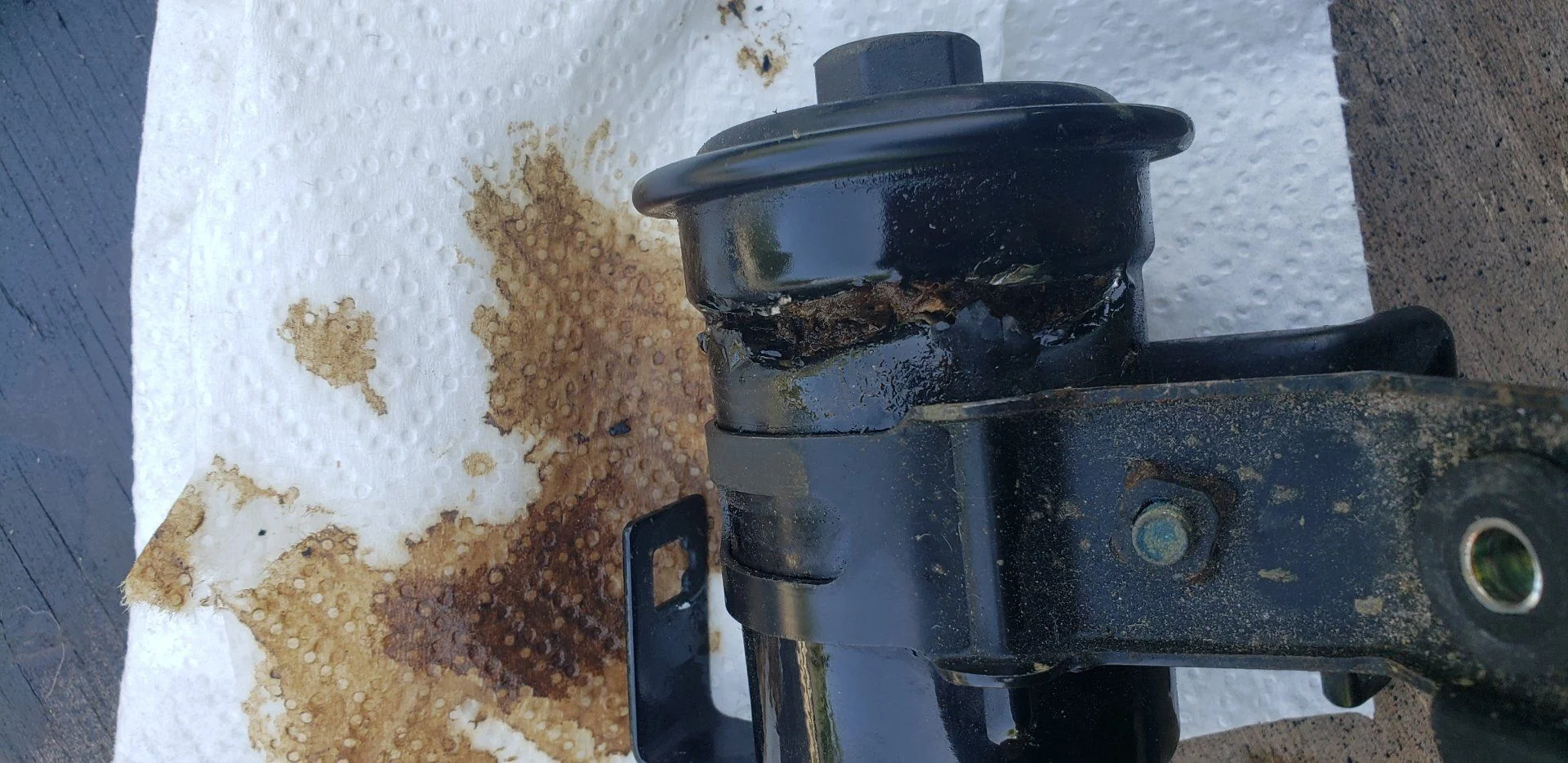

That is horrible and well overdue. Mines due for change as well, 2014 is the date on it. (cooper filter)
Mine has never been changed. 215K so far. Guess I'd better order one. Does Toyota even have a service interval for the fuel filter?

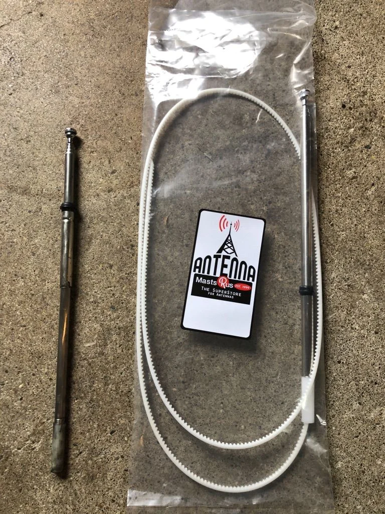

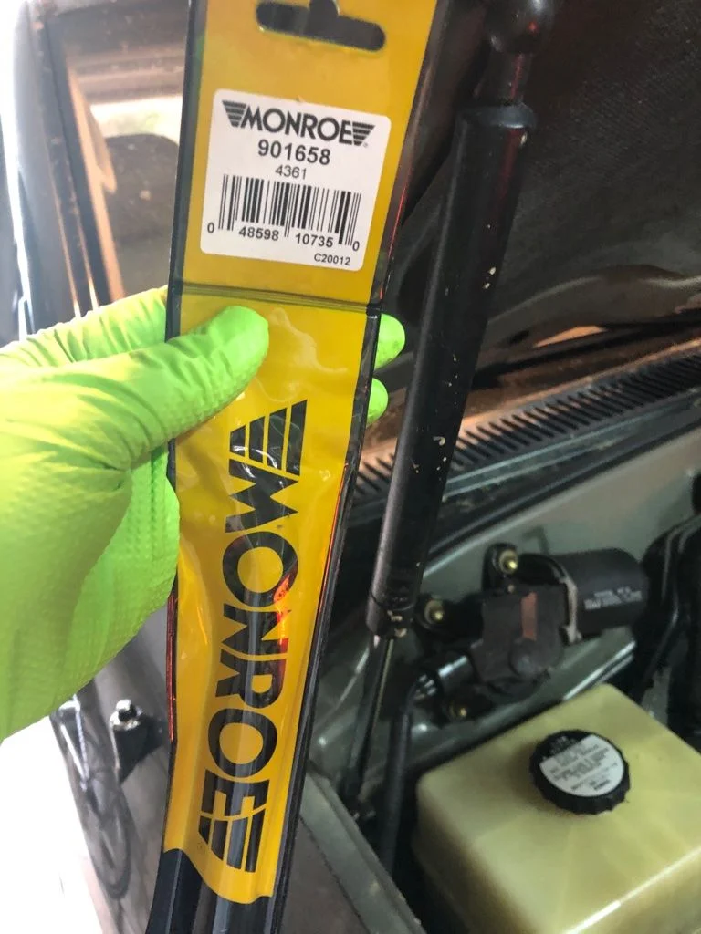

New hood struts, new key bodies, new antenna mast, and mounted my fire extinguisher this week.

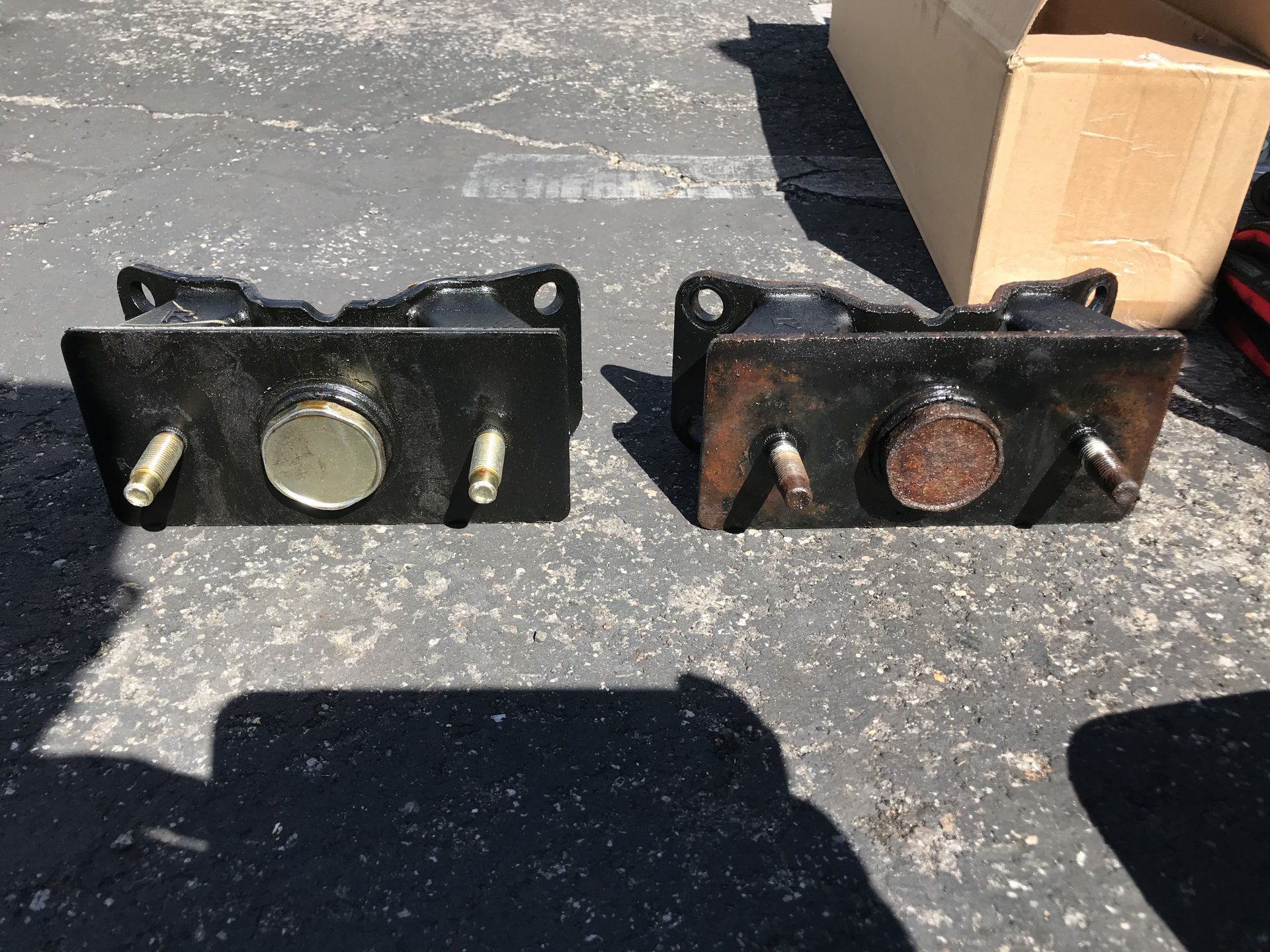

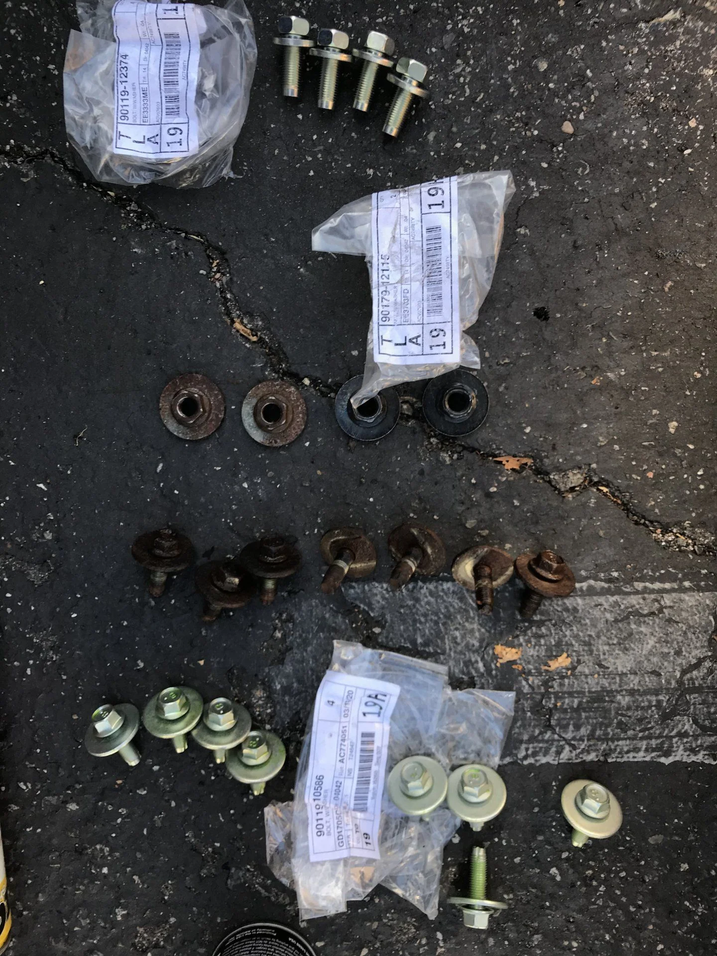

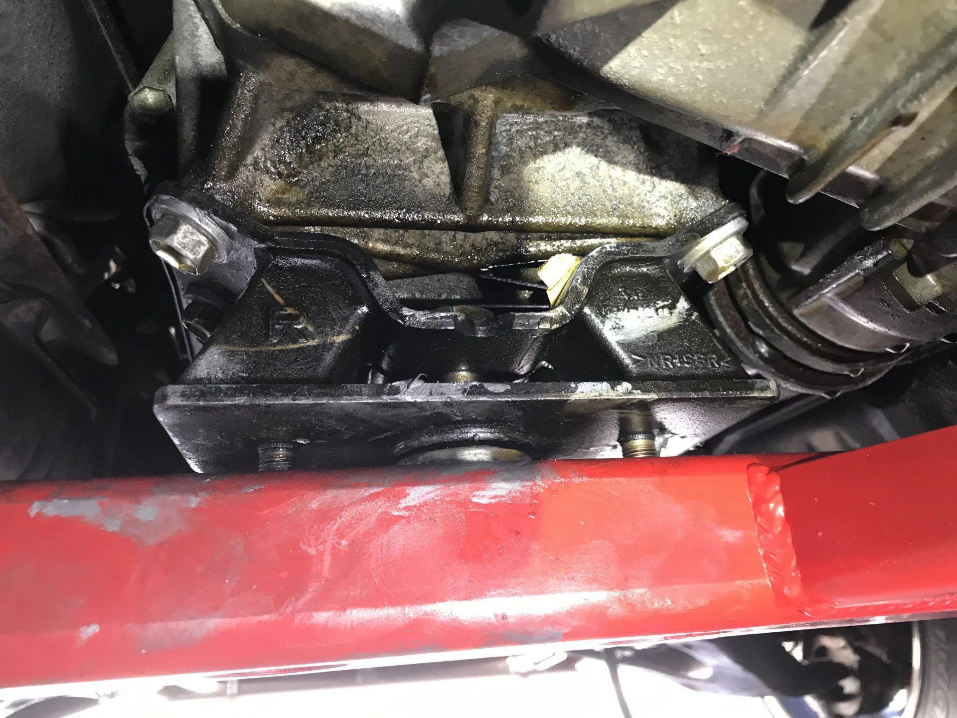

I had a chance to install a new transmission mount and @TRAIL TAILOR creeper skid and rear shock skids. It was super satisfying replacing all the rusted hardware with fresh OEM pieces. Torque specifications: 37 ft-lbs for the cross member to frame bolts, 43 ft-lbs for the transmission mount bolts, and 54 ft-lbs for the crossmember to transmission mount bolts. I used a 14 mm 6 pt socket for the bolts on the cross member and for transmission mount, and a deep 17 mm for the 6 pt for the nuts on the cross member to transmission mount.

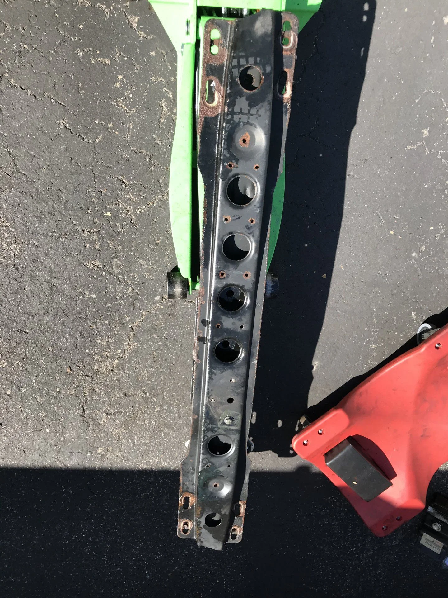

Cross member was pretty rusty. Looks way worse on the side, flaking layers.
Transmission mount rubber was in pretty decent condition, the metal was a little rusty.

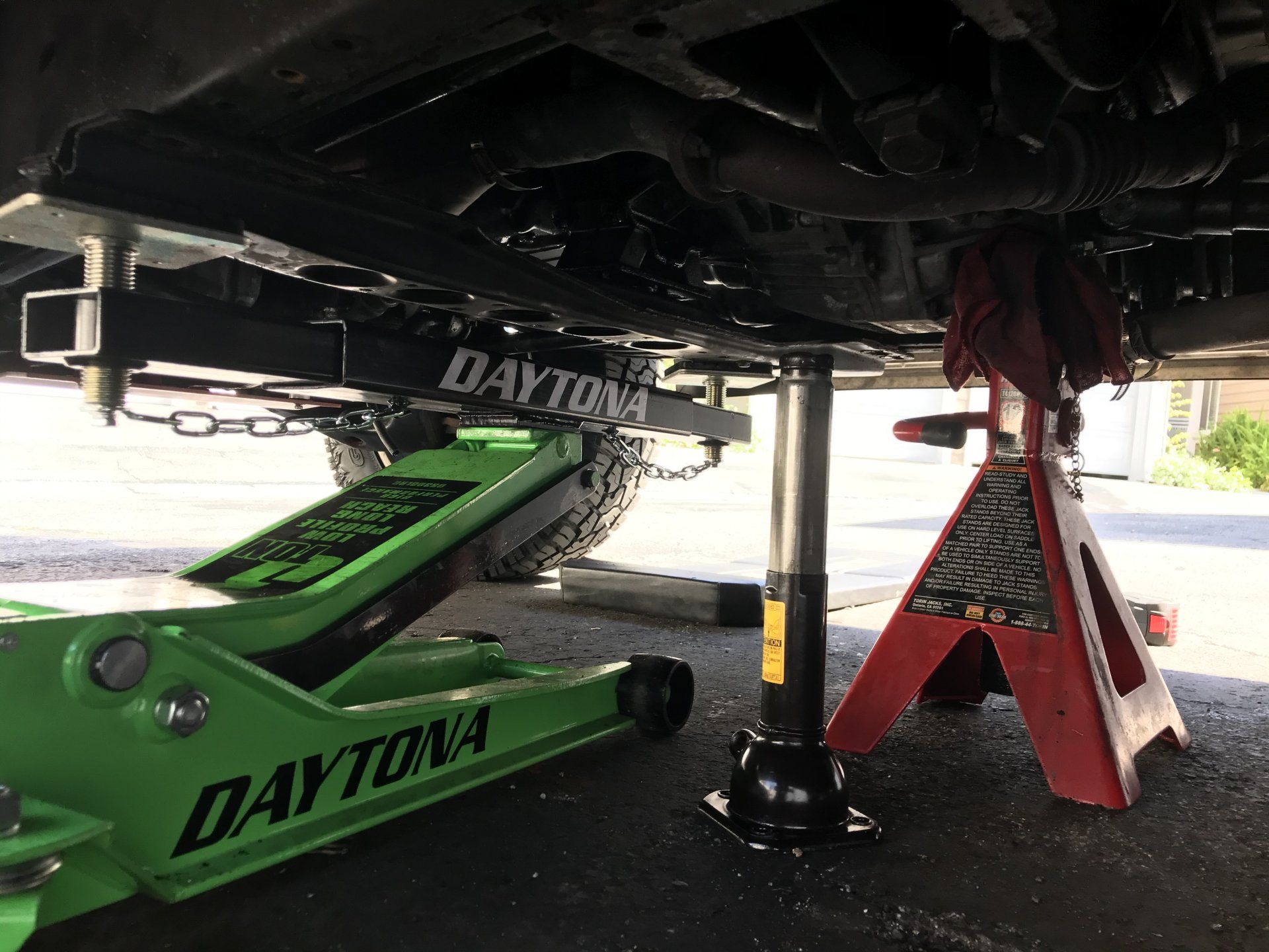

Had a chance to use my cross beam attachment only 40 bucks with coupon from Harbor Freight, super handy. I have been super happy with my Daytona jack, gives me 24 inches of lift! I used a 12 ton jack with some shop towels to hold up transmission while I swapped everything out. Will come in handy for for bumper install.
Fit and finish on the creeper skid line up nicely. No need to widen any holes.
I used a 15 mm 6 pt combination wrench and 15 mm ratcheting wrench to tighten the hardware on @TRAIL TAILOR rear shock guard, fits like a glove. Took maybe 10 minutes a side including retorquing the shock bolt, 72 ft lbs I think.

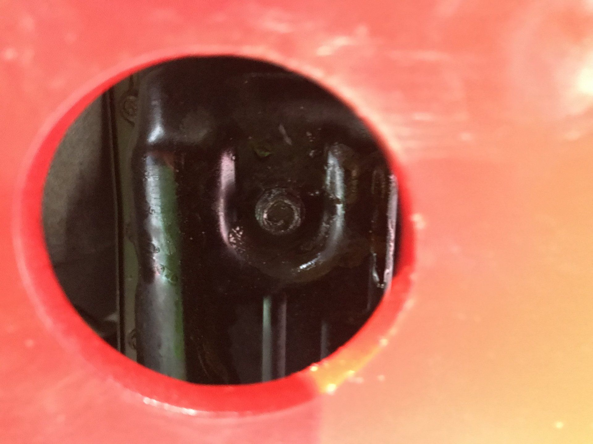

Access hole for the lubing the driveshaft zerk fitting.
