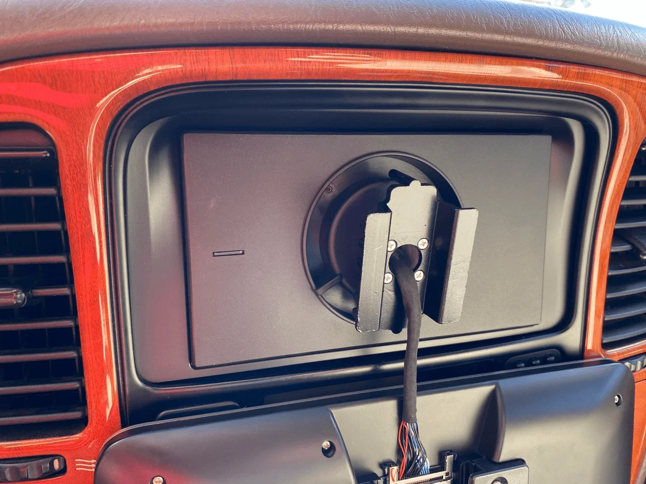

I'm still new to the 100's and haven't seen that setup before. Was curious how it looked from the side, like how far it stuck out, etc. I've been contemplating throwing a few raspberry pi's in the truck.. still trying to work out my use case.
I'll take some pics from the side and post. Also slide the screen off to see.
It's a double din unit, so only needed a trim piece.
I had to get longer mounting bolts with some spacers as it would sit too far in. (1/2 in spacers_
At the current setup, I can adjust it up / down. I like where it is now though, so I can still see the A/C.

Did you (hopefully) mount that with security screws? Did you also use a single DIN blockoff plate?
It looks fantastic, much better than I thought it would look with the monster screen

It's nice since the A/C vents are still exposed.

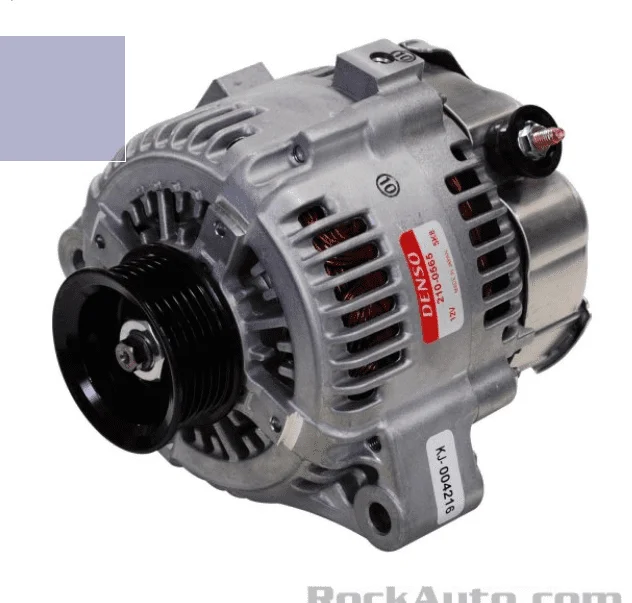

Just bought a Denso reman 100a alternator for the 99 LX470. I'm looking underneath the truck and I think I was told the alternator was replaced with an aftermarket. Something about it looks like its 21 years old. These Denso remans are $99 at RA + $34 core. With the Mud discount takes off almost $5. I think I will get a this one and keep the old one to rebuild and keep as a spare. Unless it is some unidentified aftermarket, then I will send it back.

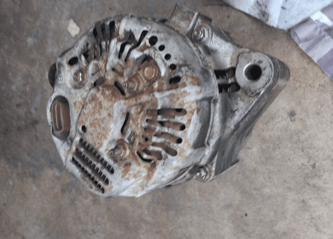

This was the fastest alternator pull that I've ever done. It took all of about 10 minutes to snatch this one out.
I can't find any identification on this alternator to know where it came from. It almost looks to be older than the rest of the LX.
Any ideas?
