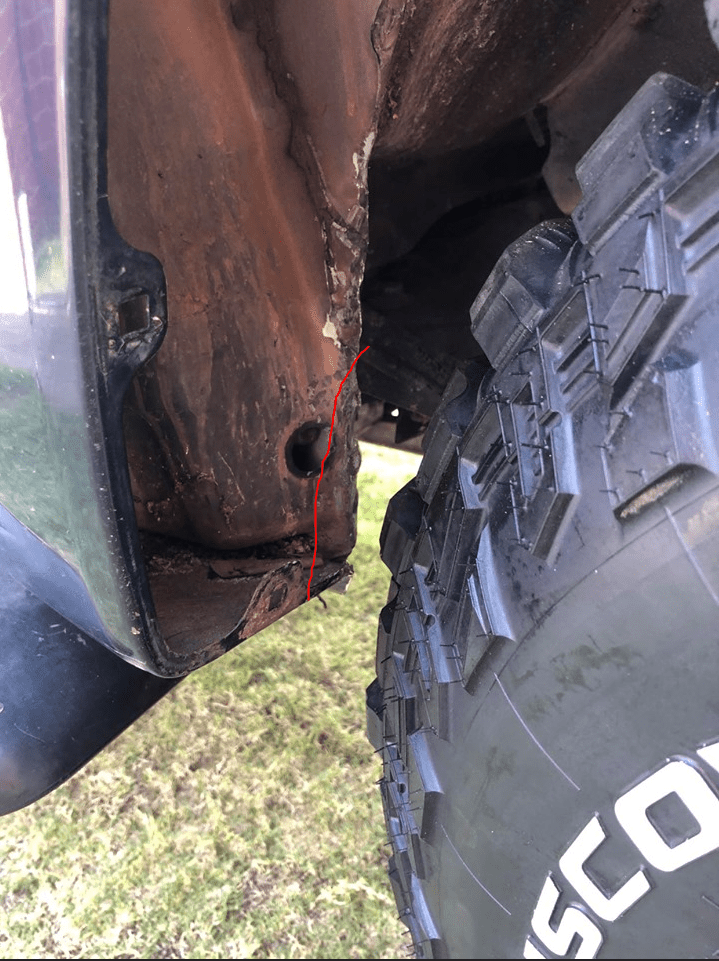

Currently attacking the front inner wheel arch.
Anyone know the effect of taking off this corner with a grinder disc? Thinking it would seperate the metal. Bad? OK? Not sure about it.

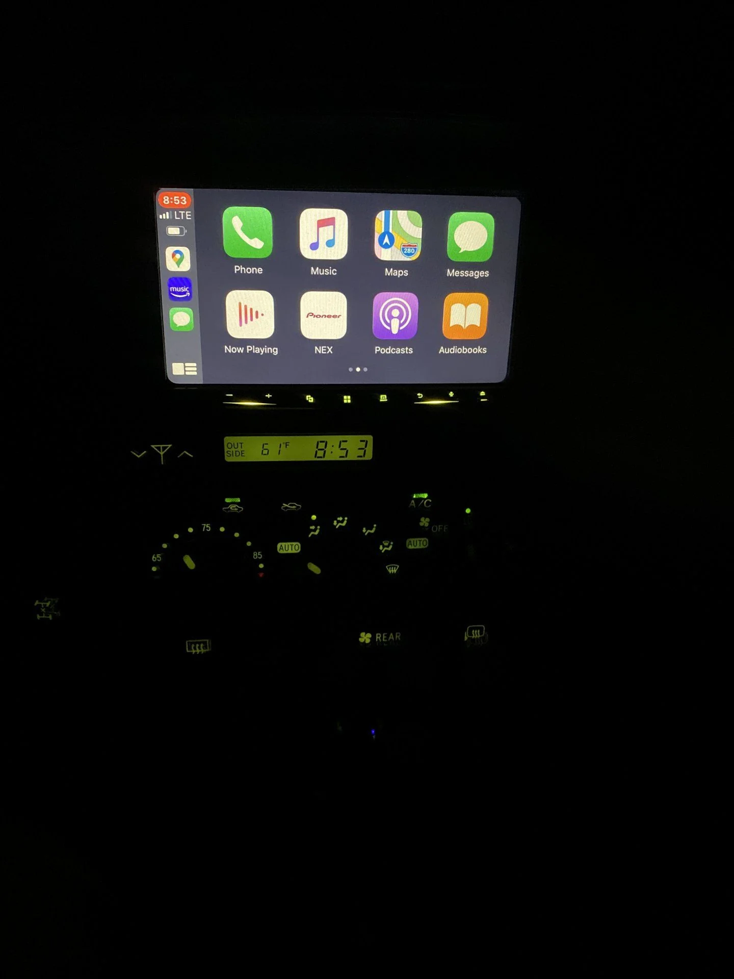

Hey guys, my name's Thomas new to the forum but have owned my 99' lx470 for the last 4 years. Have done a little work over the years not much upgrades more upkeep; added some Yoko Geolander A/T's, took my running boards off (looks great btw), topped off the transmission fluid, used some seafoam high-milage with my last fill up, and a power steering flush and top off.
-Pioneer 4500 NEX installed
-Blue sea dual usb installed on the right cig
-Accele usb + hdmi extension from HU to center console plug for CarPlay

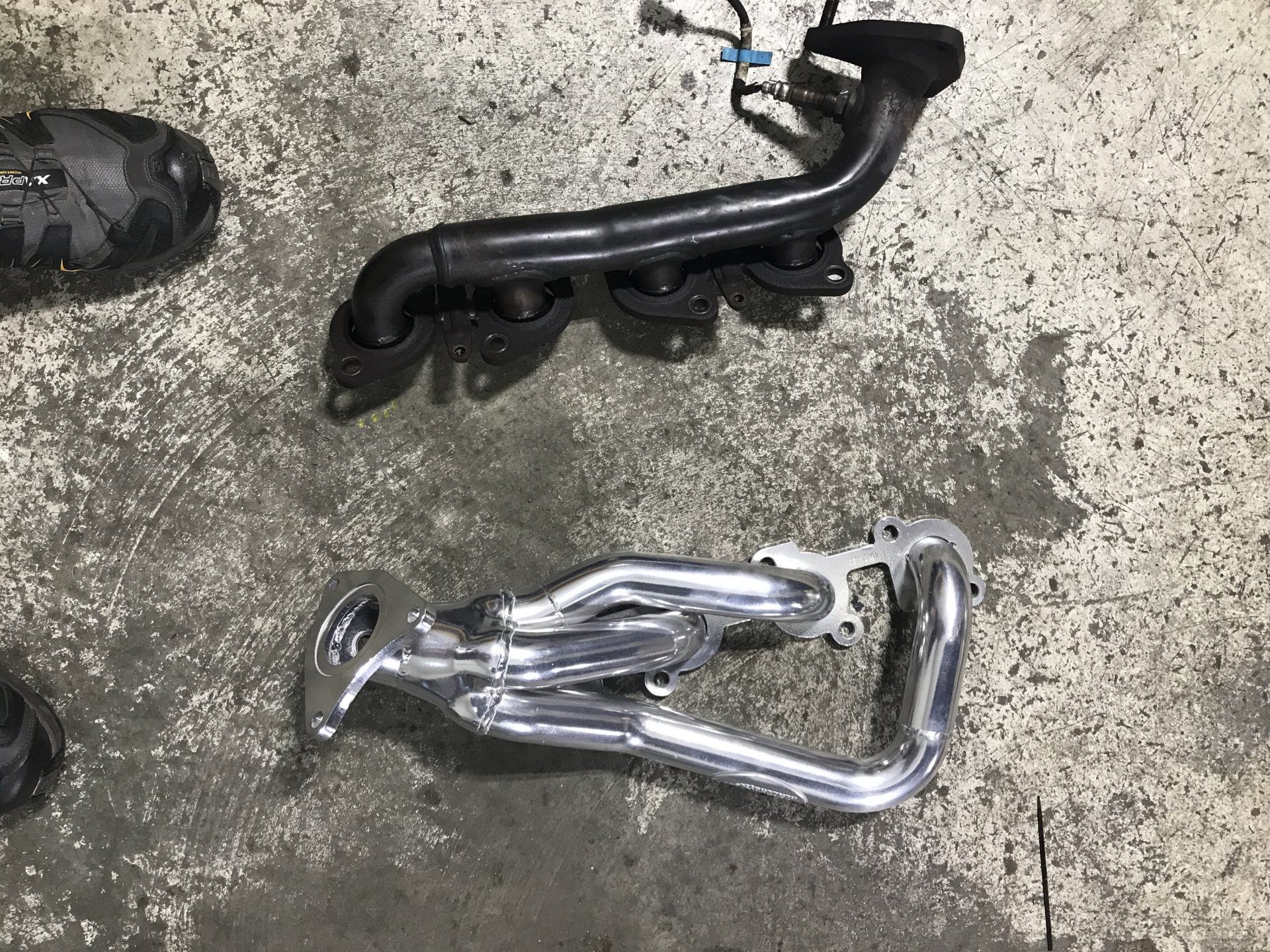

-OEM exhaust from cats back. $$$$
I looked at Borla, Doug Thorley, talked to Slee. Decided that OEM was the best choice. After running for a few minutes you can hardly tell it’s on.

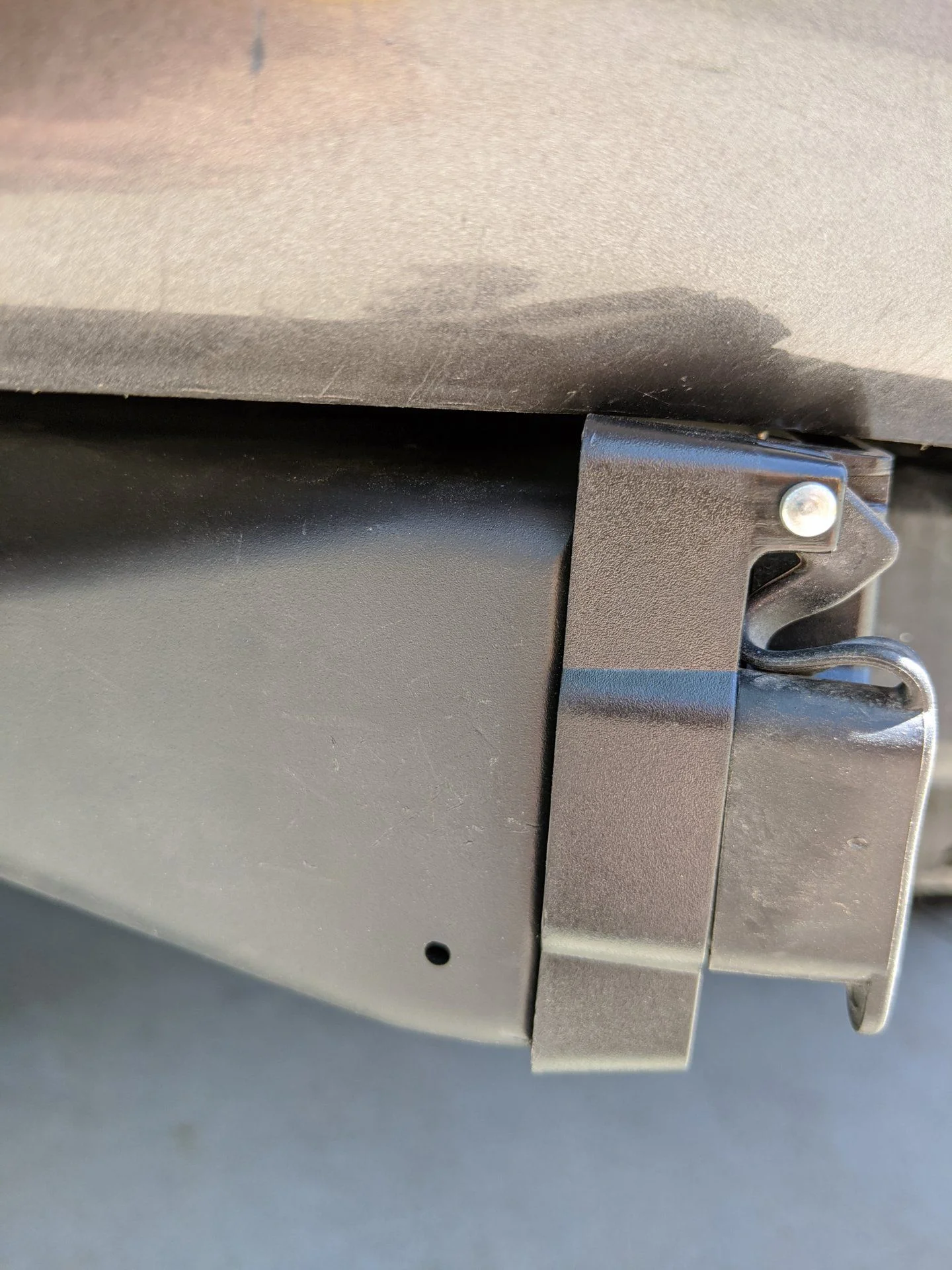

Thanks for the tip! It leaves a little overhang on the top with my Hopkins Multi Tow 7+4 connector, but it will work great for me. It was super easy to install by clipping out the cutout so the wiring could be run without disconnecting anything. I'm sure I can still find a way to rip off my connector, but it seems like this will decrease the frequency.

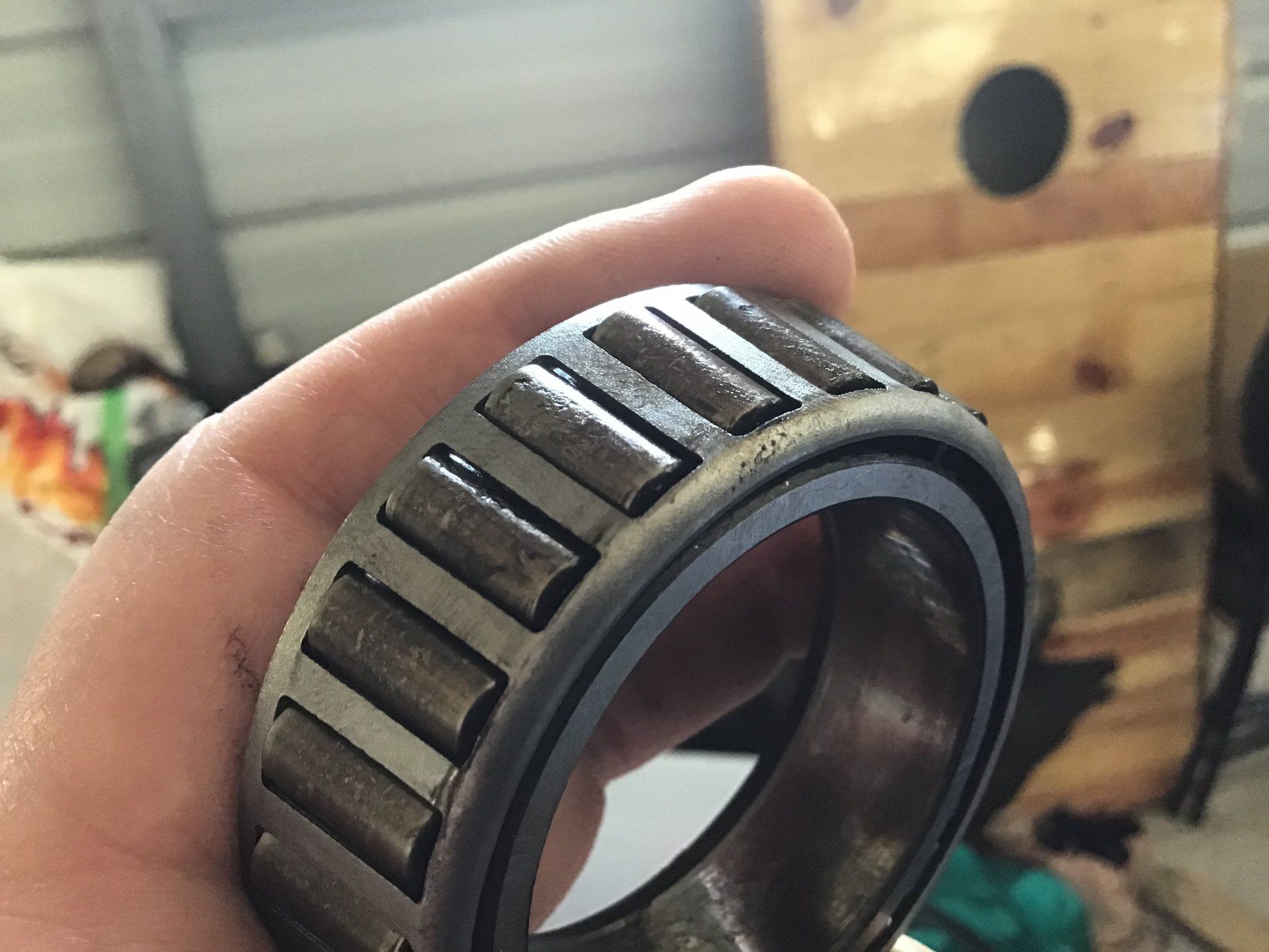

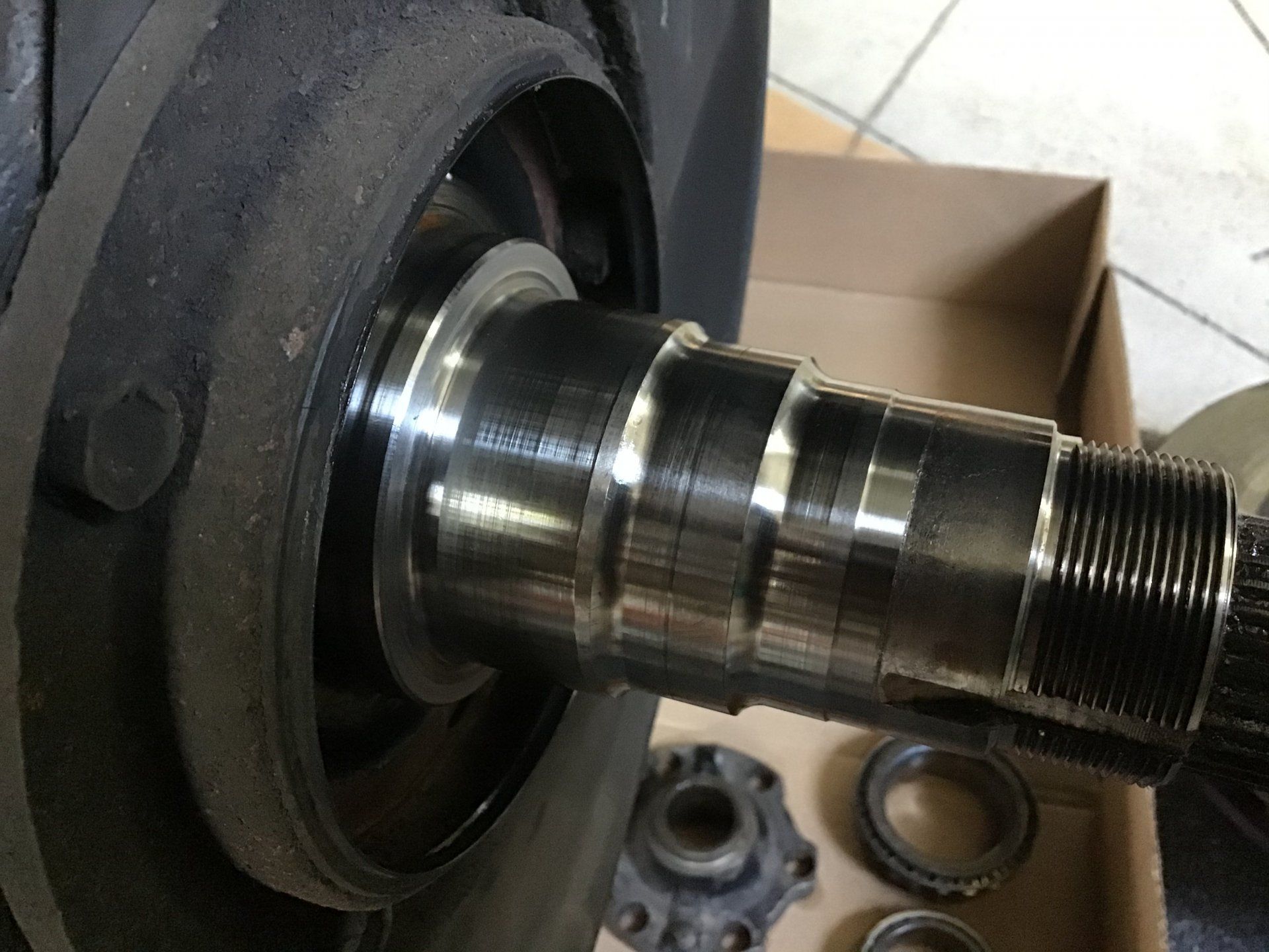

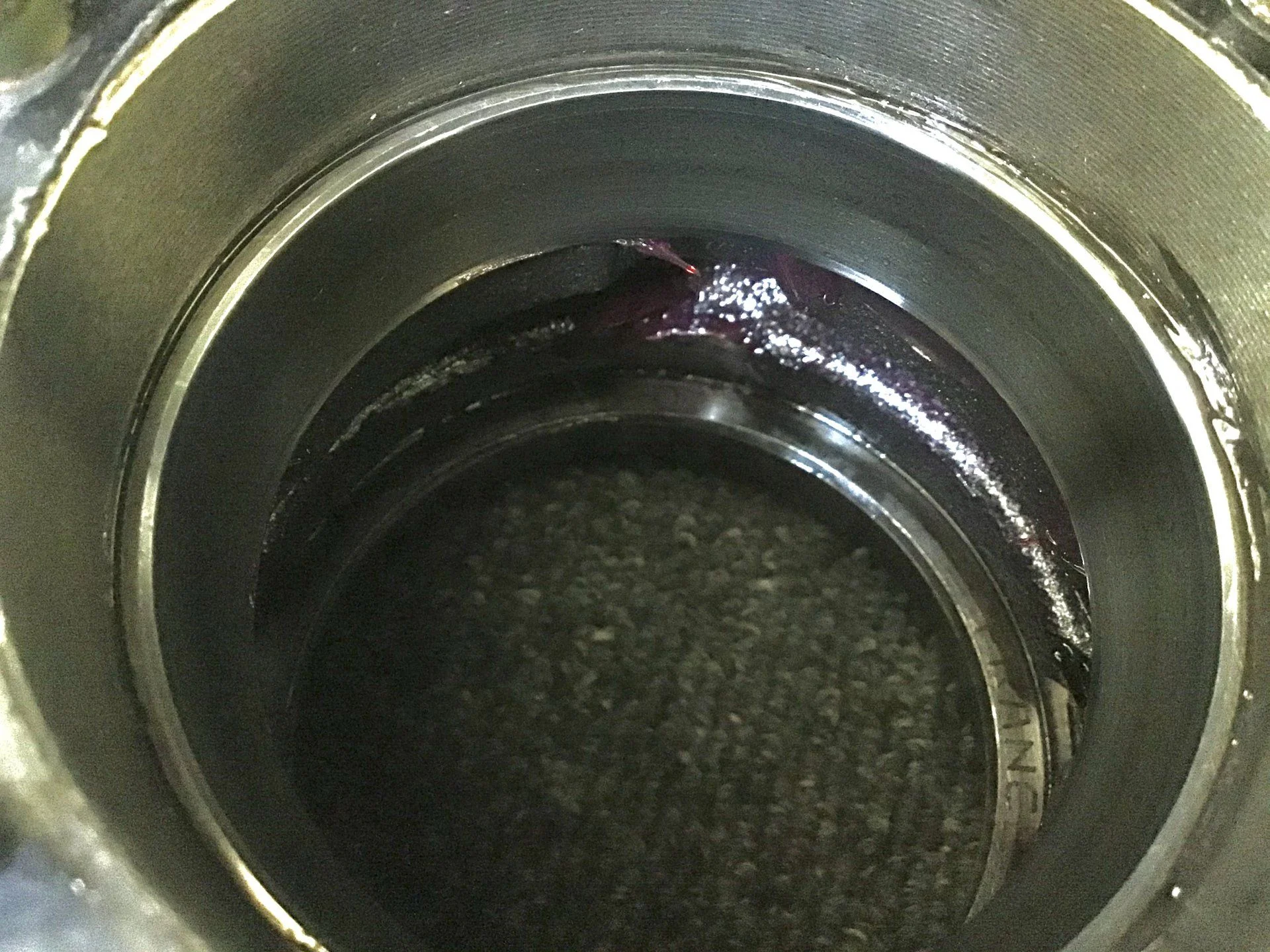

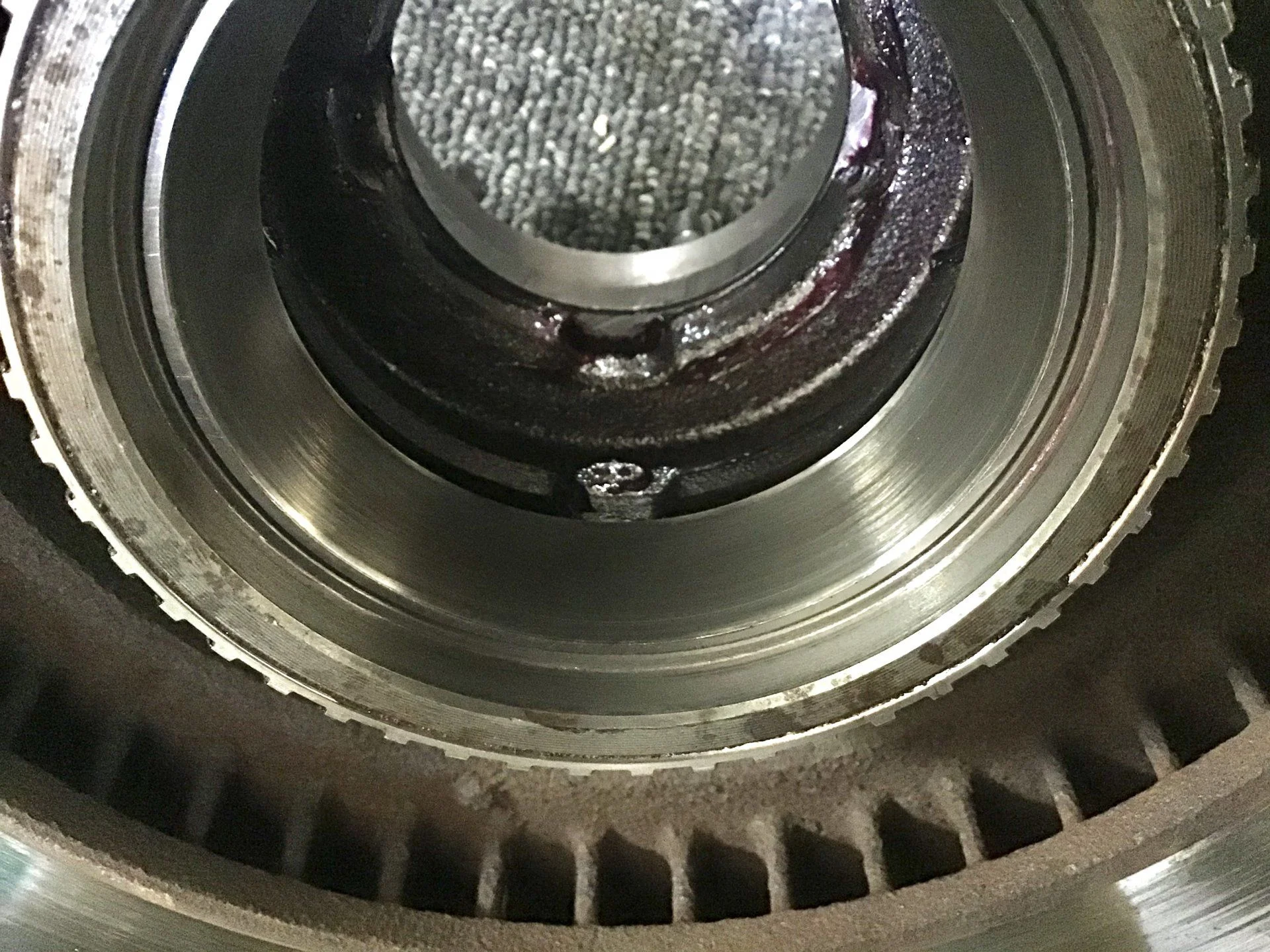

Discovered the source of the “growl” during faster left turns(?) I think. It started on our long trip last summer, and I chalked it up to the CV boot that split on the second day. It turned out that another boot was dry from the date of purchase, but when replacing them earlier, and getting a rotation and alignment checkup yesterday, it was still there. No noise when going straight or right. To their credit the tire shop charged nothing for their extra time trying to help me figure it out- they thought it might be way out of alignment too, after all my front end work, but it was still nearly perfect, and the KO2s had no signs of abnormal wear. There Final guess: wheel bearings. So I pulled everything apart today and found this: (besides 1 random lock washer tab sitting in the grease, and no drive flange gasket) IMO, spindle looks great, inner and outer races look good, inner bearing set looks good, but outer is pitted In places, and every bearing has tiny dents. Would just that cause the “growling” enough for the vibration to be felt through the floorboard? In order: spindle; inner race; outer race; inner bearings; outer bearings.

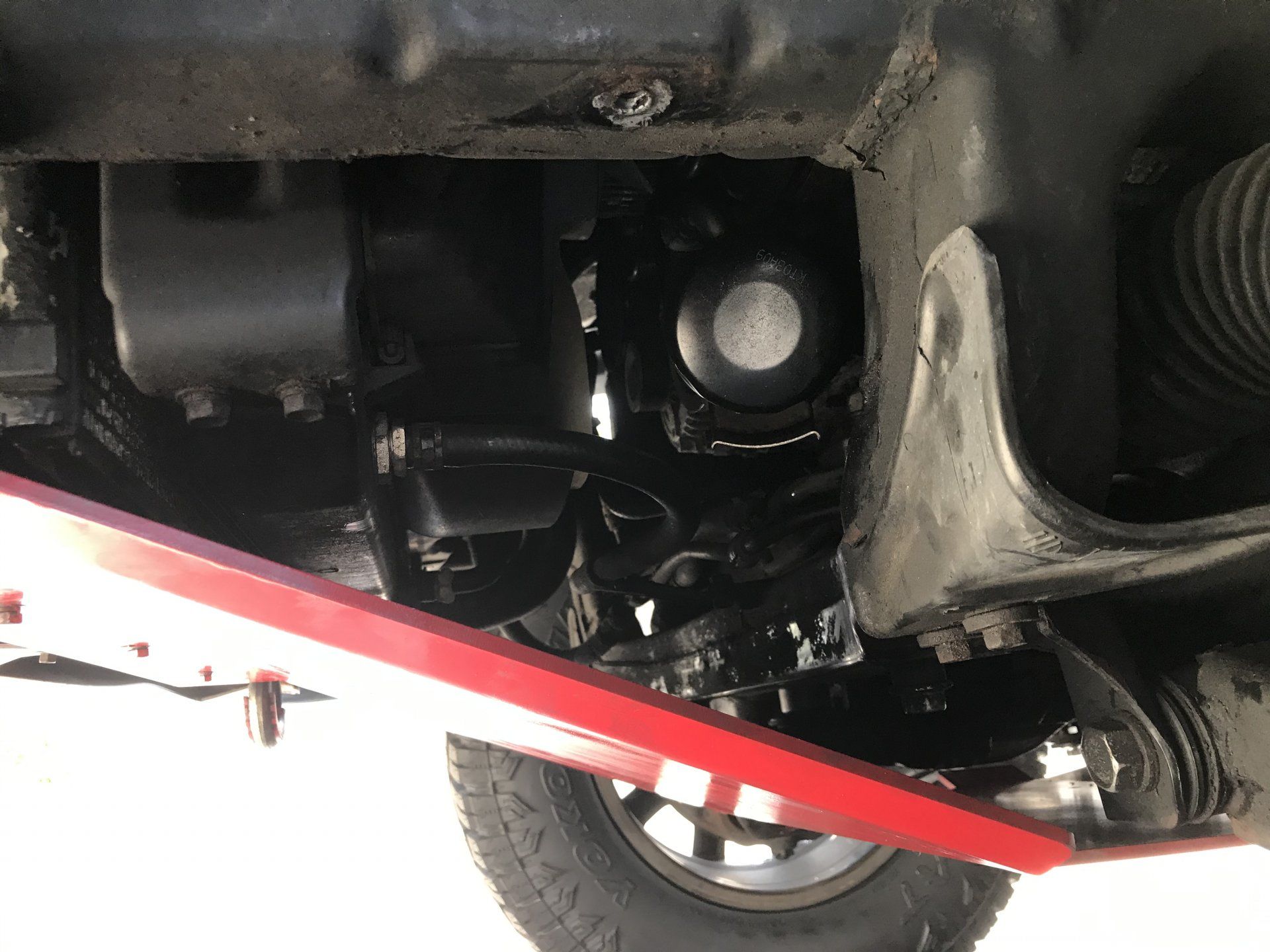

Installed a fumuto drain valve and replaced with Mobil 1 0w-30 and OEM filter. I need to add a hole in my mid TJM skids to access the drain valve.
Also installed my front ASFIR skid, need to get a 90 to 120 mm tall puck for the center of the skid. As I have @Trail Tailors diff drop and the ASFIR skid doesn’t have the hump like the OEM one does. Also need to add a middle hole to the rear of the skid plate to line up with the diff drop. On the plus side, plenty of room to access the oil filter, I folded a piece of cardboard to help it drain.
Yeah, that bearing is chowdered.

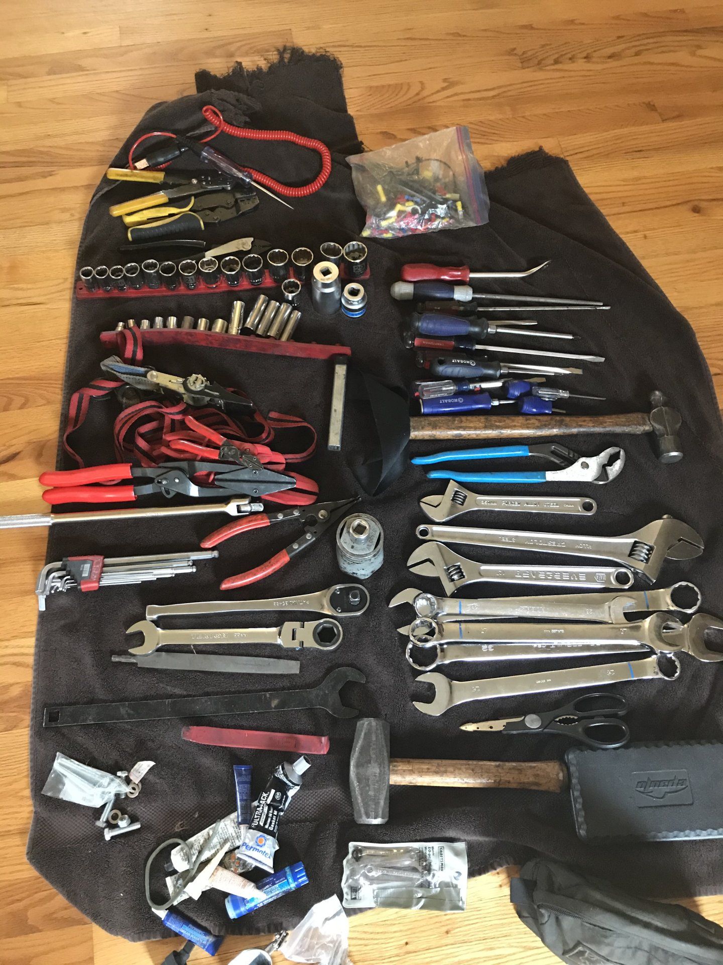

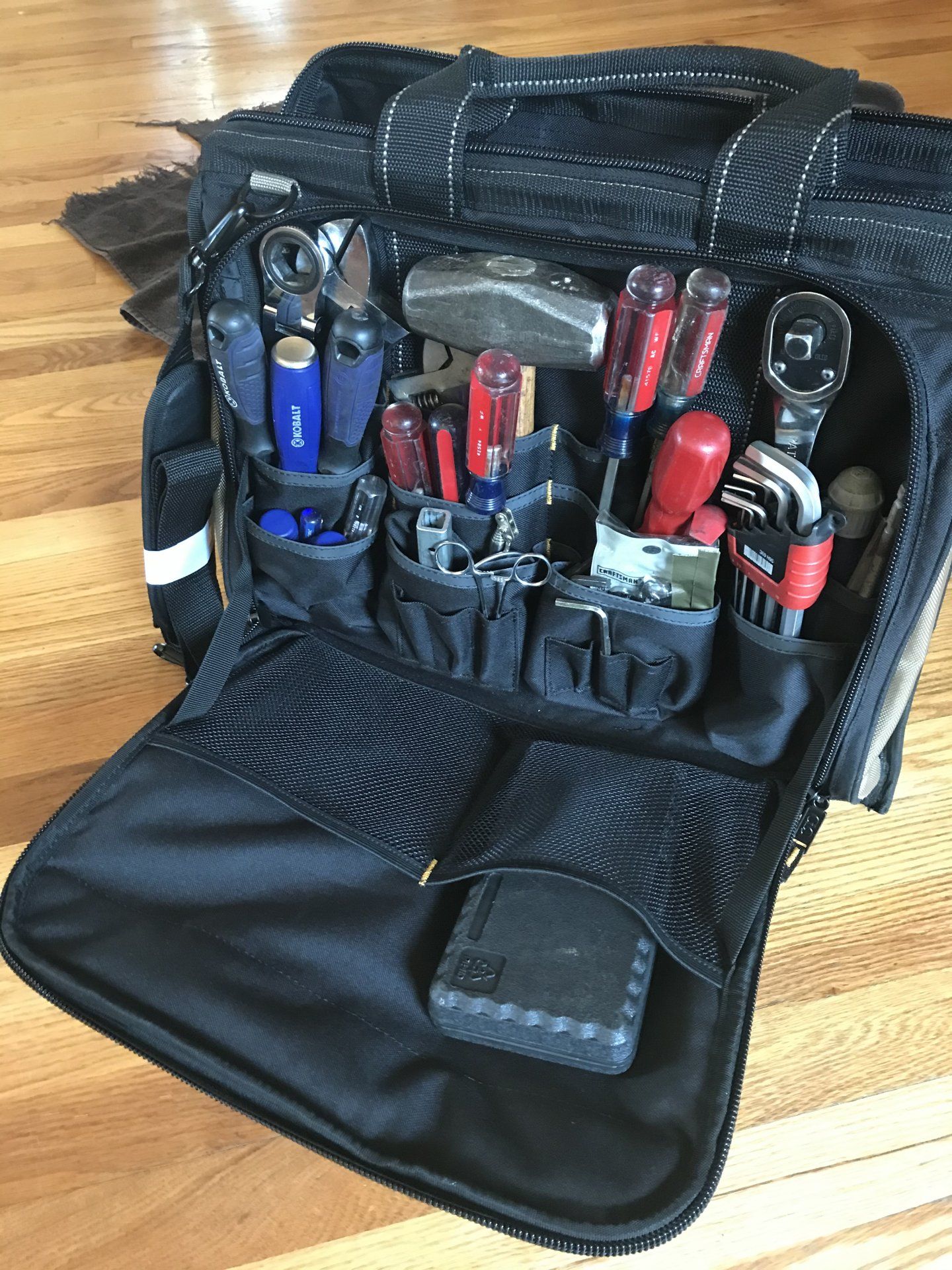

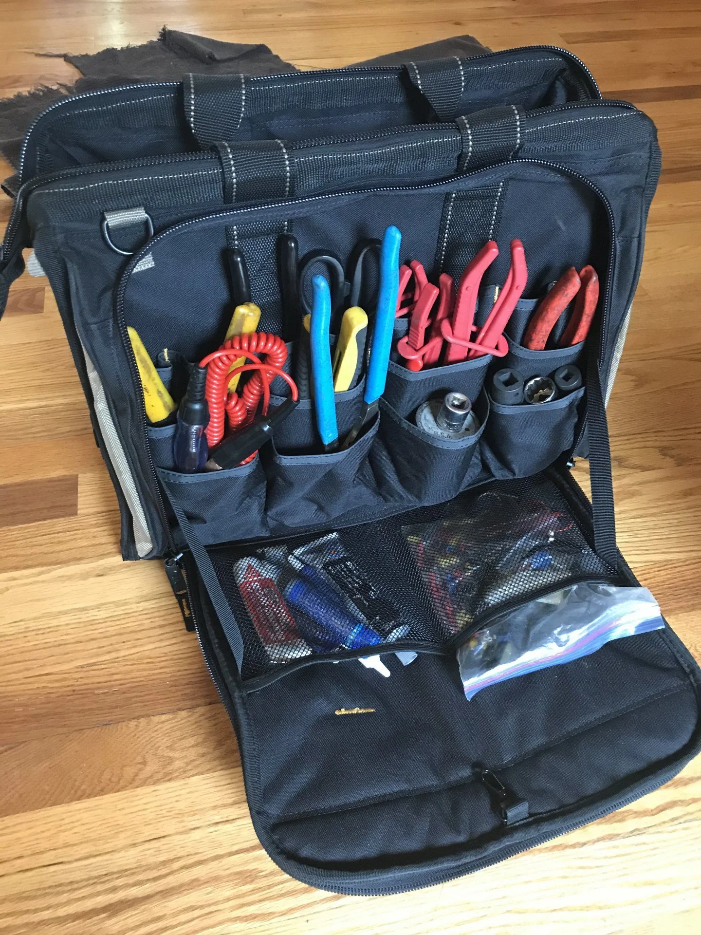

Not something I did to my hundred, but something I did for her—replaced my 25 year old, overfilled, and busted-zippered tool bag with a new one that allows me to organize 80% of the big junk that was rattling around in the bottom of my old bag. Now there’s just a BFH, big wrenches, and a tool roll loose in the main bag compartment. Soo much better.
below see everything spread out, then packed....
