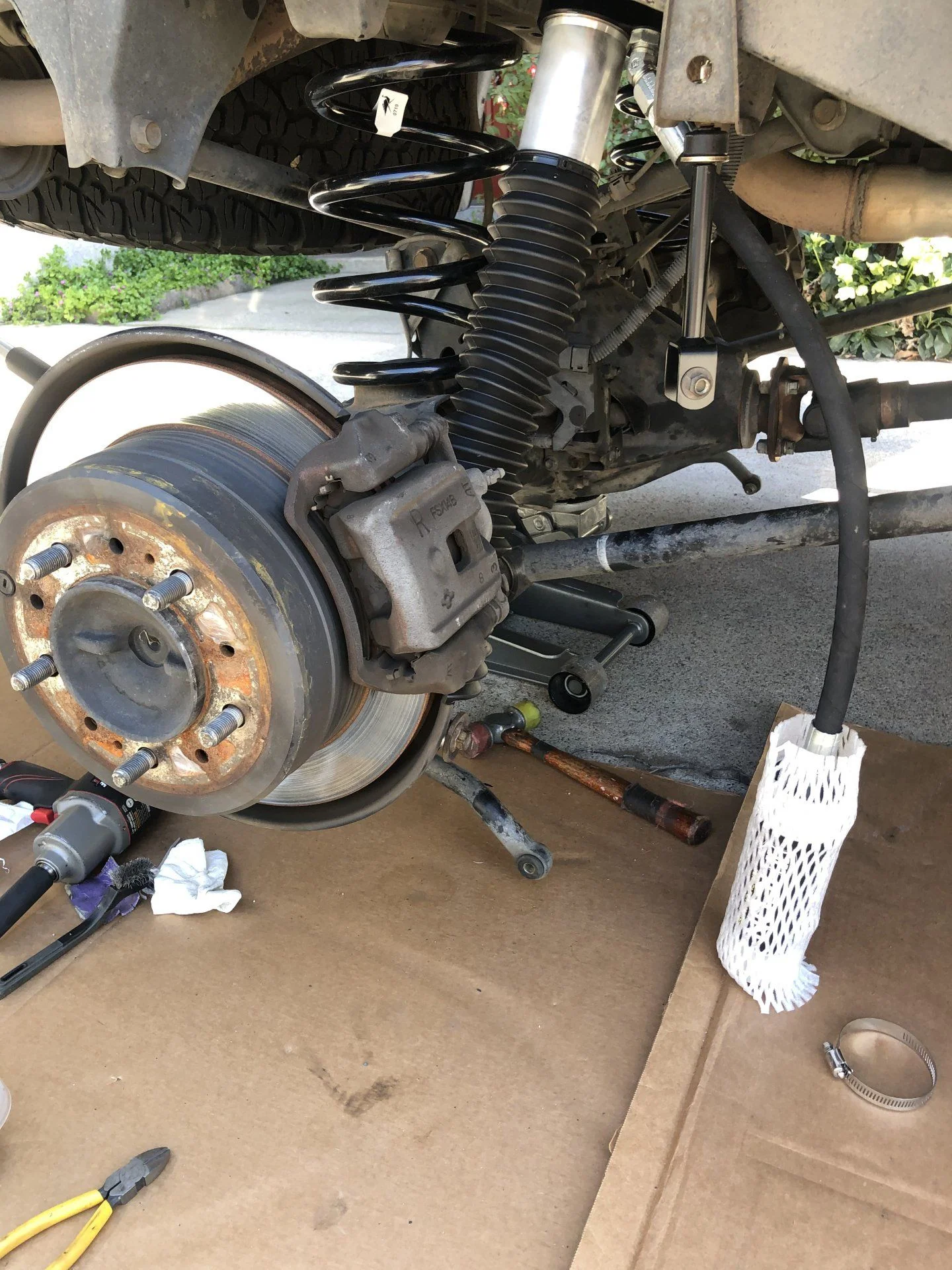

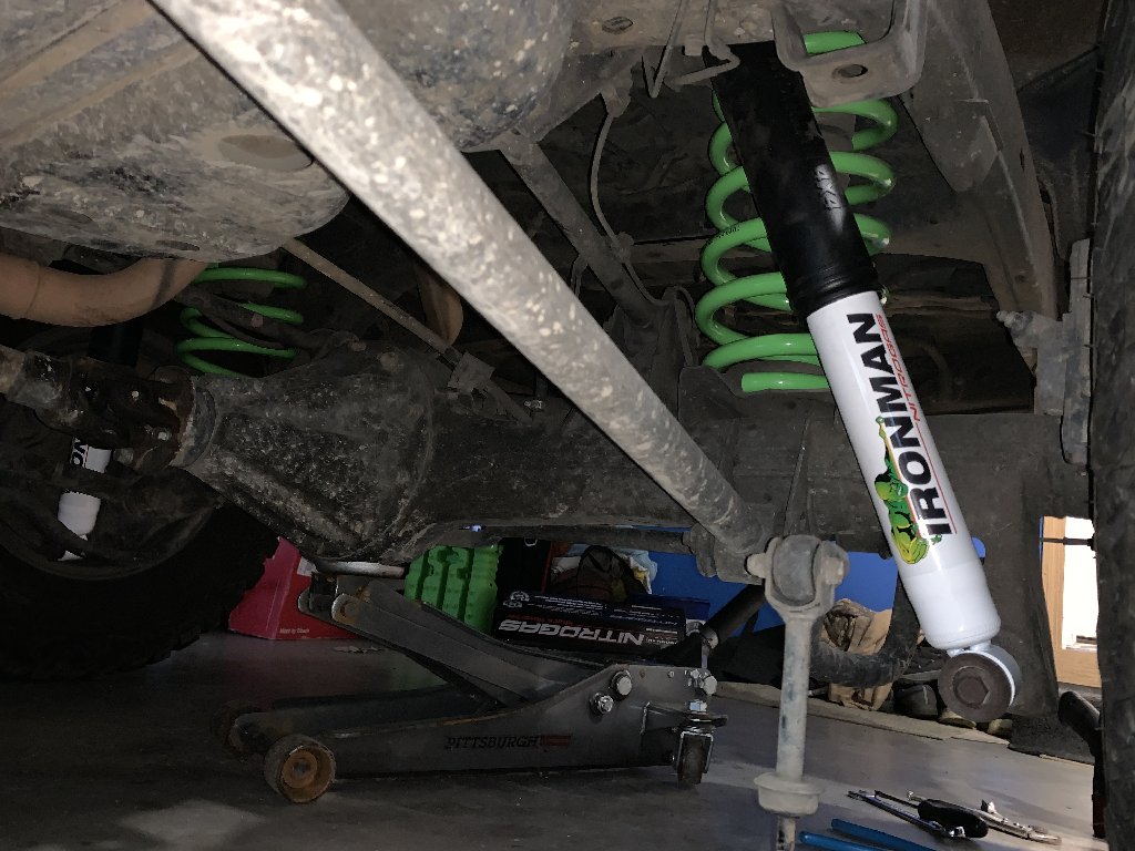

Last night I wrapped up installing the Ironman rear shocks and springs.
(Does anybody happen to know what the washer is for that comes with the rear shocks? In the instructions it looks like it goes at the bottom with the bushings but I didn’t use it and it’s driving me crazy trying to figure out)
I ordered extended sway bar links from Trail Tailor and those are coming in tomorrow so I can completely finish the rear end.
I also have the Trail Tailor diff drop coming in with the links.
Today I will try to knock out the torsion bars after work and start prepping the front end.

I'm interested in your washer question.

The picture below is the shock with the hardware it comes with.
I am unsure of what the washer I’m pointing at is for.
This is otherwise how I assembled the top portion.
I watched a OME install video on YouTube and this is also how they installed the rear shocks without any washer.

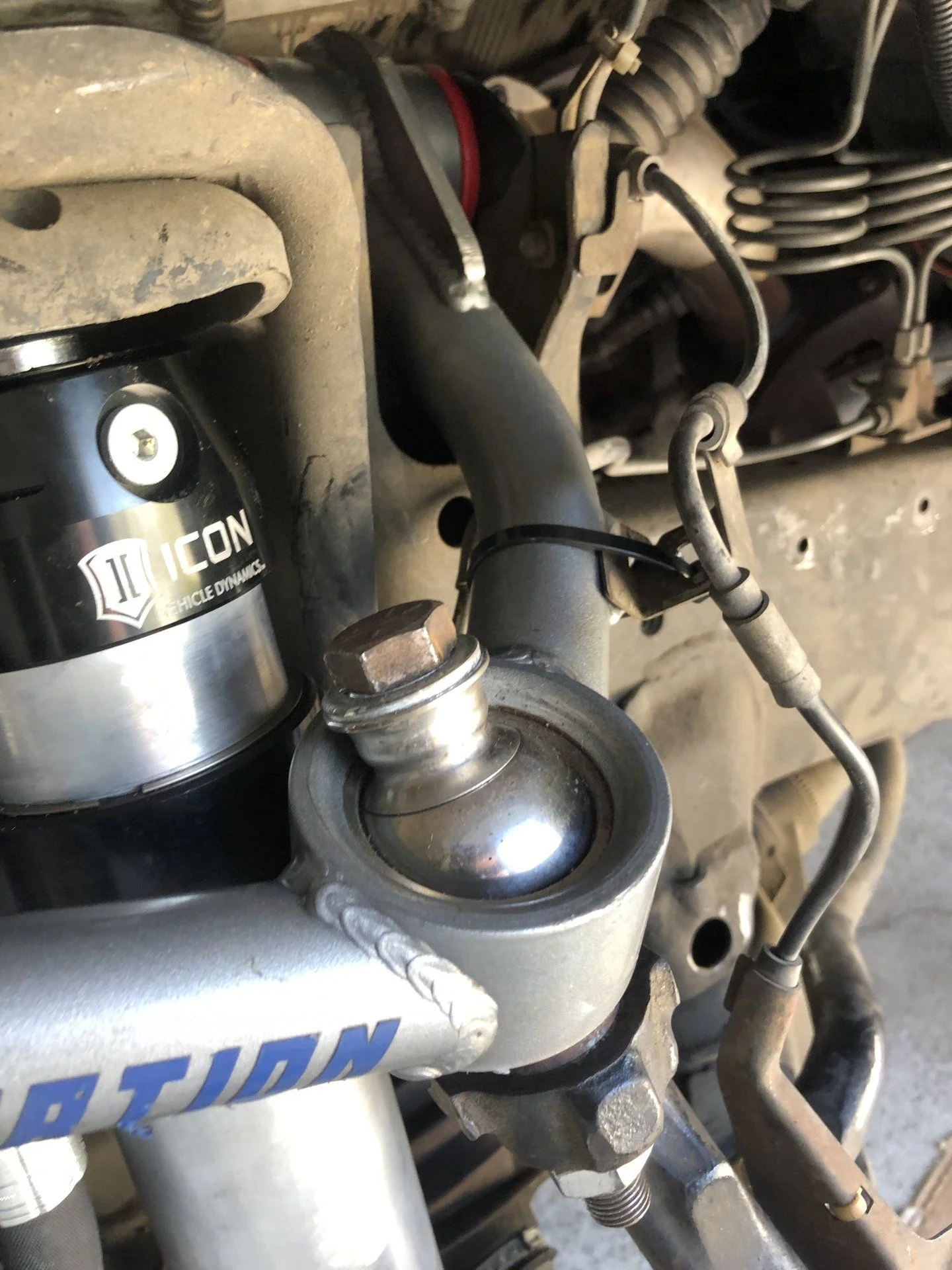

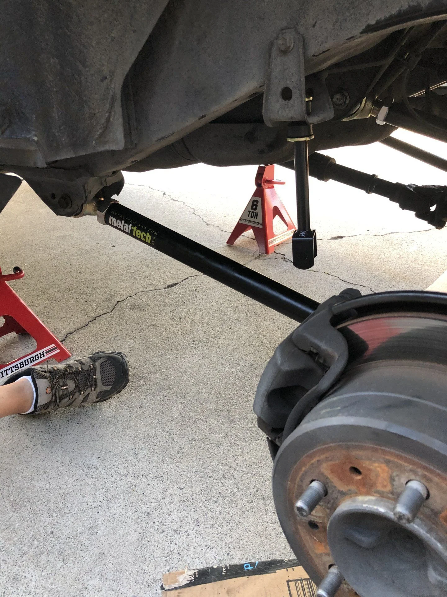

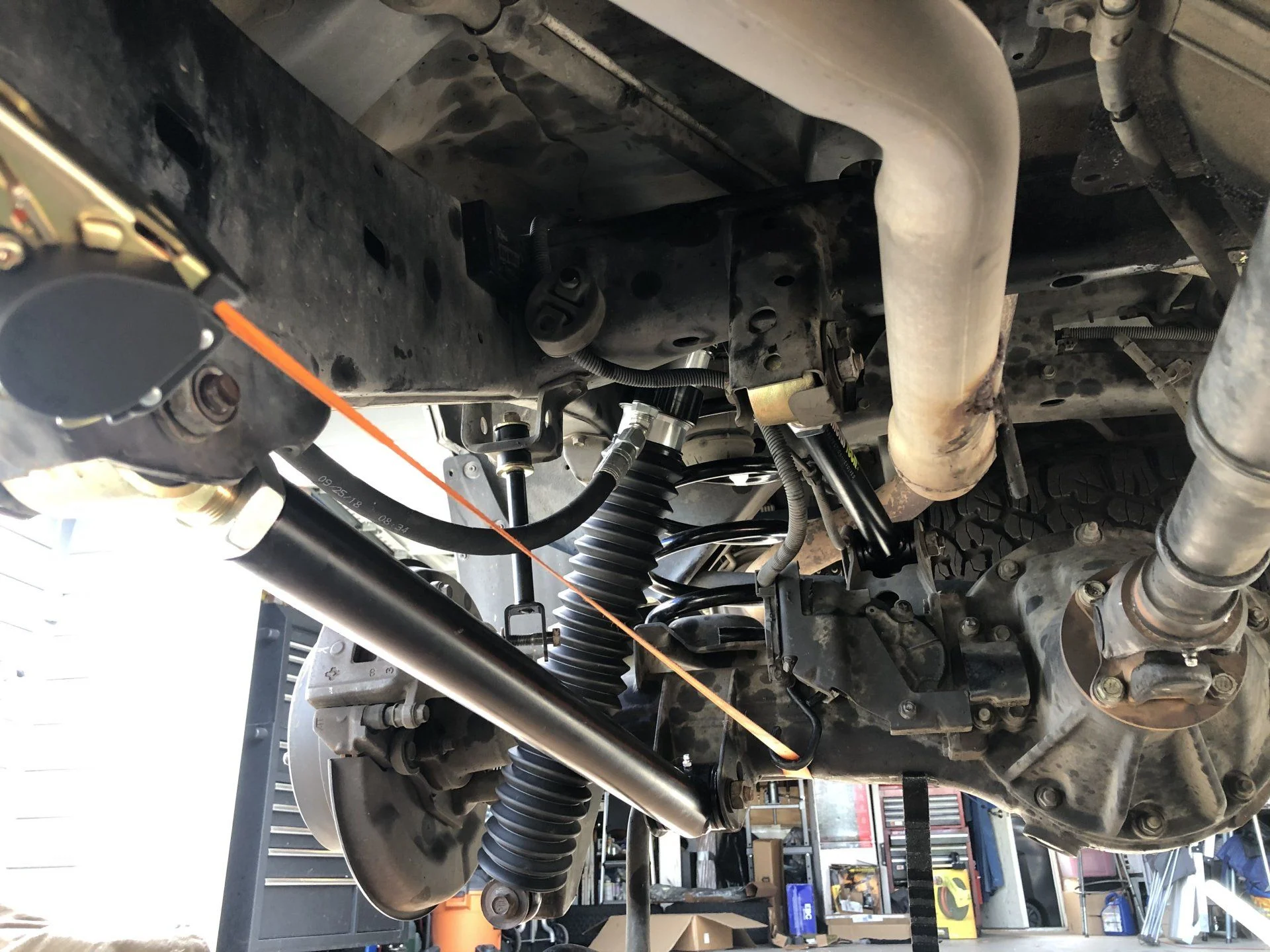

I have slowly been buying parts over the last few years and finally had the time to put it all together. Icon stage 3 front and rear shocks, total chaos UCAs, Trail Tailor diff drop and extended swaybar links front and rear, metal tech 4x4 rear upper and lower Johnny joint Links and OME 866 springs. I cranked the torsion bars up a few turns and leveled out the front at 22” from the center of the hub, I think I may need to reindex my torsion bars so I can get 24” to match the rear, thoughts? I also have Ironman 4x4 torsion reinforcement brackets that have not been installed yet. Did I miss anything?

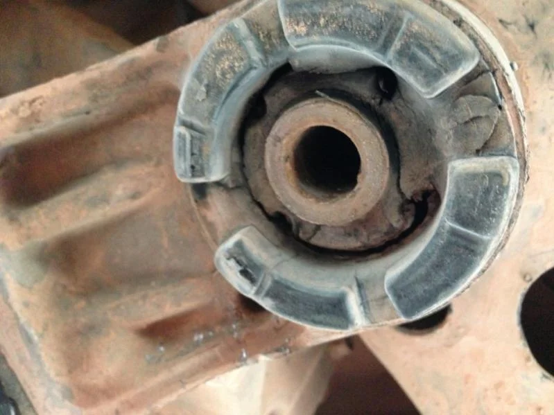

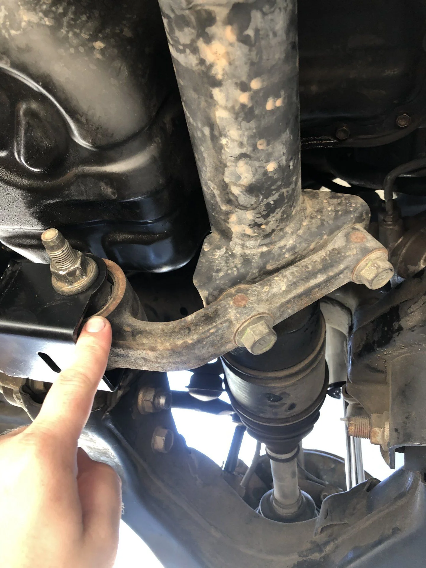

Second picture is a very cracked bushing that mounts from the diff drop to the steering rack. I will definitely need to press that out and replace soon. Anyone have a name or part number for this piece?
Go ahead and replace all three bushings.

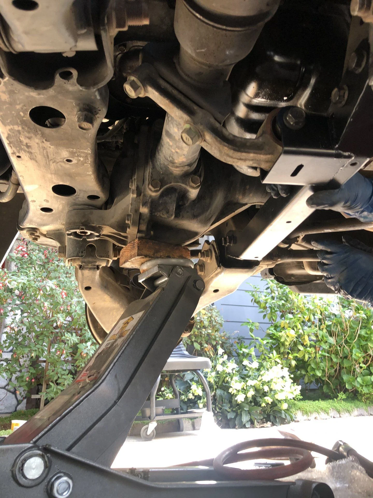

I'm replacing all of mine with the diff project. None were in terribly bad shape. I figure since they lasted 21 years, it will be sometime after the year 2041, before I would need to think about replacing them again. :zilla:
Only one of mine is bad from trying to move them in place with a small crowbar, but I'm replacing all of them while I'm at it.
I'm betting that washer is intended to go over the lower shock stud before you install the shock.
