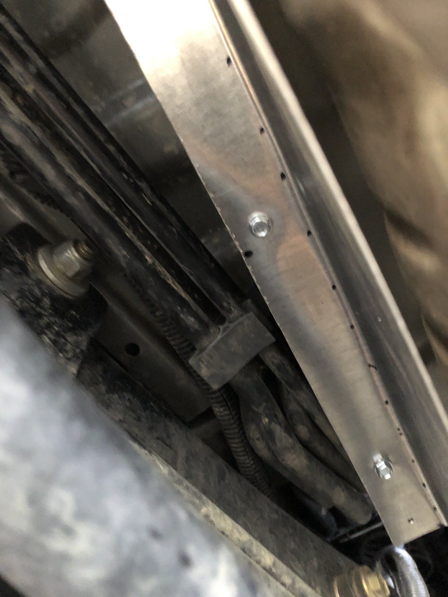

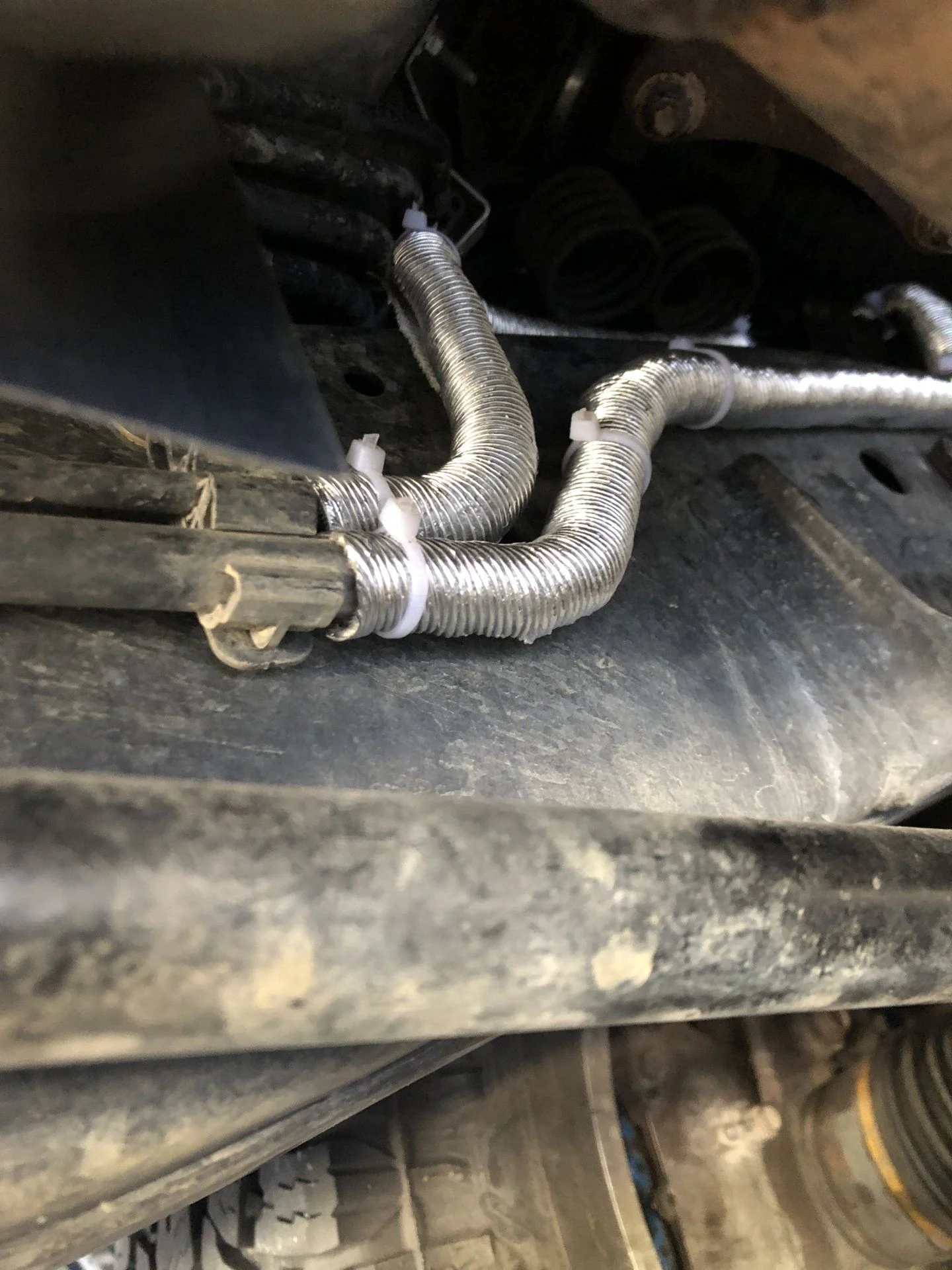

From what point to what point did you shield the Fuel Lines. I want to do this but not sure which are the fuel lines and how far the fuel line shield should extend.
Why install heat shielding for the fuel lines? Is there some mod you've done that makes it necessary? I've got 215,000 miles in the heat without ever having a problem with fuel flow. Just curious.
Chris
Chris
In my case I put on the heat shield to help with transferring heat from the Cat to the fuel return line , this has proven to really help with the fuel tank heat
Chris
In my case & experience by others, my gas in the tank started boiling on a trail in which I was struggling on; day was hot & at just a little higher altitude then normal. The solution seems to be to install a heat shield & wrap the fuel lines to help keep the gas from boiling.
But my questions still stands where are my fuel lines under the truck. And how far should I wrap the lines.
Hmmm, I was off-roading in Sedona and Paria Canyon/ Vermilion Cliffs last year in 100+ degree heat, sometimes with all seven of us and our gear for 2200 miles. Never had that fuel issue or even heard of this. I hope for your sake it works! Looks like it should, especially if you keep some air space around the shielding.
For reference: 100 Caught fire & gas tank venting concerns. It's a thing, but it doesn't seem to affect everyone. Mine has definitely boiled as well. Replacing the evap canister and fuel cap seems to have solved it, but I won't know for sure until it's again 100+ degrees or we're at elevation.
Oh, that problem. Mine boils the fuel sometimes if I pull the boat up to high elevation. I hadn't heard of shielding fuel lines as a fix for it but I'm interested in the result.

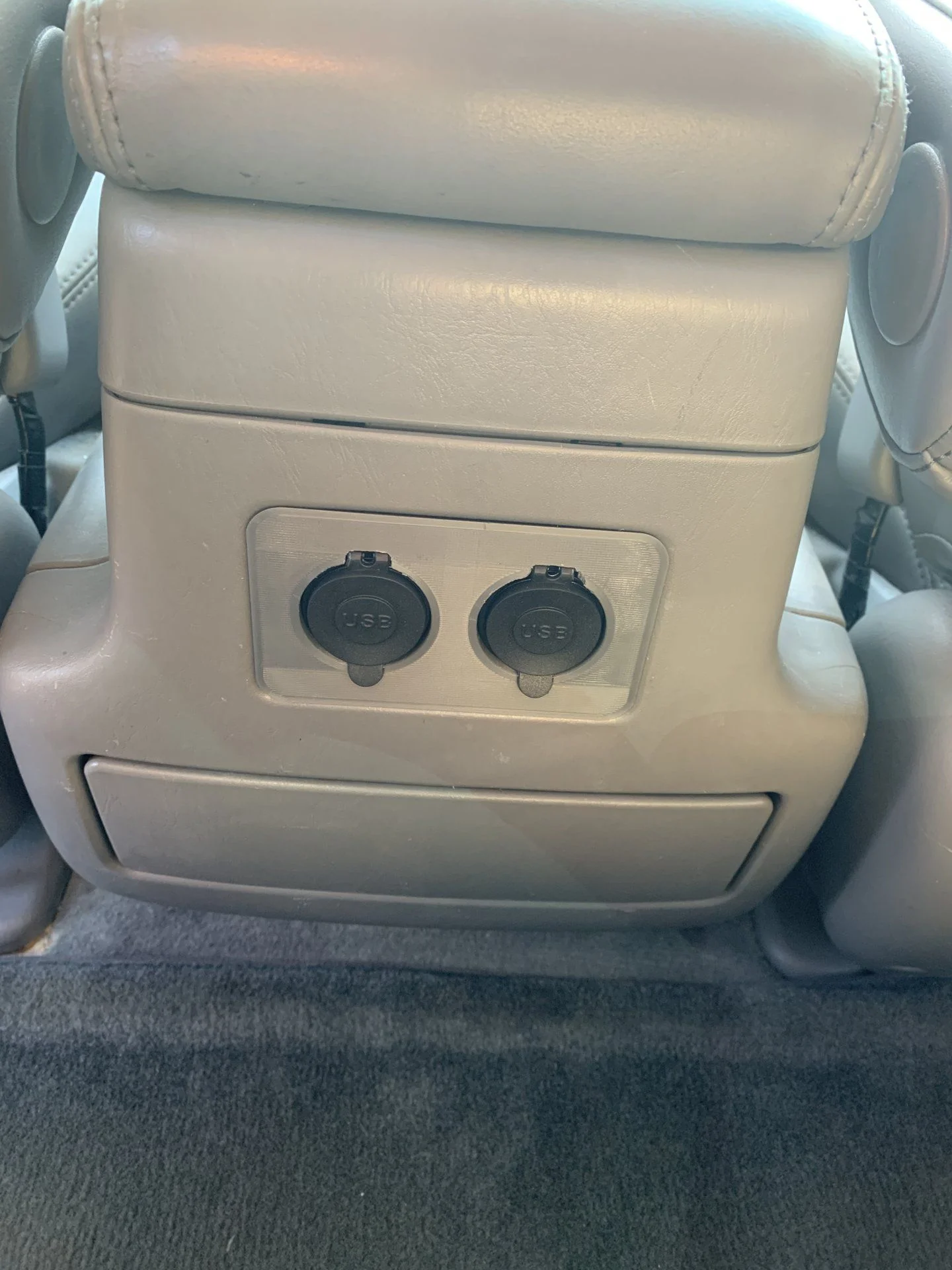

Installed one of BenCC usb housings in the back of the arm rest and put the platform in. Doing some wishful thinking that camping season is here.
There’s a lot of factors that can cause it. Some believe it’s the combination of high elevation and high alcohol content fuel. I had this happen to me after HIH8 on Pearl Pass. Luckily I had paint protection film installed and no paint damage. We also got vapor locked on top of one of the trails during the event. Keep your engines running at high elevation!
