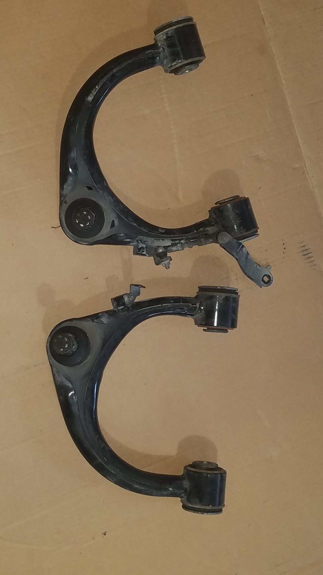

Decided I don't want a clunking and creaking front end anymore. Ripped out these Nitro UCAs (the uniball type ball joints have become loose and squeaky!). Replaced them with a pair of used OEM UCAs. All is nice and quite now and the steering centers itself quickly after the turns.
Out with the old ones:
In with the new-old ones.
My Total Chaos UCAs are squeaky too, especially after it rains or I drive through water. They require a lot of grease.
how much lift do you have? and did you re-align after going back to stock? just wondering if you needed the nitro UCAs in the first place.
