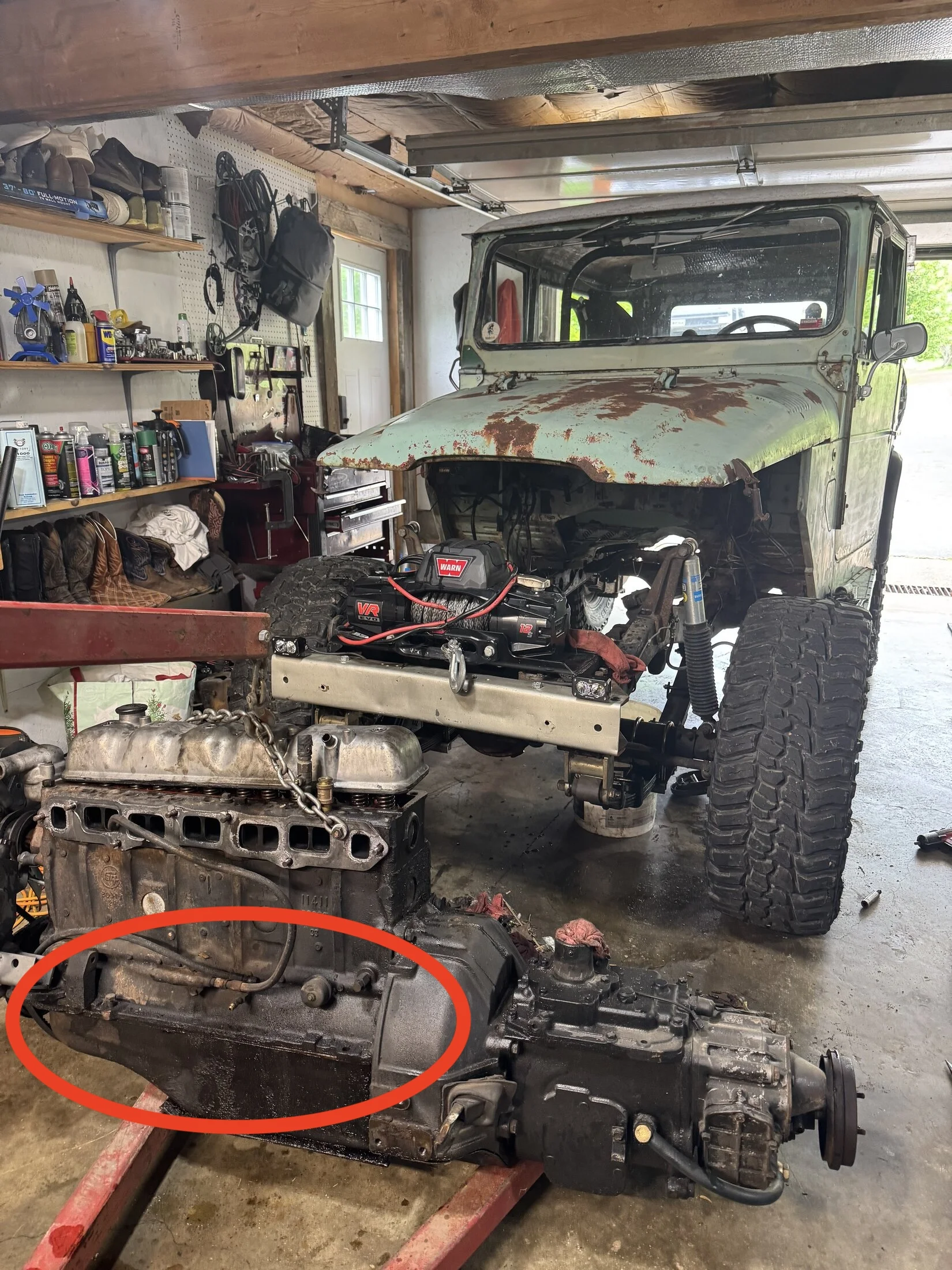

What do I have? 40 newb
You have to have custom bends and what not I believe. I’m not sure I understand it all yet, all the fabrication rules.
I'm running one of them propeller supports. Not because V8 but because drivetrain length due to doubler. I got these for mounts
Man I agree. I’m initially wanting to buy time. I was planning to do the LS in another year if it survived that long. It honestly ran great minus smoking at idle when hot.
However to do an LS I’m going to be another 3-5 deeper, unless I bolt it to my 4 speed and add the 5 speed later down the road. Which I don’t really want to do. If I did mate to the 4 speed I would need a 60 shift plate for my trans. My shifter is plenty close to the heater now so there is no way I could move the drivetrain forward enough to clear the firewall (I think)

I'd be curious to hear or see what you have. Most all V8 conversion(AA or Downey) I've seen with the stk 4speed(h42) & Tcase use a rear propeller crossmember.
No propeller crossmember….it looks to me like the H42 bell housing remains, and there is a bell-housing adapter from SBC to H42 bell housing. Best i can tell, the h42 bellhousing and supports are in the original location, and i believe this is supported by the fact the original h42 shift plate is still in place, and the shifter is in the factory location.
View attachment 3897027View attachment 3897028View attachment 3897030
What does your adapter look like?

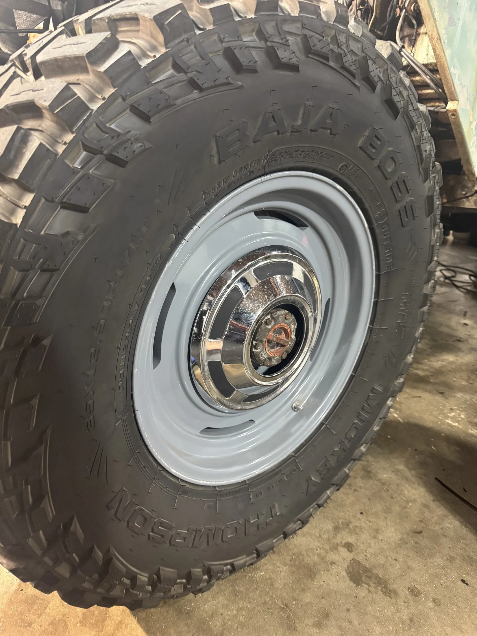

Just run spacers in the front?
My only gripe about spacers on the front is my lockout will be inside my hubcap due to my wheel setup. Currently flush
Is that with a spacer now?

No spacer now. The wheels are pretty thick. 17x9 Fifteen52 aluminum.

Ok I see what you are saying now. If you put spacers on it will be wayy inside the hubcap.
