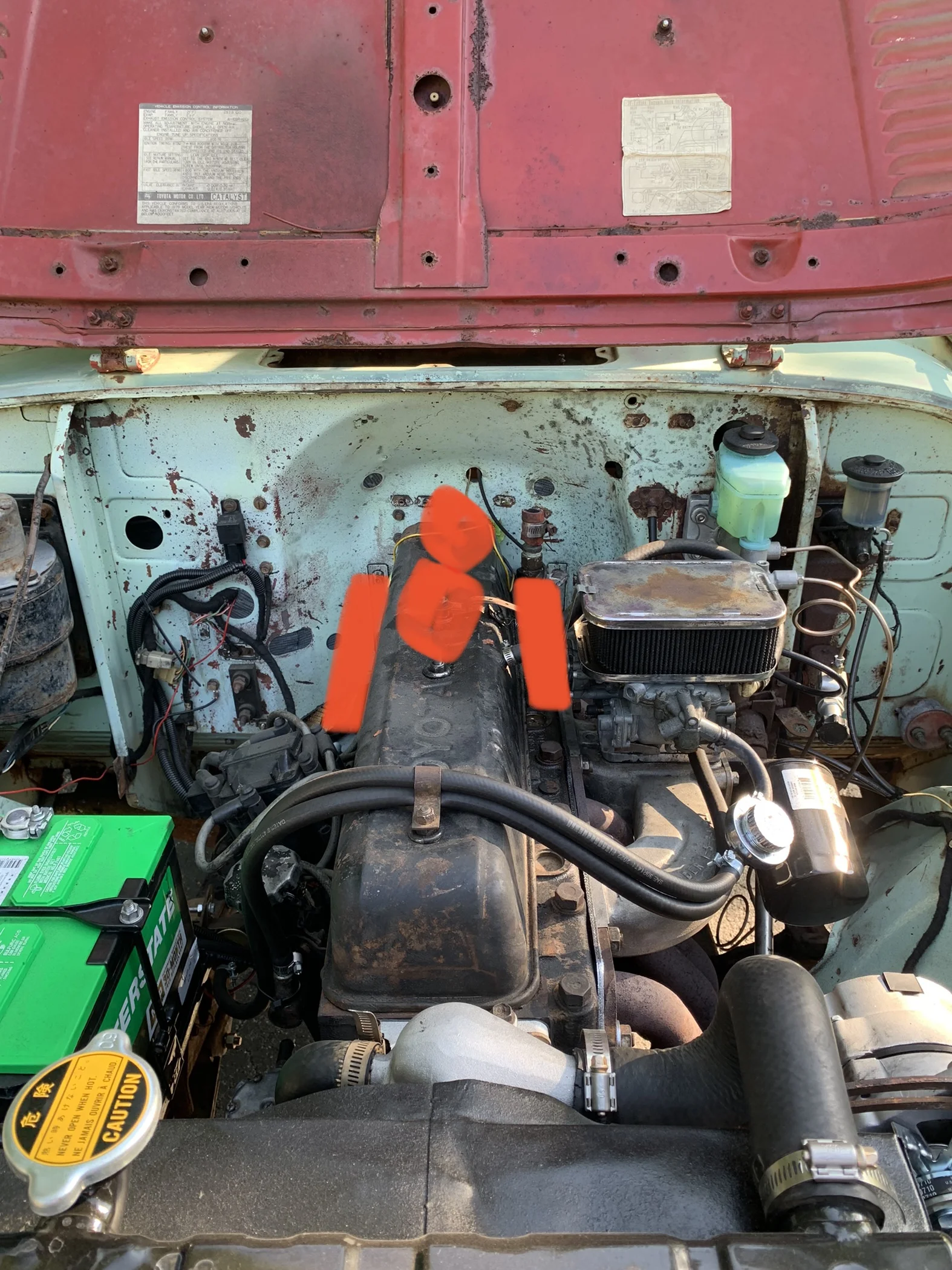

Hand drawn art for better description of where it was leaking before. The head had standing oil on it on the driver side above the manifolds.

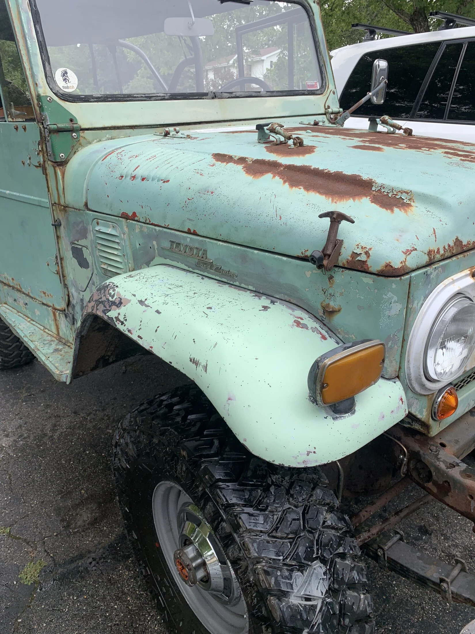

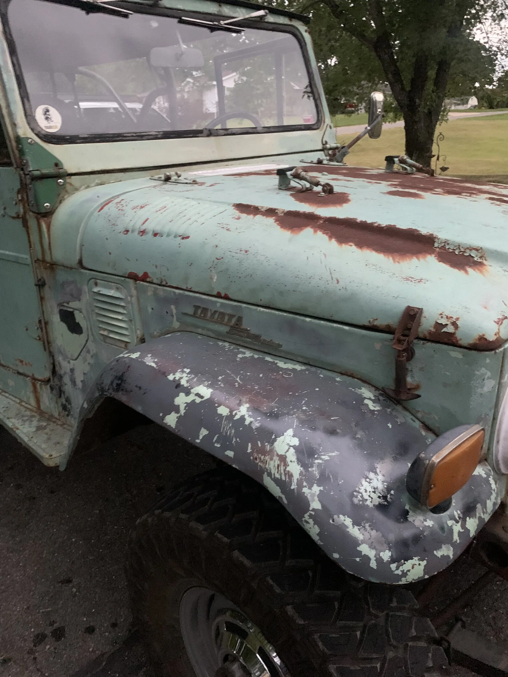

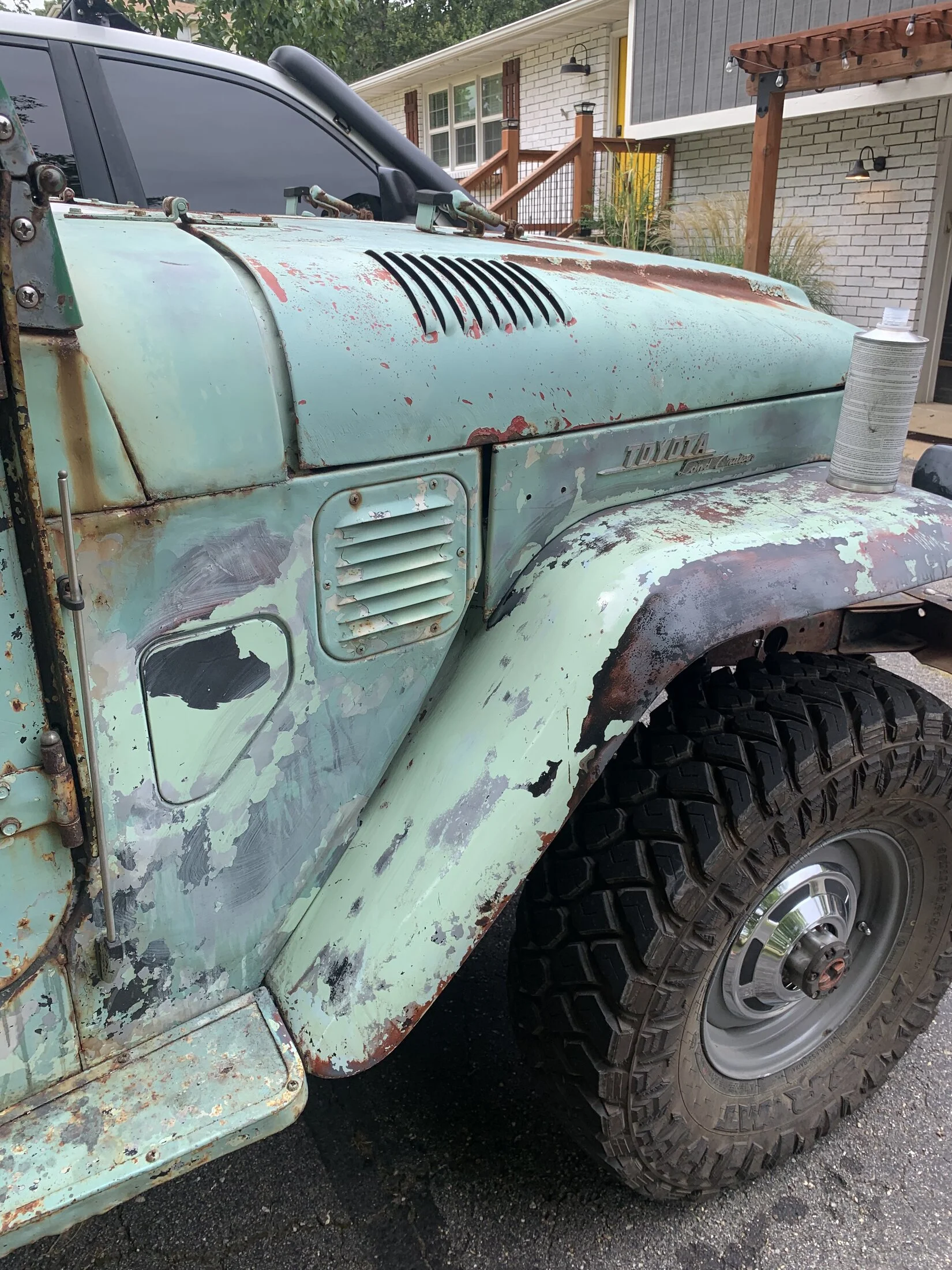

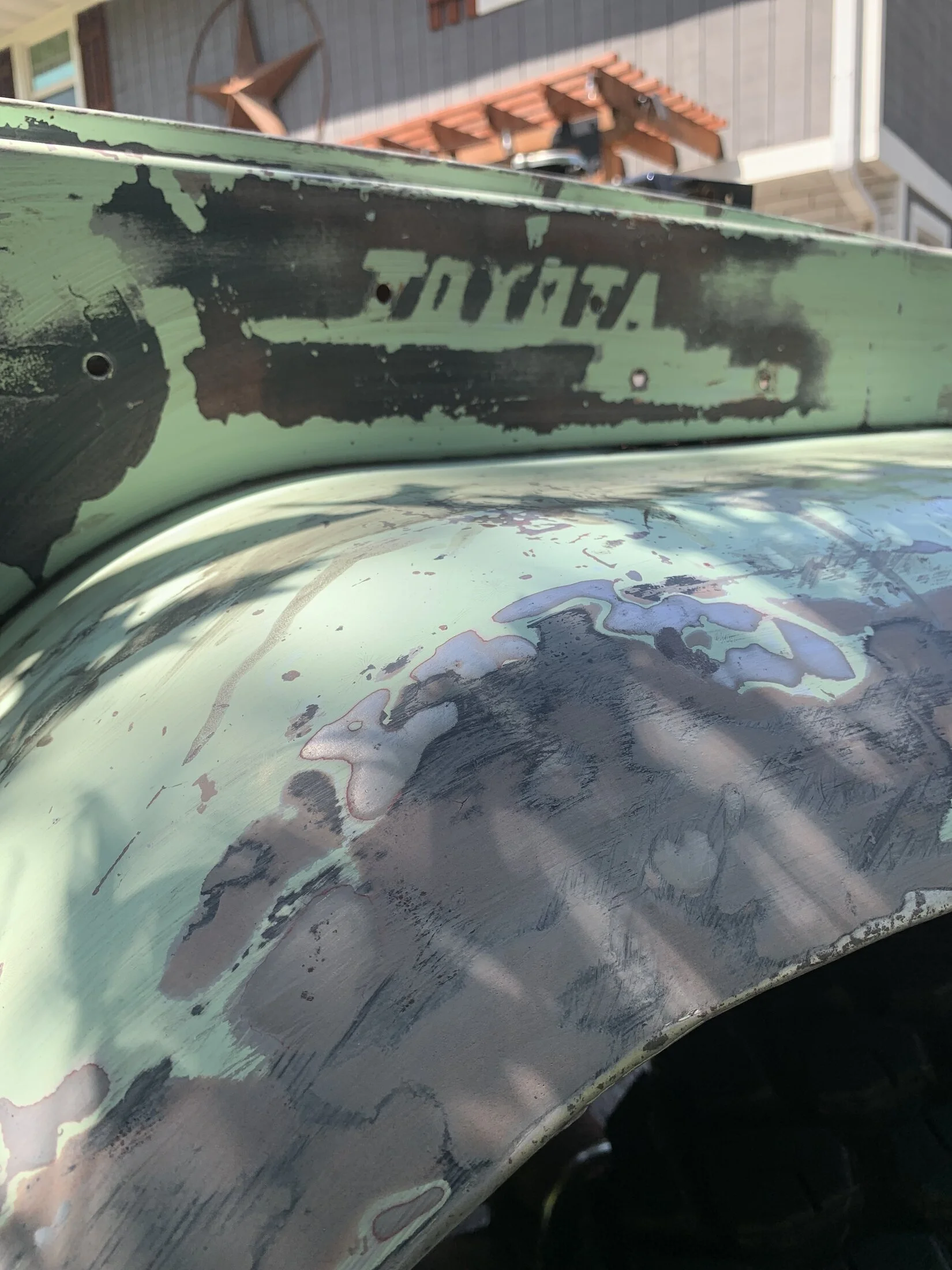

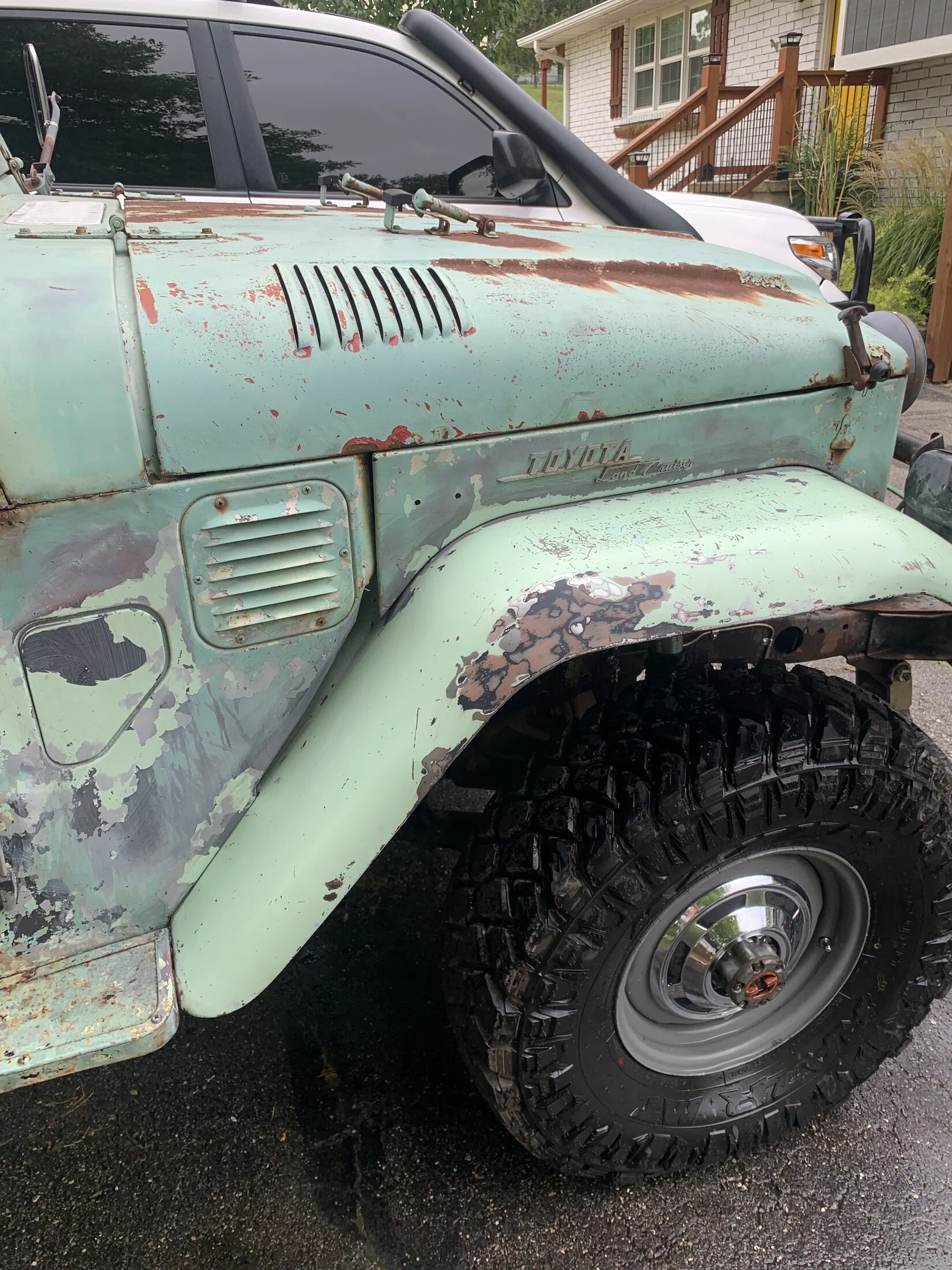

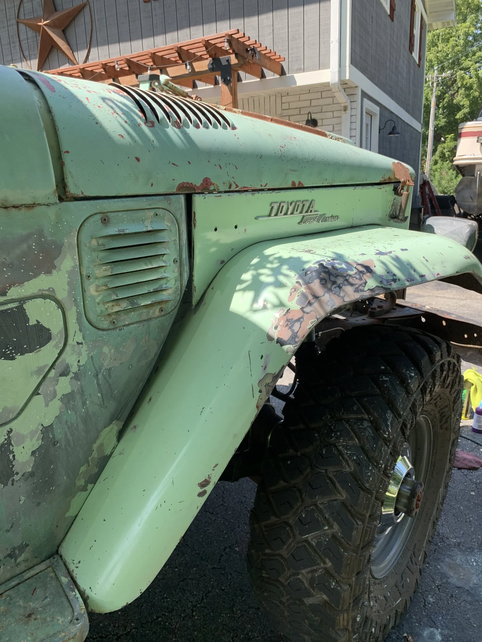

Ended up removing the three coats of paint off the passenger fender to get back to the original paint.
Eventually I will do the entire 40. It’ll take a while. I think I used a quart of medium reducer on this fender.

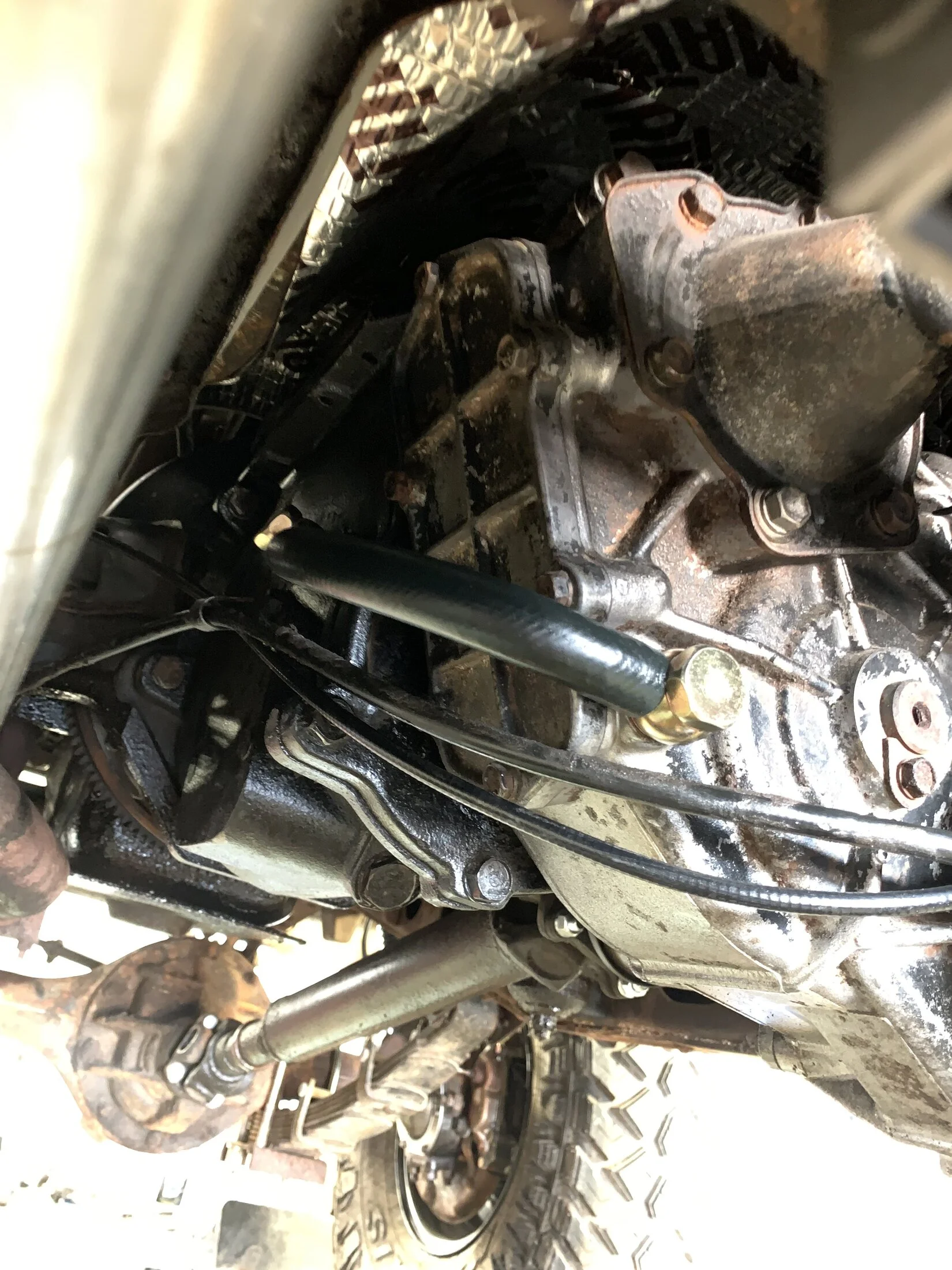

I also stole a parts list from @mattressking and got the fittings I needed for the transmission and transfer case fill plug equalizer hose. Flushed the fluids in both and filled with fresh lube.

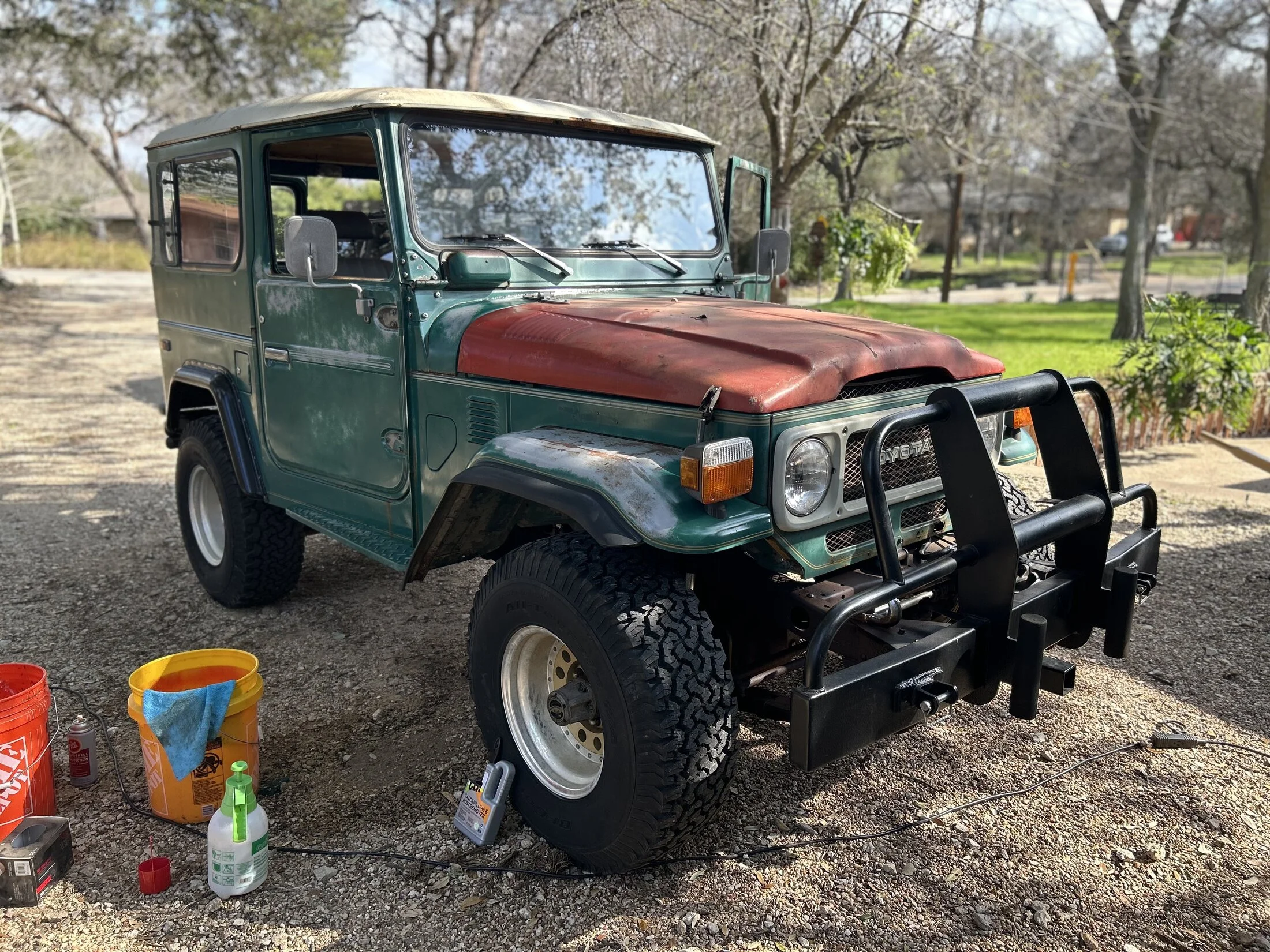

I honestly wish I had a free weekend. 2 gallons of reducer and a case of beer. I cannot wait to bring the rest back. The hood will be a different story as it is factory Red. I’m going to try and paint match it best I can when I get to that point.
Too bad we aren’t closer, I’ve got a few buckets of elbow grease and just happen to enjoy beer.
I had an interim hood that was red on my rustic green (since found a match and sold the red one to Nolan) and my son won’t stop begging me to paint this one red… need to ask my wife if we dropped him on his head or something.
