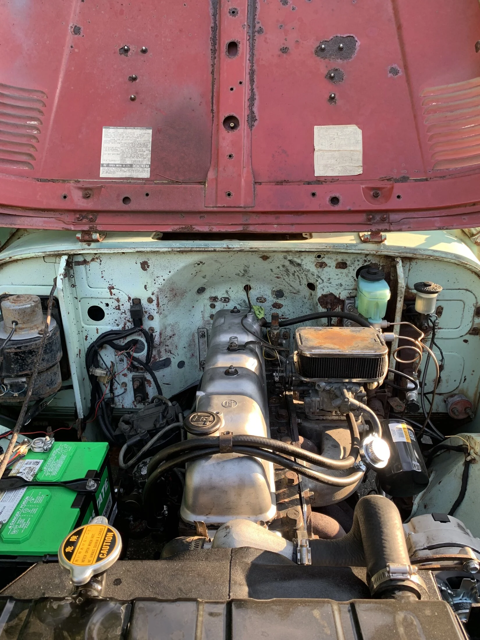

Bypass fuel filter helped a bunch. As did installing one step larger Air Correction jets.
Baselined the carb and started from scratch.
Set timing to 11*
Idle at around 700 and change
Solid 15 vac
I’m at 10,000’ so yeah.
It does, manual choke. Still doesn’t idle worth a crap.
Honestly no clue on timing. It doesn’t spark knock, starts good, doesn’t diesel when you shut it off. I actually haven’t touched the ignition side of this rig other than to hook up coil power. (HEI distributor was in it when I bought it) I haven’t even changed the spark plugs that were in it from at least 2004.. (maybe I should)

I will say there has been no single thing that improved my Weber functionality but it is greatly improved.
Valve adjustments were the greatest single player,
But the bypass fuel filter (from a late 70’s early 80’s Jeep 🤮) was like $9 at O’reillys and contributed significantly. Even though you are at a lower elevation, I would take a look at your jets. Since you can’t idle I would assume your idle jets are clogged or sized wrong.
Getting a feel for the lean drop on these carbs isn’t hard, it’s just annoying, but necessary.
I arrived at 11* advanced by a lot of back and forth, I’ll probably increase my air correctors by one more size then do all the lean drop and advance dance again to see where I end up.
Again, I’m currently at 10,000’ and will be traveling down to 8k and up to 13+k so my jetting is different.
Also, I know this sounds dumb, but swap out your current fuel filter for a fresh one. I kept overlooking that small item. They’re cheap but get dirty fast.

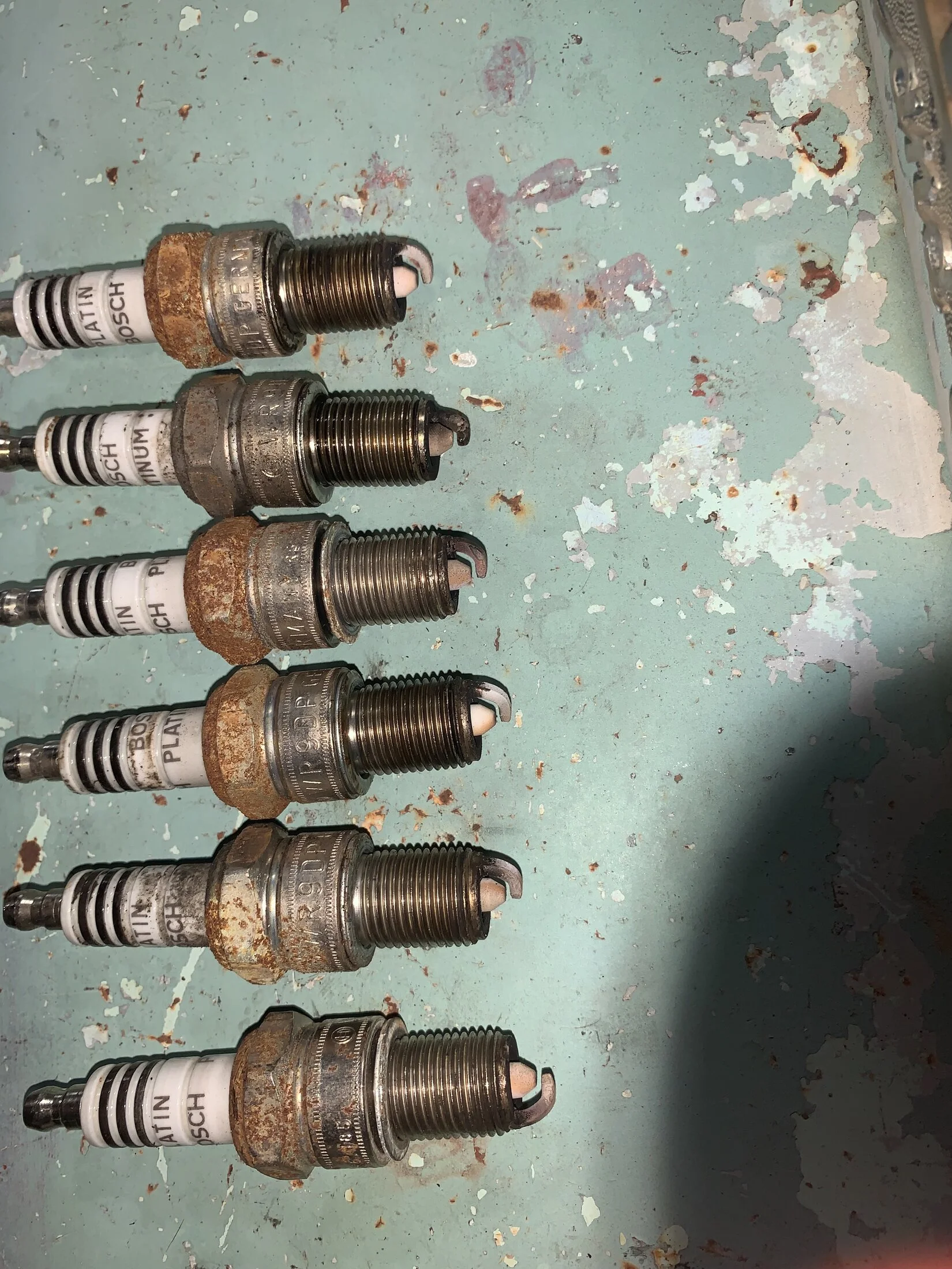

So before I left work today I threw in a new set of plugs. They are autolite “56” basically one step cooler than the 65s mine calls for. The ones I put in are new old stock off our shelf from probably the 80s.
Then I reset the car idle air mixture screws and it runs 200% better. I guess the plugs were just trash even though if you’d look at them you would think they were ran border line lean.
I still haven’t checked timing, or vacuum/ advance. But it runs so much better I’m afraid to mess with anything else.
No joke feels like it picked up 20hp.
Old plugs. Bottom is #1 plug, top is #6
Those look decent from here; your carb jetting is close to spot-on.
