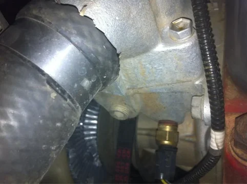

Found this old pic. That's how I ran it for several years. I checked the date on my pictures and the header gasket has been holding for 5.75 years!! :knocks on wood:
Yeah that wouldn't be a 2f gasket. I usually leave both valves in the water neck. Hate draining the water out if I dont have to.
