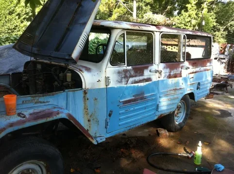

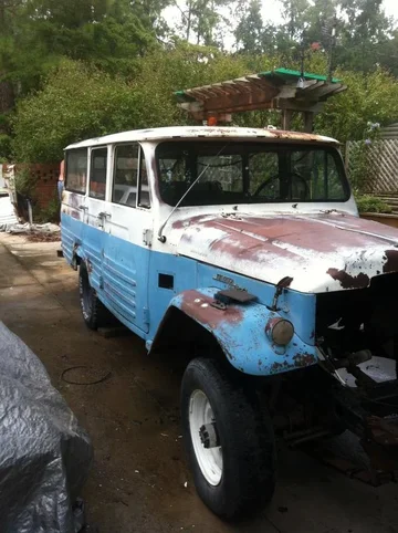

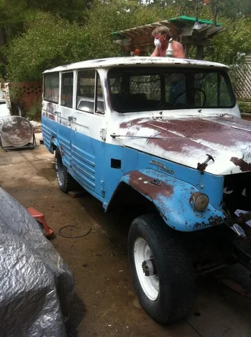

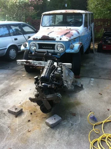

This weekend Steve-O and I decided to give the old LV we drug back from Casper, WY this past Jan. some love :D

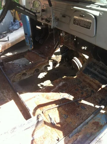

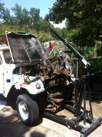

We replaced the locked up F engine with the one I removed from my 45 (it originally was in Richards piggy way back when), replaced the front floor pans since the LV was a Flinestones mobile, did lots of pressure washing of the frame and undersided, and finally used CLR/warm water to remove the rust and associated stains that the old girl had acquired since relocateing to the South... topped it off with a couple applications of wax. Our goal is to keep the old girl original looking with a "Rat Rod" flare, hence perserving the patina look :beer:
The day we picked her up
New engine, notice the hot rod upgrade :hillbilly:
Out with the old...

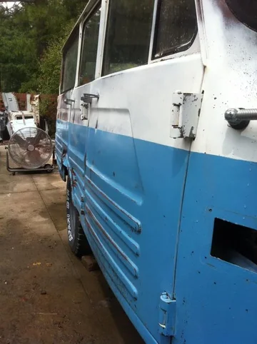

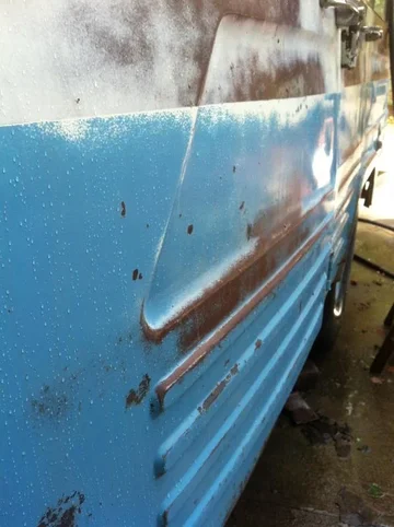

Restoring the patina. Found a method on a VW bus site for removing rust stains and bringing back the faded paint.... it was pretty simple use CLR mixed water and Scotch Brite green pads to scrub. It removes old rust like a charm. We added a couple of layers of wax to breath a little life back into the old paint and protect against rust coming back.
I know this look isn't for everyone, but we really like the faded/ patina look of the old girl and decided to keep her that way.
Test panel on drivers door
Pass. side before
CLR in action
