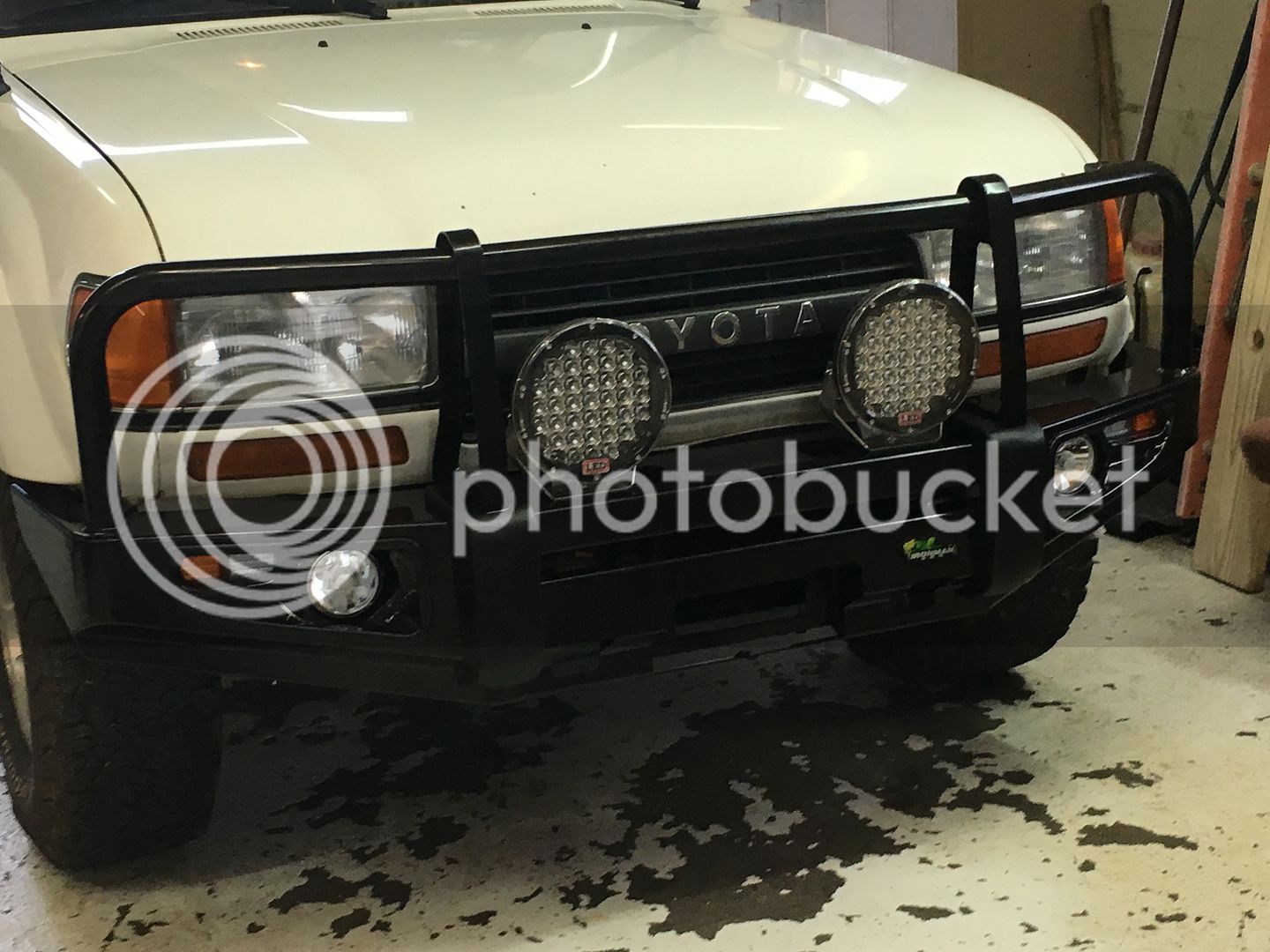

Ironman Comercial Deluxe bumper and some ARB Intensity Knock Offs.
Are they bright, Bright or BRIGHT?
