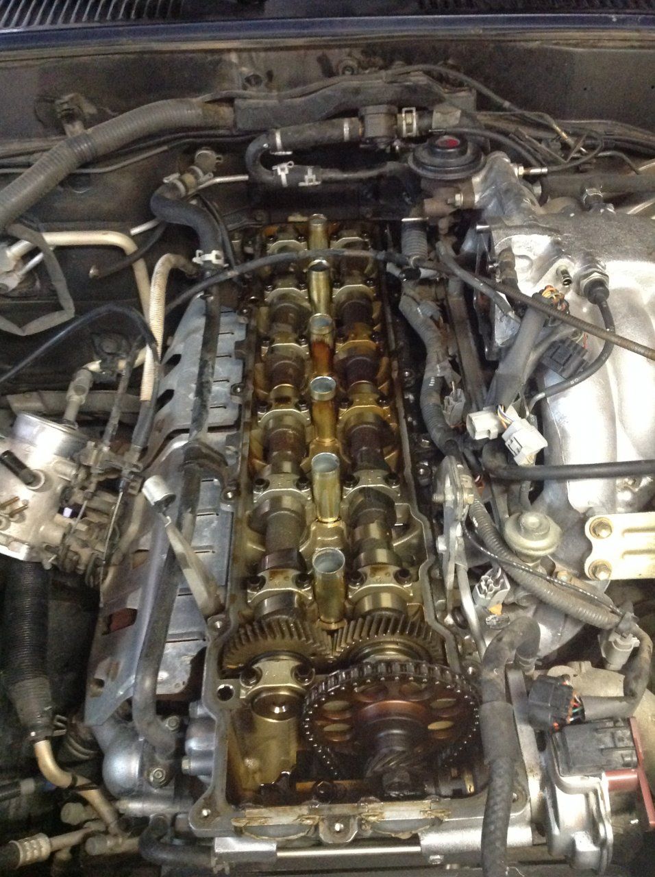

You probably have a different edition of the FSM. I do it differently than you do.
It's barely a "while you're in there" thing. The valve cover was leaking and I was frustrated so I figured there was no time like the present.
