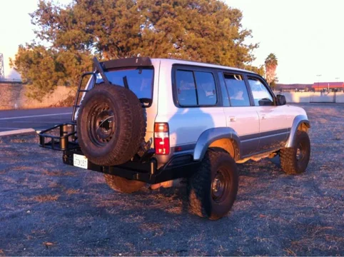

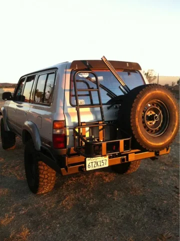

Breaking in some Cooper AT 3 tires in this crazy freaking snowicane were getting high in the northern Appalachians! Next tire. Not so cool looking like a typical mud tire. But very functional. Running 285/75/16 on heavy OME Stock height.
Was that a local CO truck? I feel I have seen it parked up at the top of Middle St. Vrain trail before. Looks great!
Thanks. Shipped it from SC last week. Haven't been up that way yet but would love to check it out!
