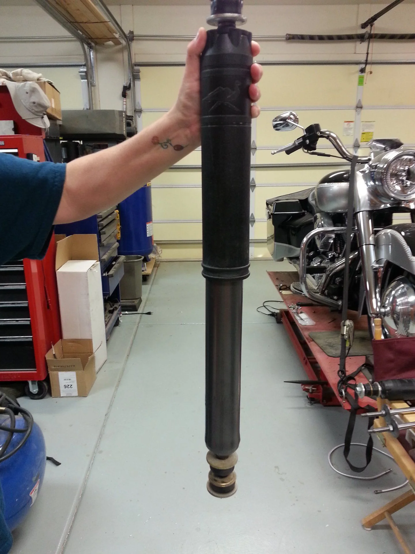

Began with repainting the shocks that came with the lift purchased from jp_waltz. To do that I had to figure out how to get the plastic dust boots off without destroying them.
Before
After

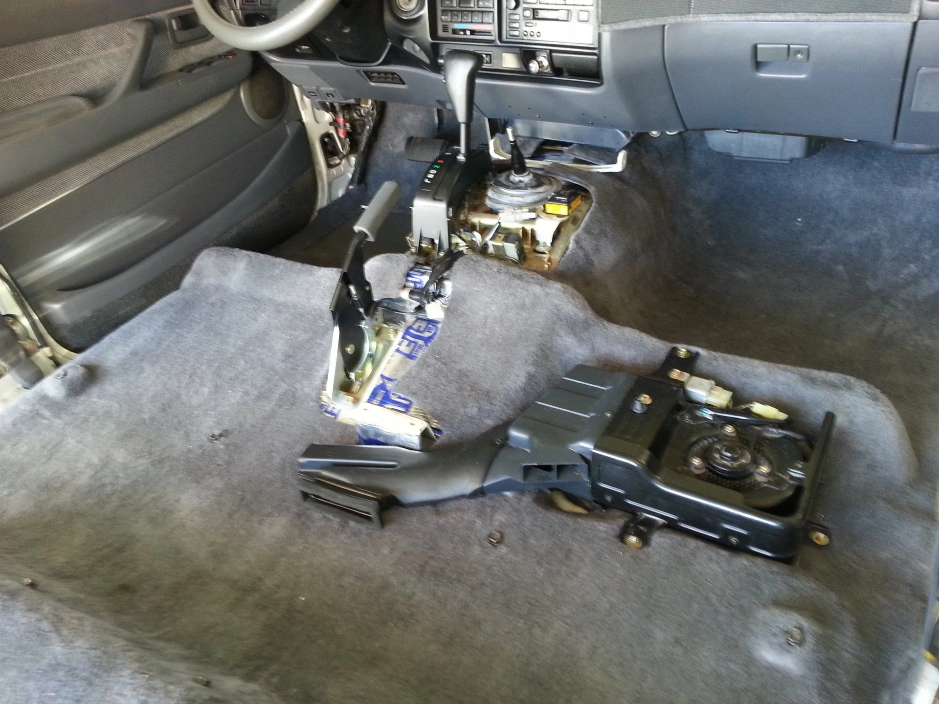

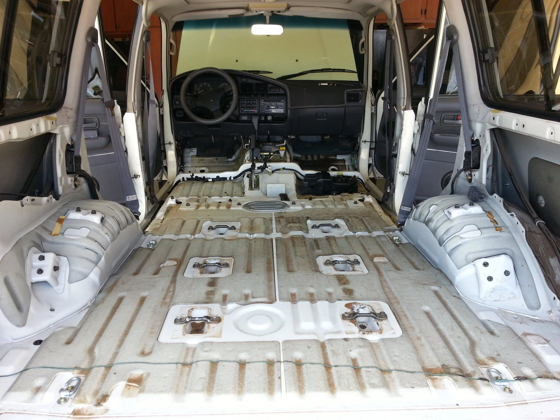

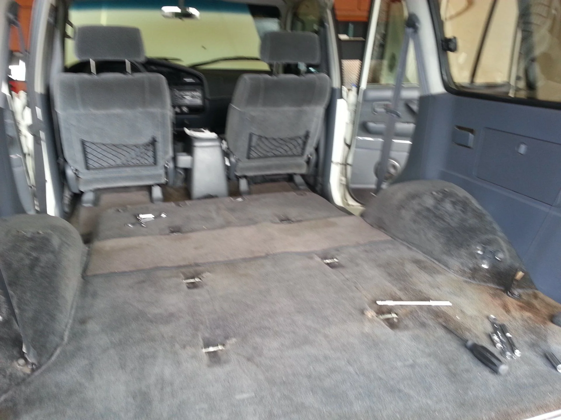

Had to do something between paint coats so decided to gut the 80 for the new carpet.
Laid in some sound deadening...

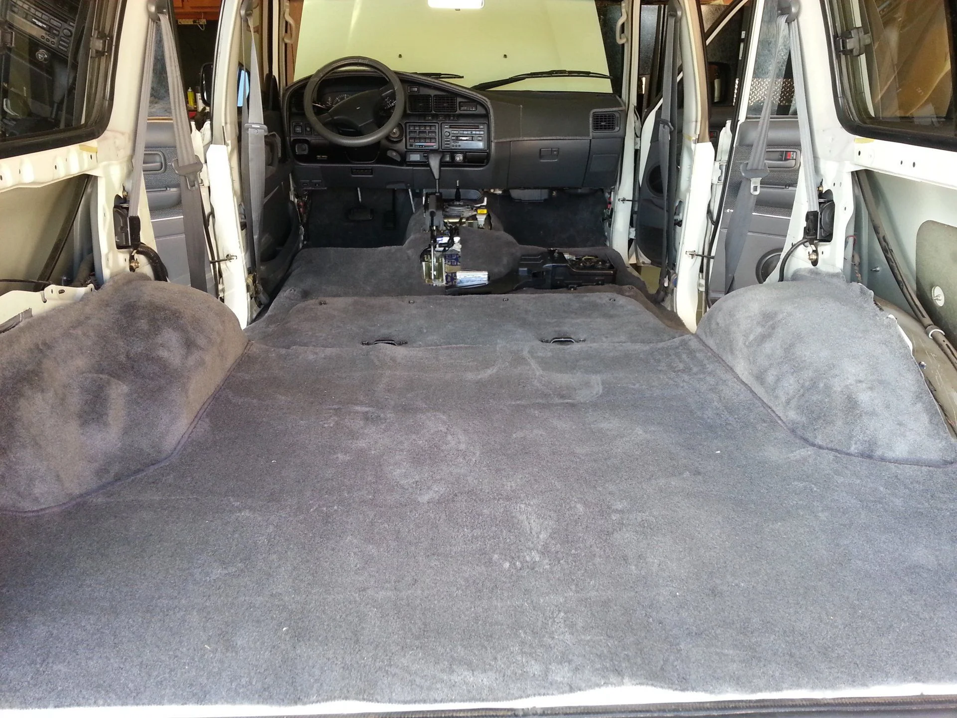

Followed by some new plush pile...
Quick tip- When your gutting everything, put the bolts back in the holes.
It will make finding the bolts/holes with the new carpet much easier. Just feel for the bump and run your razor knife around the head of the bolt and wha-la..perfect location every time.
Still have to put the seats/panels back and repaint the console/s but have some things to run fore and aft before I do that and a trip to the supply house for a buttload of new panel clips. Saved all but 2 but they are very brittle so new ones seem warranted.
Before
After
