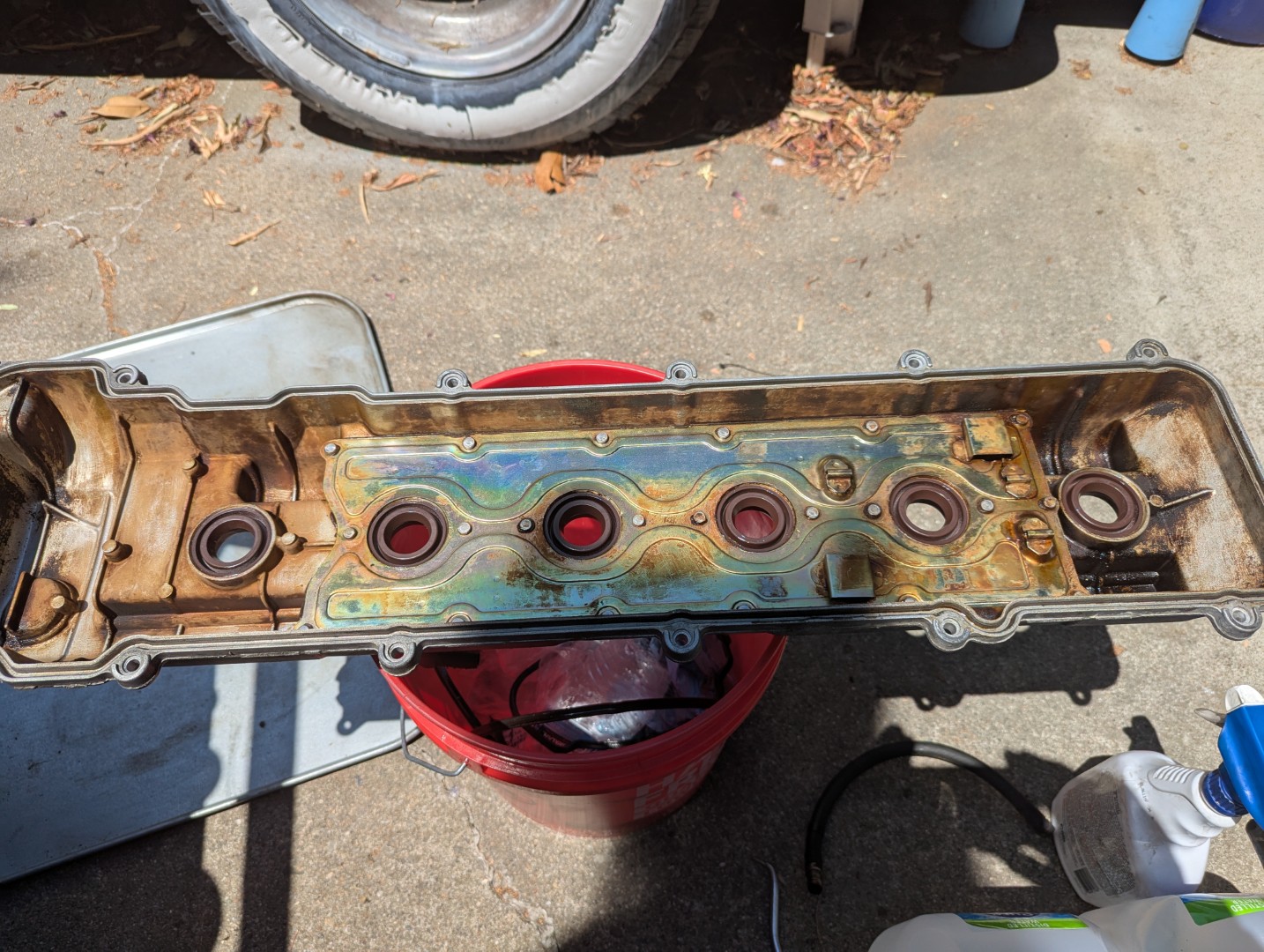

Started yesterday. Time to replace the spark plug tube seals in the valve cover along with a few gaskets, grommets etc.
First step is to remove a bunch of stuff to get easier access and then pull the valve cover.
Removed the old seals and tapped in the new.
I used an old seal as a 'tool' to tap the new seals in. Cleaned out the groove and installed a fresh valve cover gasket (not installed yet).
Valve cover back in place. Replaced the dizzy rotor and put on a new cover and gasket. New plug wires going to go in also.
Some of the new parts. Did this job 10+ years ago, hopefully I'm still capable of doing this job again in another 10 years :)
Need a few more bits and will start to put things back in place over the next days as I get time. Will flush the coolant system and replace brake pads and flush.
Should all be good to go for late summer/fall camping trips.

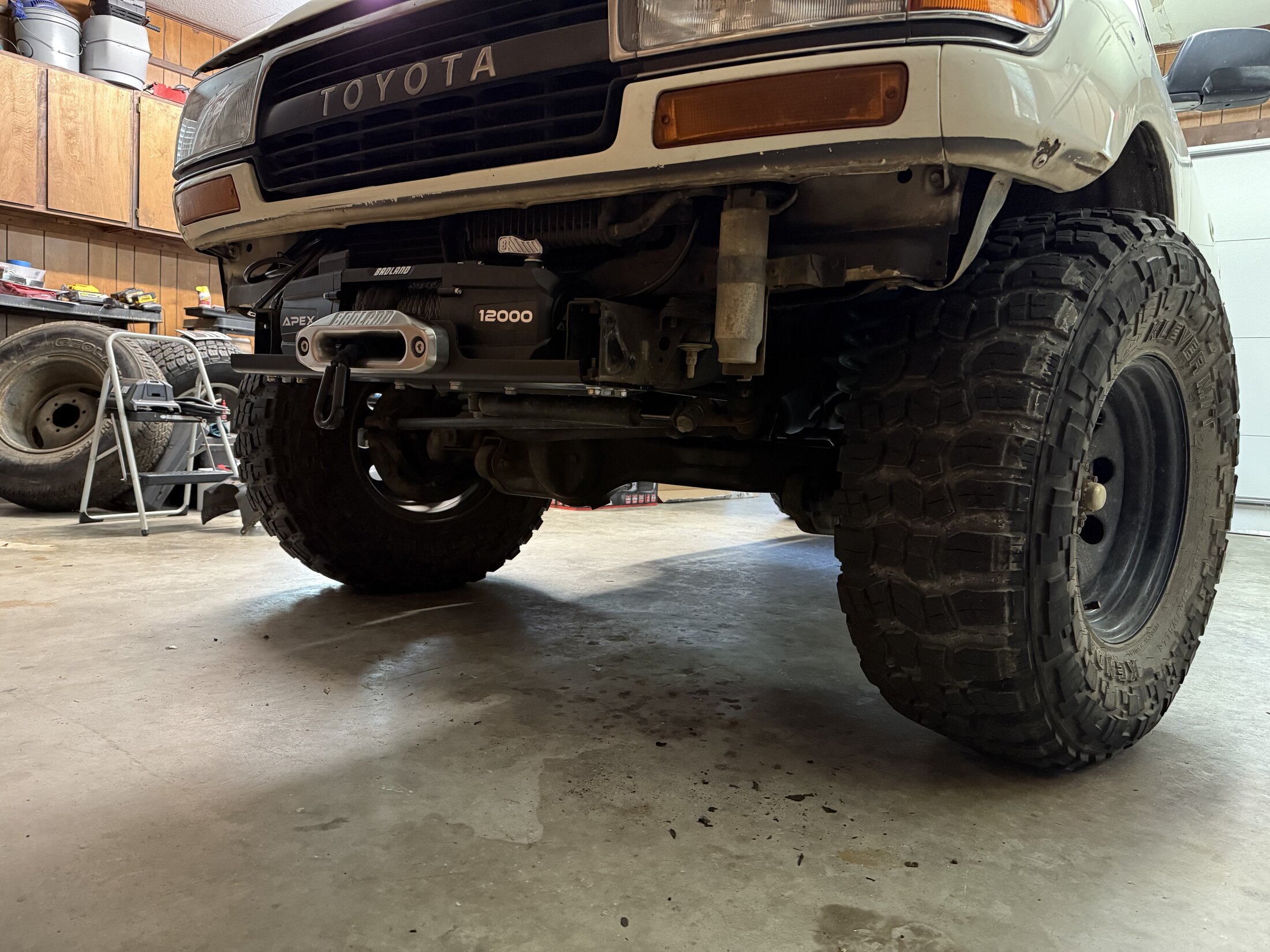

Installed an Apex 12000lb winch on a HF universal winch plate. It took some cutting and drilling but it's in! The control pack is going to take a bit more fiddling to get in a permanent spot. Right now it's just sitting in between the coolant overflow tank and air filter box. I'm thinking about getting a thin piece of sheet metal bent to attach to the inner fender well to hold it. I installed with the intention of re-attaching the factory bumper but I'm liking the look as is.
That looks great, almost stock.

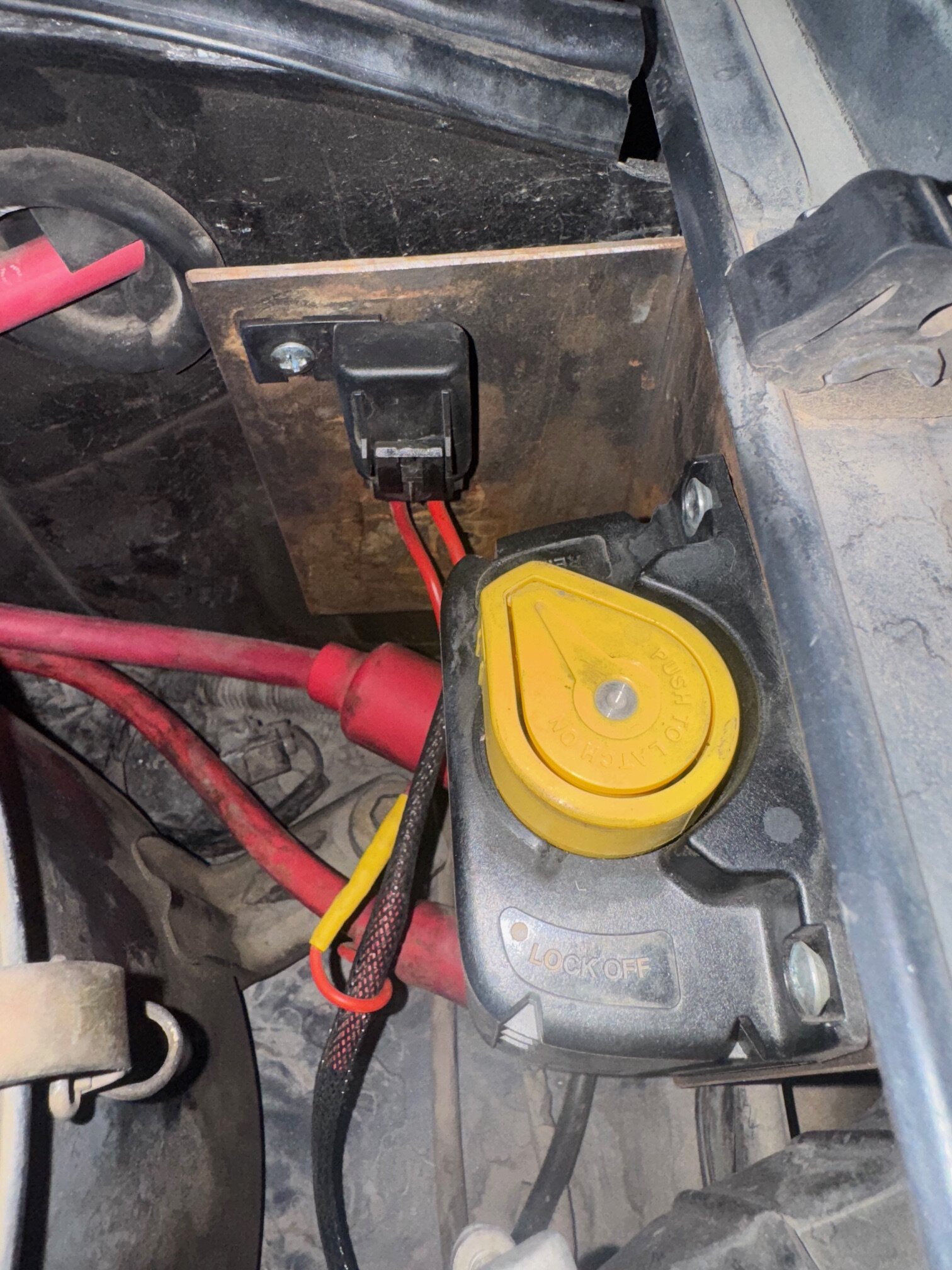

For the Apex 12K Winch solenoid pack, I removed it from the housing. You can get smaller generic housings on Amazon, but I didn't think it is needed.
The housing isn't really waterproof anyway, but the solenoid pack itself appears to be. I tucked it behind my bumper. I still need to extend the wireless switch and connector.

I moved mine up into the eng. bay. I don't want it getting wet.

Very cool! I might look into doing this. The control pack seems unnecessarily large for sure!
