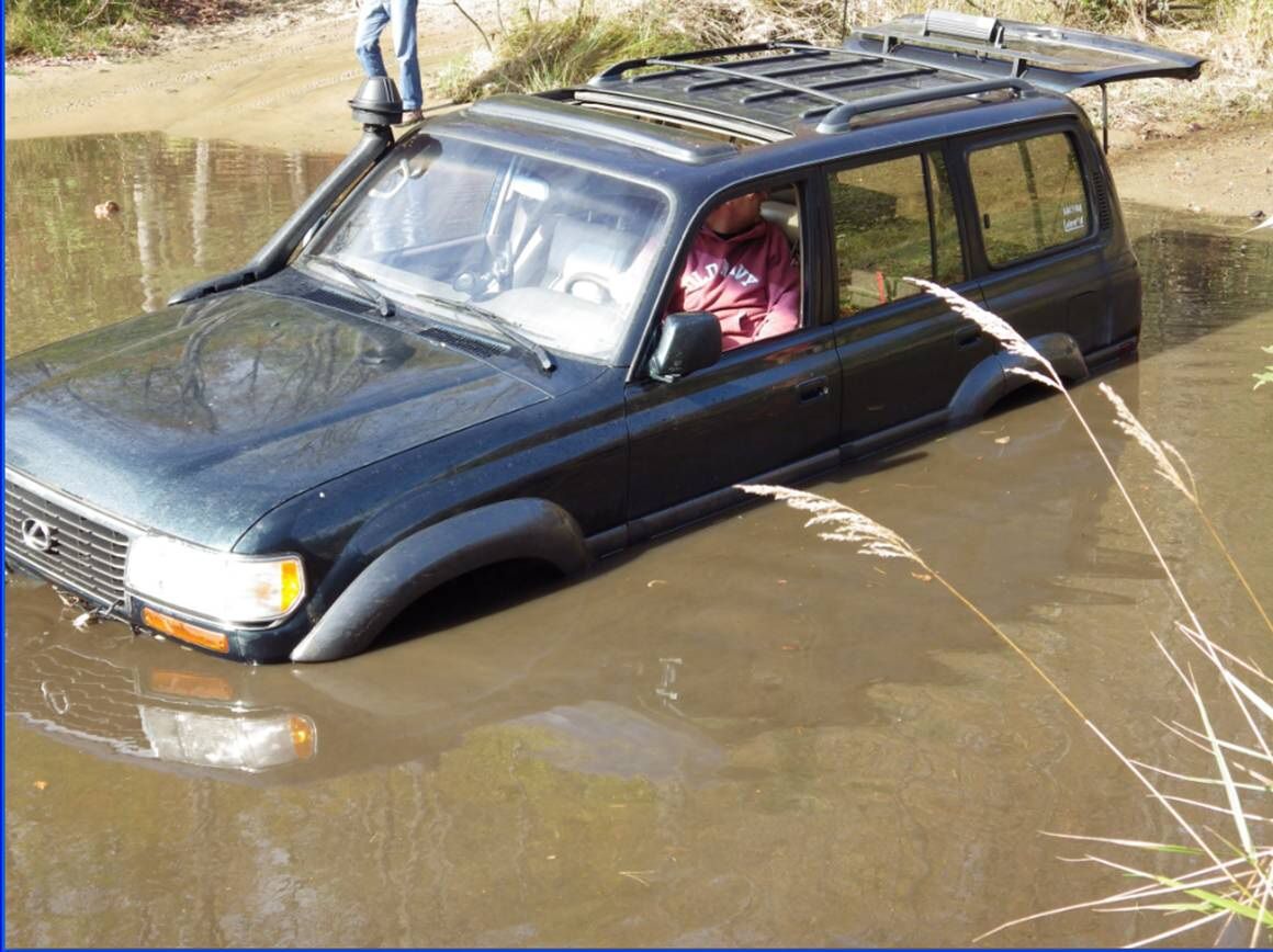

Went off roading with a few members of our local Cruiser club and had to finally try crossing this notorious section of water formed by a small creek. Tried to pull me from the front with the Bubba rope. Didn't work, so I got winched out from behind. No water was coming in until I was tugged with the Bubba rope. Engine stalled after I tried a few reverse/ forward manoeuvres, but I just dug myself in deeper. Engine started right up, but was idling rough for about half an hour. Looks like I'll be changing some fluids as well as removing the carpets for a good cleaning.

You got stuck with a snorkel? How is that possible? Dizzy got wet?

The dizzy is the first weak point with 3 holes in the base way before the snorkel comes into effect when it comes to water crossing.

Yes, the dizzy got wet. Even had a couple small twigs stuck on the valve cover. The entire engine compartment is covered in dirt.

Is there a safe way of waterproofing the dizzy write-up somewhere?

Plug 1 of the 3 holes
Use 1 hole and a line for fresh intake
Use the last hole and a line connected to your air cleaner
Warning - When water level is above the body line it begins to come inside, snorkel equipped or not!
