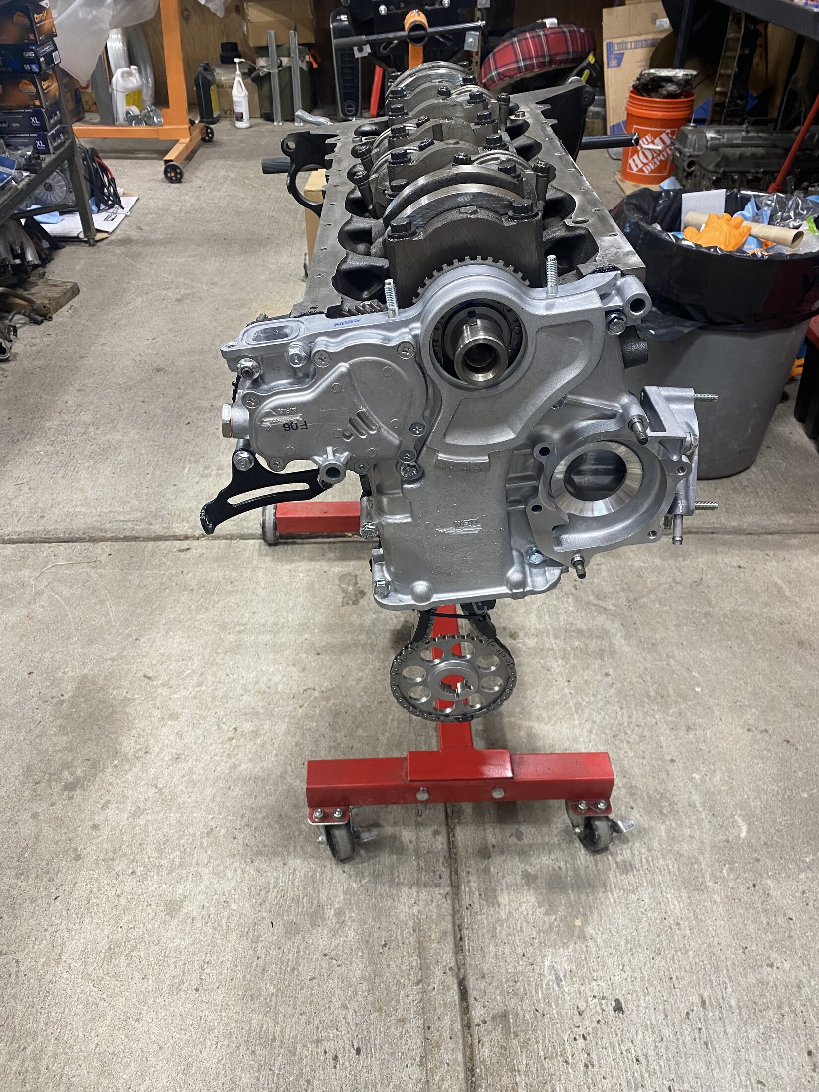

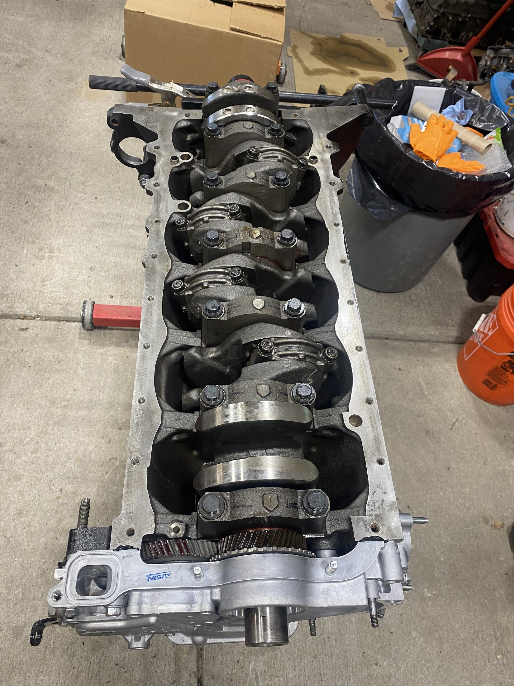

Are you using oversized pistons in all your rebuilds or just this one? I saw the .50 on the piston and was curious. Does Toyota make a flat top piston if so why not use them, or is there not enough valve clearance.
All rebuilds get bored with new .50mm pistons. Toyota does not offer a flat top piston.
