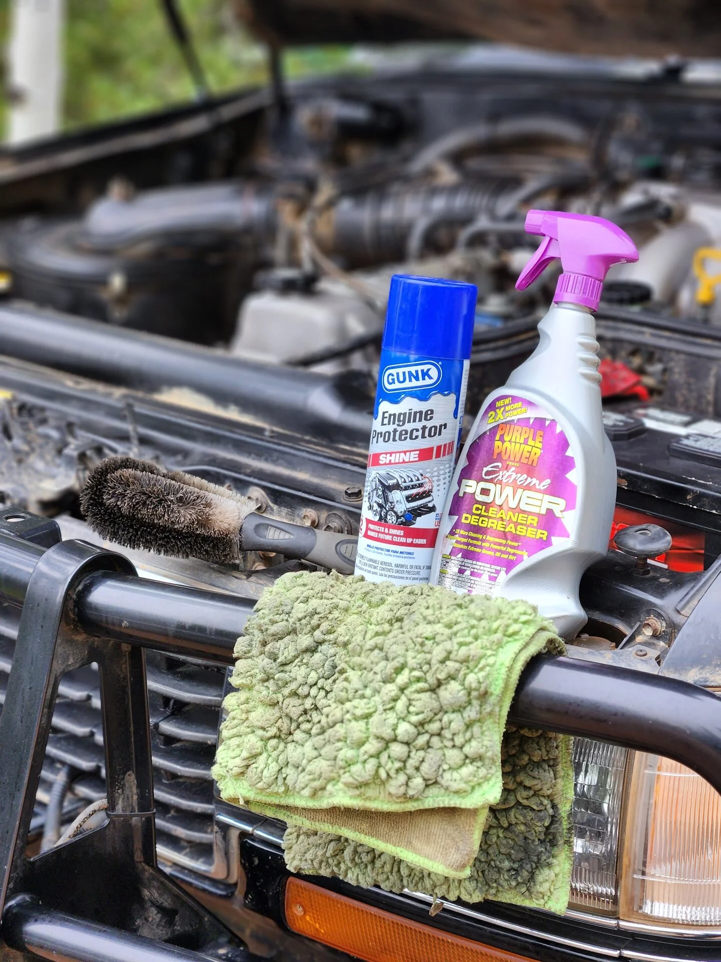

I drew inspiration from the YouTube channel Legit Steet Cars in which the host often cleans their engines in a similar manner.
Supplies:
- "The Purple Stuff"
- A round brush
- Gunk Engine Protector
- One of those microfiber towels with a coarse side
- Garden hose (not pictured)
- Eye protection (Do NOT get "The Purple Stuff" in your eyes - I cannot stress this enough)
- Gloves
- Plastic bags
I started out by covering the distributor and battery with some bags. As I wasn't using a pressure washer or spraying directly at it, I left the alternator exposed.
Next was thorough application of degreaser, followed by gentle agitation with the brush. Don't need to use a ton of pressure, just loosen everything up and let those harsh chemicals do their job. Once everything is degreased and scrubbed, follow that up with the garden hose with a tight fan spray pattern. The goal isn't to pressure wash but rather rinse all the degreaser away and the schmoo with it. I did this process twice, as I missed a bunch of spots the first time around and some of that filth was really caked on.
After the second degrease/scrub/rinse cycle I patted everything dry with the towel, removed the plastic bags, and wiped off the distributor and battery with the now damp towel. That was followed up with a thorough application of the engine protector stuff and another wipe down.
All in all the end result seen took me about 45 minutes.
Once everything was done I fired it up, let it idle for a few minutes while I cleaned up, then drove it for a bit to bring it all up to temperature and evaporate any lingering water.
This was intended to be more of a functional clean over a full detail, there are a bunch of places I could have done better but didn't feel like putting in the elbow grease. I understand there are a lot of different methods and products available, this is just how I did it.
Purple power darkens/blackens aluminum FYI. Simple Green does not.
