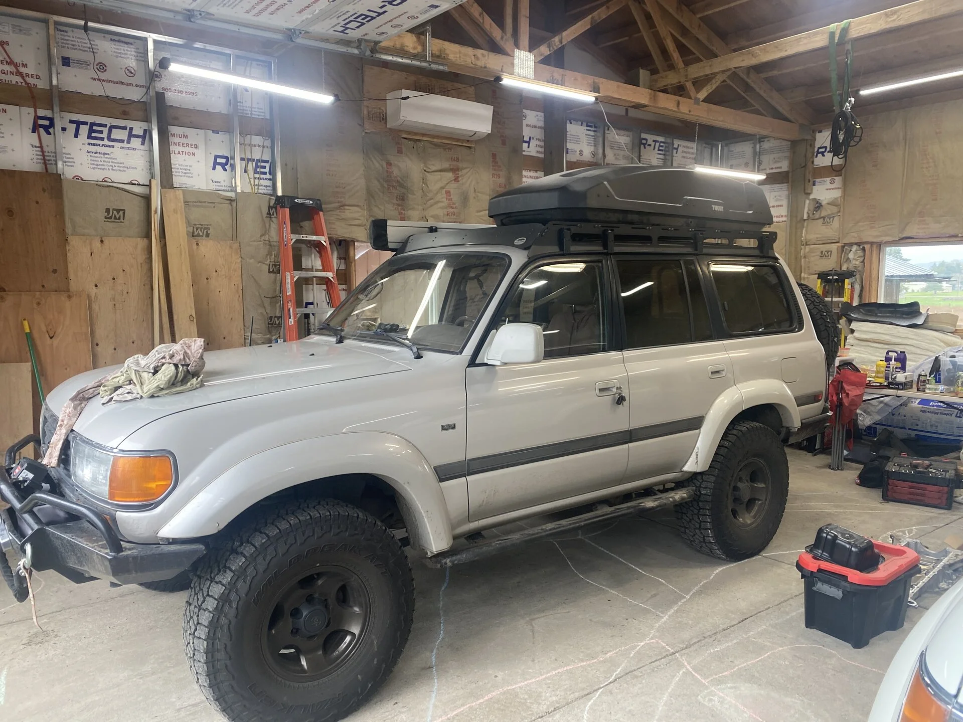

Please educate us on this nice little device. 😊. I think I have those same handles that you have on your roof rack (is it a table?) I put them on my Pinsu rack which is similar to the Bowfin you have. Have to say the Bowfin looks like a nicer design due to the clamps.
The handles on the upper bar are a slide for my Hobie. Made with t-slot extrusion. This bar releases with a latch from the rear and extends to the ground on the front side once extended out to help support the weight of the kayak when loading solo(hopefully lol) due to weather I have yet to test it. Added a couple handles to help pull it in and out. Both front and rear supports are independent so I can support the front kayak on that slide with ground support and lift the rear and slide the rear rail out under the kayak to load it up.
Fingers crossed it will work but if not I will just add a brace under the bowfin so the slide won't bust loose from the weight and crash down on me....
The spread works perfect to allow a 200w panel to sit right in the middle. Ill add a write-up in my build once I know it works...
These racks are a bit heavy but so user friendly and well made.

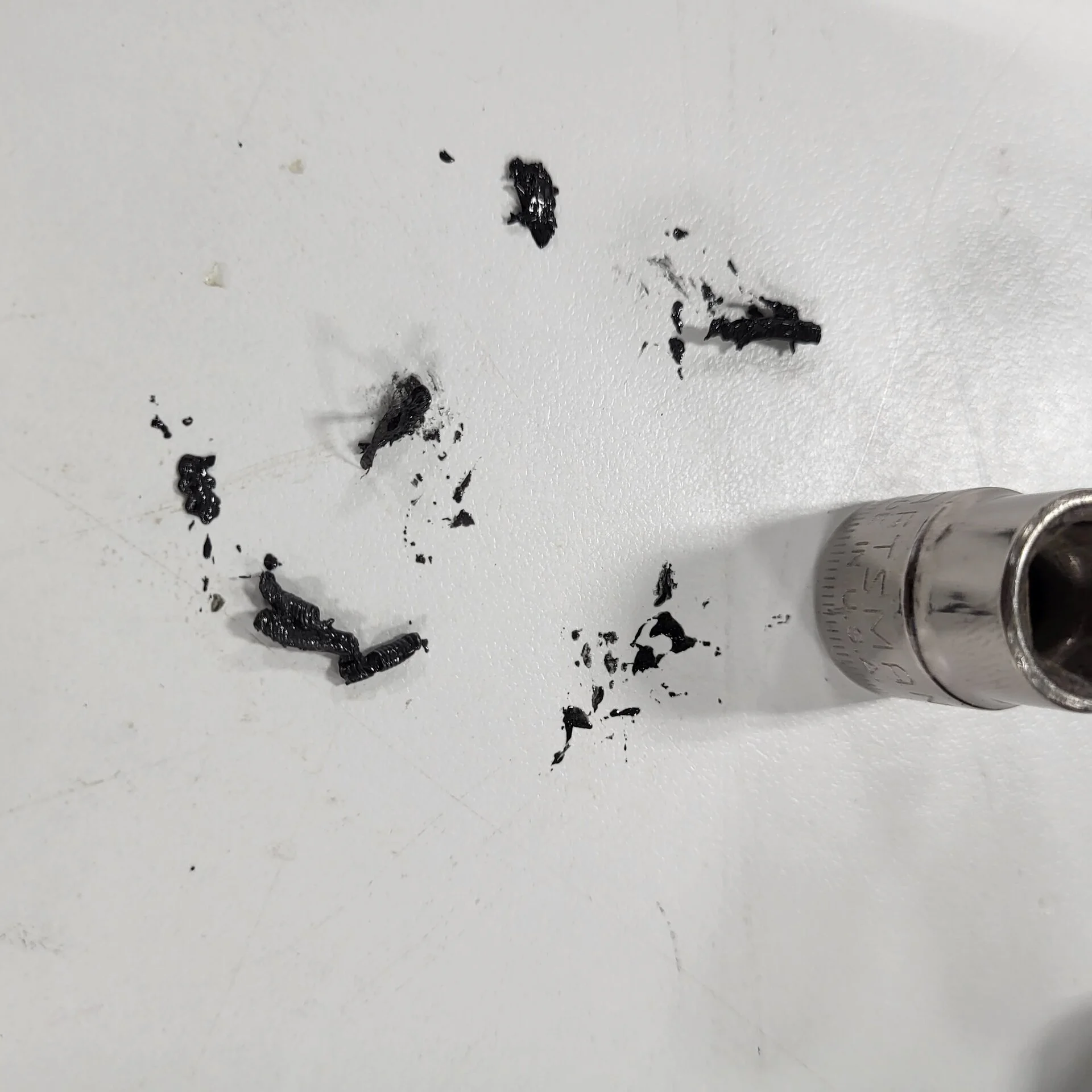

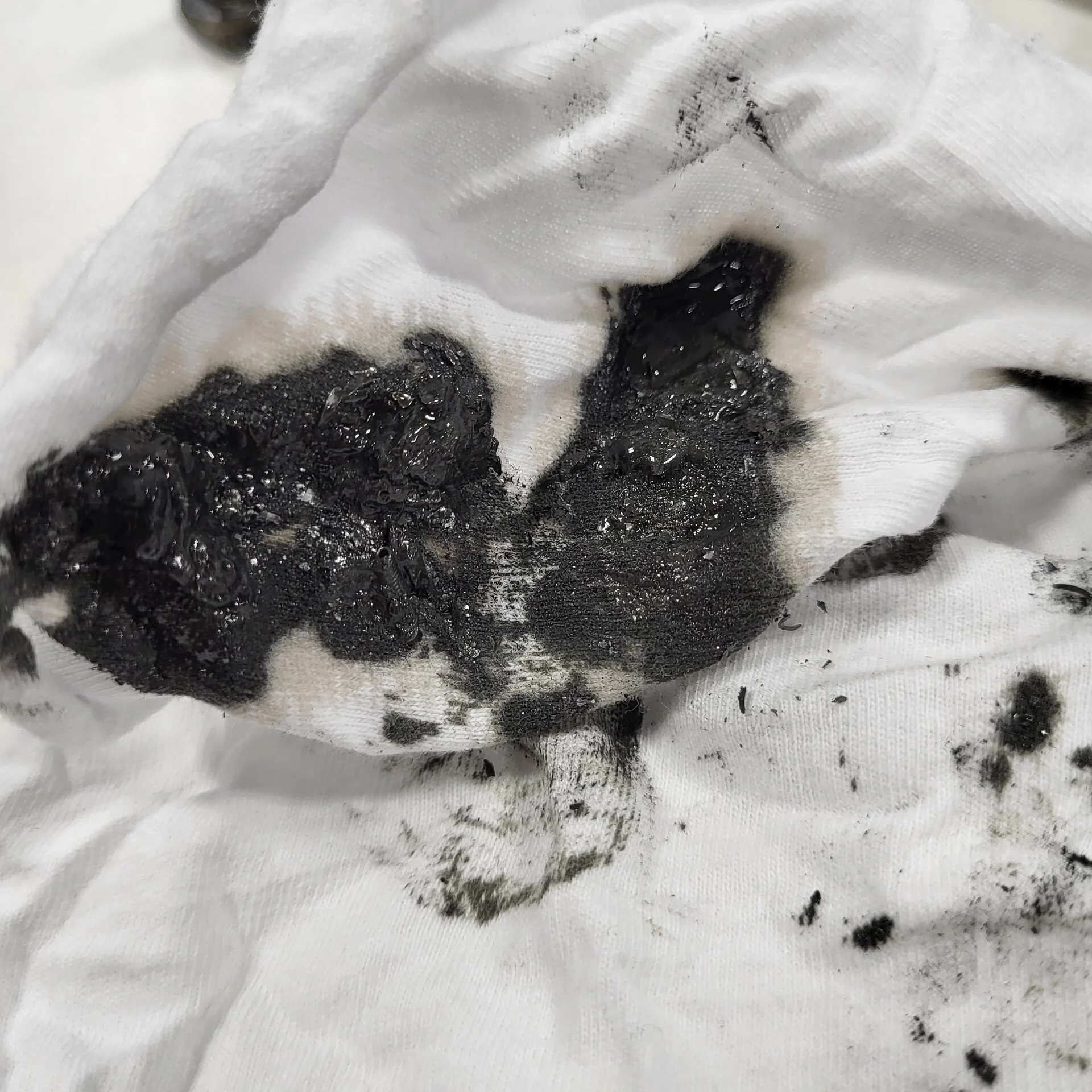

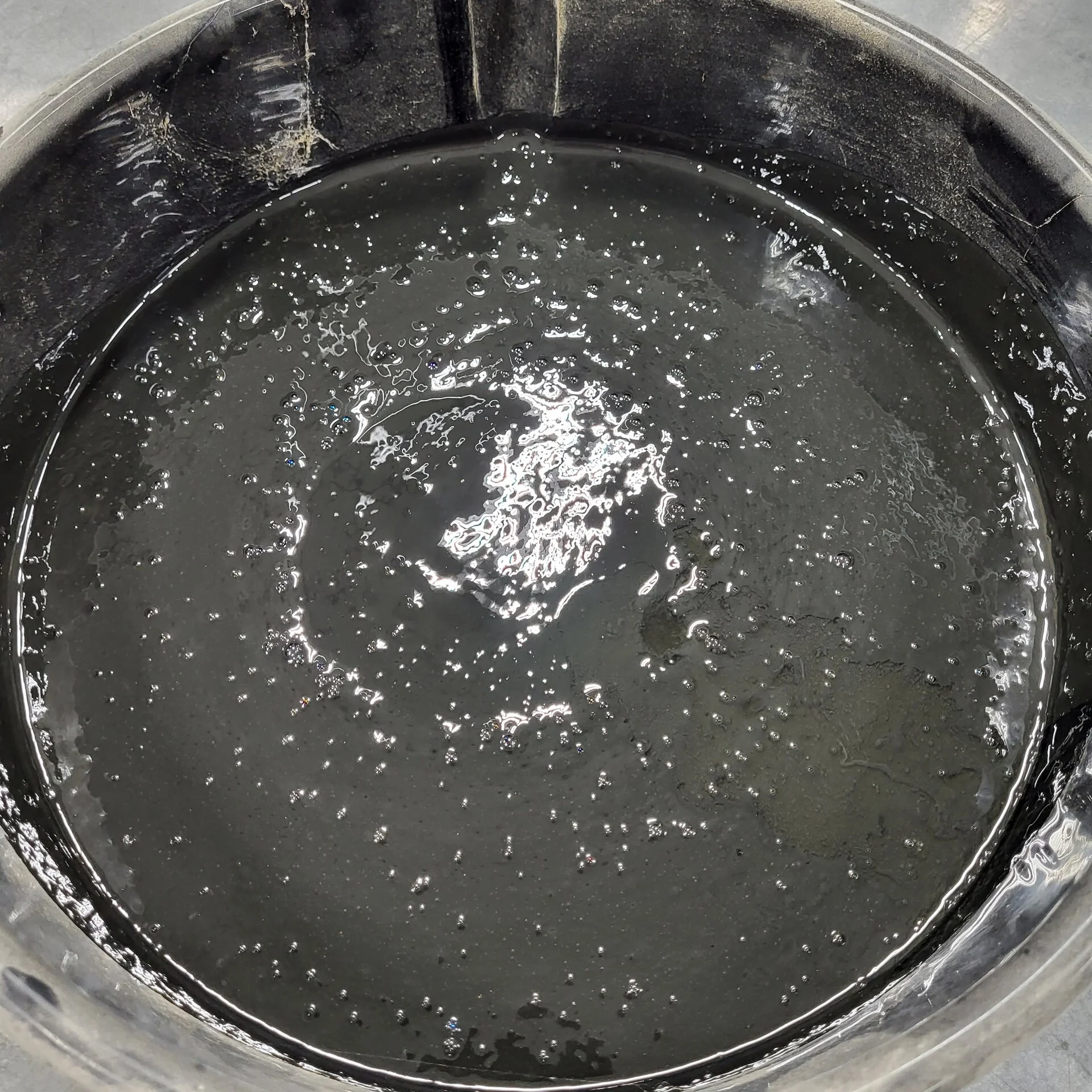

Changed fluids in both axles, transfer case, and engine oil.
Got super sad when I drained the front.
Lots of ferrous goop on the drain plug
And part of a seal spring...
Looks like I'll be pulling the front diff to inspect the gears, and a housing seal is toast. Might as well just rebuild the whole thing and pressure wash the inside of the housing. hooray....
Hopefully the gears are in serviceable shape.
I've got a mystery groan at neutral throttle. I thought it was the transfer case, but the fluid looked tits. So I'm guessing at this point it's something in the front end.
Rear axle fluid looked really decent too. So that's a win
Just did my front axle and it was close to the same as yours minus the ferrous goop and not quite as thick it drained pretty fluid just had a lot of moly grease in it. I am just gonna swap the lube out 3 or 4 times in quick succession as long as I don’t get any chunks I am gonna call it a win
The amount of metal freaks me out, only because I'll order everything but the gears. Then I'll need gears, and not have gears.
If you pay for shipping, you can have the stock gears that were recently removed from mine when I switched to 4.88s and installed lockers.
I finally got my LED relay installed and put old school bulbs back in the break lights to fix my lighting gremlins. Might need some HID for driving lights though, the LEDs (GTR lighting from headlight revolution) I got just are not bright enough.
I might take you up on that. As of right now, gear condition is unknown, and I won't open it up until August probably.
