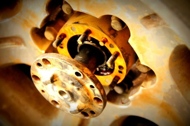

QBALL came over to install a Powertrax locker in his LX. Things did NOT go as planned since either we were given the wrong locker to install, likely, or the carrier is damaged, not likely. Was going to build a how to thread but since we had to just put everything back the way we found it I didn't feel there was enough useful info. So I figured I would show off some of the pics of removing the rear diff so that those that haven't done it, can see how easy it is.
By the way, a little trick if the 3rd is stuck on the housing - take a jack and put it under the pinion, and slowly/carefully push up with the jack. It'll help break the gasket seal so you don't have to beat on it to get it loose.
Don't jack it up too much, tho. You don't want to hurt the studs if you can help it.
