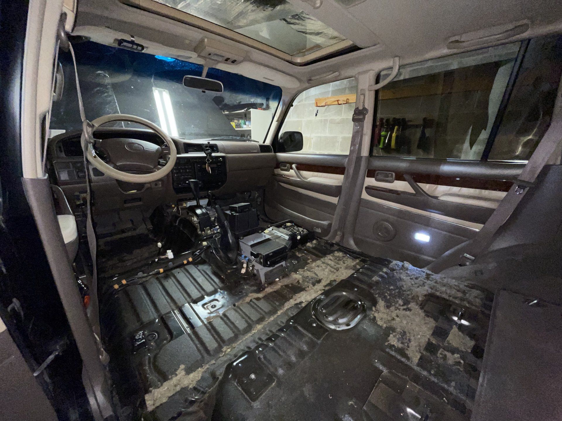

I am going to have a pause day and review the 30+ pictures I took and label, label, label! This is the point where I am going to need a couple of paint pens.
I will let the air out to get a few more inches. I'm 6'4" and tend to worry about things being too low.
Thanks again for the solid advice. I think my anxiety was coming from lack of labeling. It was starting to get to the point where I felt I could not remember each thing I took off.
I understand on the memory, you won't remember, don't try. The pics and info on my rebuild post may help. If you have a laptop, store the pics on there for reassembly. The nice thing about airing down the tires, you can always air them up again. Cheap way to get a few more inches of clearance.
