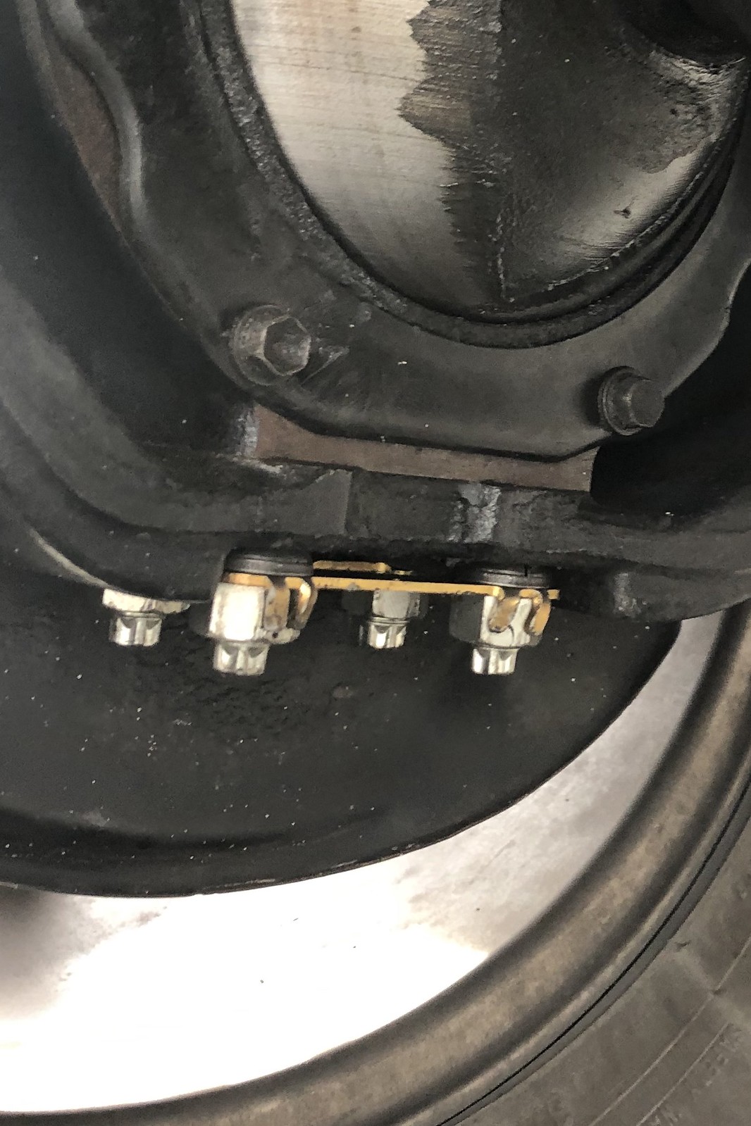

Steering rod ends. Purchased through Cruiser Outfitters. Good product, good service.
I noticed a torn boot a while back and figured I'd change them all before an alignment, but they were all in good shape and I'm pretty sure they were original. Love this southern CA rig: two of the four spun out without even touching a pipe wrench. The other two needed a good talkin' to.

Those in the rust belt will tell you to paint those rod ends, ASAP.
(I still haven't painted mine yet)

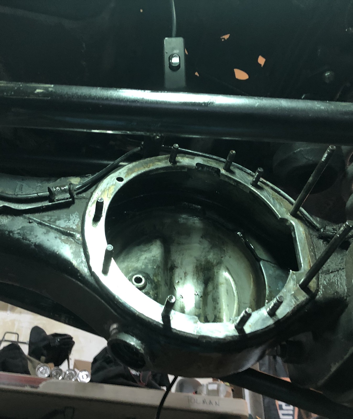

Got my Nitro chromoly front axles/birfs installed over the weekend. Was WAY more messy than normal since I was also resealing the front diff and troubleshooting a front locker that wasn't working. Had to pull the diff actuator and lock the diff manually to get the diff to come out. Was a good move anyway since I found that there was a busted plug on the actuator. Fortunately I have a spare locking diff so I pulled the actuator from that diff and will R&R the bad plug as I have time.
I must have had a bit of water intrusion in the front end because the gear oil was very thick. Was incredibly messy and took a while to get the axle tubes cleaned out since the tubes wouldn't drain since the oil was so thick. All good in the end.

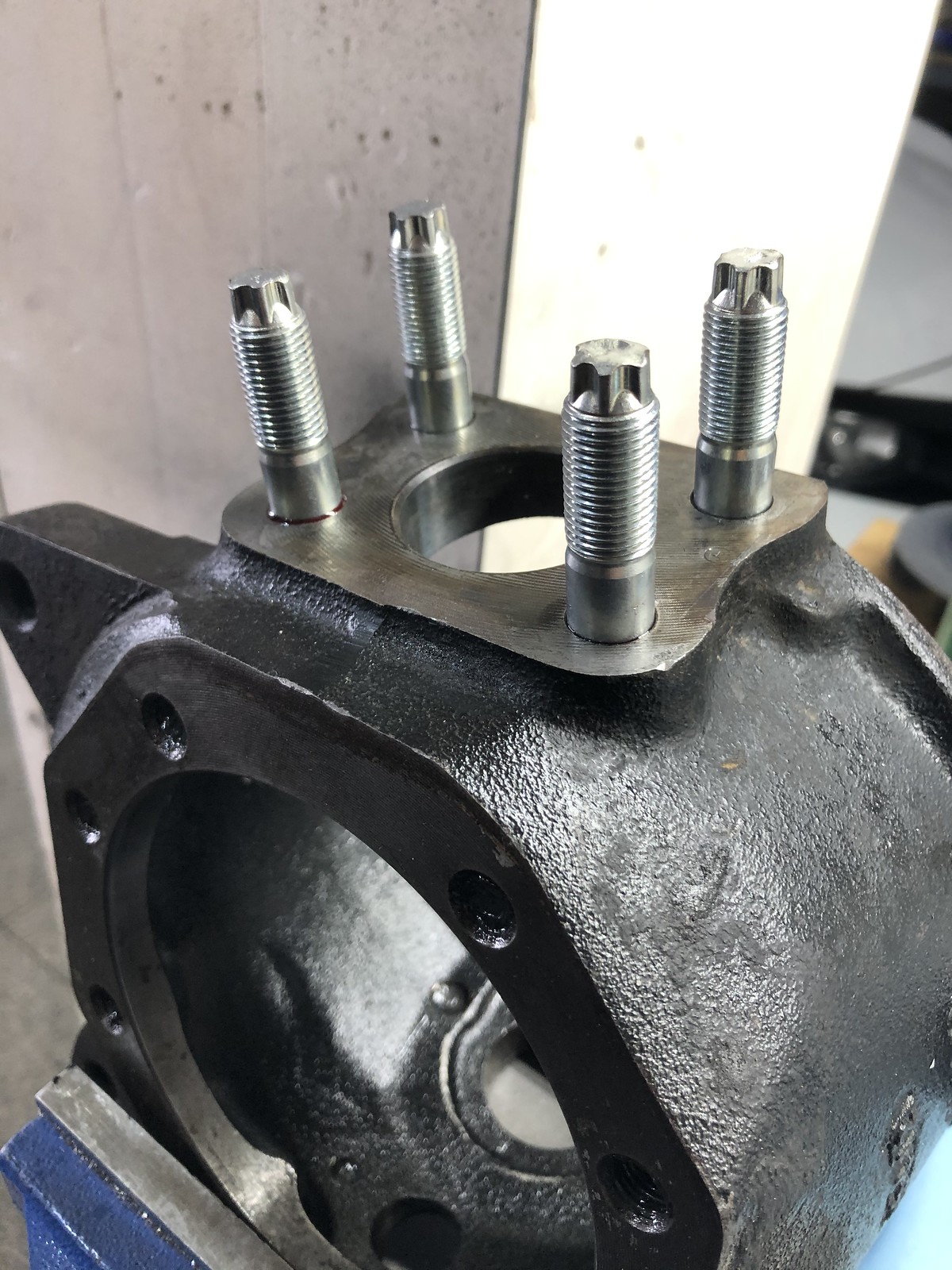

Used a Wits End knuckle stud kit with new cone washers/washers and nuts. Tried out the new "nut huggers" too. This should take care of the last leak I needed to address.

I am looking to rebuild my knuckles soon too. Great choice on doing the Wits End stud kit. I am thinking when I rebuild my knuckes I will do those "nut huggers" too. But I am trying to save up some money for aftermarket axles and do the re-gear all at once.
