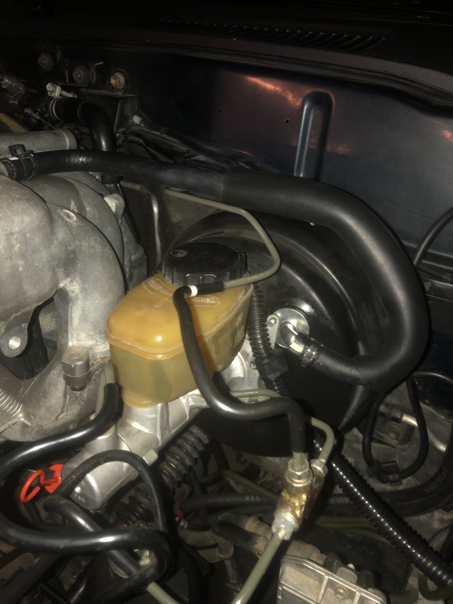

Finally replaced the dying Bosch starter with a reman Denso unit. No more worries with the starter when remote and winter trips! I also have a brake booster sitting in the garage so I thought this is great time to install it and gain more room to the starter. I probably tweaked my back going under for the bolts under the pedal. Still I am glad i finally got it done after all my procrastination.

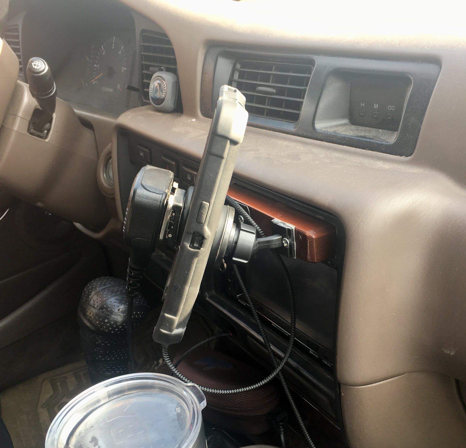

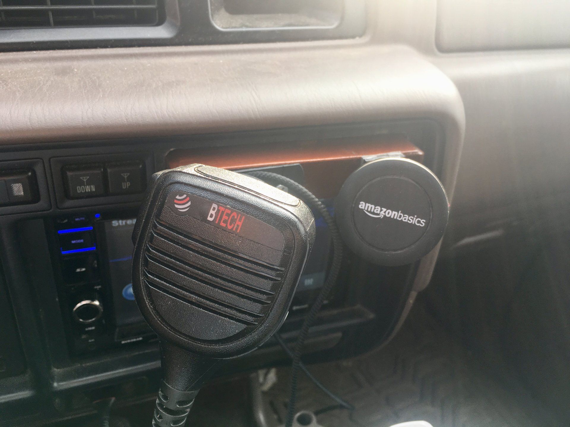

Completed the useless cubby block. 2 mag mounts for phone/nav and comms. Ended up with 2 different mags that are not identical, so that is kind of annoying but the stain matched the factory ersatz wood perfectly.

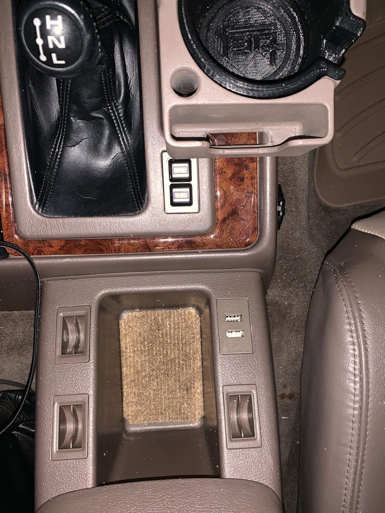

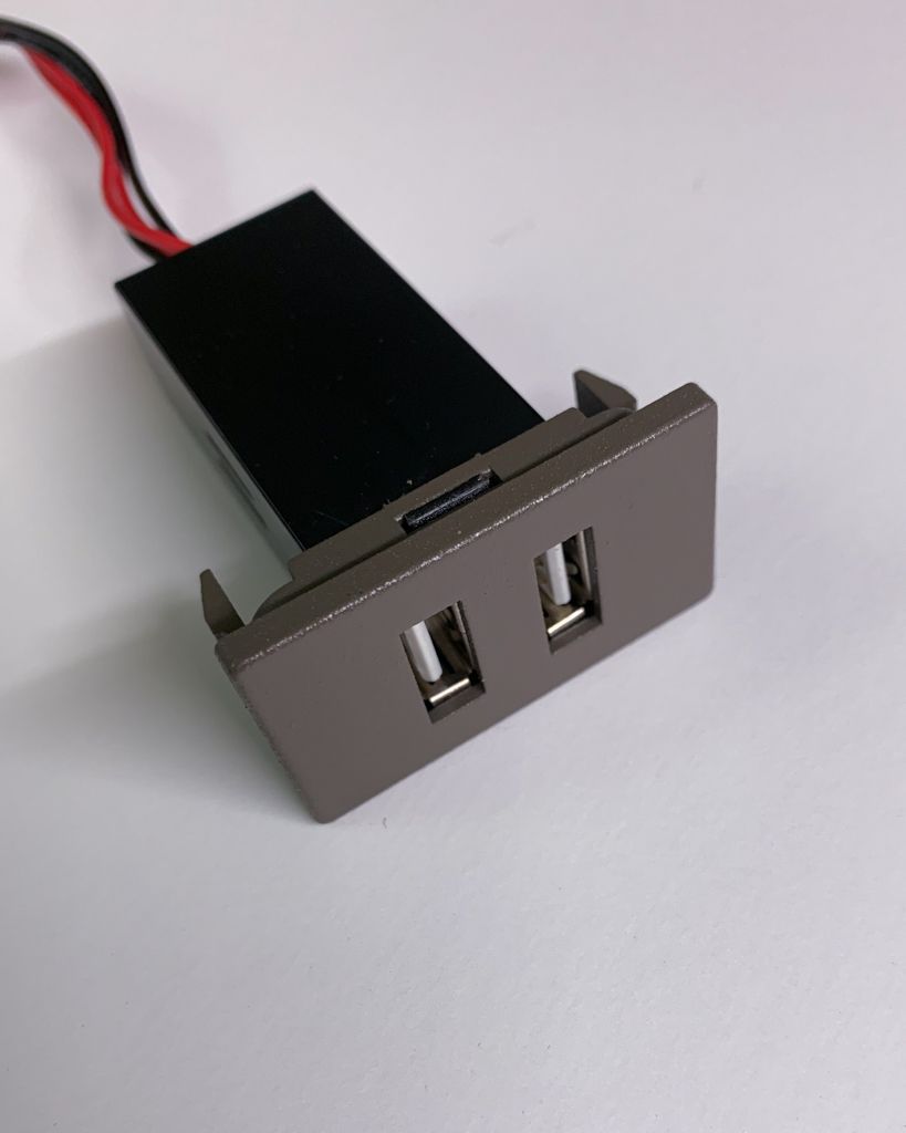

Added a couple USB charging ports. Brown matches better in person than in the photo. Probably will have these up on the site in black and brown.
I like the execution, I dont think the location of those usb ports lends itself to a long life.
Yeah, I’m kind of thinking the same. I may do the black one next to the rear heater switch instead, but I’m going to live with it like this for a trip or two then decide.
I have Blue Sea dual USB in the exact location for several years and personally find the location nice without issue.
