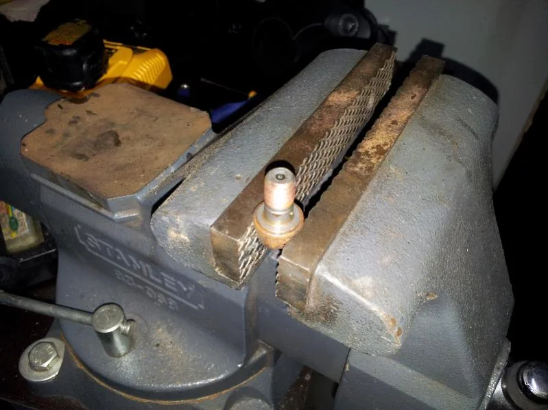

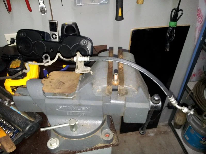

Replace front caliper brake flex hose and had to pull the entire hard like to get old ones loose ( probably factory ones there)
What caught my eye
1. Factory new flex didn't came with new copper washers had to reuse old ones
2. Caliper line bolt looks like it's copper too?
After 3 complete rounds of bleed still have air in the line :doh:
Old Dot 3
Use Dot 4 and flush the entire system
Any to worry with new Dot4?
What caught my eye
1. Factory new flex didn't cane with new copper washers had to reuse old ones
After e complete rounds of bleed still have air in the line :doh:
Old Dot 3
From what I've read, DOT4 is fine in these trucks.
