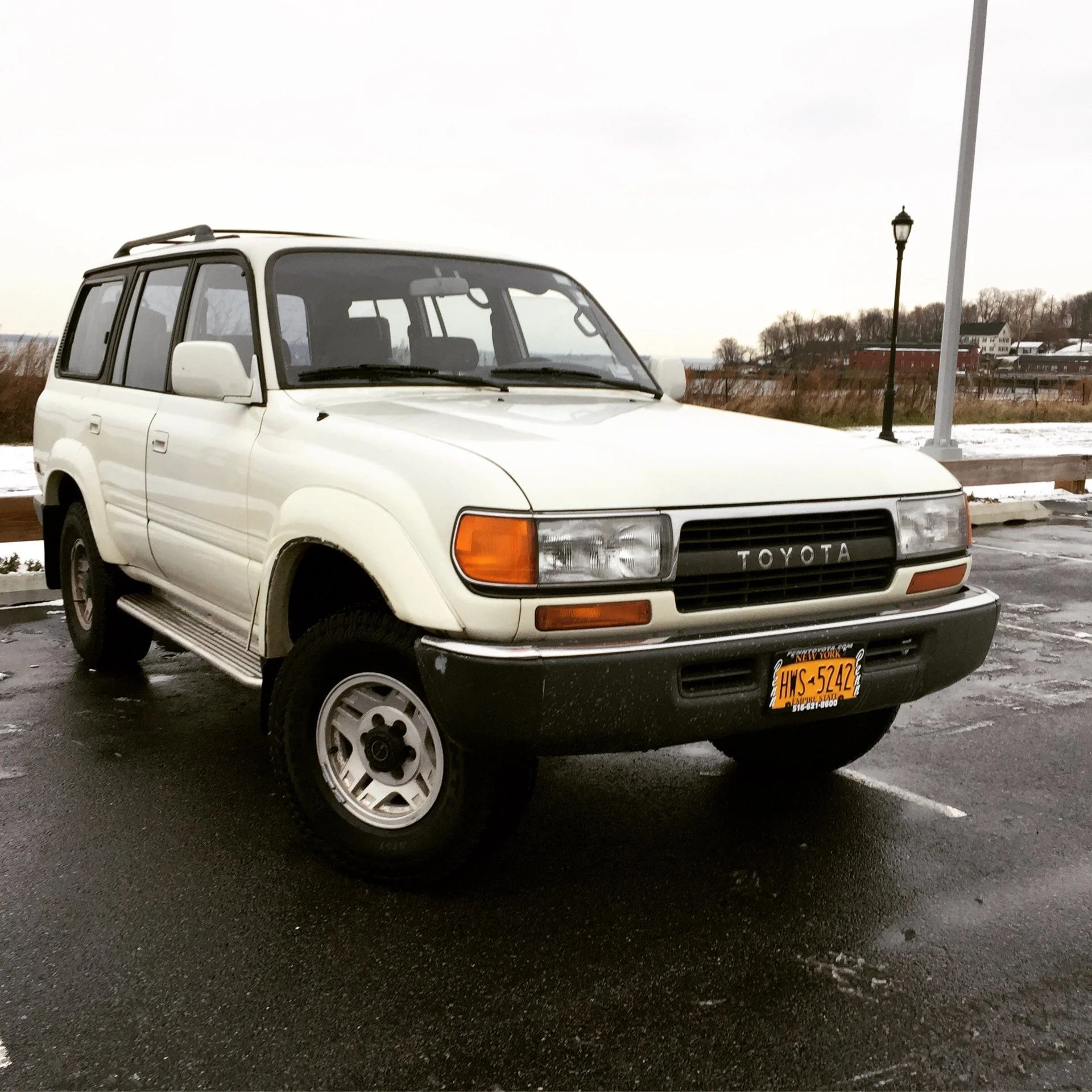

Hi everyone, I just picked up my first LC today, 91', one owner, 146k. Most everything seems to work, thanks to the online community here I was able to be well informed and prepared to welcome her to the fleet. Got a 92' FSM from the Toyota publisher (no 91 available, but same truck right?), and look forward to the adventure. Got it from a local Toyota dealer that took it in on a trade. Brake line burst on my test drive, and E brake did not work, so the dealer fixed the issues before I picked her up today. Oil is leaking slowly from somewhere in the engine (wet oil pan), there is typical rust for a vehicle that lived in NYC it's whole life. Drivers side floor is a little wet, smell a little mildew, windows only open a crack all around, sunroof does not work and I don't care. The 3FE seems to have decent power despite popular opinion, and the tranny was rebuilt 10k ago. I think the PO cared for her well, I'm happy. Monday it goes to my mechanic that I've known most of my 47 years for evaluation and planning. So far I expect to keep her stock and use her as designed. Thanks in advance for the questions I will undoubtedly be asking. For example, center diff lock seems to work as I was playing with it in the snow today, but should there be a dash light? or should the button light up? I think a dash light, but have not searched forums yet. Sorry for the long post, forgive me, I'm new.

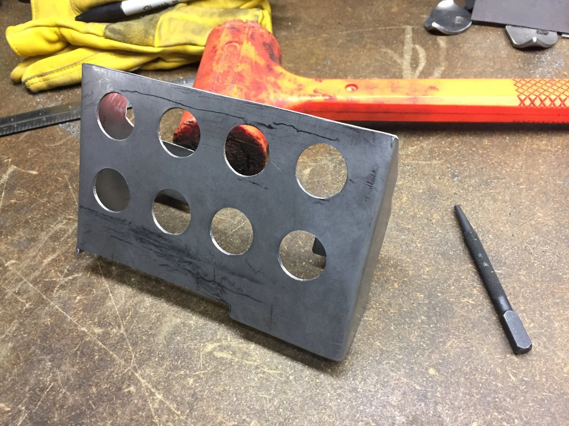

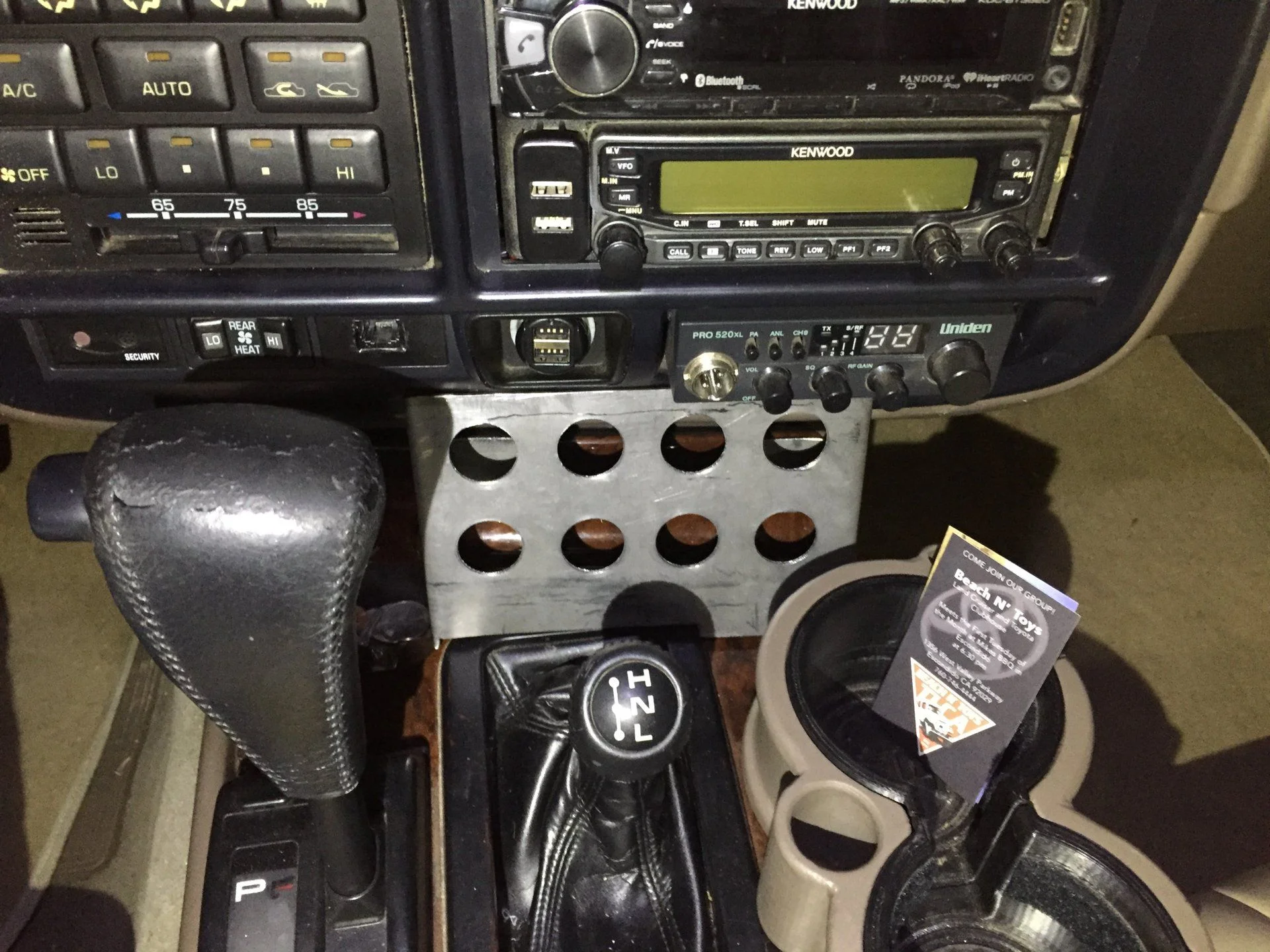

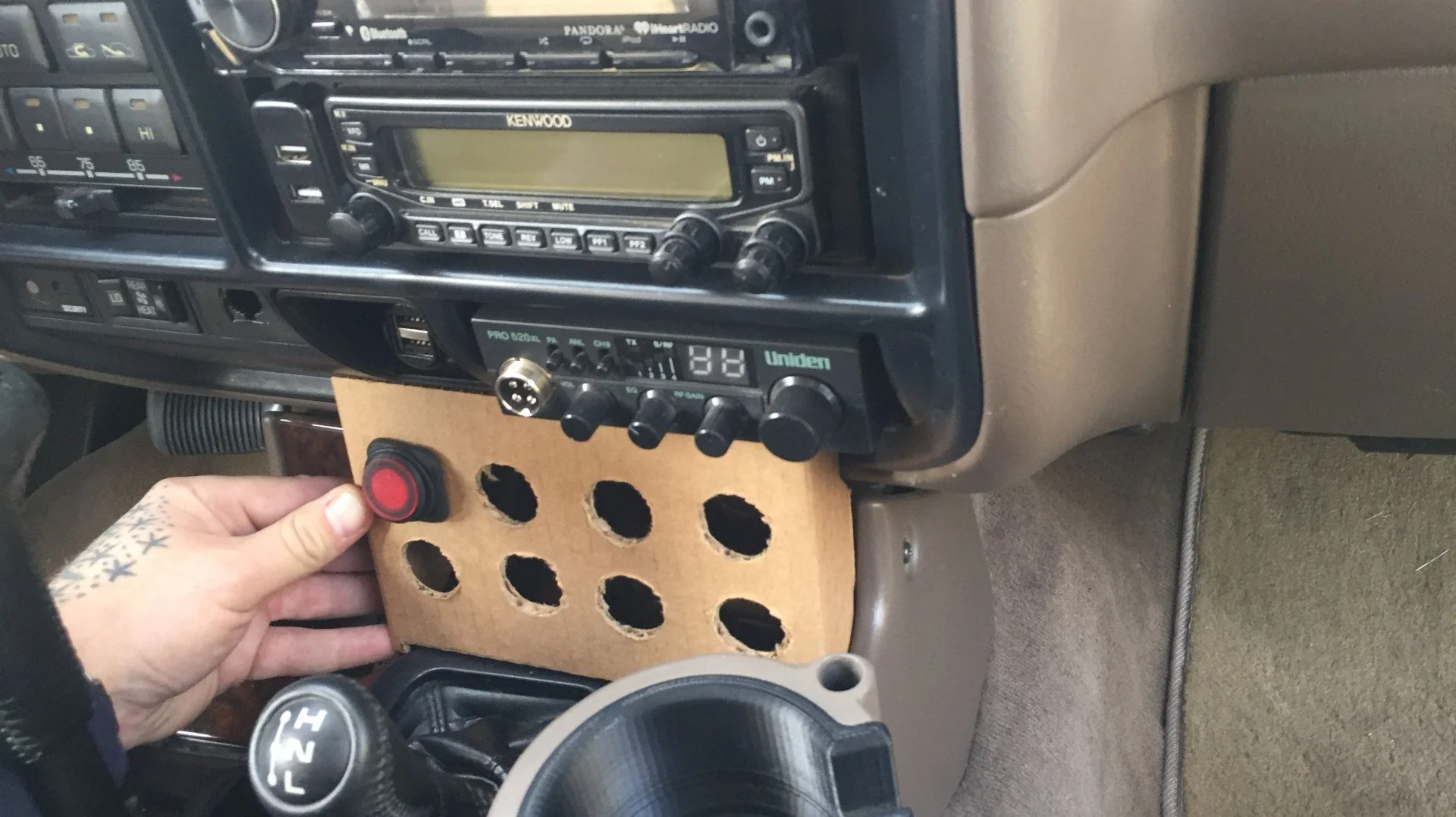

Did a little bit of sheet metal work today. Made out of 16ga.

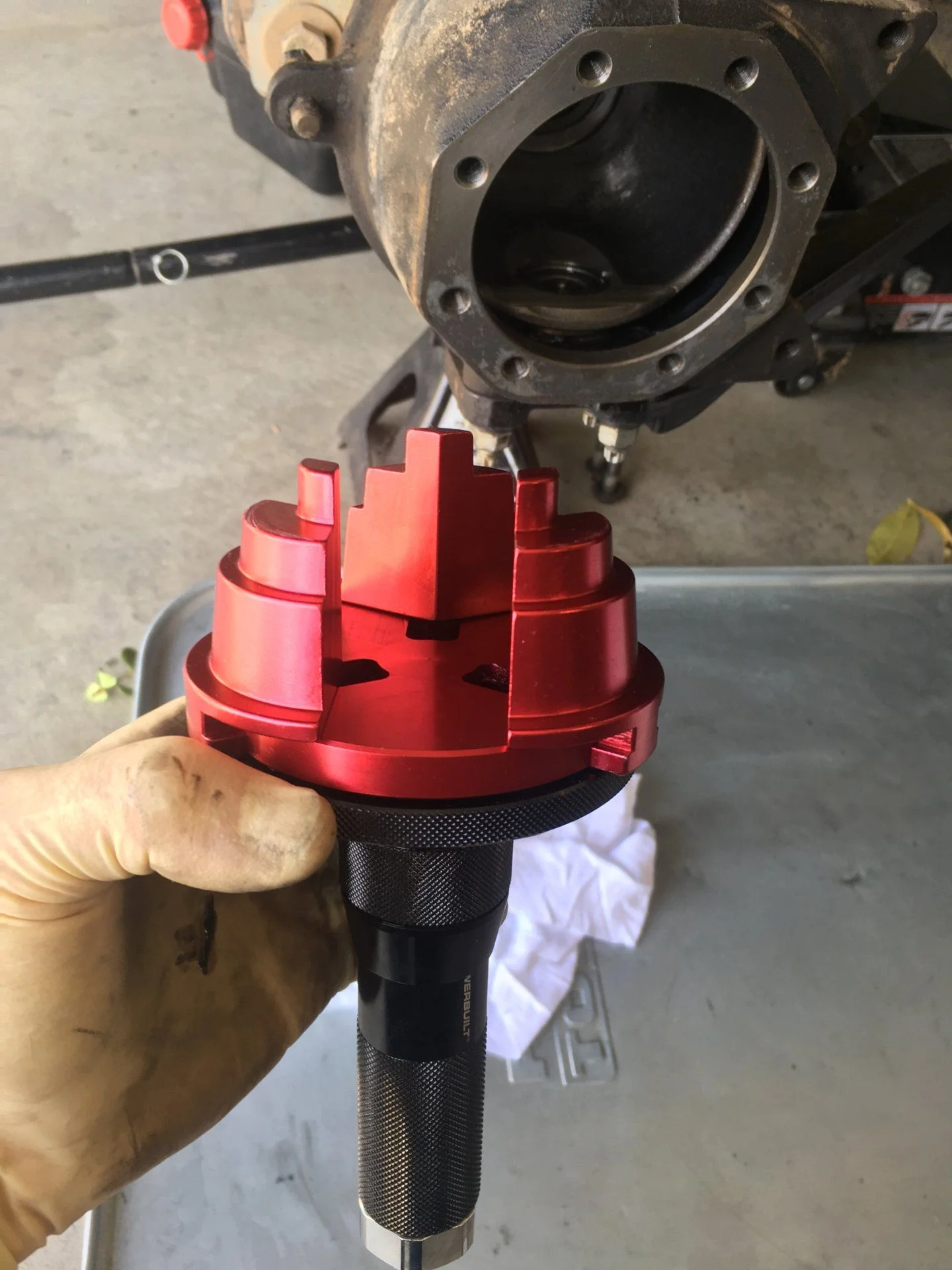

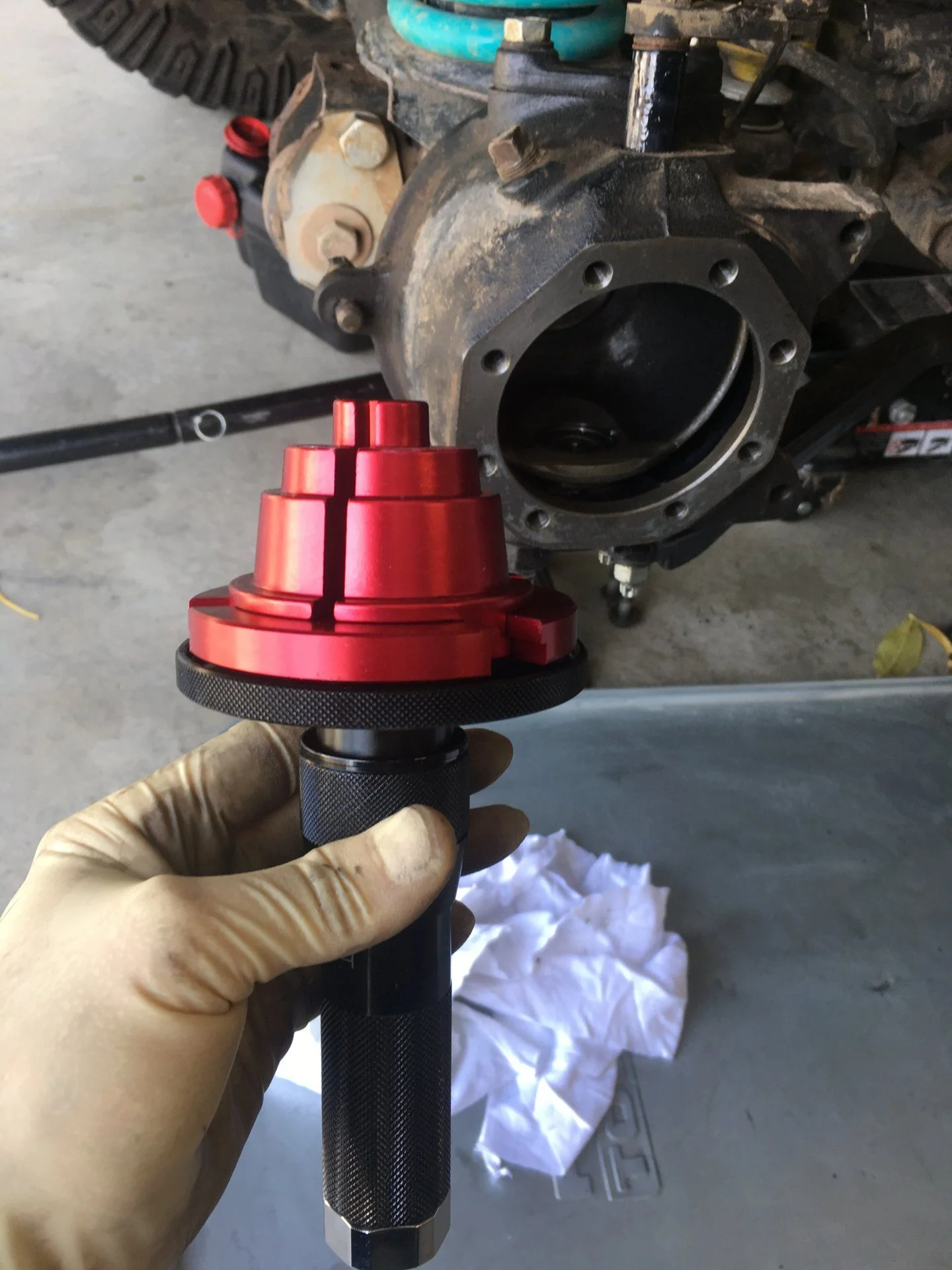

Dealt with a leaking front axle oil seal on the driver side only. Last spring I did a complete knuckle service including all new hardware and RCV shafts. Ever since, the driver side has been ejecting quite a bit of grease but not dripping.
Yesterday I drained the front diff and it was thick with Moly grease, no surprise there. I tore it down and inspected all hard parts today finding nothing wrong. But, when I removed the OEM oil seal it was minus the little spring that holds the seal snuggly to the axle. Lesson I learned here is to thoroughly verify the integrity of even the simplest part before installation.
Also, I borrowed this nifty, adjustable seal driver from Auto Zone. It worked fantastic!

Nice find!
