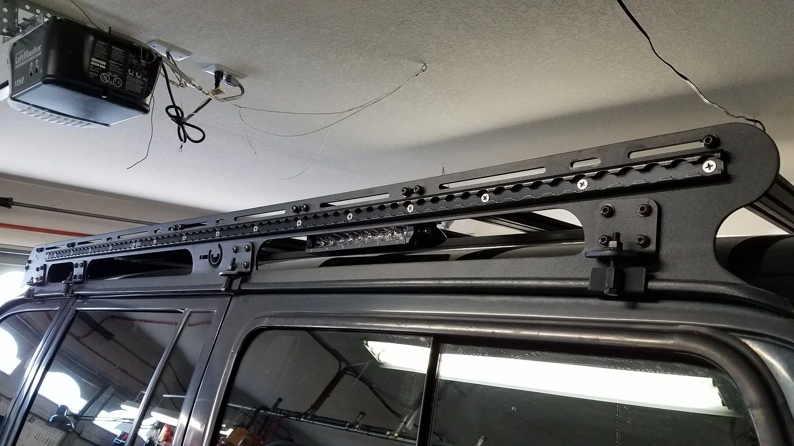

Installed a bunch of L-Track on my Prinsu Designs rack:

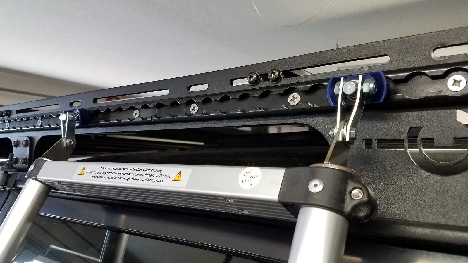

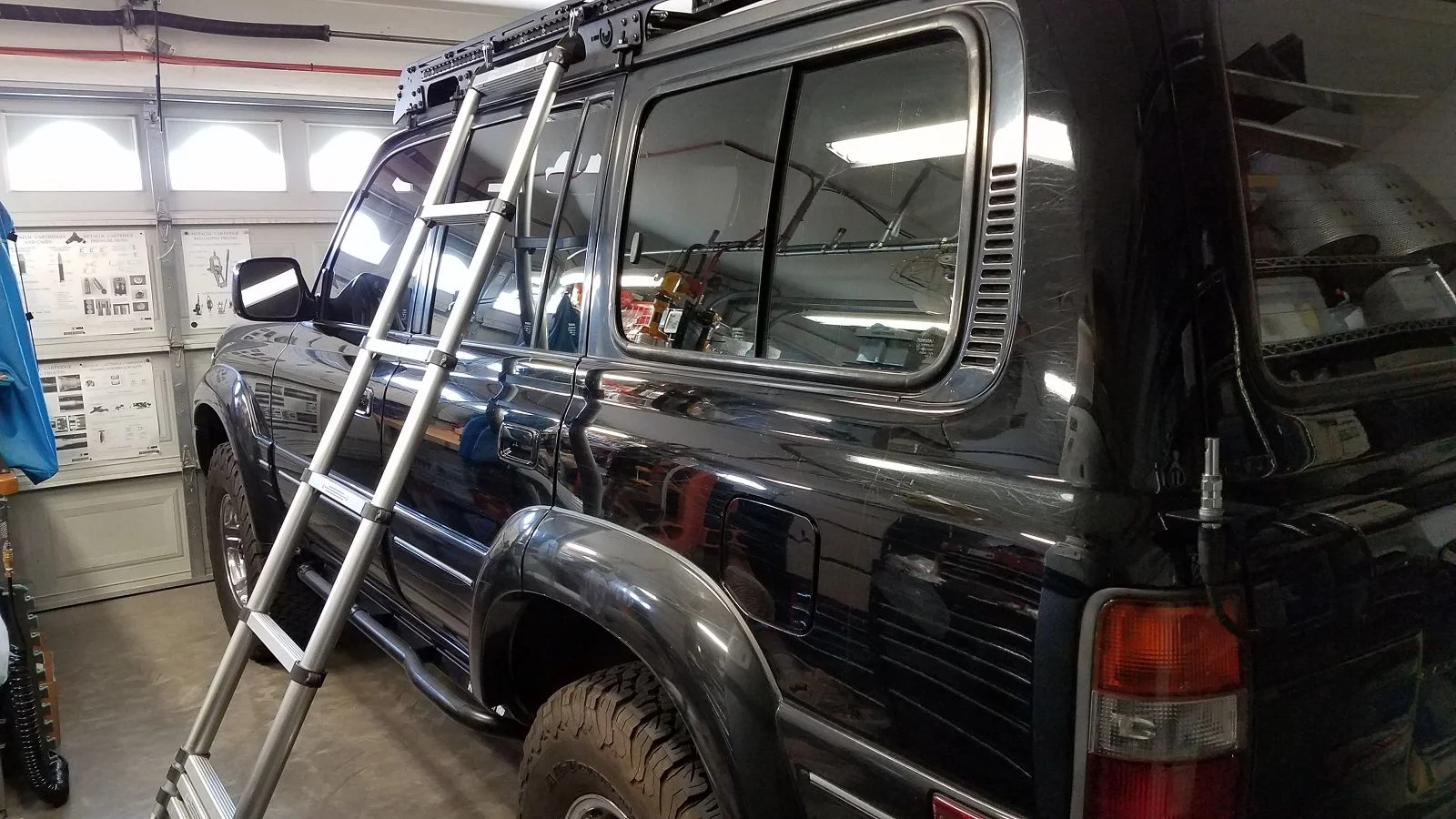

Modified my Tepui telescoping ladder for quick disconnect using L-Track:

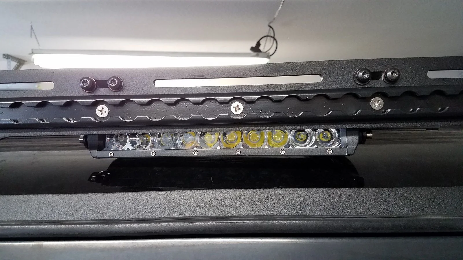

Reworked my side illumination with a single 11" 50W LED bar on each side. Amazon.com: MICTUNING MIC-5DP50 2X SR-Mini Series 11'' 50W Single Row CREE LED Light Bar COMBO Spot Flood 5000lm 500m Visibility: Automotive
I had to get creative with the mounts given the 11.5" width. Used only the brackets the kit came with and a few nuts and washers for spacers. Very little clearance on the front end of the light.
Info request on the ladder mount to the L-track
This is for one side, double quantities for the second one:
  • I started with the higher quality, rubber booted L-Track triangle ring fitting: https://www.amazon.com/dp/B00LGYWADO/_encoding=UTF8?tag=ihco-20
  • I cut the ring with a hack saw and removed the rubber boot from the spring.
  • I picked up the following hardware from Ace Hardware
  • 2x 2" galvanized steel brackets with 1/4" holes
  • 2x 5/16" diameter x 1/4" thick aluminum spacers
  • 2x 5mm x 25mm bolts
  • 2x 5mm nylon lock nuts
  • 2x 5mm fender washers
  • 2x 5/16" washers
  • 2x 1/4" x 1" bolts
  • 2x 1/4" nylon lock nuts
  • I inserted the 5/16" aluminum sleeve into the 5/16" hole in the ladder then stacked 2x 5/16" washers on either side of the ladder to take up the gap. I then stacked a 2" strap on either side with the bevel facing the bushing. Next I fed the 5mm bolt though and tightened the nut flush where the assembly would swivel freely but would hold it's position for ease of mounting.
  • Next I determined that the 2x 2" straps would need to be bent into a slight dog leg on either side to clear the bolt of the L-Track fitting. Once both were bent up, hold the L-Track spring down and insert the 1/4" bolt through one 2" strap, the L-Track fitting and the other 2" strap. Fasten the assembly with a 1/4" nylon nut and tighten until flush. Again the assembly should swivel a bit. The sprint should hit the bolt but not get snagged in between the 2" straps.
  • Place the ladder on the ground and extend to the track then clip in one side and confirm the spacing works for the other side and secure to the track.
I had to make a few minor tweaks to the 2" straps and washer spacers on the ladder to hit the track just right. I climbed up on the ladder a few times and it held fast.

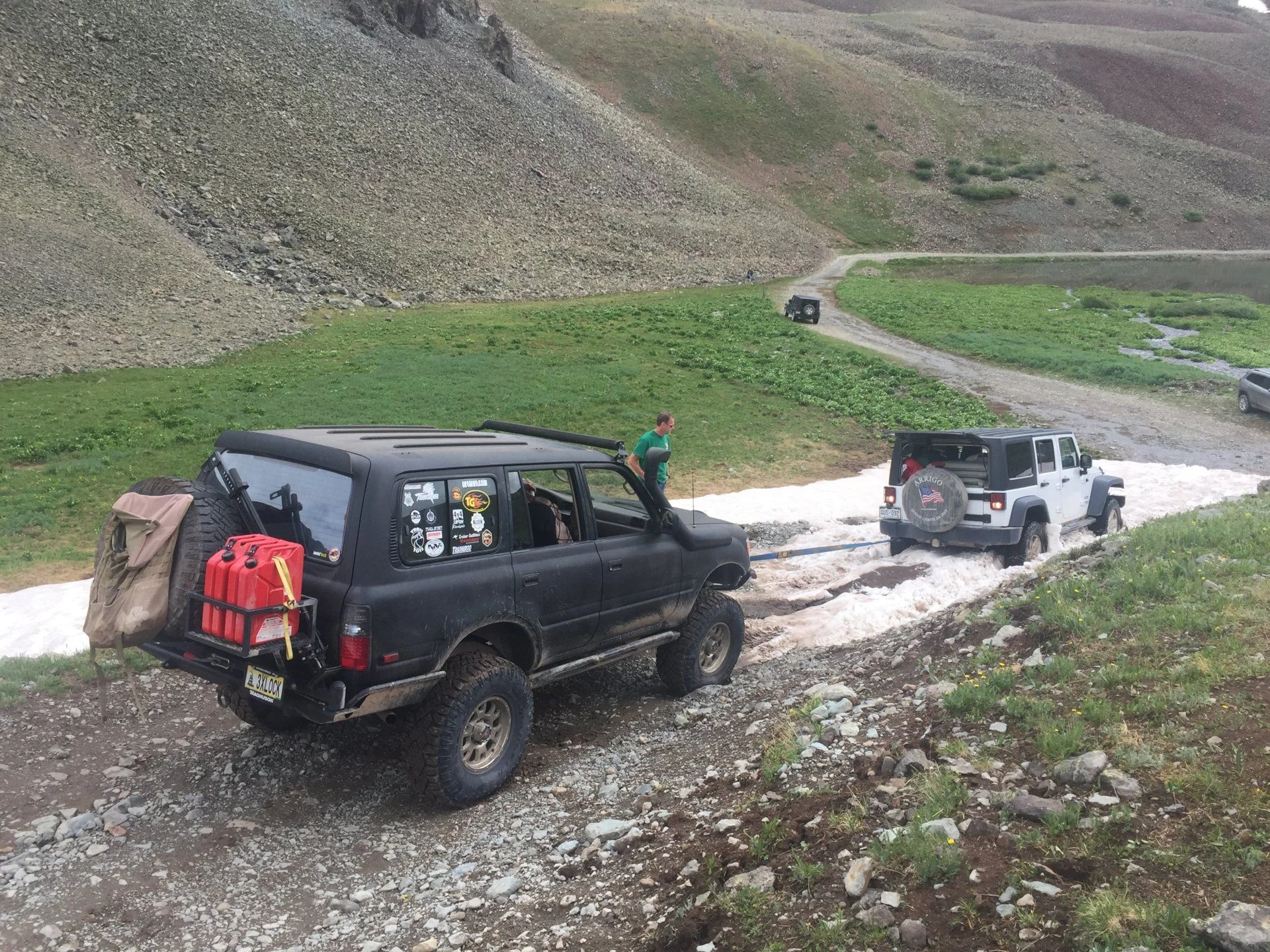

Can I assume it was not Trail Rated? I would of drove up next to him and asked if he wanted a help.:grinpimp: Then drive around him like I was on pavement and pulled it out forward with little to no effort.:moon: You would not want him to get stuck AGAIN try to past through.:D
Note: Pulling in reverse is not safe you or your Land Cruiser

Yep. I took only a tug. I drove down it just minutes before so he wanted to try. Nice guy.

Are those things really that easy to get stuck? I haven't driven a Jeep since I sold my '73 Wagoneer and I know that thing would have ripped right through that.
Is it hard on the driveline to pull in reverse? I don't do much recovery where I live but the times that I have, I felt like it was helpful to be able to see what I was doing. I have never had to give anything a real yank though just a little tug to back someone or some thing out to get a little better traction.
