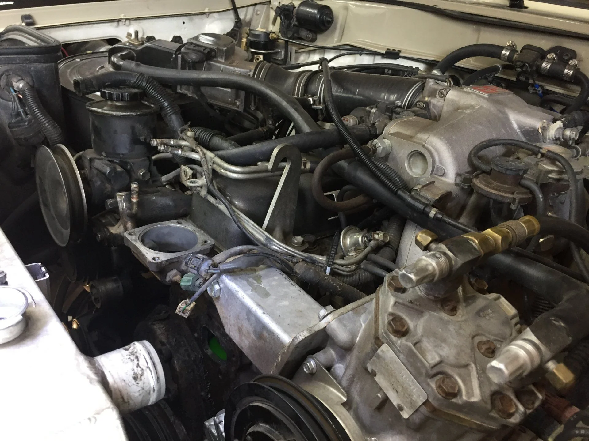

Fresh water pump, thermostat, and coolant hoses all over the front of the engine. Crazy thinking it should be fine until 500-600k miles

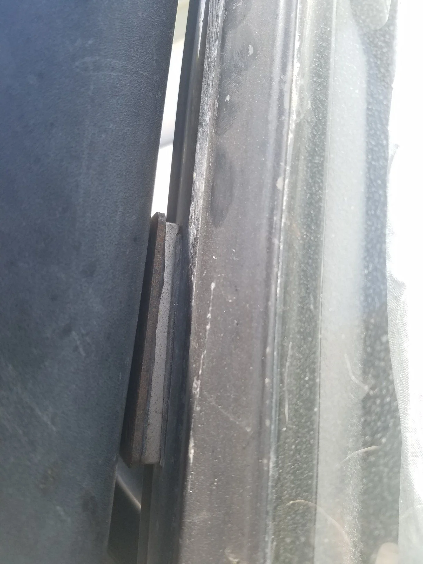

eBay Snorkel install
That's cool. I just didn't GAF about drilling in mine. I put a bed of marine grade silicone before the bracket. Then spread that around the outside edge.
Great pic but..... wth is it? @karlslashwarren
3m VHB is my guess but folks might like to know
Tsk tsk tsk. Silicone? The rust promoting stuff recommended not to be used on this sight ? :p
