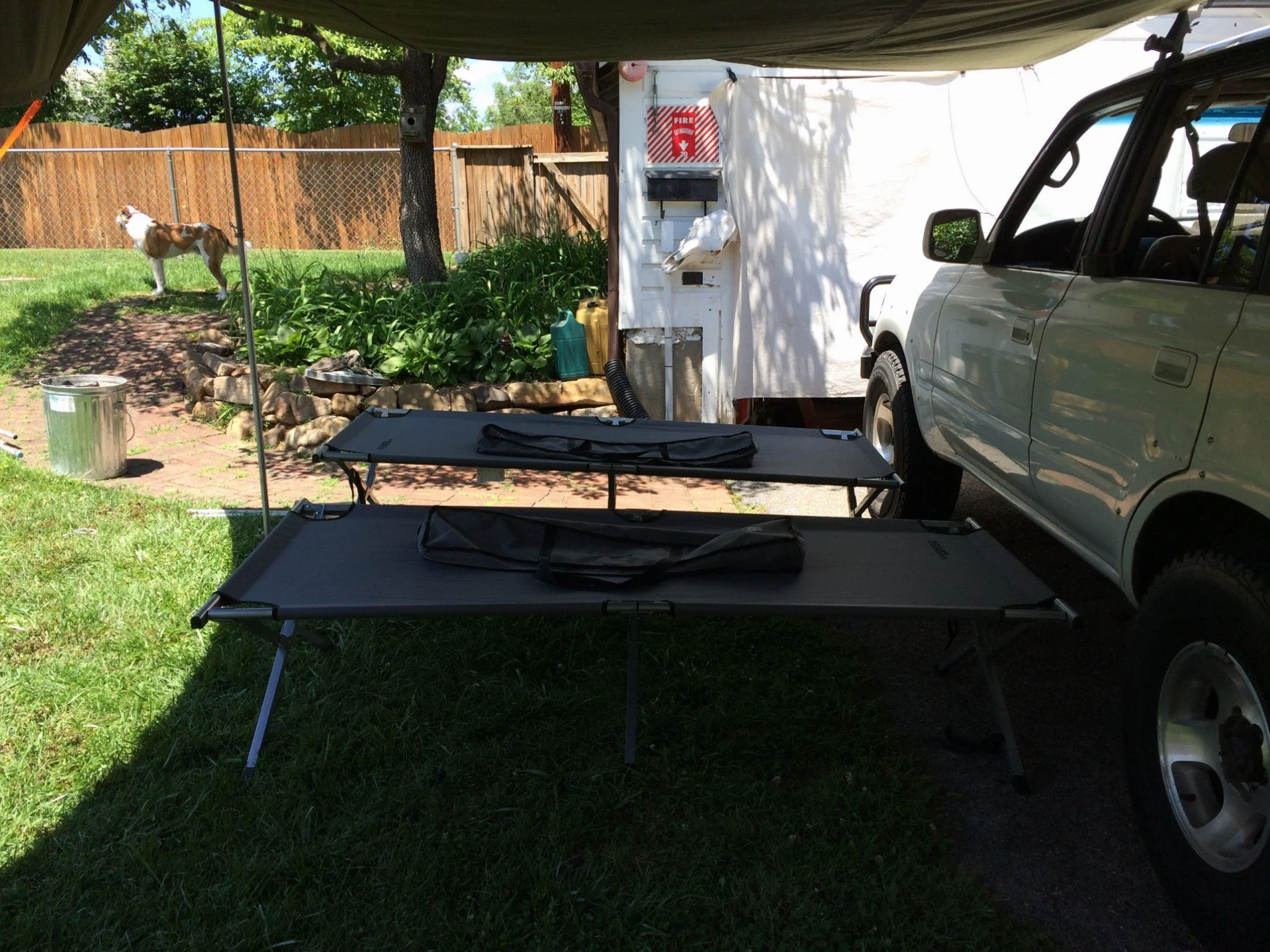

Pre check for camping next weekend. Carolina Relic Run here I come.

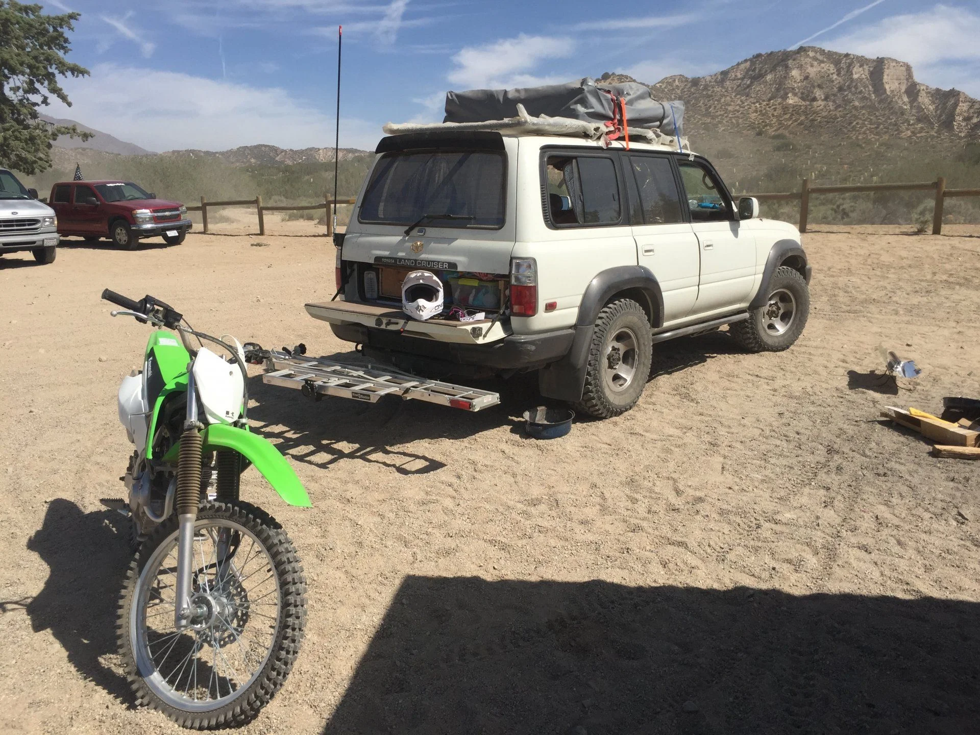

I'm a week late but Memorial Day weekend was love/hate ....
Got a great deal on a full roof rack and RTT only to have it completely blow off the car since it was strapped down to the factory roof rack. I learned a very important lesson about securing items down that day. Brand new rack probably done for...and the RTT definitely has some issues that need to be addressed. We ended up hitting hungry valley OHV still and saw a ton of 80's...the most I've ever seen in one place in my life. Did a couple of trails with the cruiser but mainly gave the new dirt bike most of the attention :)
Before
After
This thing was flat ...
If anybody has any recommendations on straightening out the roof rack, feel free to PM me. I'm not really sure what to do with this thing now :frown:

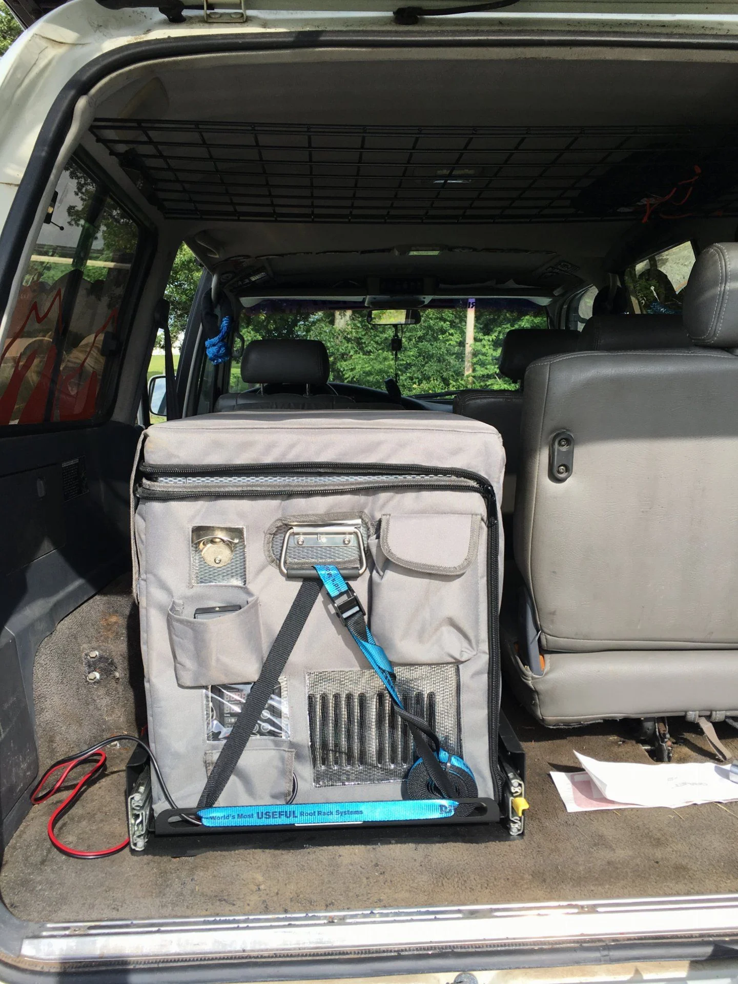

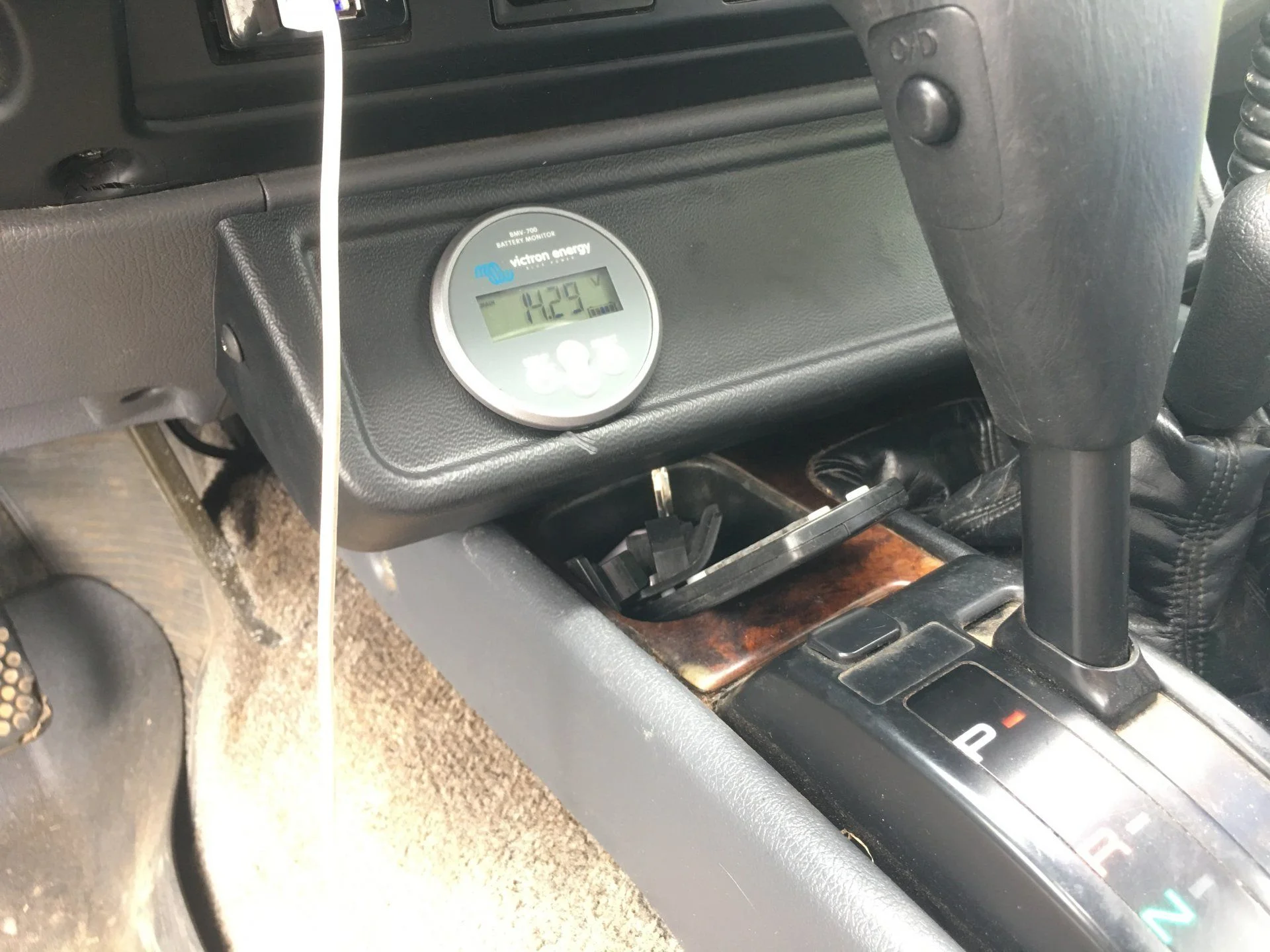

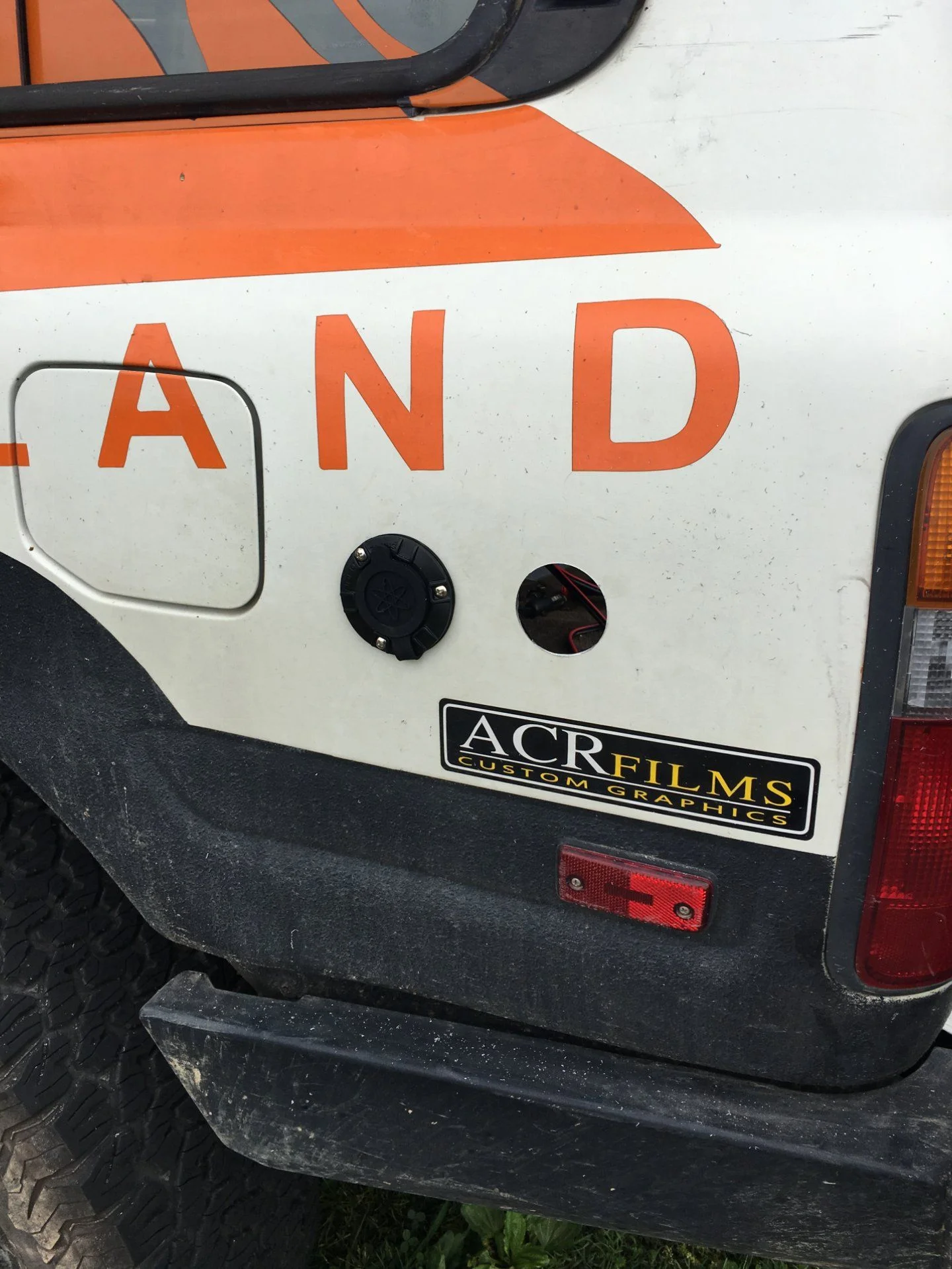

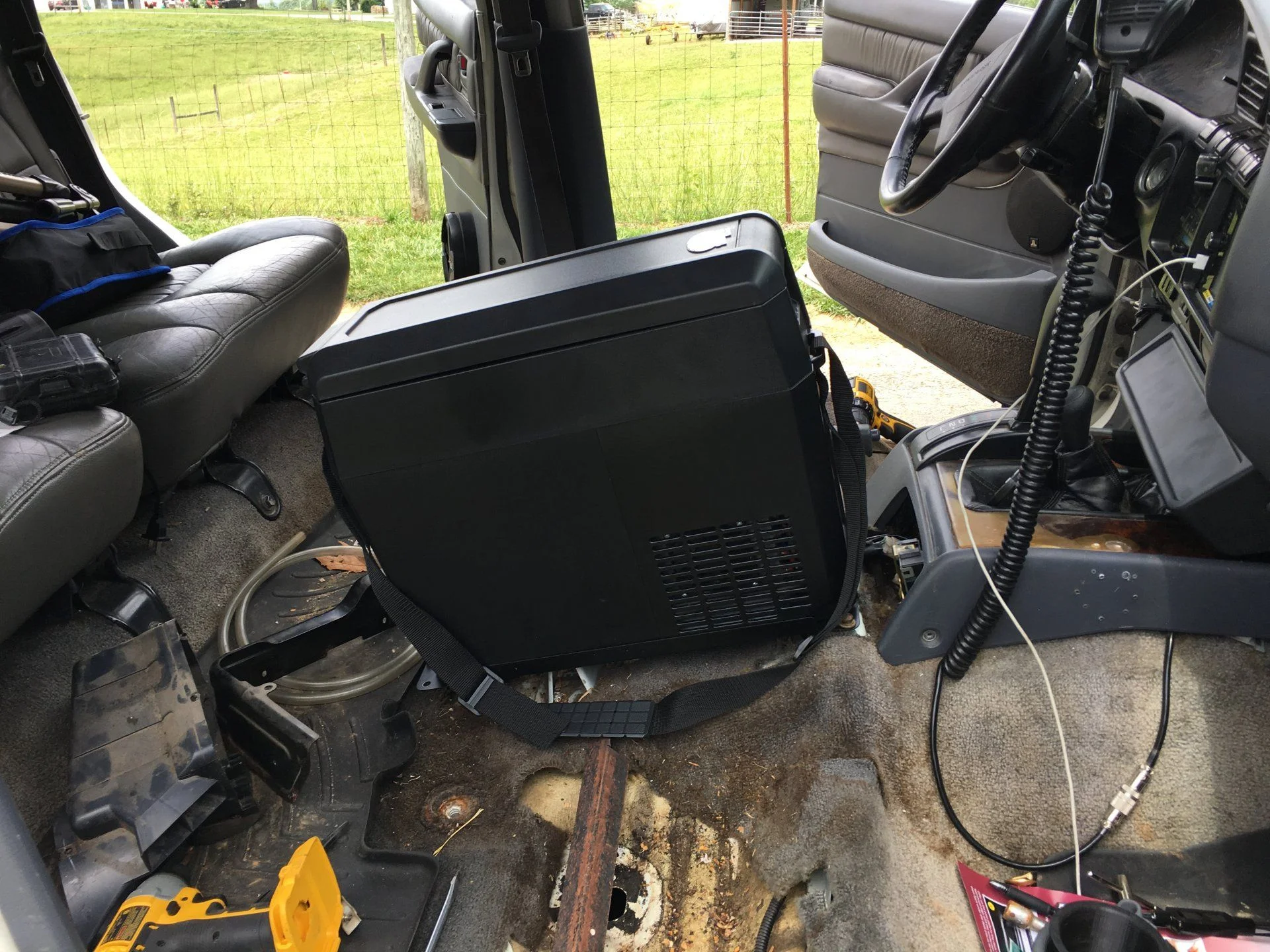

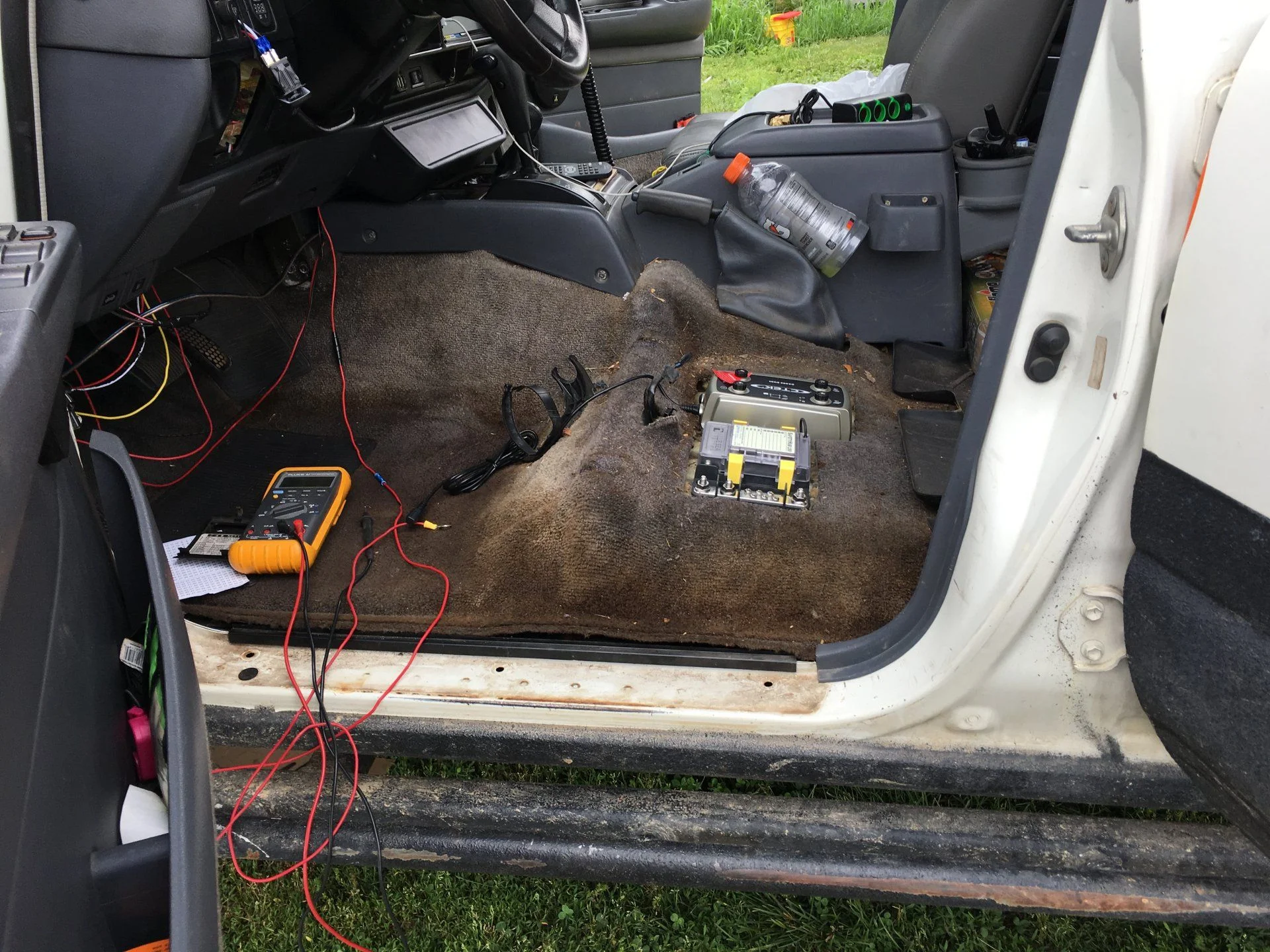

Just going to tease a few. Will do a full write up.
Total aux power rework including ports for shore power, solar and added 2 fridges

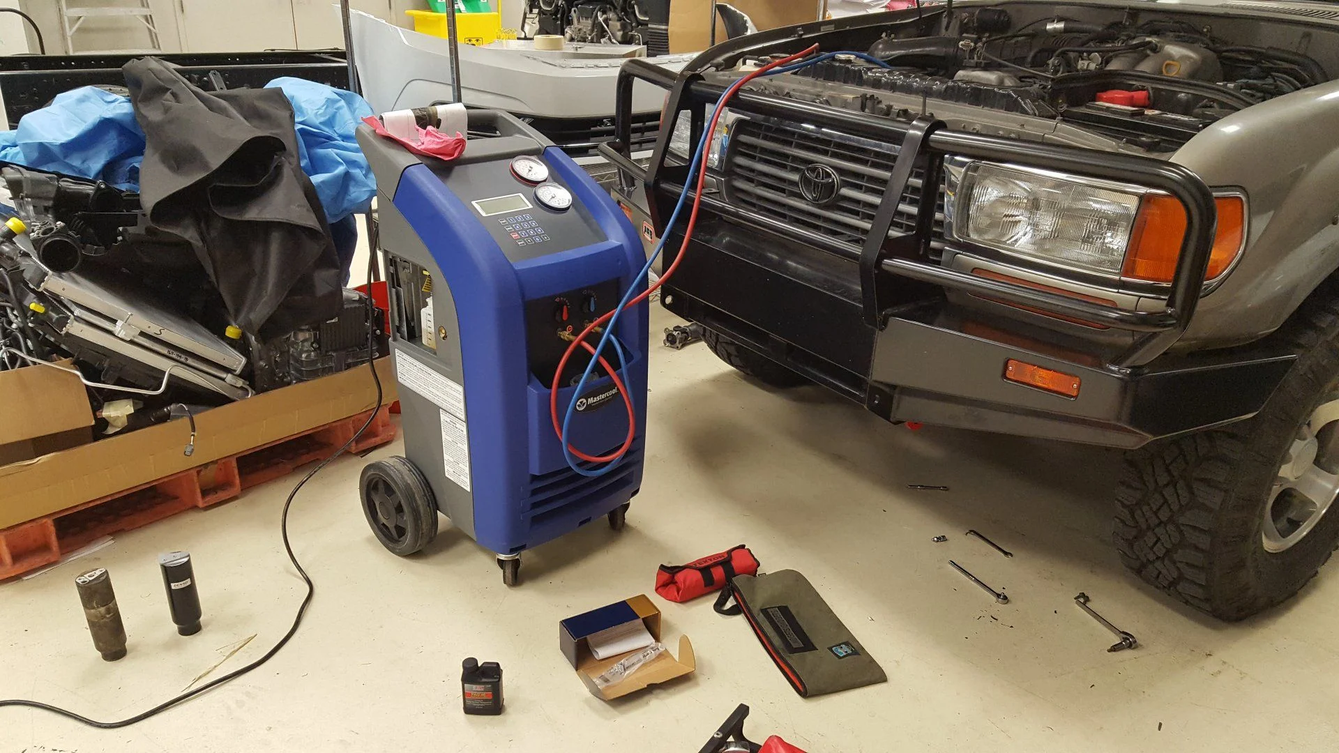

After having the ARB for a month, l finally got tired of seeing the AC receiver drier. A 0.75" shorter Denso unit was only $14 and seemed like a safer option than bending the lines.
I was able to use the awesome refrigerant machine at work, which is way better than using a manifold. When recovering the old r134a ,only 0.8 lbs came out of the system! :eek:
Strangely I couldn't find any leaks and the system held vacuum, so I went ahead and recharged it with 1.8 lbs of r134a and 10 ml of pag46 oil.
Do the AC systems on these trucks have any common leak points?
