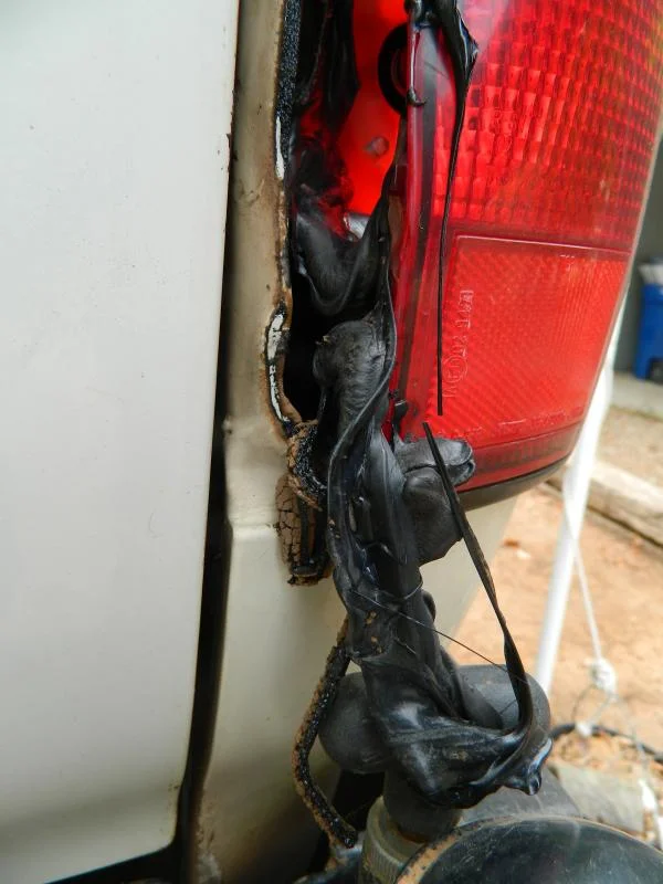

Howdy! Got kinda bored, so I decided to make tail light lenses out of candle wax. Looked pretty good, but did not hold up to the heat very well.
Uh, huh.
It looks like you either had an unprotected circuit, or got the camp stove too close.
Uh, huh.
Good guess, but wrong. Actually was an exhaust problem. I had been wheeling in the rocks all day and unknown to me, I bent the last few inches of my tailipe upward enough that the exhaust was getting trapped in the right rear corner of my Slee bumper. Back on the hiway, with enough throttle on the uphills, the heat was enough to melt the plastic. It was trying to excape between the tailgate and the body, so all the plastic melted and ran down into my latch. I could not get the tailgate to open. Had to chip it out with a screwdriver. The heat was bad enough that it even ran forward along the side wing of the bumper and melted the bottom of my flair a bit. It also melted a bit of my trailer harness wire, so that grounded out and popped my dash light fuse. Time to Trim The Tailpipe. John
