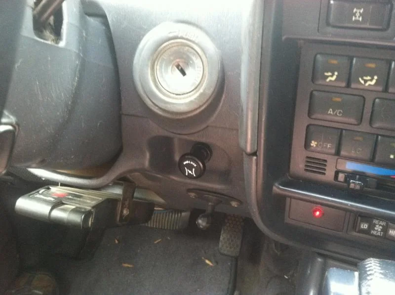

Hand throttle installed. Don't mind the interior, I just got back from the woods.
Took about 10 minutes for me, and I generally have no idea what I'm doing.

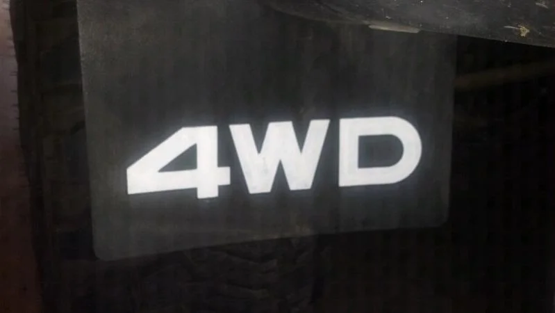

I refreshed this when my son was taking a nap yesterday. My rear mud flaps on my 91
How did you mask that off? Looks like crisp lines.
1st thanks
2nd I painted the 4WD with those paint pens you get from the craft store. I got the fat one, and painted it 2 coats. The 4WD is raised, and being the pen is fat it did have a little paint runs. I just got a black sharpie and outlined the 4WD on both flaps. Took me 20 min to do. Could of been faster, but I removed the flaps and washed them. Took it in the house on my table and colored them both. Then screwed them back on the truck.

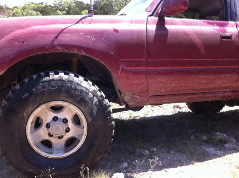

Finally tagged a rocker panel after 3 1/2 years of wheeling without sliders.
Figure I'll straighten it out best I can and add sliders. Ran some new/harder trails this weekend and I'll be back on them again next time out so I need protection.
