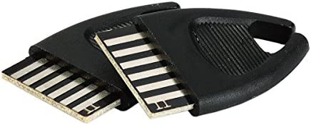

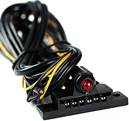

The previous owner installed one of these below on mine....and it works. it will not start when the key style to the system is out.
VEHICLE STARTER INTERRUPT DISABLE SYSTEM REMOVEABLE KEY STYLE​
  1. VEHICLE STARTER INTERRUPT DISABLE SYSTEM REMOVEABLE KEY STYLE
