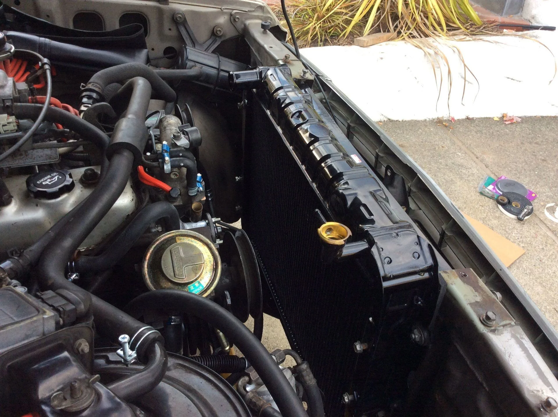

Louise is continuing to get up to speed: this week we replaced almost the entire cooling system, and a few other items:
Water pump/gaskets
Thermostat/gaskets
Upper/Lower Thermostat housing
Fan Clutch
All hoses that contain coolant
Oil Cooler Hoses
Oil pressure sending unit
Battery Tray

Still runs warm. It looks like a freeze plug on the side of the block is leaking, and one of the hoses is leaking. I'm hoping it's not the tiny little hose from the bottom of the water pump.

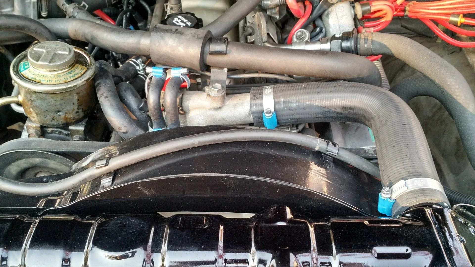

Okay, Bob's your uncle. Started up and never got warmer than a needle's width above the first third of temp gauge. Beno was the man this week getting me a couple of hard to get OEM hoses and thermostat. So the cooling system is refreshed, plus I changed the air filter and adjusted the kick down cable about a mm or two. Shee-it, I'm rolling in the big leagues and trying out those brakes! Not too bad either. Bath coming up tomorrow.

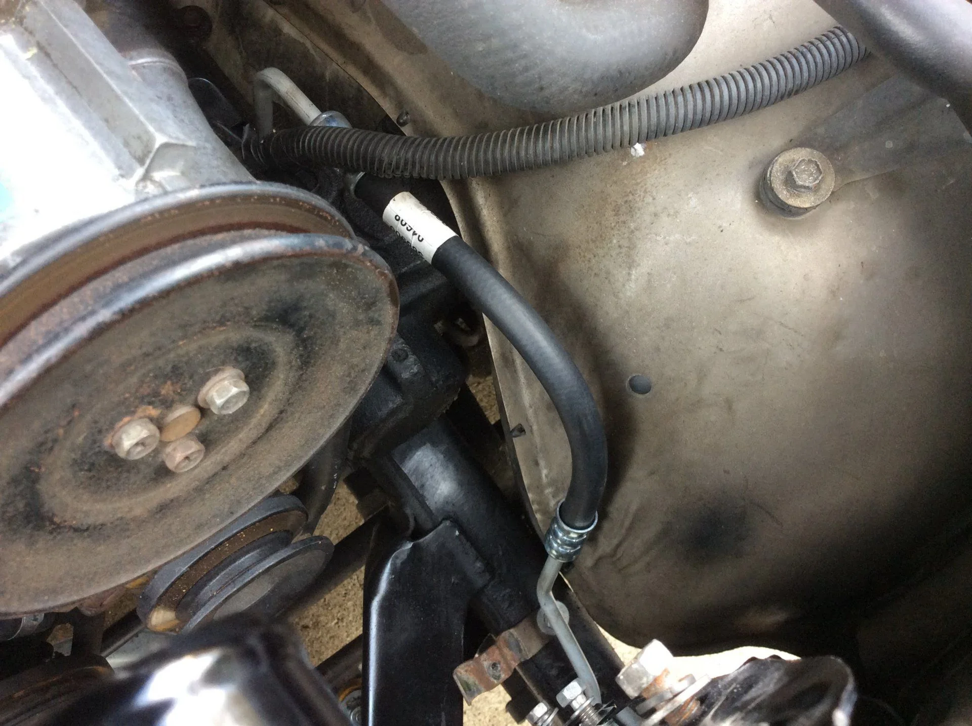

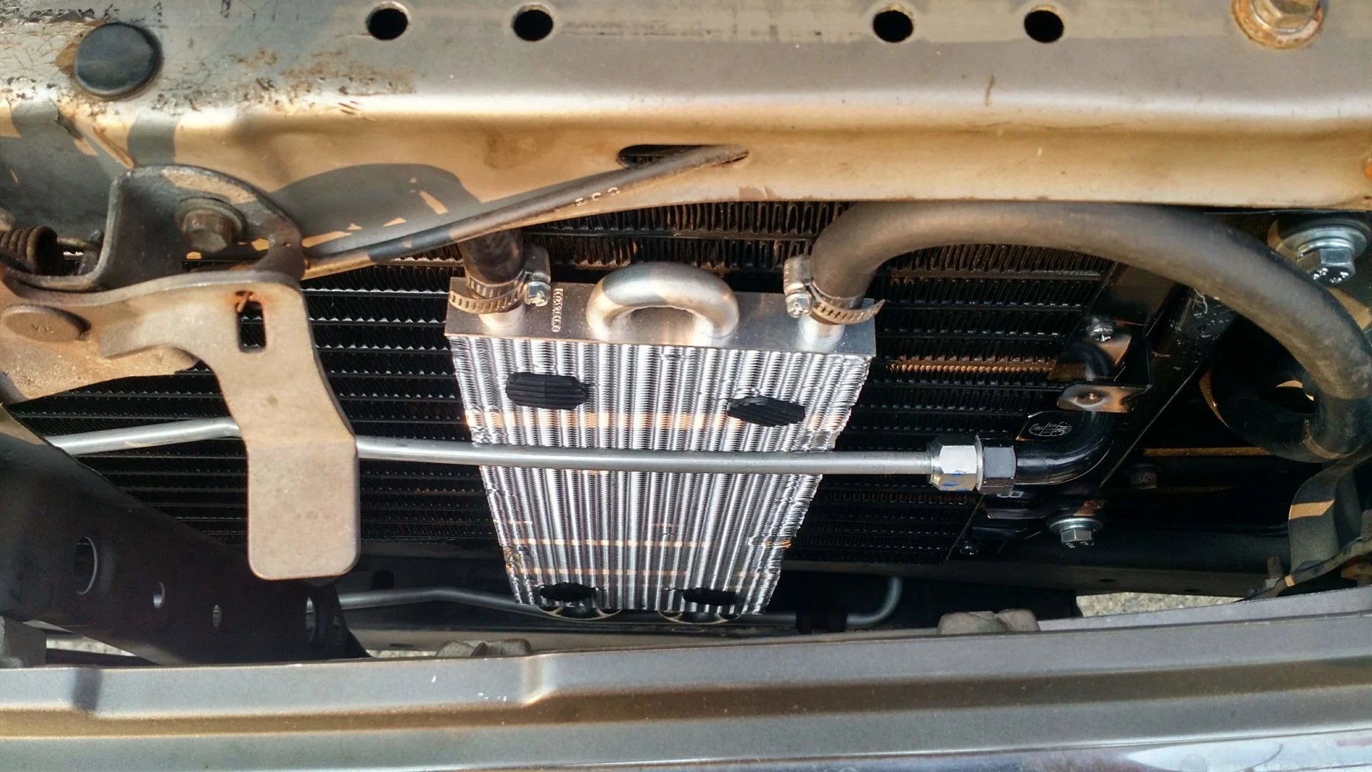

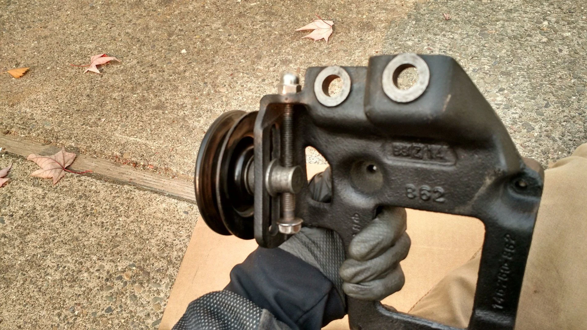

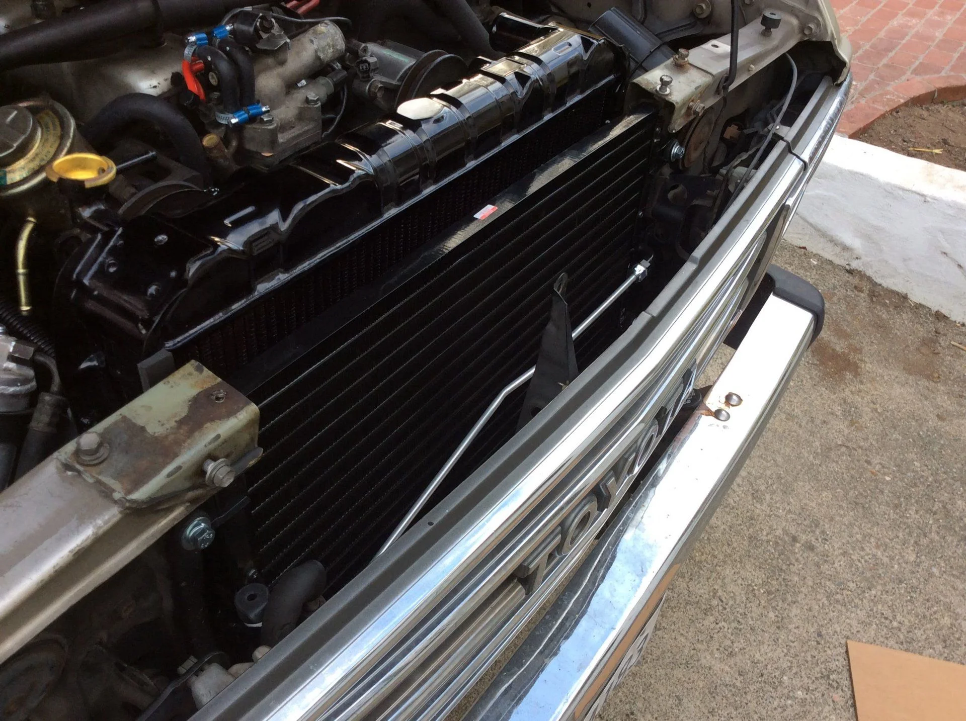

Finally got the auxiliary power steering cooler up and running, new AC Condenser attached, new Water Pump, new T-stat, gaskets, hoses, Water Temperature Gauge (didn't redo the upper and lower housing for thermostat). New oil-cooler hoses. Probably missing some things.
Anyway - its working and not leaking, so I am a happy dude.

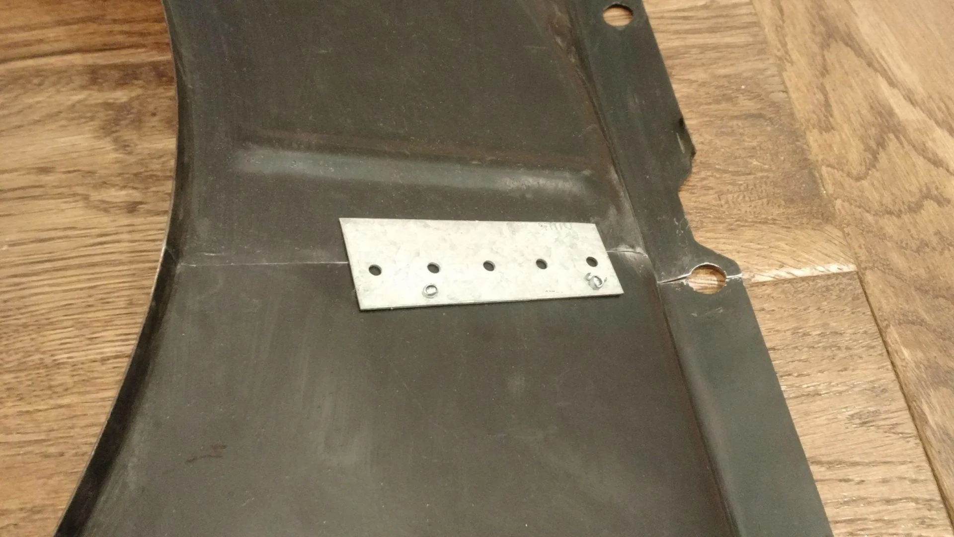

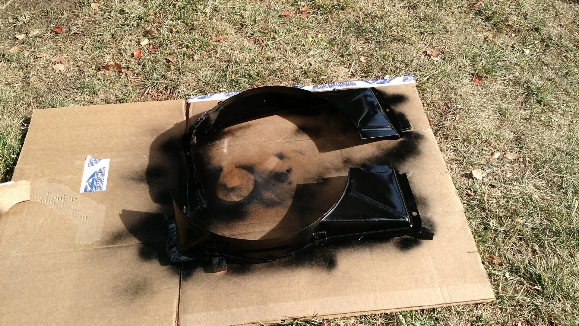

In the last little bit, since I had the front-end taken out already - I decided to perform the infamous fan shroud mod.
I decided to use some spare sheet metal I had laying around and drilled a few holes to allow for aluminum rivets to get in there.
After extensive cleaning, I decided to rattlecan with some rustoleum to help keep the shroud working for another number of years.
I was impressed with the results. And when I went to put the upper shroud on it was super easy. Well worth the time and energy.
