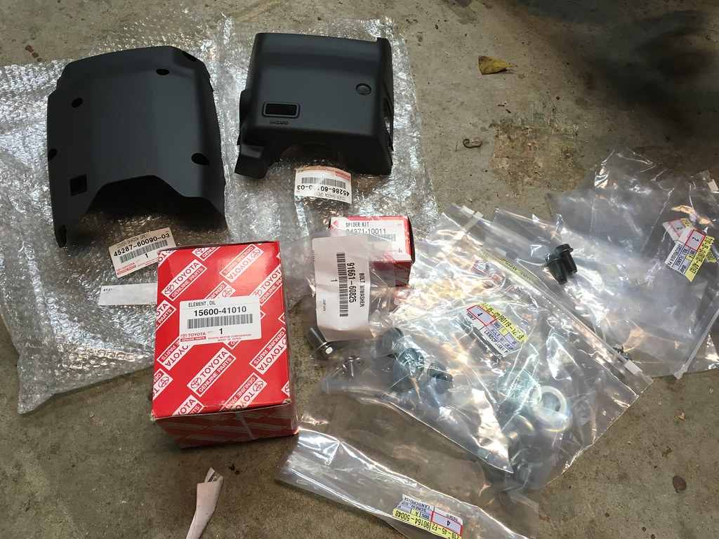

Received some goodies from @beno . He threw in a new oil filter as well! Best parts support, advice and enabler... :cheers:

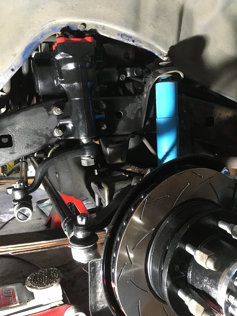

Installed the steering box and currently waiting on the 32mm socket to install the pitman arm. Currently painting the steering shaft protector and installing the new u-joint in the upper shaft. Then the steering refresh will be all done! :bounce:
Nice! Fwiw, I bought a 32mm socket from Lowe's recently when I refreshed my steering box. Took about 10 minutes to get there and back. Torqued it on the bench vise, I was surprised how easy it was to get to 130ft/lb.
@red66toy
Black clam shell? Plastic steering column surround?
If you haven't order the socket I have one and can meet up tomorrow AM to hand it off.
@red66toy
Its actually shadow grey, the lighting just made it look black for some reason. Definitely darker than the old faded/broken one.
I just got the socket in the mail (Prime! ). I should have just checked with you though, not sure I'll ever use it again. hahaha
Good to know hat the steering clamshell is still available!!! Scared to ask how much!!!
Yeah, I was shocked and happy to find out it was still available! It was around $100 for the whole thing. Mine was broken (the screw terminals) and it rattled a lot which drove me crazy. Plus, since the last one lasted 28 years, it was a worthwhile investment to me :)
