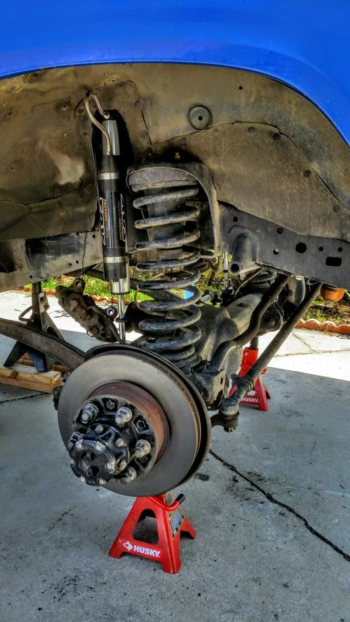

Getting ready for some front axle/brake/suspension work this week.....

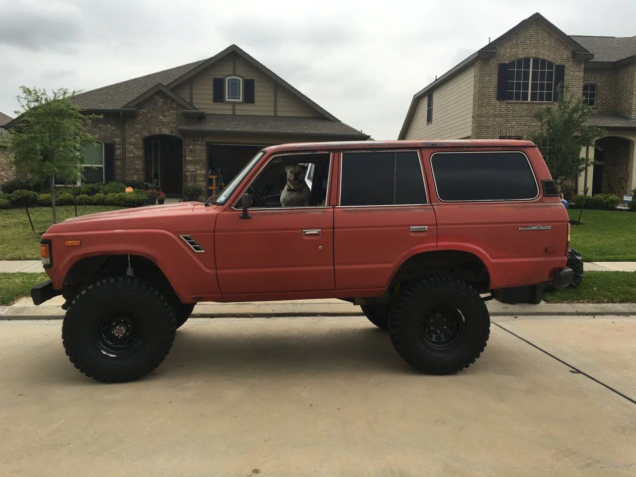

I got an inspection done. Guys at the shop were all amazed at the condition of the interior. Said that they have newer vehicles come in that are in worse condition than my 1984. Safety only on this thing here in Texas, they didn't even pop the hood. :grinpimp:

Anyway, I like seeing your 80 suspension as much as possible. Gets me motivated to do something similar in the future.

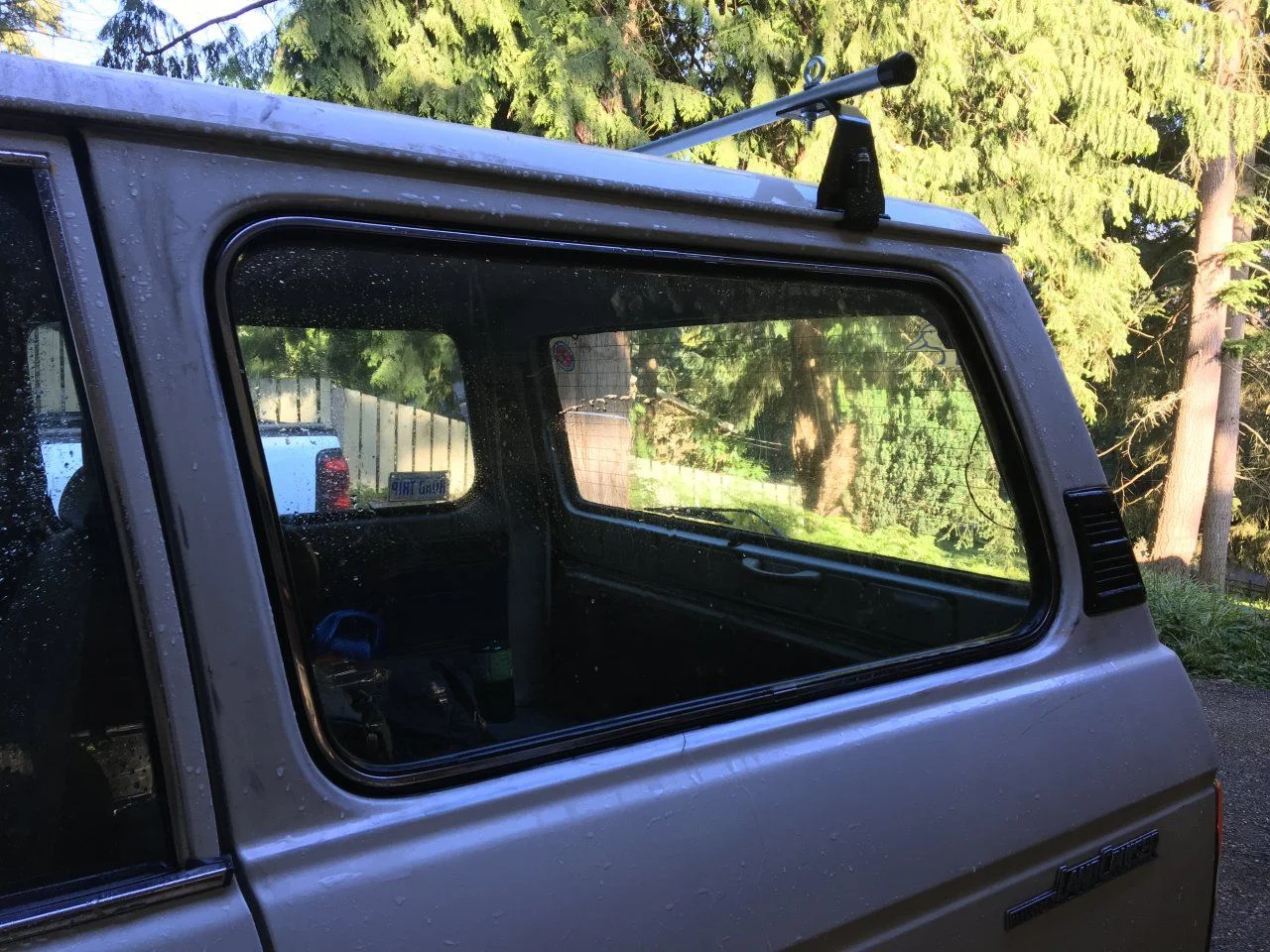

I shouldn't have been scared, 10 minutes with a 10' piece of paracord in the gasket lip and some spray soap and I am back in business (chrome strip and all - only kinked it a little in one place.) I did have to give it two goes as the upholstery towards the front was actually folded over the pinch seam and wasn't letting the gasket slide over, so I just took it out and put the front lower corner in first and she went right in pulling the paracord.
Thanks @torfab for having a window!
I did call some shops Jason - lowest (reasonably close shop) quote was $125 and they couldn't get to it for a few days. None of them seemed all too pleased to quote the install a window they weren't providing. You must have a good glass guy.

@reevesci you may have noticed your work on my roof - got the mounts in last Friday, thanks they are great. Nice touch on the metric hardware. Put me in the que for a rack to throw up there when you are set up again!
