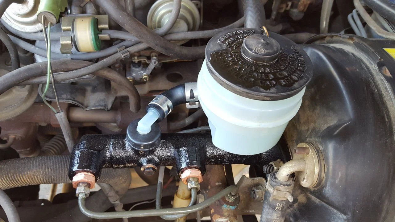

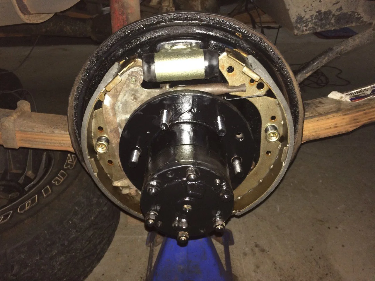

New brake master cylinder installed, new SS brake lines and flush/replace brake fluid. Stops on a nickel now!

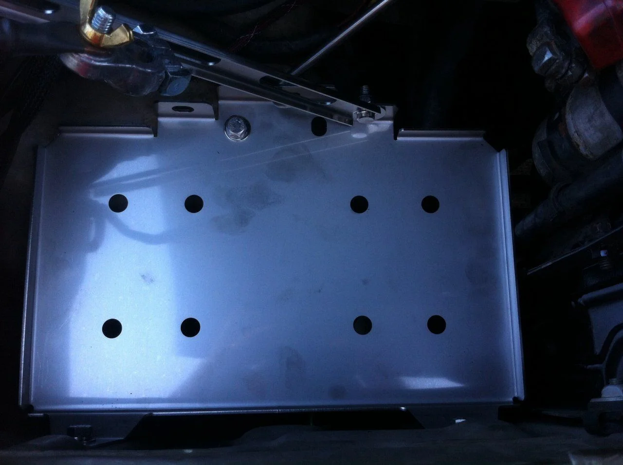

^did the same about a month ago with SOR regulator and crank handles. Just broke the knob off my brand new crank handle this morning. Not impressed.

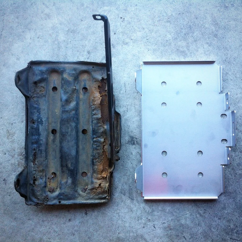

1 new e brake cable

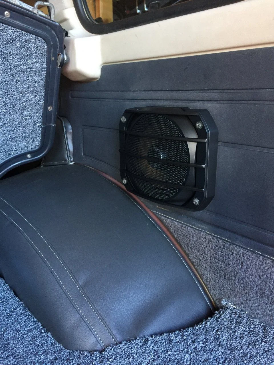

More of the same. Radiator came out to do the PS pressure line. A new one is going in since this one leaks. The wife did a good speaker upgrade in the back though. She also took the front door cards off and did some work on the front windows.

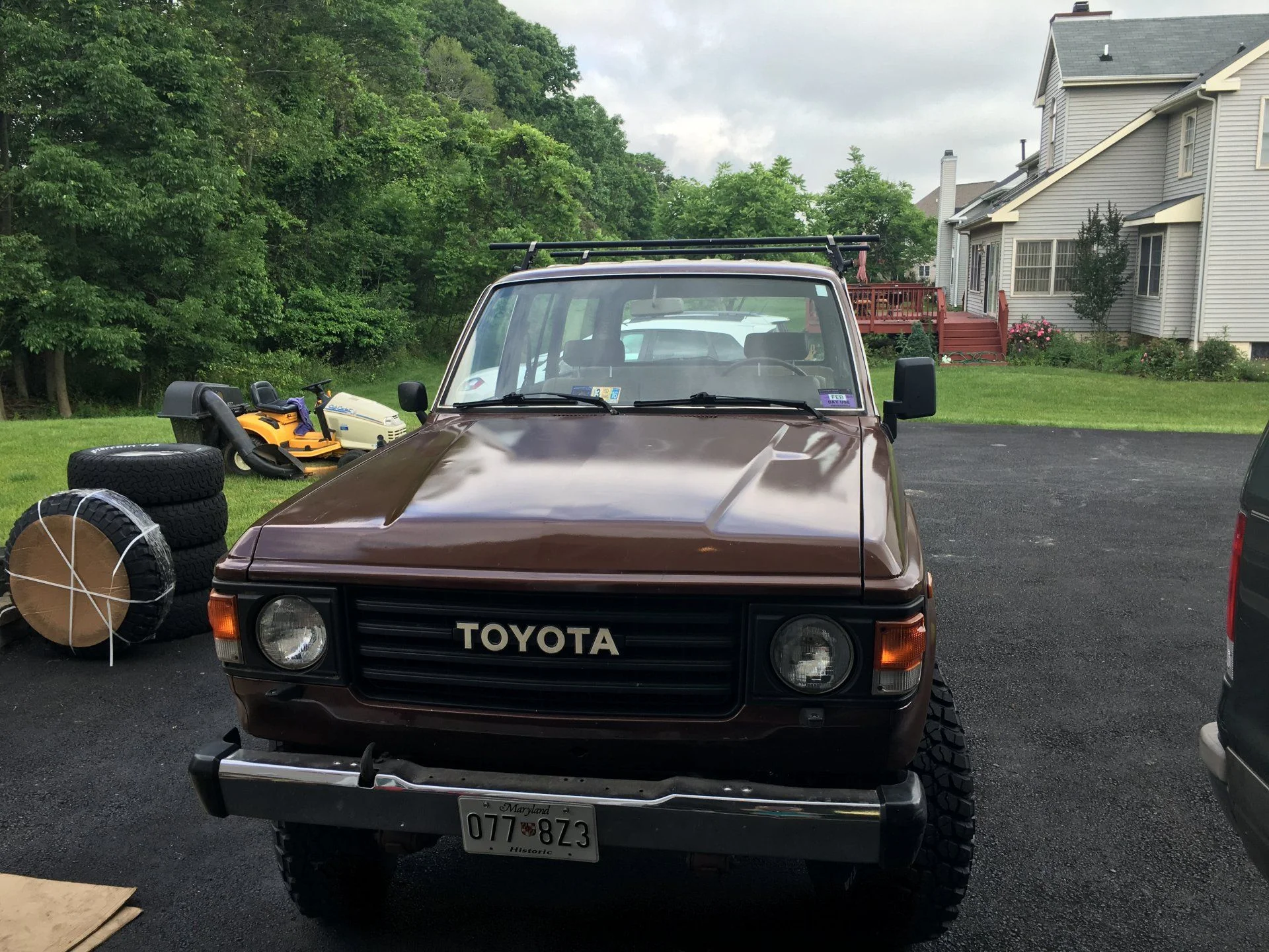

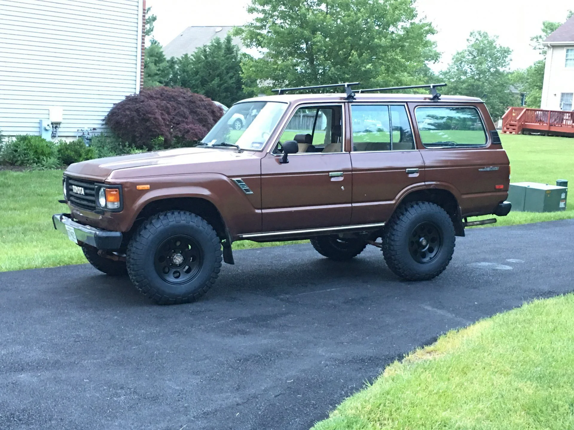

Spent Friday to Sunday in the garage getting weeks of parts orders all put on she came out like a new truck. No interior shots yet but got the Tuffy console in and GPS set up, as well as the leather wrap steering wheel and wired LED driving lights.
Before
After

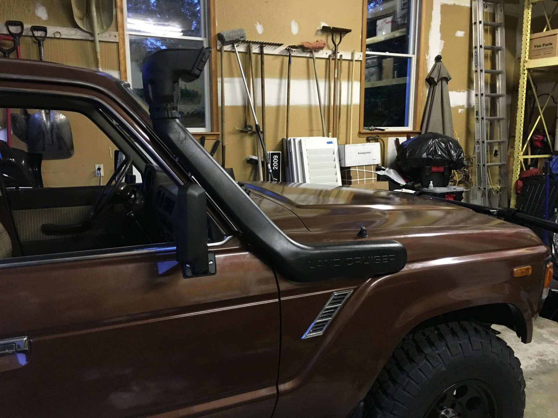

Snorkel install

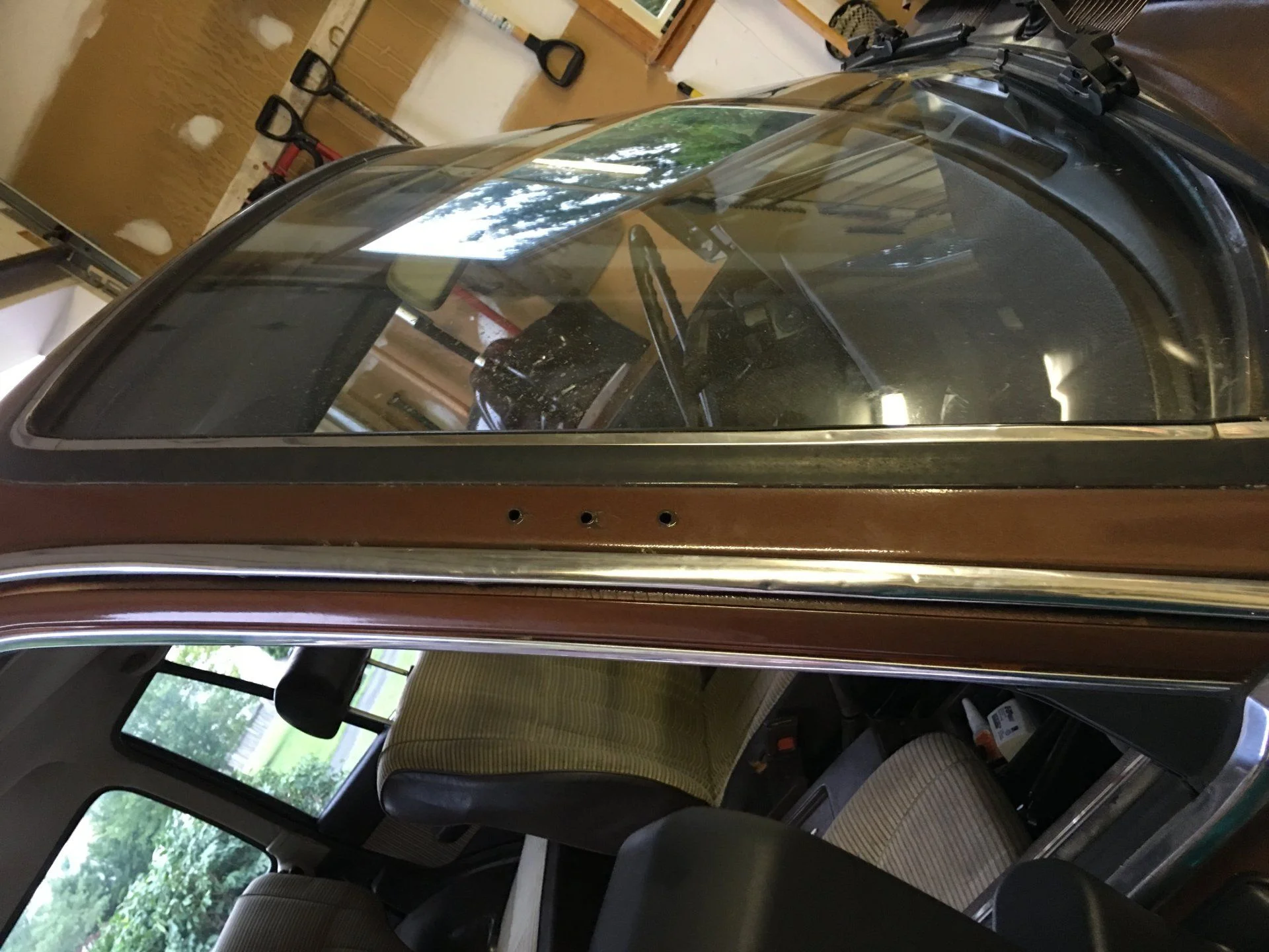

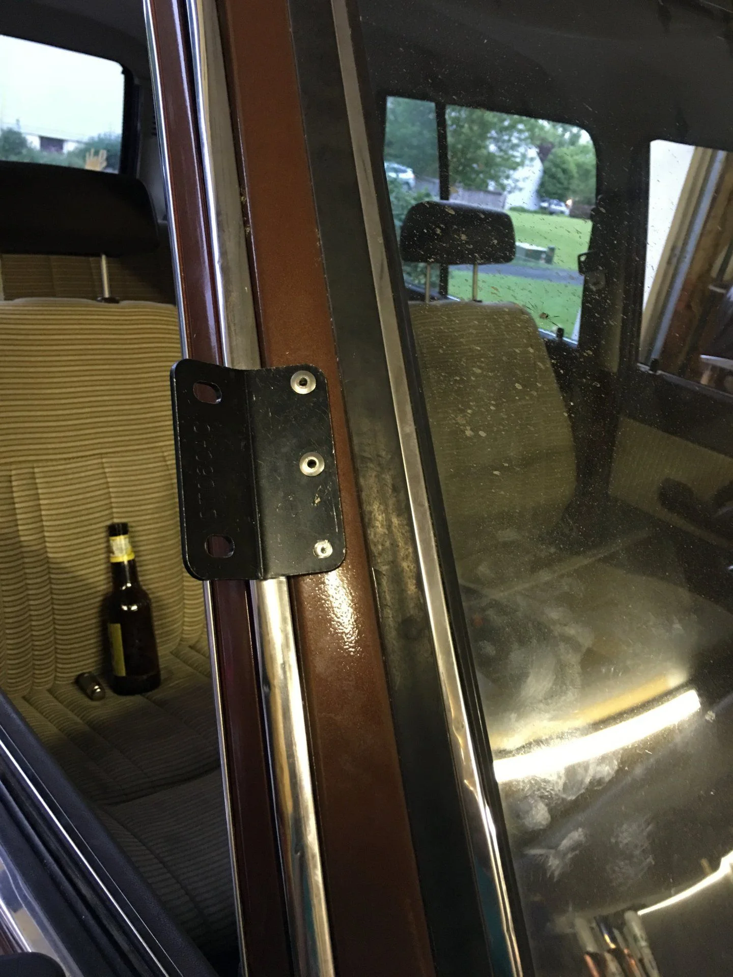

@Breitz6989 Were you able to get a nut on the stud for the hole closest to the a-pillar? I couldn't find a way to reach that far back in the fender and even tried going in through the fender vent.
Not a chance as soon as I drilled it I was like ah crap this is probably accessible on the driver side when it's RHD. I sealed the bare metal and plugged it with a piece of rubber I had. The riveted brAcked and 2 bolts was
More than enough.
Before
After
Snorkel install
New vs Old mirrors
so the small hole in the template closest to the front of the fender is for locating the large hole cut-out
