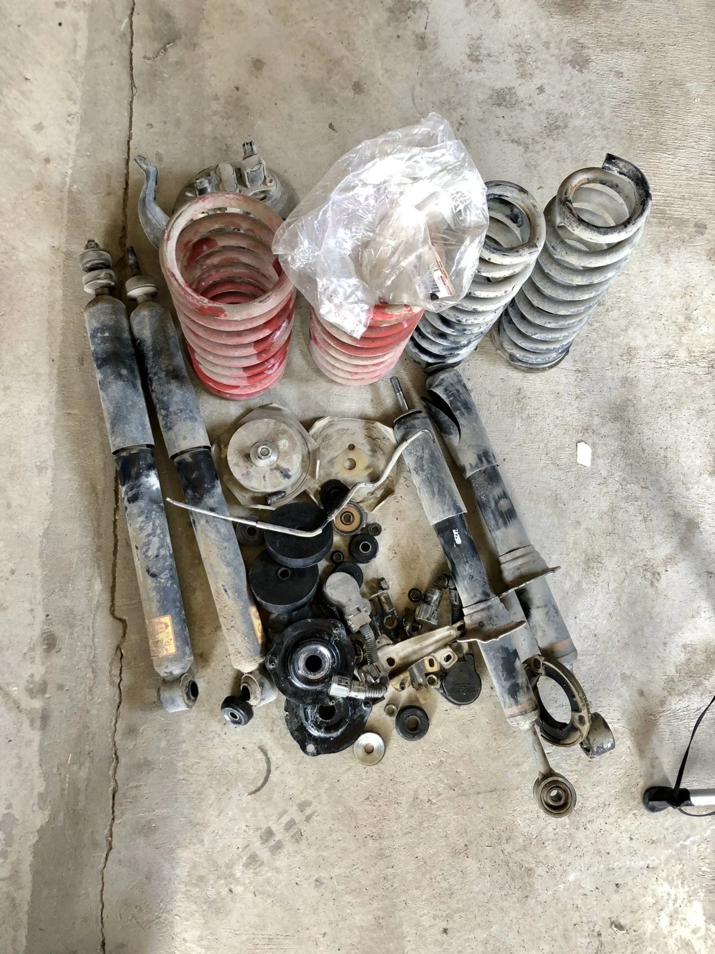

Well, I didn’t start this work today but I finished it today. I ended work early and started to replace the rear brakes. While I was there with the wheels off and everything, I slid the rear shocks and 895 springs on in. The old Strutmaster kit looks like it had seen better days, no idea how long it has been installed.
I was optimistic and also started to replace the front suspension items. In retrospect, I should have not started that at 2100 hours, but I did. The top hats on the original assemblies would not budge! I was able to get the passenger side mounted and setup around 230, I gave up on the driver’s side at 430. Long story short, all replaced now and sitting with a nice angle. Those Strutmaster coils made the GX point down a little, which was really noticeable at night with little or no load.

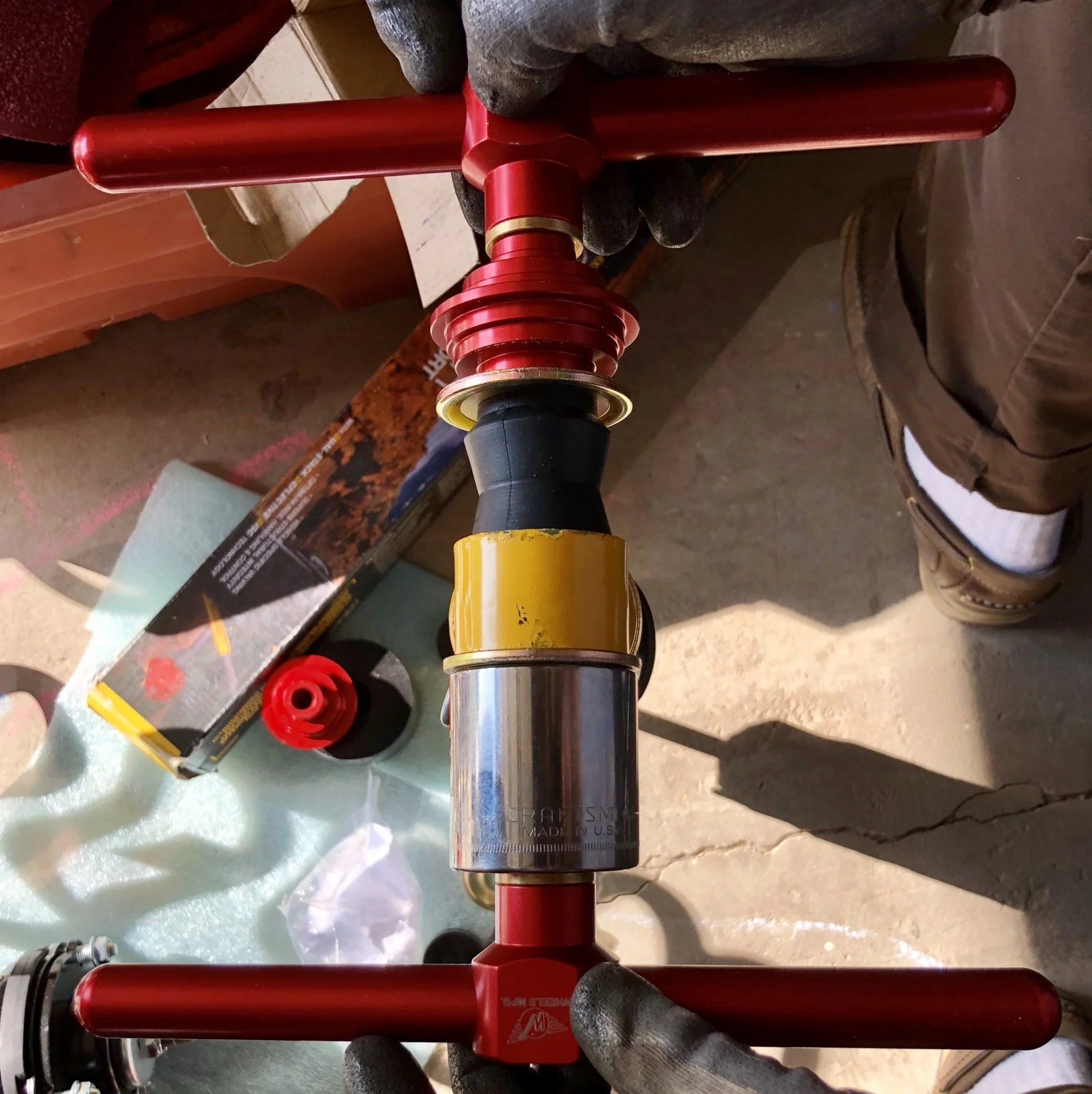

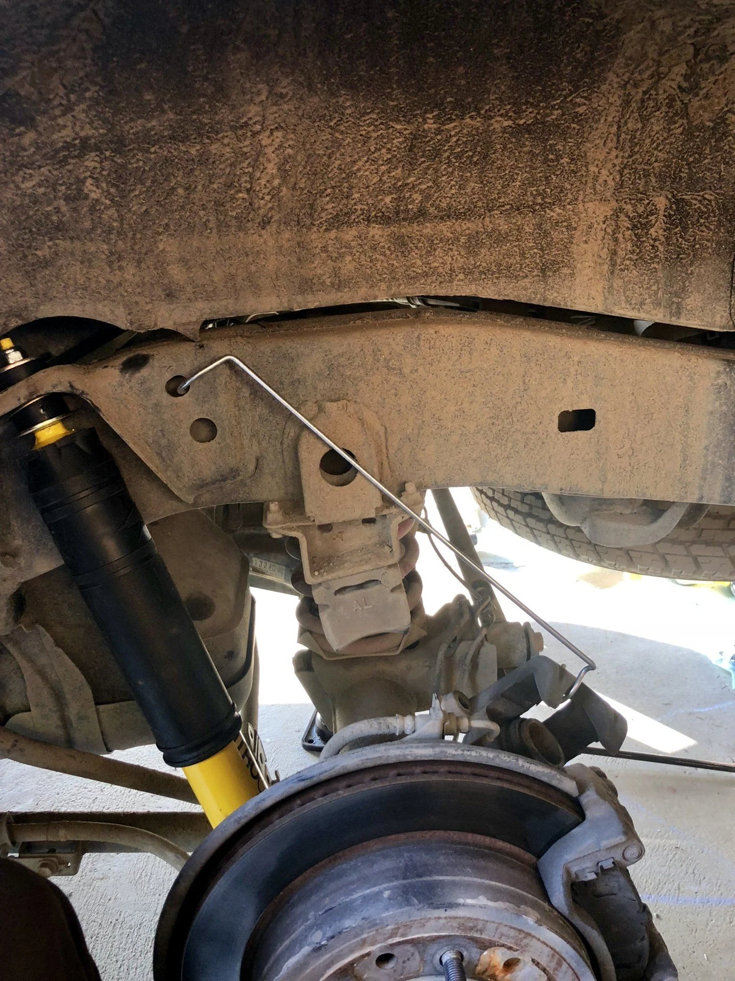

I did have to get crafty to install the rear shock bushings. I ended up using a bike bottom bracket press tool, worked great! I also used the shock retainer items to hold up the calipers and sway bars.
nice!What you gunna do with the take-offs?
What all came off? factory fronts or an aftermarket?
and what again di you put on..front and back?
I have no idea what was installed in the rear section. The hardware is badly damaged, not just from removal. The front appears to be straight up original and already trashed. It looks like the rear coils had hockey pucks holding it in place, pucks that were retired after a hard NHL season.
We installed a OME 885/895 combo. Nothing really fancy. We regularly have weight in the back (people or items) and the 3rd row is installed. The rear suspension is using factory components to hold the coils in place. Most items came from RRO. They do a nice job with service and price.
