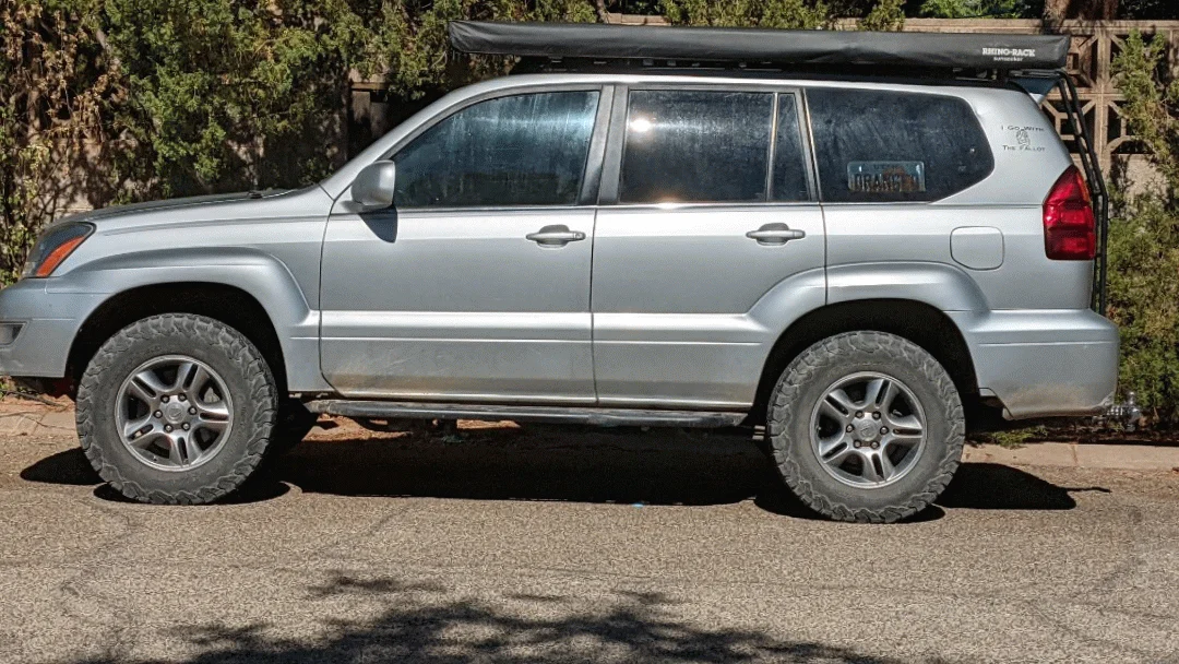

I am lifted 1.25" in the front and 1" in the rear on standard bags and lexus adjustable shocks. I tow as well and really appreciate keep the airbags. I run a .75" spacer on the front strut (and correctly space the front bumpstop), and then just use washers on the height sensors in the rear to make it run higher.

I ran a 0.75" strut top spacer providing 1.5" lift in front and washer spacers to rear airbag sensor providing 0.5" rear lift for 7.5 years. Daily was fine, auto levelling worked perfectly, with hi and low height adjustments retained (for trailer loading and slow speed crawling respectively).
Here's a gif showing ride low, normal and hi ride heights
I then fit 265x70 17s with a little front rubbing fixed by massaging the fender liner.
Quick side-by-side stock rig on stock all seasons left, mine on front spacer and AT BFG KO2s right
Retaining auto levelling is awesome.
Here is loaded for a 2 week road trip; bikes and racks add like 250ish # hanging off the bumper, let along the camping gear on roof, kitchen, cooler and gear in the back, plus 2 pre-teens.
Its been very functional for daily, long-haul road trips, multi-day camping trips and off road adventures. It even wheels mild-light hard trails and even amazingly while loaded around where I live...

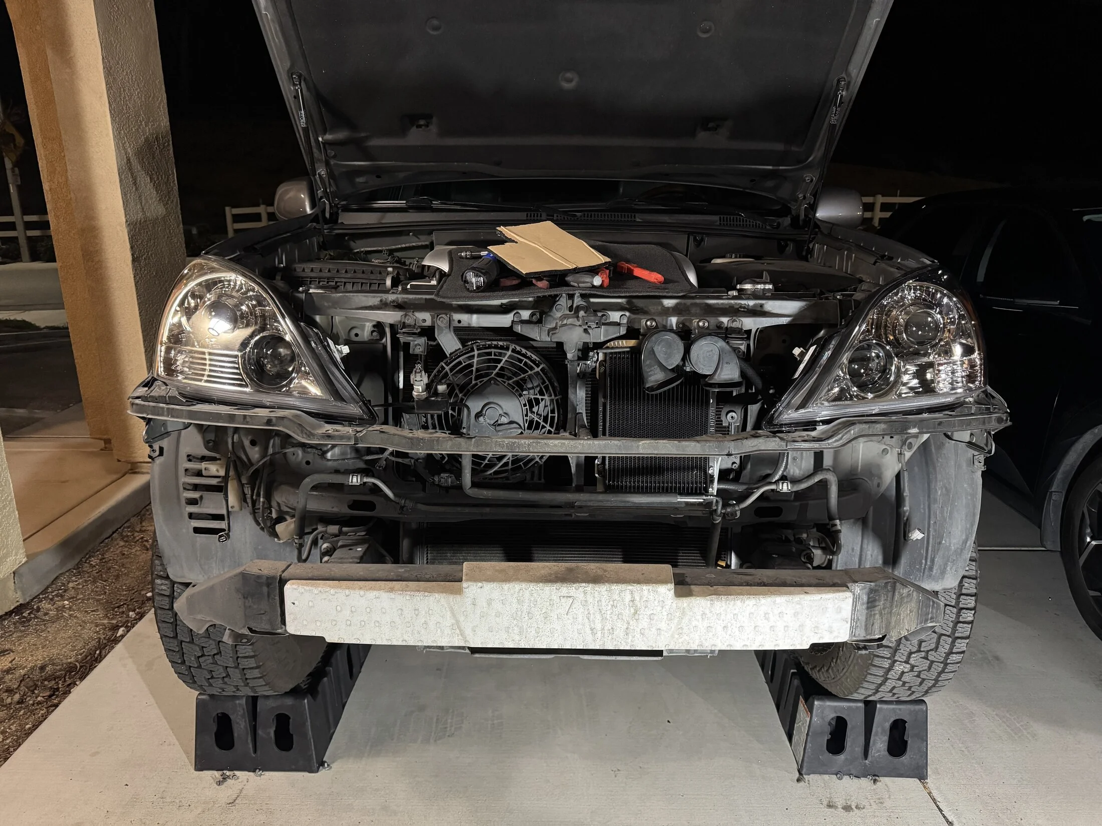

Installed TRQ HLA90500 headlight housings with the Sealight LEDs swapped from the factory housings. Did a restore on the factory housings which looked good for a few months. Overall they looked better than pre-restoration, but they were cooked. TRQs are great after getting them aimed last night.
Added LED bulbs to the foglamp housings purchased from @zzyzx85

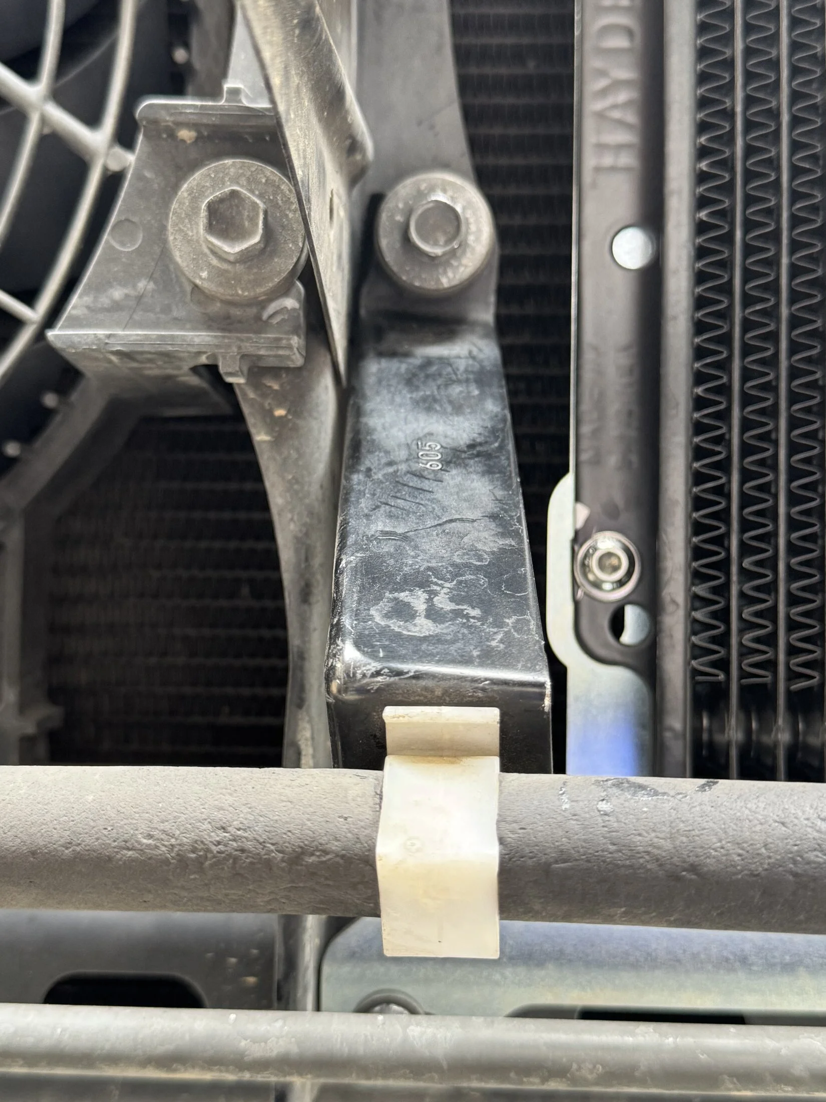

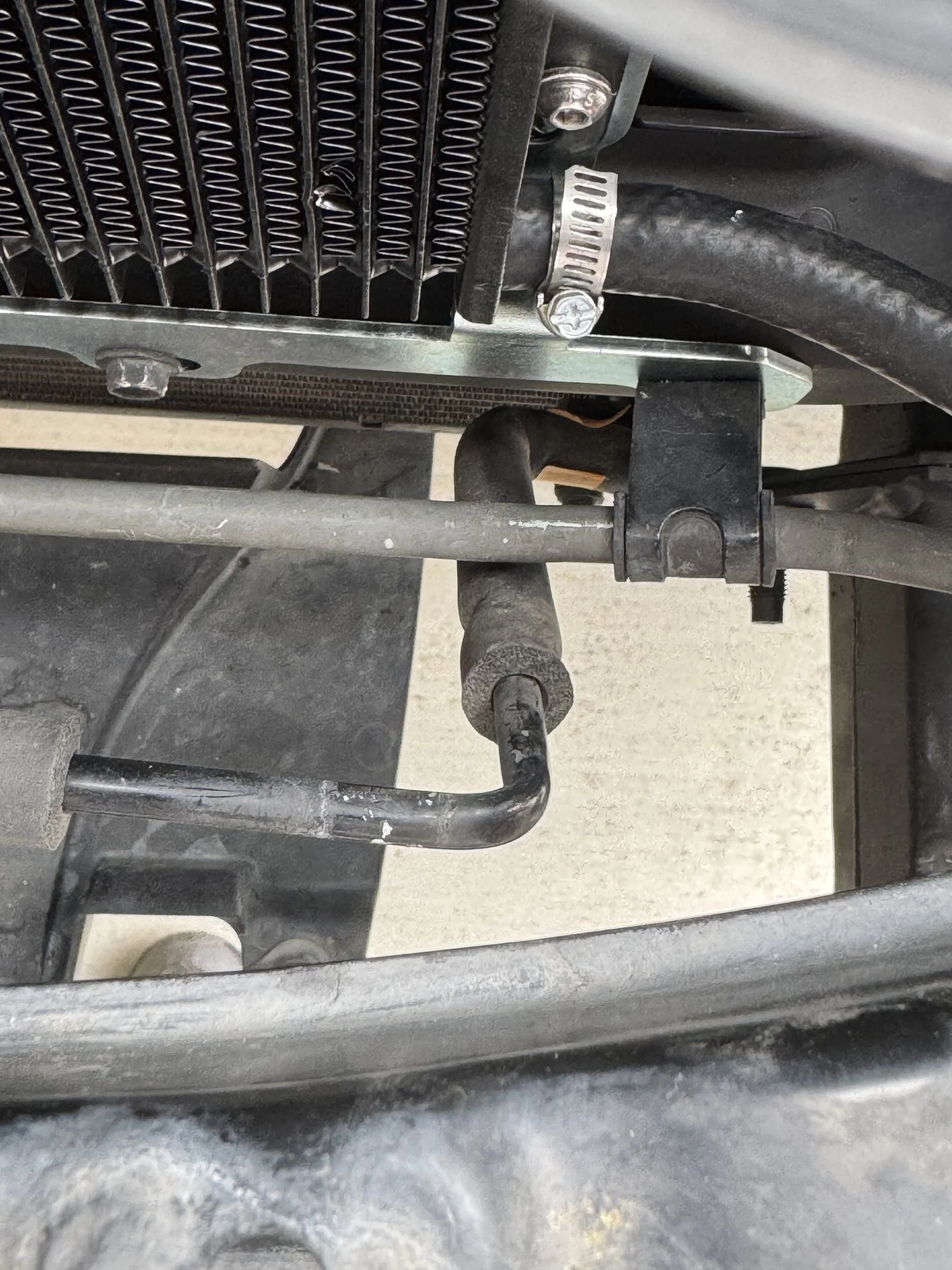

Mounted the hard AC line that was unsupported post Hayden ATF cooler installation. Modified the original bracket, mounted, and bent it into place.
Took the bulge out of the underside of front bumper on the driver side from the PO’s collision.

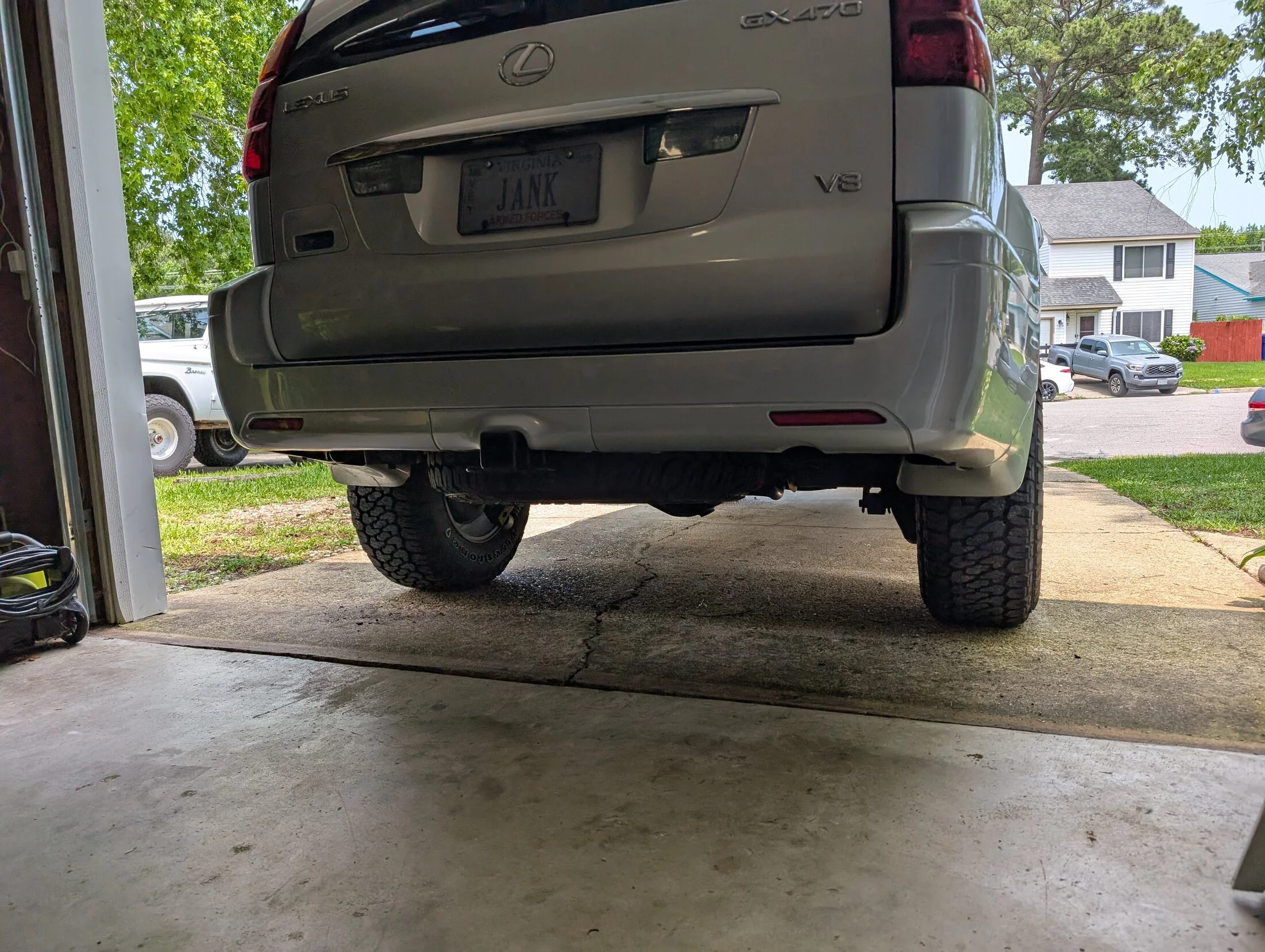

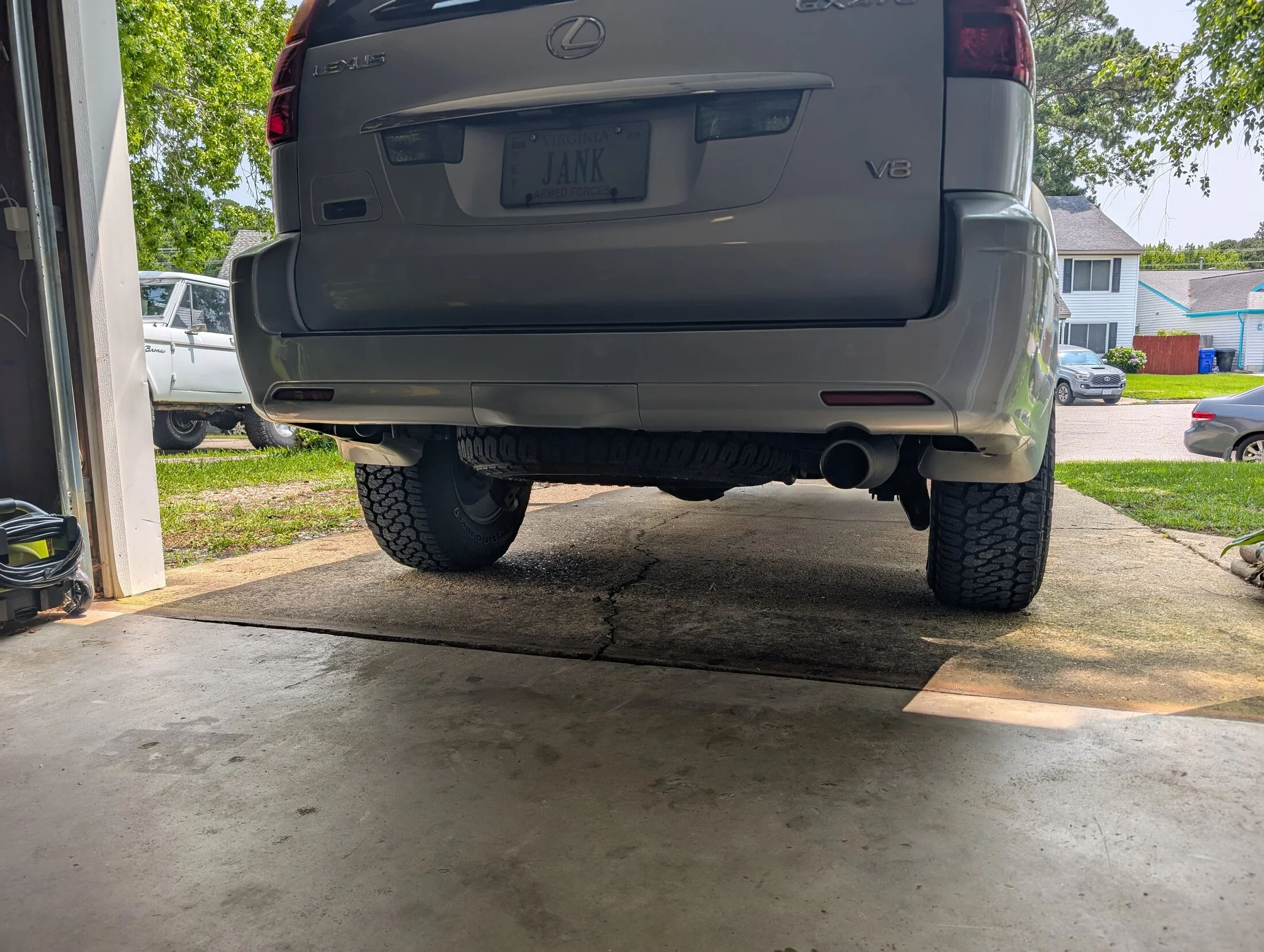

Popped off the rear bumper cover to install a new low profile hitch receiver and the associated bumper filler that I painted the day before. I chopped off the rear resonator just above where it starts to curve aft.
Before:
After:
While the bumper cover was off, I took advantage and extended the rear diff breather to the space behind the fuel fill.
Lastly, I extended the HVAC drain down past the frame rail. No pictures of that. Plenty of those all over the internet.

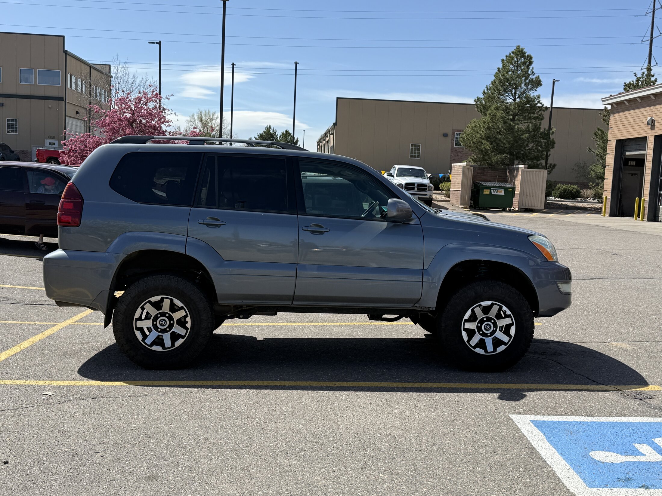

Finally installed my Dobinsons IMS a few weeks back.
C59-302 springs on the front (2” stock weight)
C59-505 springs in the rear (1.5-1.75”) with Firestone helper bags. the rear seemed to sit higher than 2”. Didn’t grab measurements from the axle to fender prior to install.

Wow, this looks great. I just picked up an Ash Blue Mica 03 a few weeks ago, after driving a 4th gen 4Runner with this exact setup for the last few years- IMS, 302/505 springs, and the same wheels. Happy to see it looks this good on the GX too as I loved the suspension and wheels on the Runner.

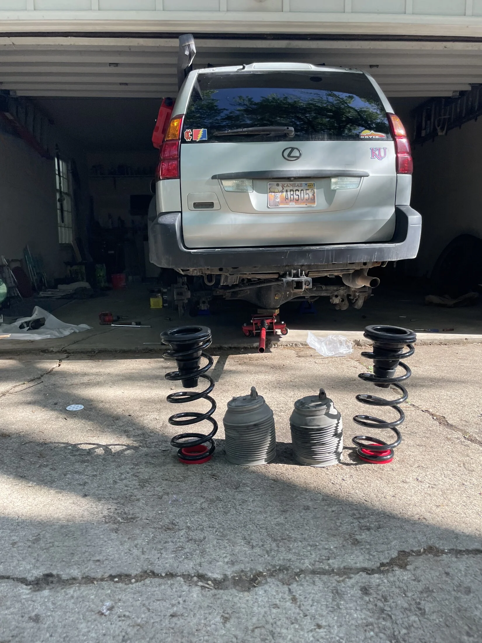

I’ve been slowly knocking out little things. I replaced the rear bags with some 3in springs. Super easy. Replaced the height and ride switch with an aftermarket plate that dropped right in. It’s machined aluminum. Added two switches there. Had an alignment done at a local shop. Just keep running gravel roads real fast on the way to fishin creeks!
