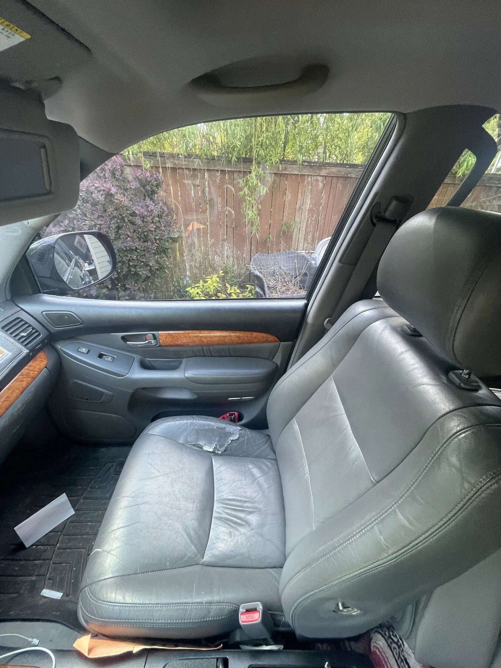

Installed the Coverado seat covers and the armrest covers, both from Amazonia. Are they as good as a full reupholster job? Nope. Are they the perfect combination of price, quality, and value? Yup! Very happy and a nice upgrade for the next 175,000 miles.
Before:
After:

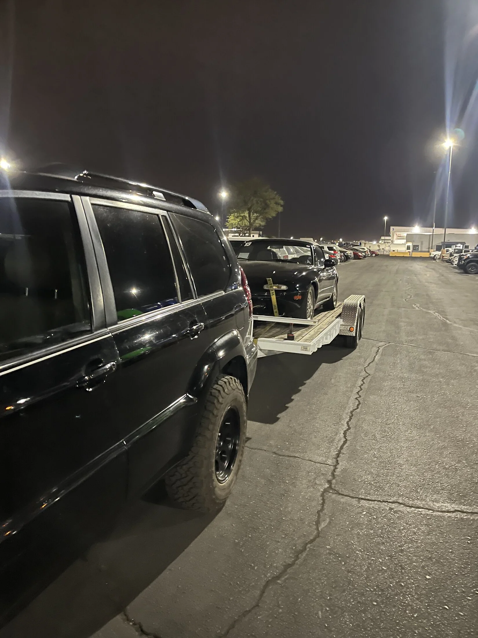

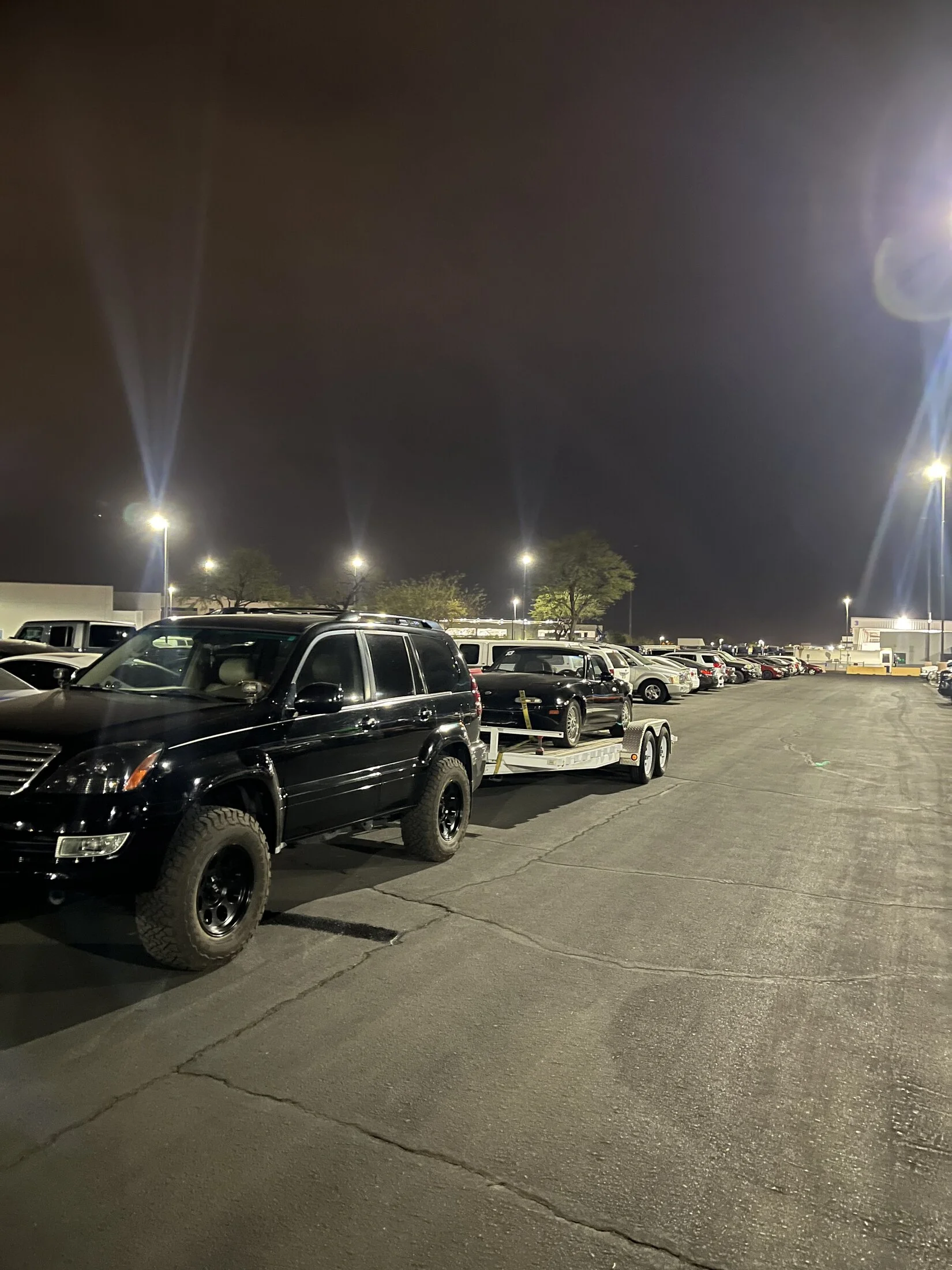

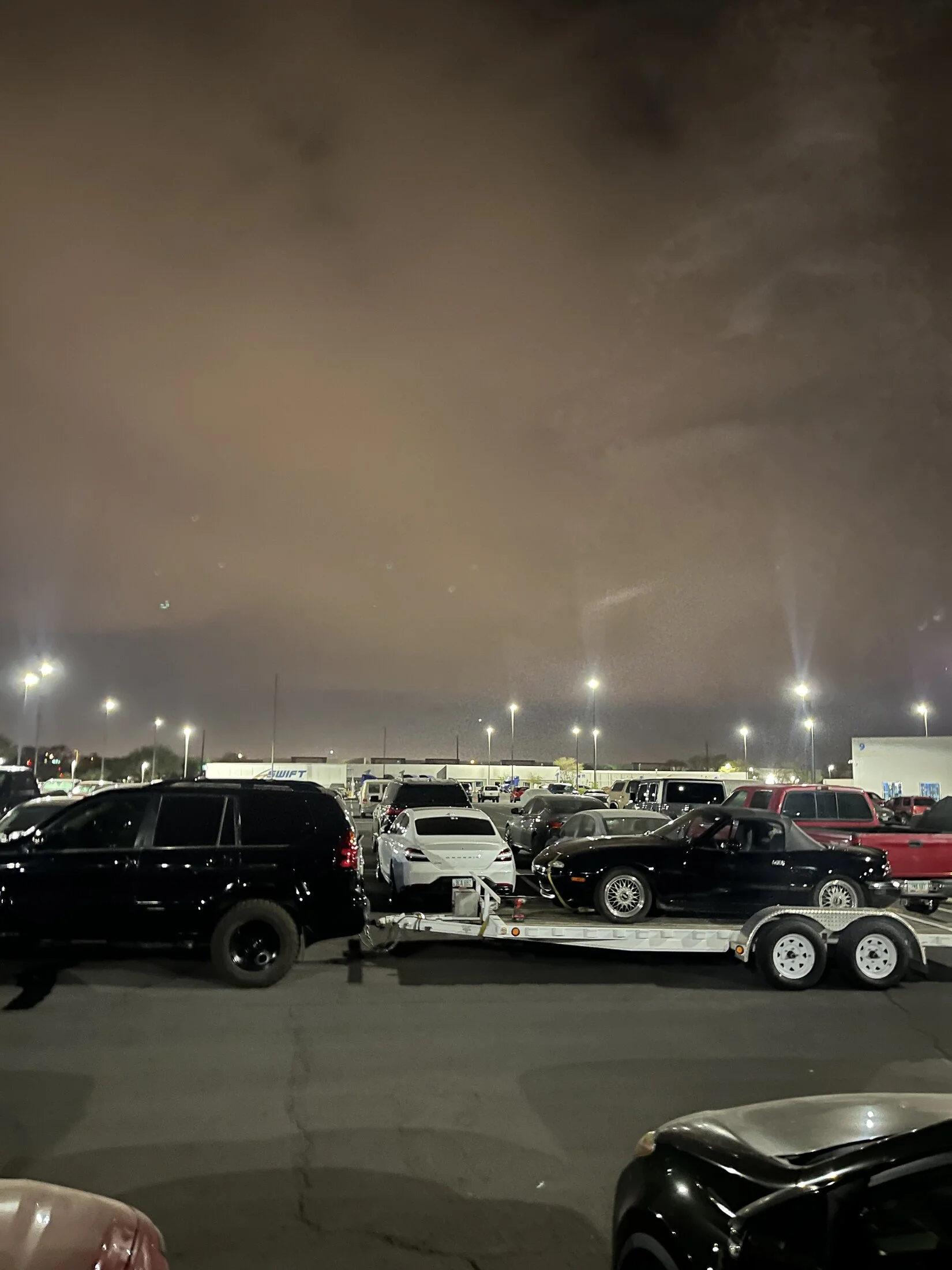

Also dropped off a load of curbing.
We almost need to make a "GXs at Work" thread to show just how good these rigs are at dragging trailers, tools, and materials around :).
Aluminum car hauler? If so, that looks nice! I'll eventually want a 7x17 or larger flat deck trailer for hauling my tractor and other large items - and will have to consider DIYing a lightweight one out of rectangular steel tube or buying an aluminum trailer.
Standard car hauler. Dove tail, weighs about 1100lb. It does have removable sides that bolt on. Hardly ever use them. It’s a PJ trailer. Bought it new in 2017. Been great, no problems at all. Just maintenance, repacking bearings, adjusting brakes and tires.
Thanks! That's super-light. The last tandem axle flatbed I rented was a steel equipment trailer and must have weighed 3,000+ empty. The GX pulled it but it was super-saggy in the back and a bit rough-riding.

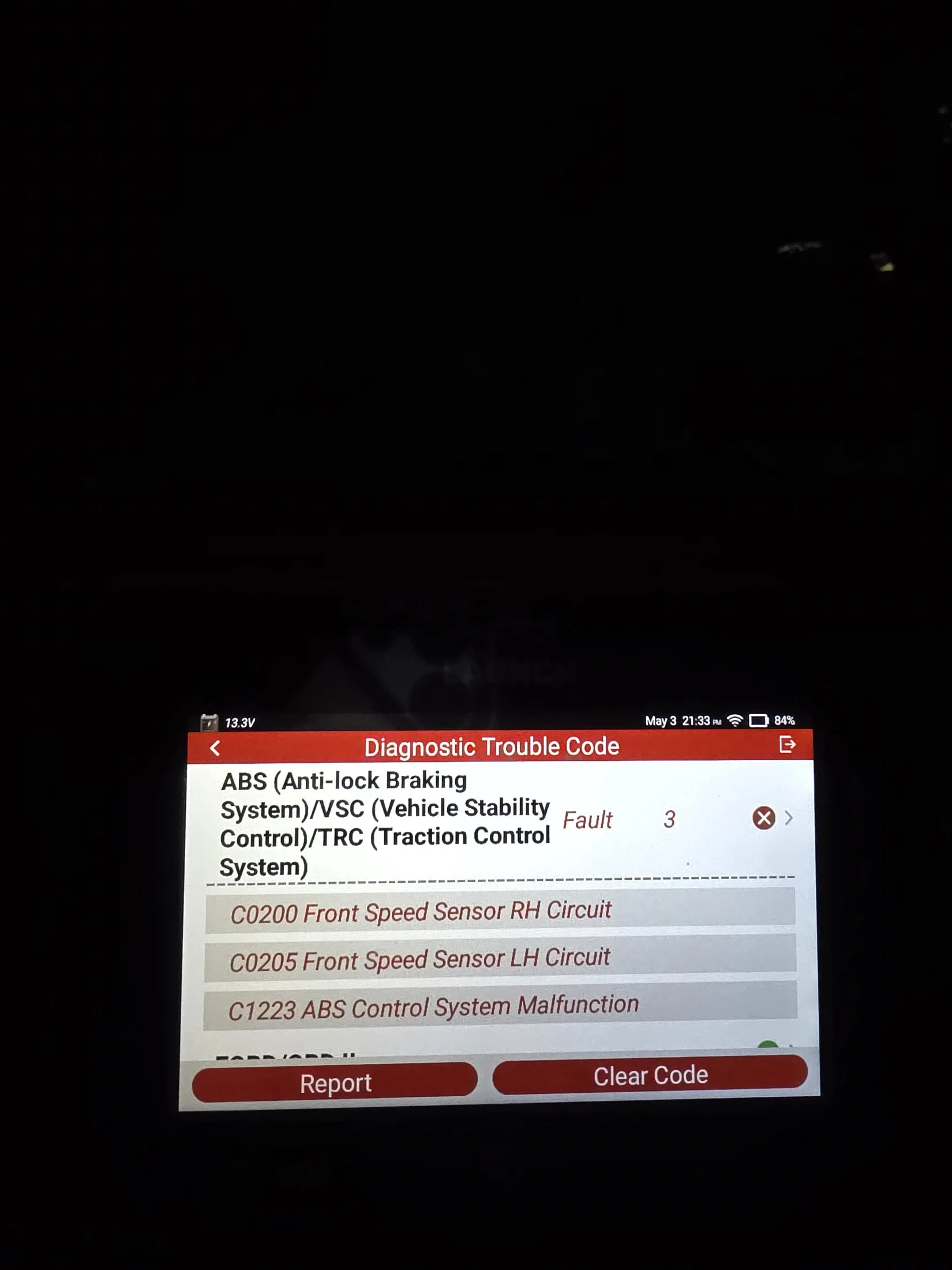

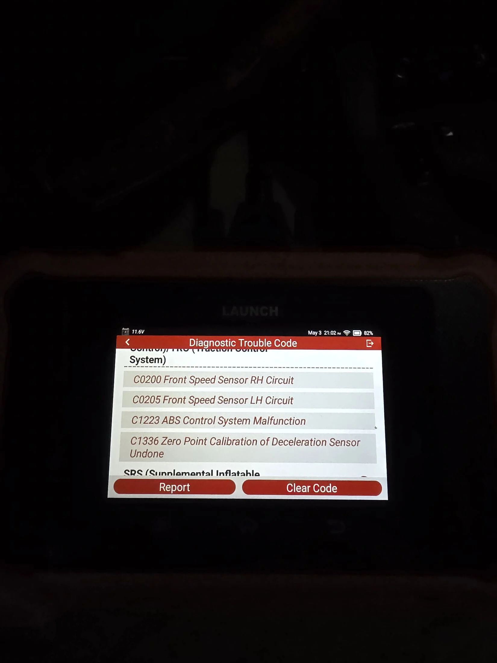

Well you were right. I damaged both abs cables smh. I purchased this SCAN TOOL
which is similar techstream. It had mixed reviews. Figured I give it a try. I purchased the unit with Toyota/Lexus software preinstalled. It was on sale at the time $150. I can purchase other manufacturer software it need be in the future. It was nice to actually see what was going on with the truck instead of throwing parts at it. Both front speed sensor were reading zero when driving. Replaced ABS cables from the local pull and pay. Everything good now.
I was also able to complete a zero point calibration and turned off DRL.

Those ABS cables need to be sweet talked when being touched. Congrats on the fix.
