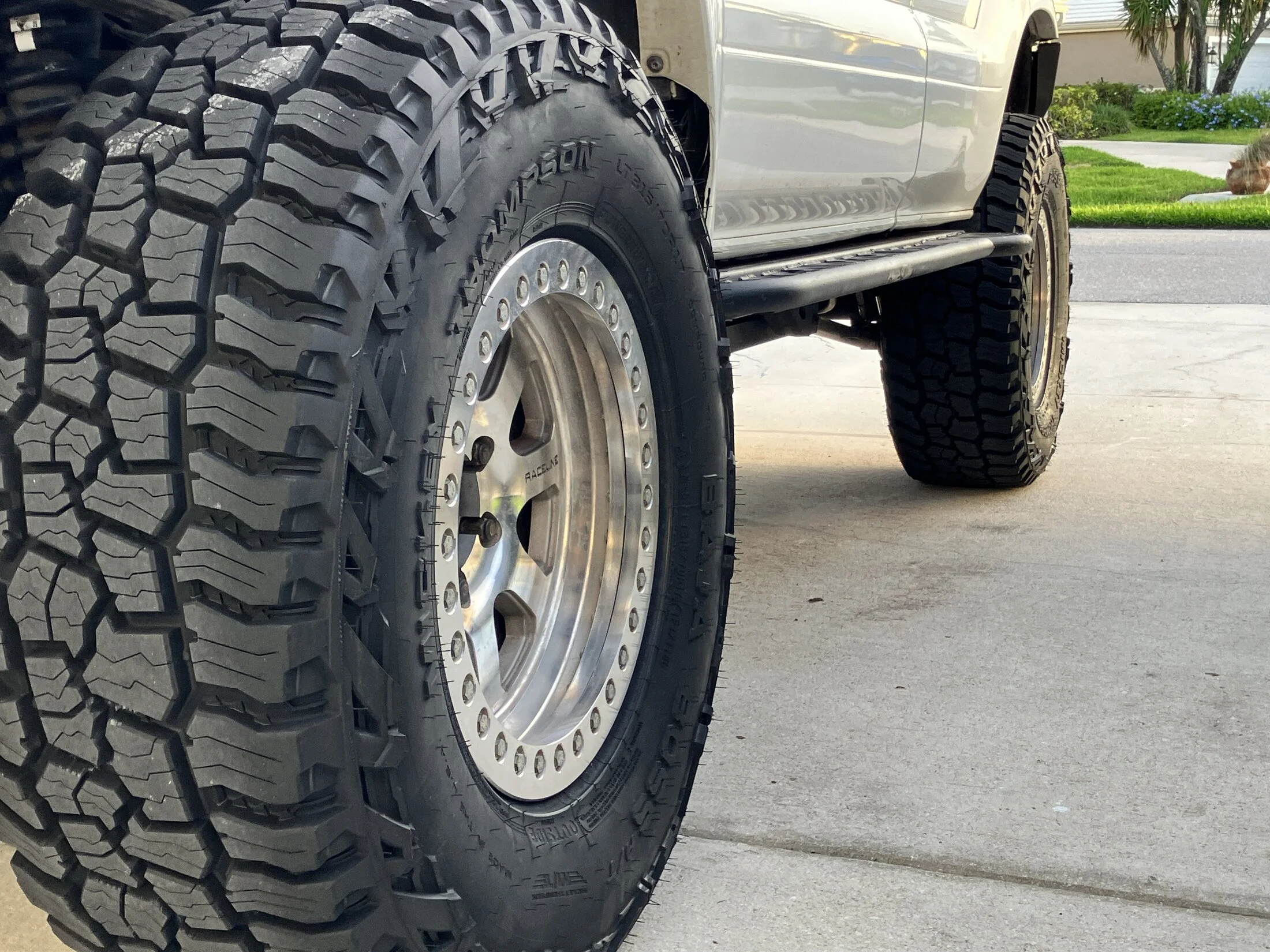

New Tires

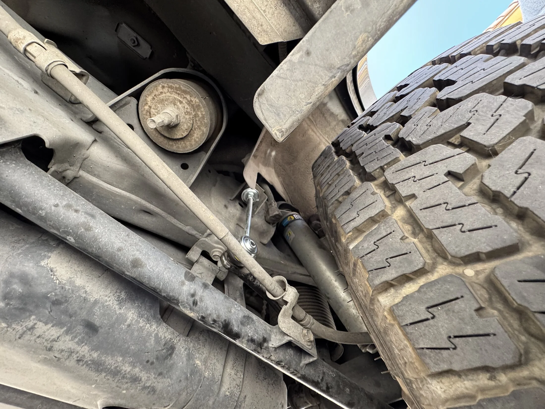

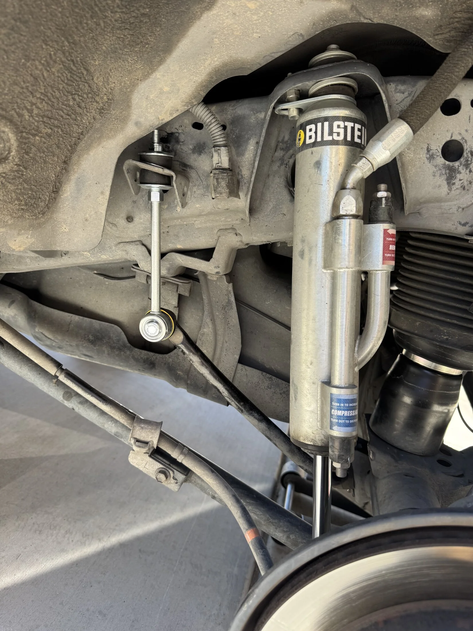

Installed 2nd Gen 4Runner rear stabilizer end links. The extended travel of the dampers really distorted the original end links. Torqued all rear suspension bolts. Found the rear UCA bolts needed a few ft. lbs.

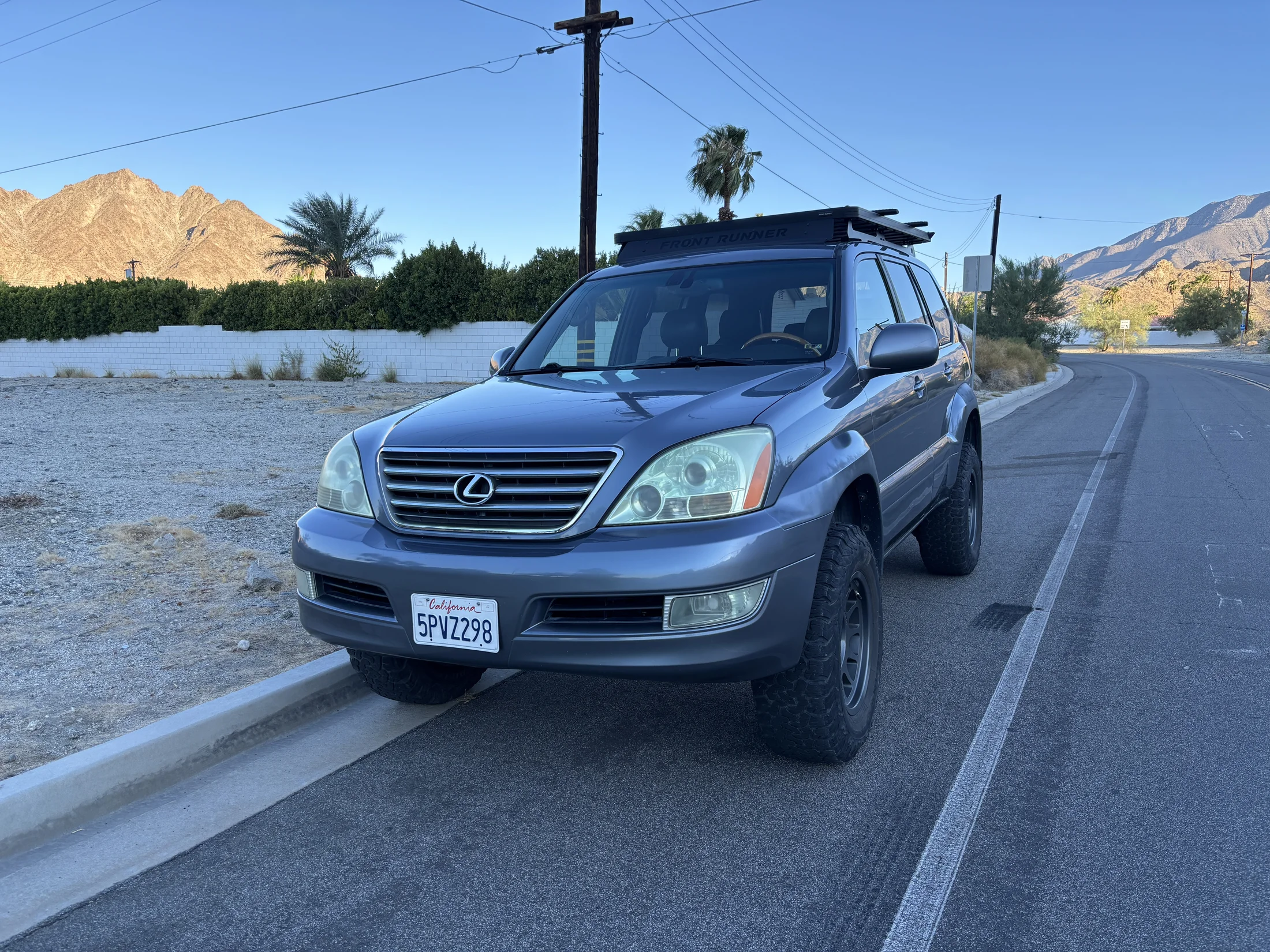

Scraped all of the dead bugs from the front :) 3000 miles through desert, mountains and PNW coast. Besides couple minor scrapes and slow PS fluid leak I didn't have any mechanical issues. Turned 275000 on odometer and hope to keep going.

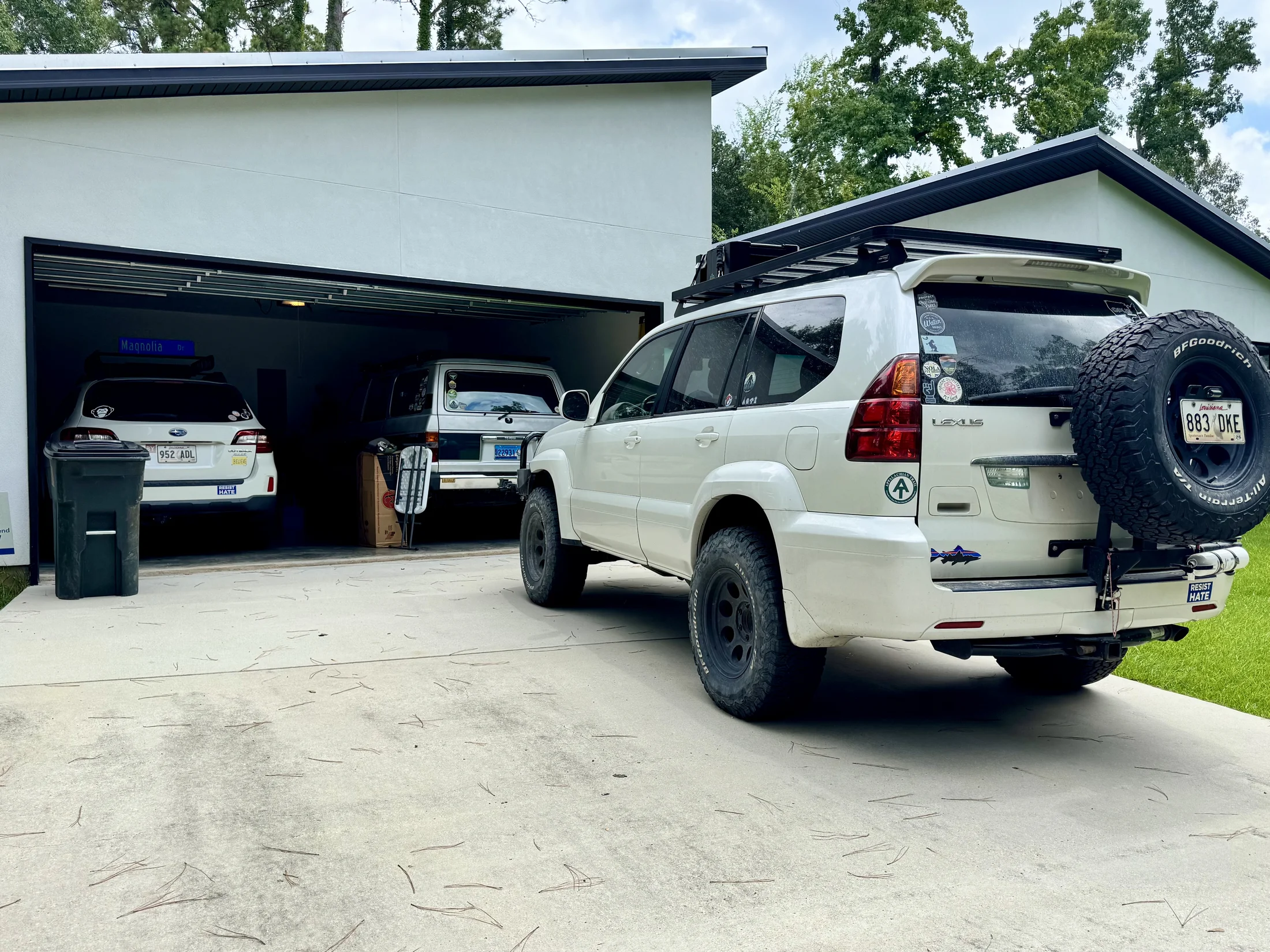

I removed all the weight off the back of the GX for a few short summer trips, recalled it doesnt ride as well w/o the weight and put it all back on. While I had the swing-out off, I thought I'd check the status of the swing-out (Swing Out Tire Carrier Kit-1410100 - https://www.4xinnovations.com/Swing-Out-Tire-Carrier-Kit_p_112.html) bearings. I should have checked it sooner, granted, this thing has been on here for under 2 years. This time around I packed the bearings like you are supposed to with a ton of grease and put it all back together,,,,,,,,,, smooth as butter now.

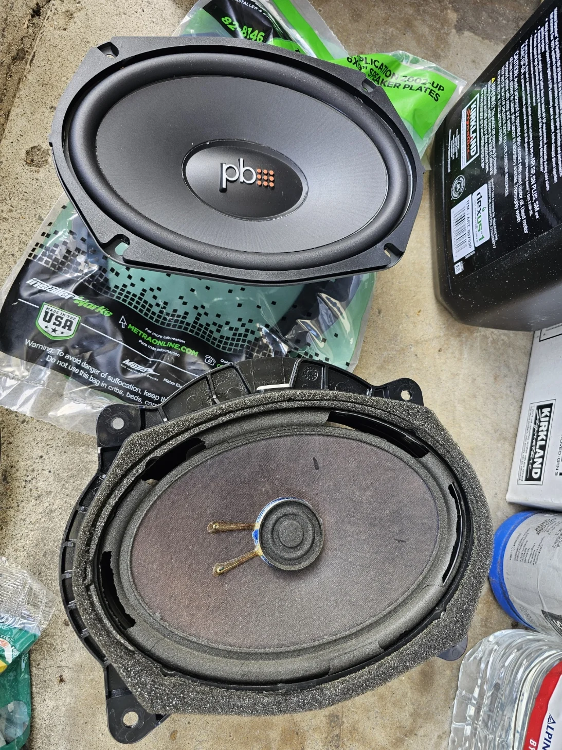

Threw on a new pair of PowerBass 6x9 in the front.

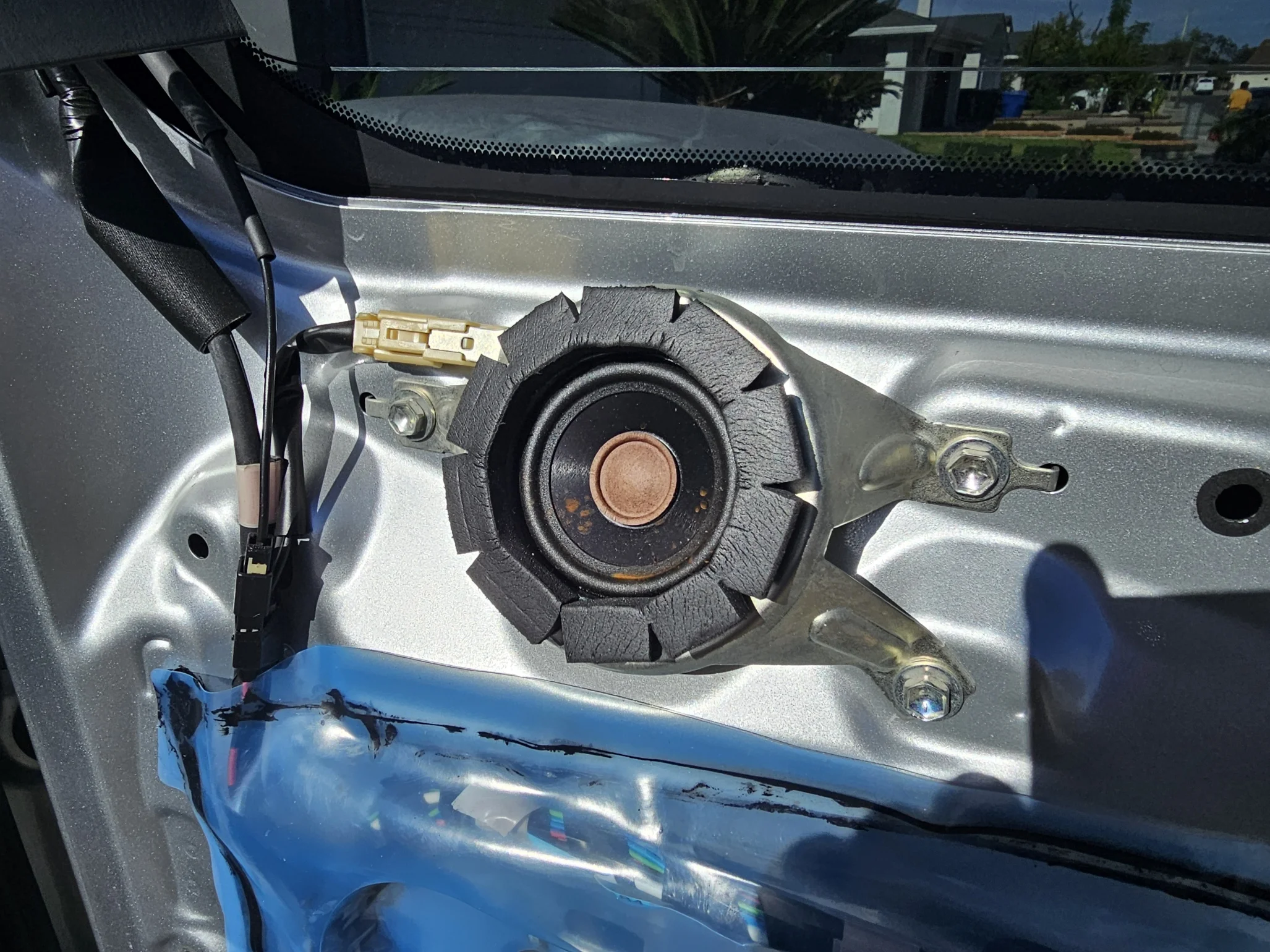

I was feeling productive so I put new foam on the rear tweeters.

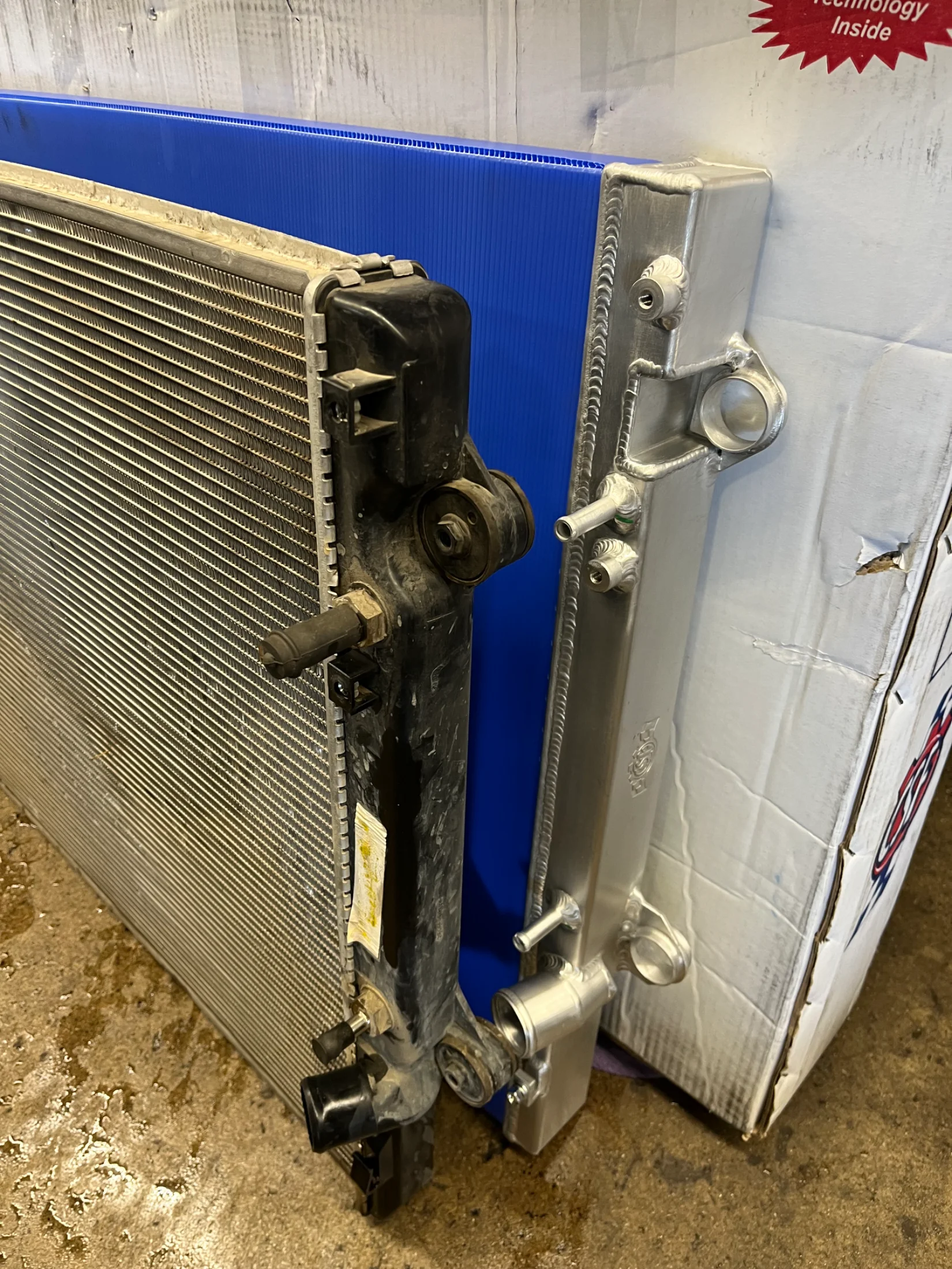

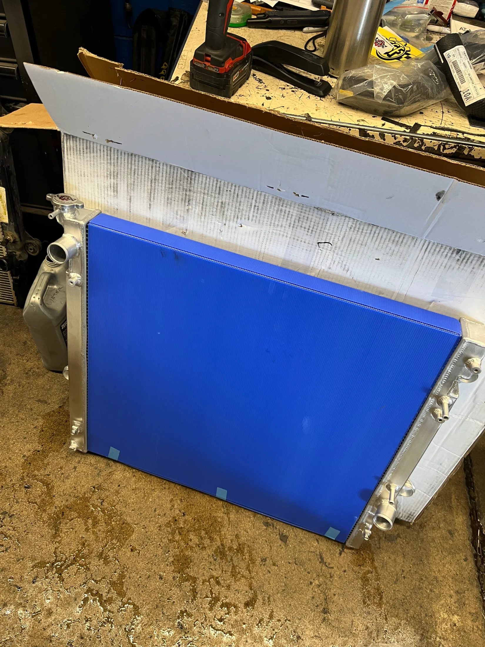

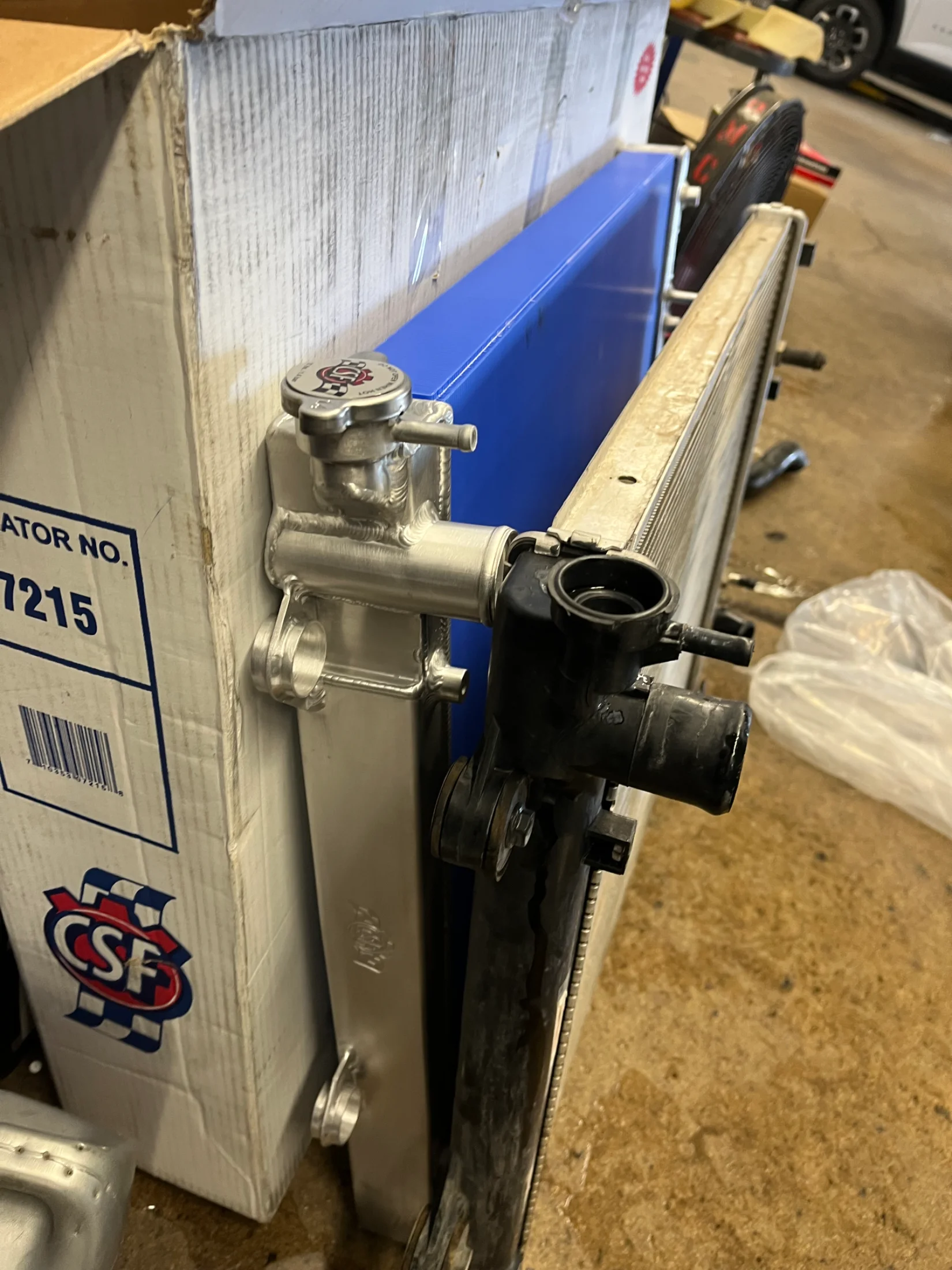

After only getting 4 years out of this last radiator, I splurged and bought a CSF all aluminum radiator. CSF is very proud of this and is on the pricey side…BUT wow! Very nice unit. Well built, no problem's installing it. Hopefully it’s holds up as good as it looks. It being all aluminum, if a leak occurs you should be able to get it fixed.
Bought mine on eBay (CSF 7215). Delivered in 4 days, and packaged/protected nicely.

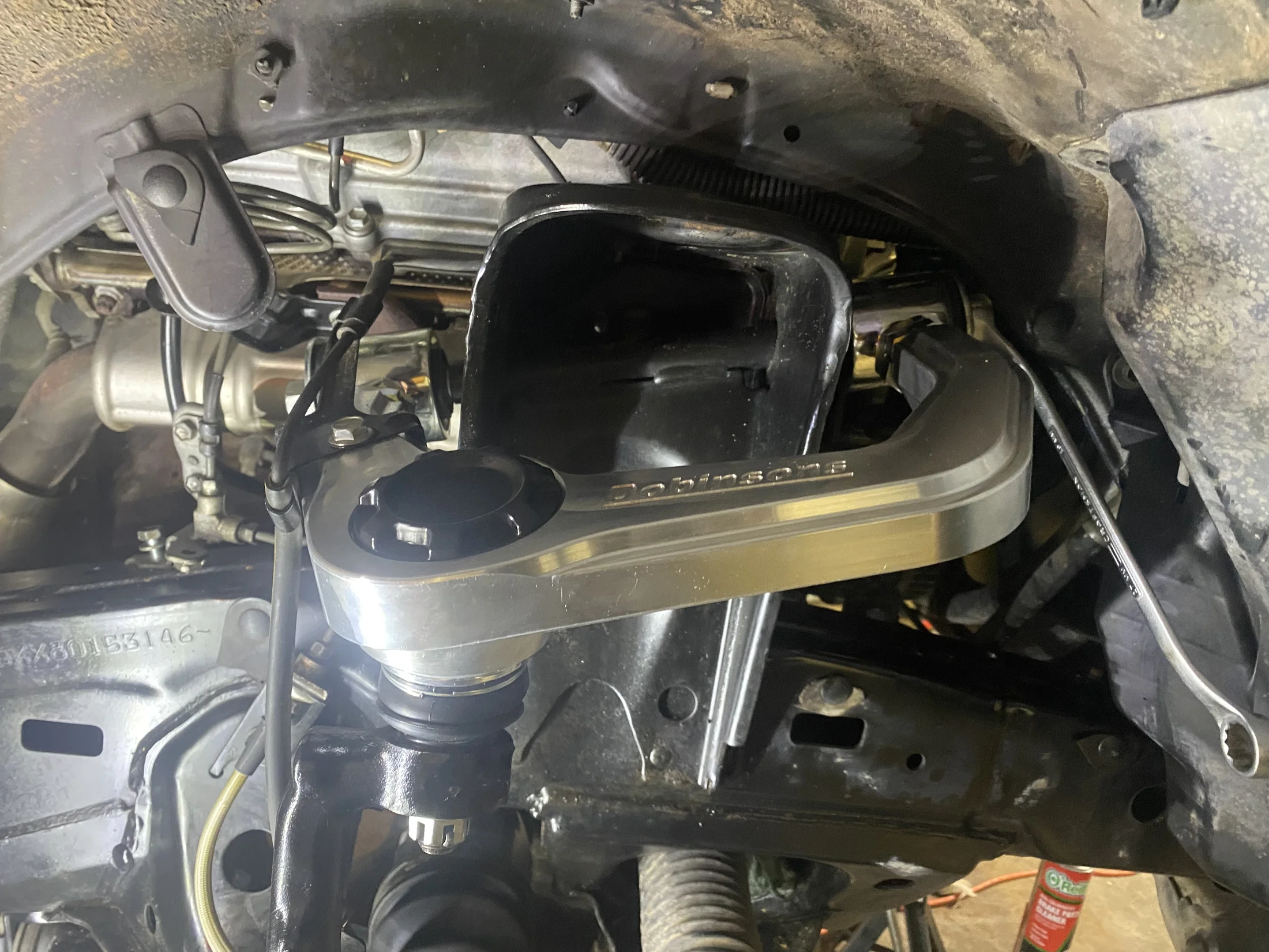

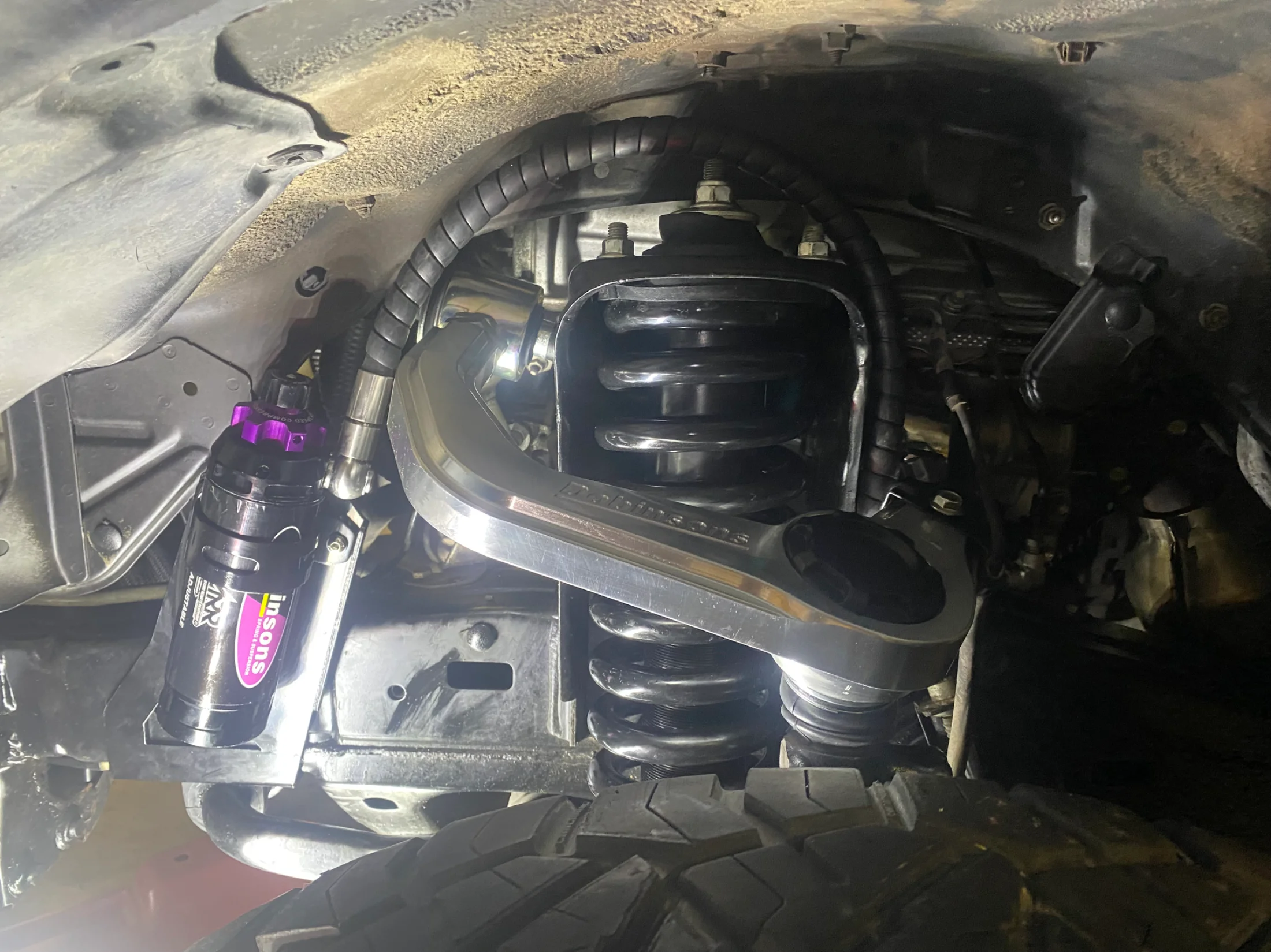

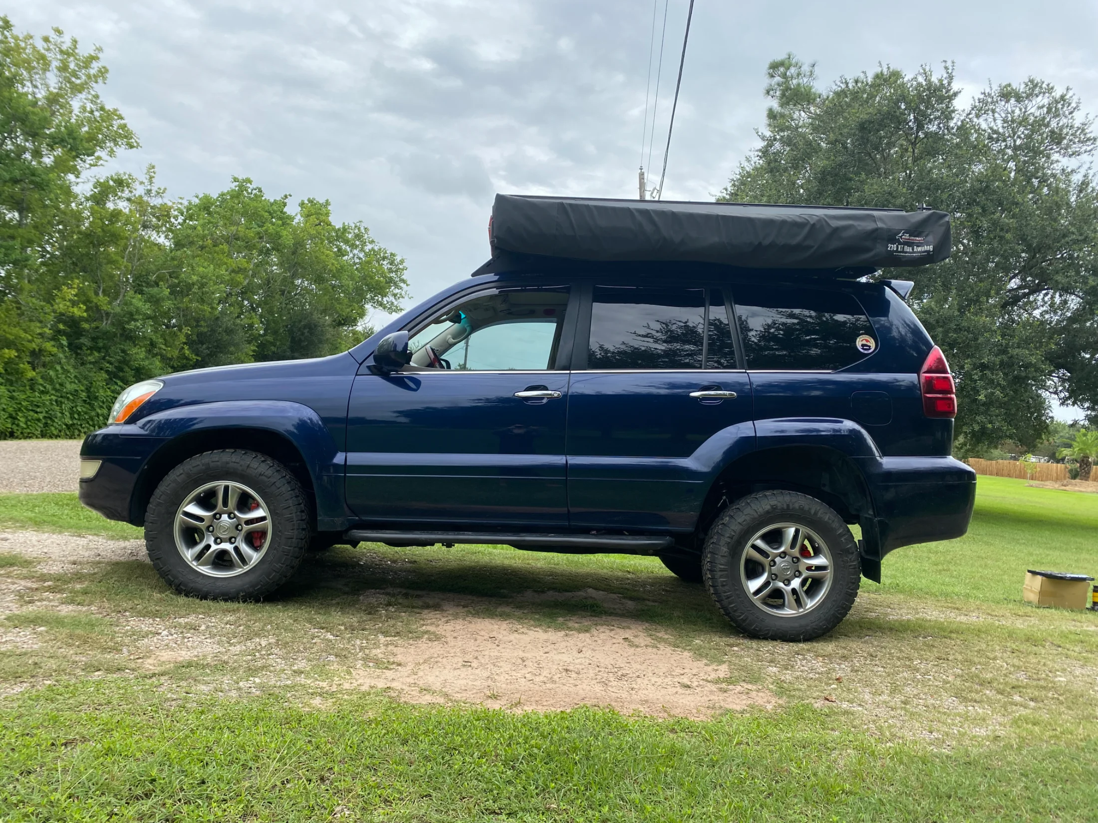

Just finished up install, finally. Went for quick shakedown ride to get fuel and it didn’t fall apart or break anything. Have to do my adjustment on reservoirs to get it more firm and then alignment Monday morning. Have a Texas to Arizona trip in a few weeks then after I’ll look into rims and tires.
