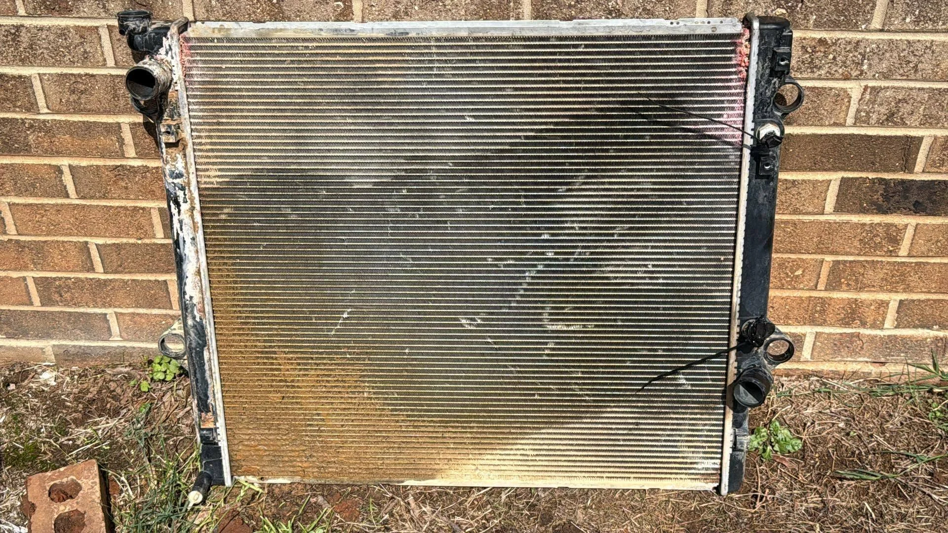

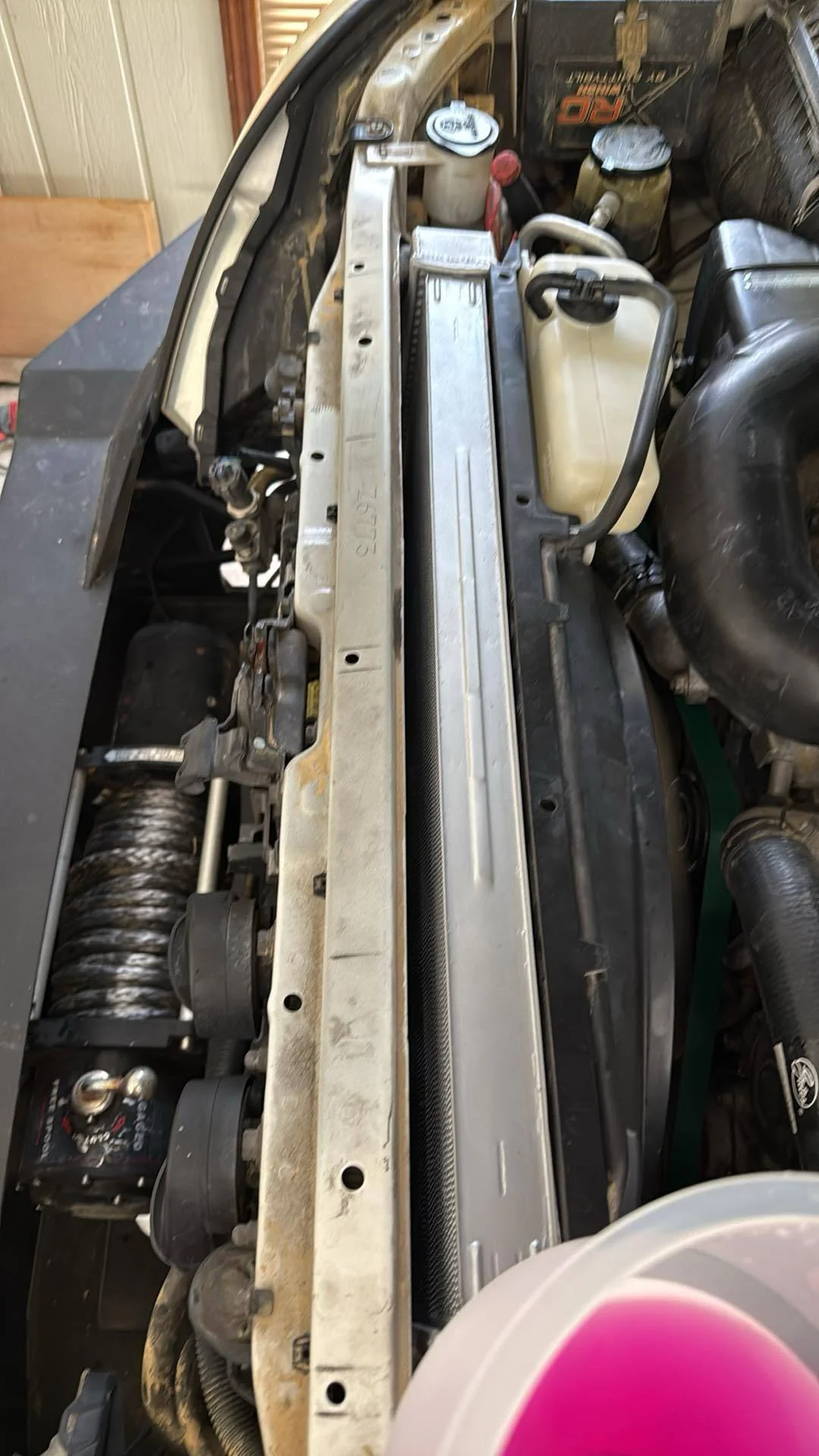

finished installing new radiator. got the CSF all aluminum one and also, the 170 degree Motorand thermostat.
all the white and pink is from it leaking. think its been leaking for about 8 years now lol.
new one installed

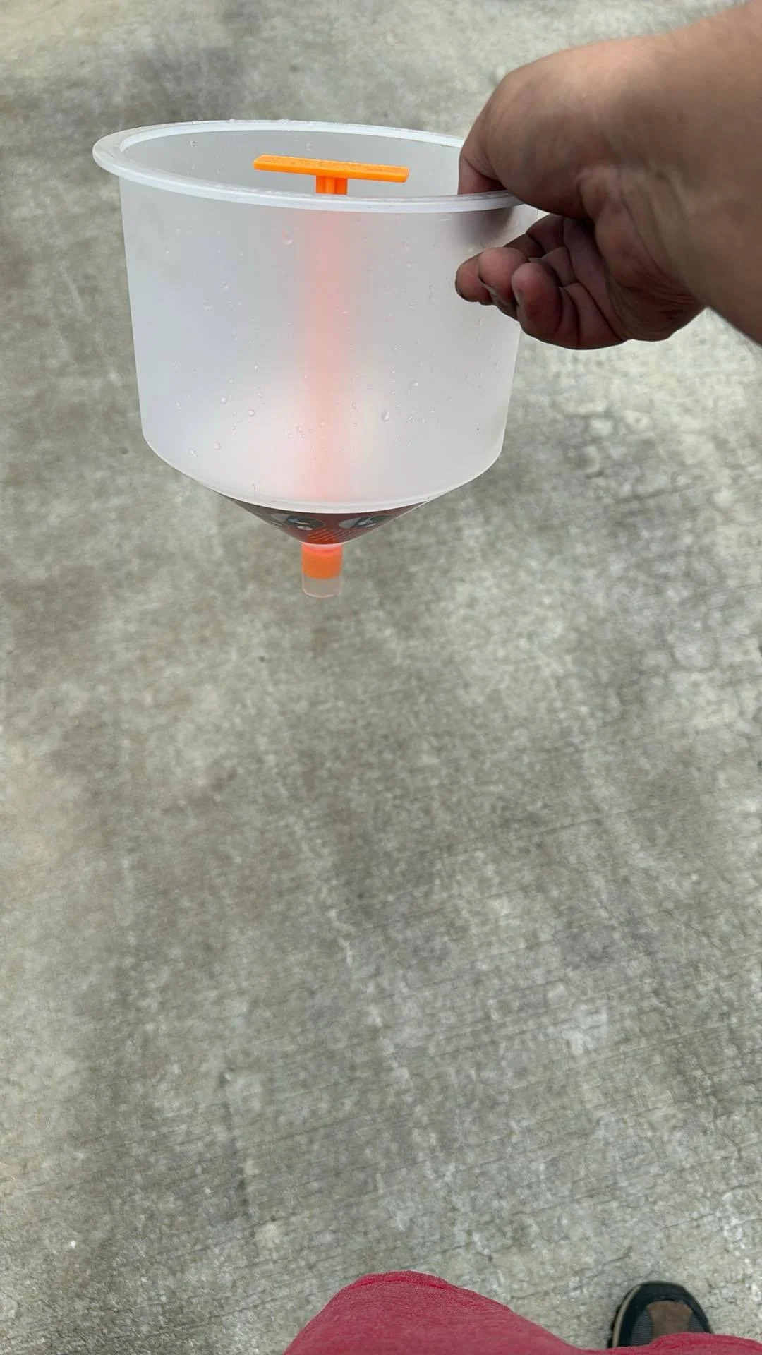

also, if you dont have one of these non spill funnels, get one almost impossible to over fill and spill coolant all over the place.

Curious why you went with a low temp thermostat?

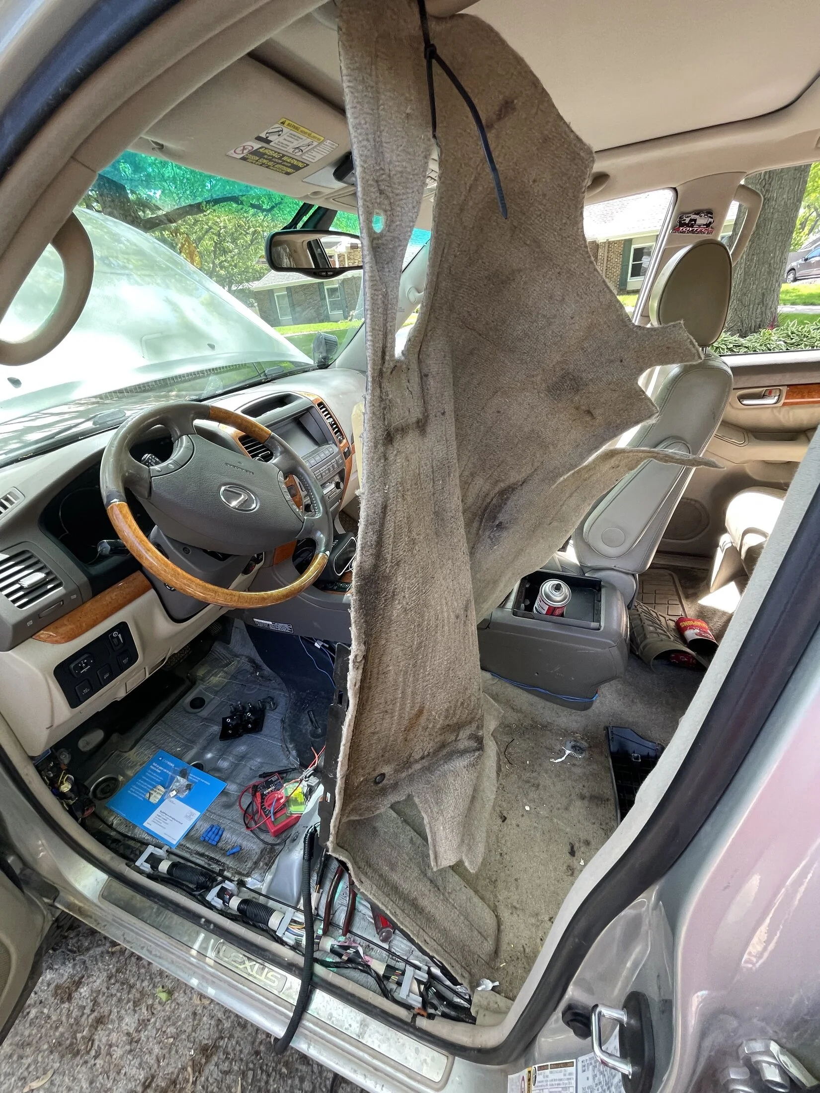

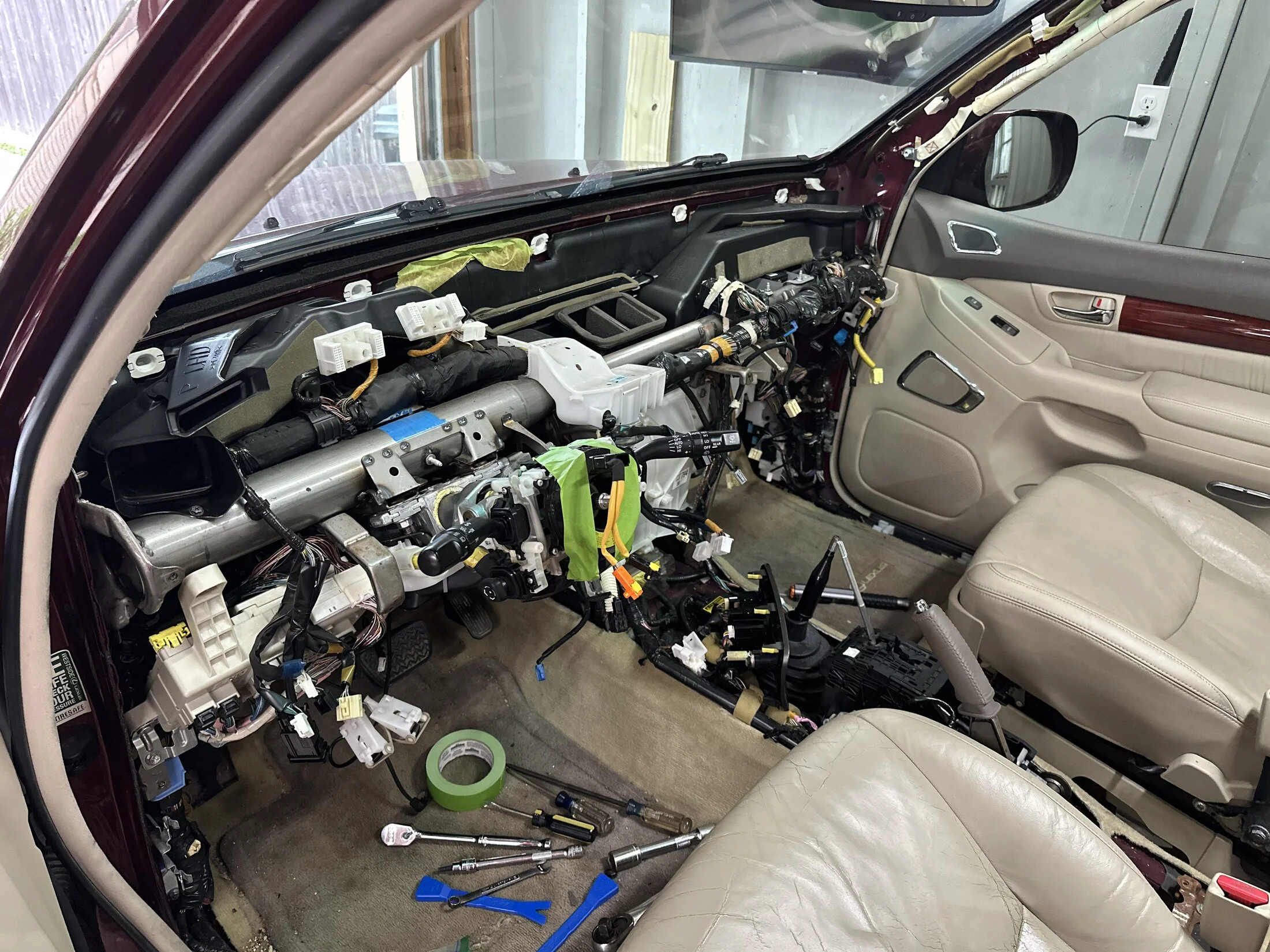

Swapped the dash this afternoon. It took about 4 hours total, and is pretty straightforward. Honestly super happy with how much better it looks.
Picked the dash up from Treasure Coast Lexus in Florida (<$600 shipped to Texas).
No broken clips and no left over fasteners.
F yeah!!! Congrats!!! I have a new one sitting in the garage and it’s on the todo list. Trying to see what else I can do at the same time (GROM, front camera, evaporator 👀). Did you find any treasure back there?
How did you pull off that deal? Looks like they’re charging just under $600 before shipping. Comes to $796 for me. I need to do mine, and want to order one very soon.
They were running a discounted shipping special. I bet they didn't realize it would apply to a dash and may have changed it after shipping mine.
I probably looked at 30 different dealer websites. 75% wont ship a dash at all. I had 1 dealer complete the order and then cancel it 3 days later saying they didn't want to ship. I got lucky haha

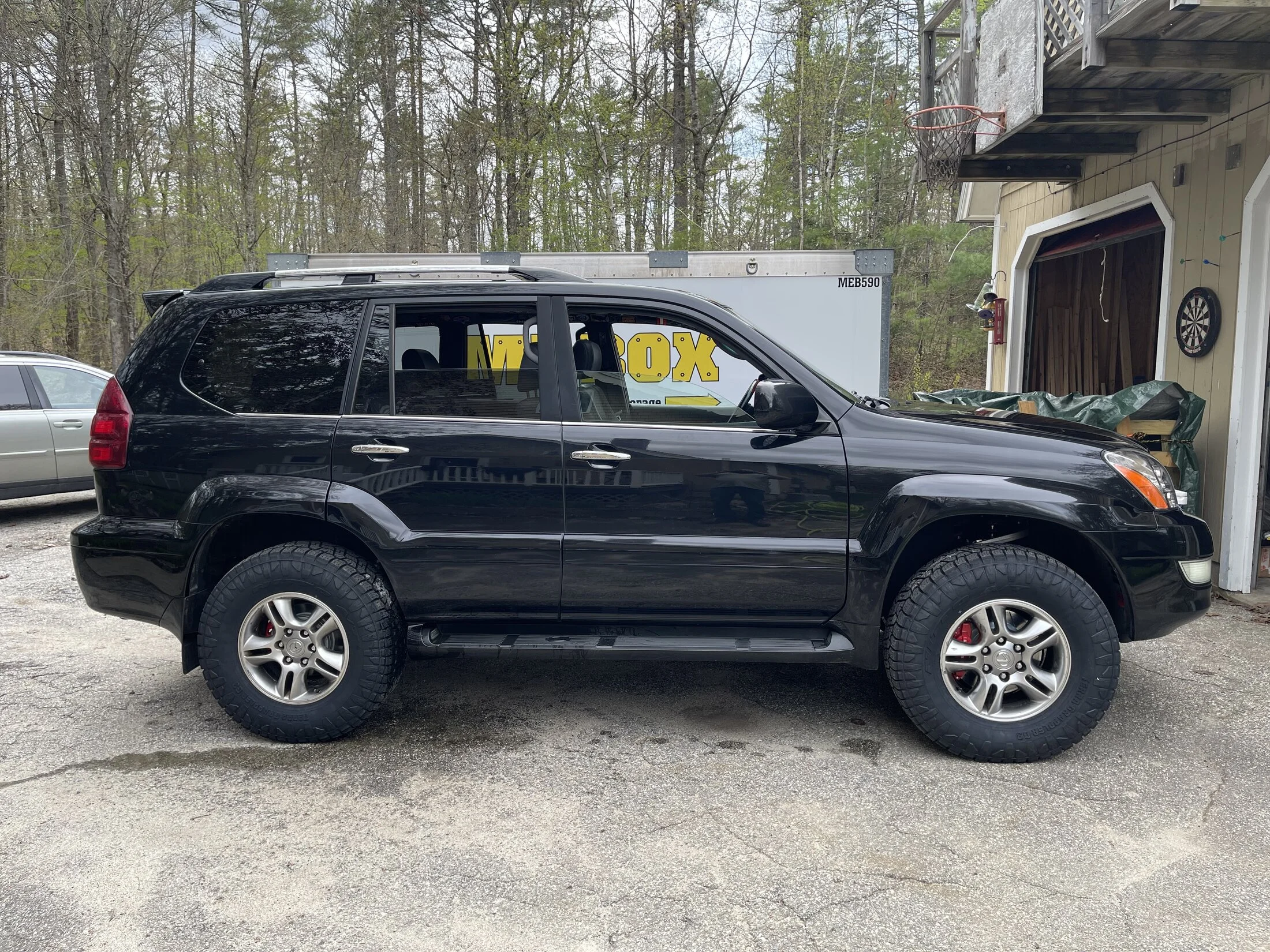

I am lifted 1.25" in the front and 1" in the rear on standard bags and lexus adjustable shocks. I tow as well and really appreciate keep the airbags. I run a .75" spacer on the front strut (and correctly space the front bumpstop), and then just use washers on the height sensors in the rear to make it run higher.

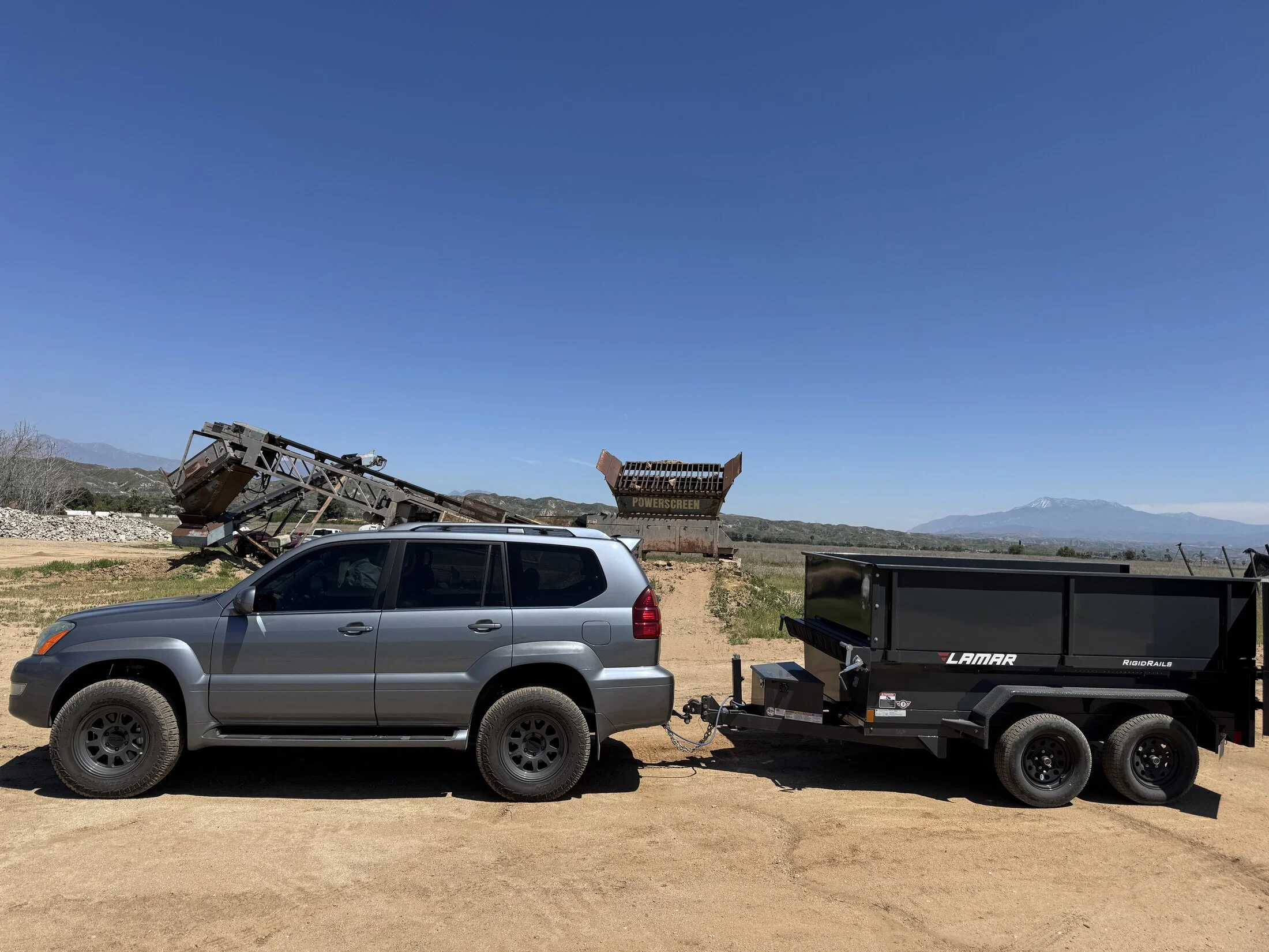

What @Krazykevin said. I have a mild lift with after market dampers with the factory air springs. I scoop up air spring components when others remove for rear coil spring conversions. Self leveling is a major feature to keep IMHO. Even if you do not tow. 1-2 passengers wlll activate leveling.
Trailer was full of dirt in both photos.
Super helpful @Timujin and @Krazykevin . You haven't found any reduced performance with the stock shocks? Both of yours look great so I'd be thrilled if its reasonable to lift a bit and keep all the stock features.
