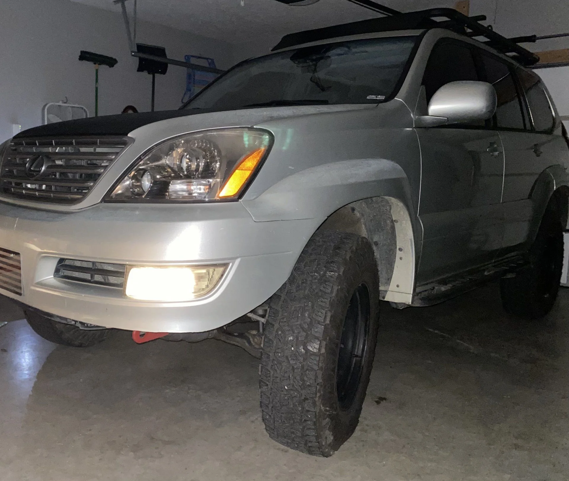

This morning, with another GXOR member's help, I got the Apex Overland recovery points installed:

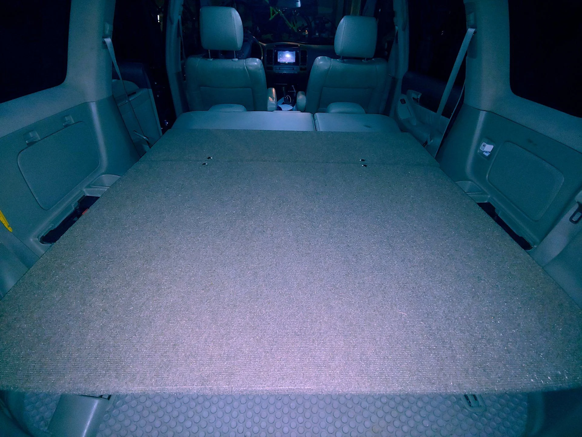

Also recently finished up V1 of my cargo/sleep platform:

Pulled the trigger on a once-mounted, never-driven set of Vors VE37 wheels on eBay ($500 shipped) and had them mounted today (17x8./5 with zero offset). Totally different look than stock; I love these wheels. Quality seems pretty good for the price. I almost went with gunmetal Level 8 MK6 wheels am glad I went with bronze on the green GX! Also plastidipped the grill over the weekend.

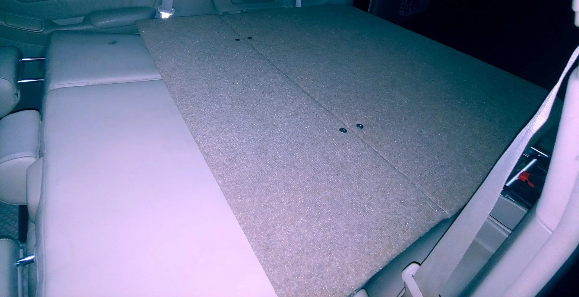

Finished up the platform build. I crawled into and out of the back several times without issue. I think it'll hold up for what I need out of it.
Here's the supply and parts list if anyone wants to replicate:
supply list: 4' x 4' x 1/2" plywood. (1) (Cut ~3' section for rear and remainder for bridge) 10' 14 Gauge Superstrut (1) (Cut 2 pieces to seat bracket width, cut remainder in half for bridge supports) Superstrut 10 ft. 14-Gauge Silver Electro-Galvanized Strut Channel-ZB14HS10EG - The Home Depot - https://www.homedepot.com/p/Superstrut-10-ft-14-Gauge-Silver-Electro-Galvanized-Strut-Channel-ZB14HS10EG/202714280 1/2" x 12" threaded rod (2) Everbilt 1/2 in. x 12 in. Zinc Threaded Rod-802127 - The Home Depot - https://www.homedepot.com/p/Everbilt-1-2-in-x-12-in-Zinc-Threaded-Rod-802127/204274026 1/2" thin nut (4) (outside fastener) Amazon product ASIN B07WNSFS87 1/2" standard nut (8) (inside fastener & 'L' Bracket) Everbilt 1/2 in.-13 Zinc Plated Hex Nut-804716 - The Home Depot - https://www.homedepot.com/p/Everbilt-1-2-in-13-Zinc-Plated-Hex-Nut-804716/204647892 1/2" lock washer (12) Everbilt 1/2 in. Stainless Steel Lock Washer (2-Pack)-800441 - The Home Depot - https://www.homedepot.com/p/Everbilt-1-2-in-Stainless-Steel-Lock-Washer-2-Pack-800441/204276547 1/2" x 15/16" Bolt (4) Superstrut 1/2 in. x 15/16 in. Strut Hex Head Bolt - Silver Galvanized (5-Pack)-ZE142121516EG10 - The Home Depot - https://www.homedepot.com/p/Superstrut-1-2-in-x-15-16-in-Strut-Hex-Head-Bolt-Silver-Galvanized-5-Pack-ZE142121516EG10/202077369 1-1/2" Aluminum angle bar (cut 4 pieces to fit mounting spacers, drill screw holes as needed) Everbilt 1-1/2 in. x 36 in. Aluminum Angle with 1/8 in. Thick-801407 - The Home Depot - https://www.homedepot.com/p/Everbilt-1-1-2-in-x-36-in-Aluminum-Angle-with-1-8-in-Thick-801407/204273991 1-1/2" Wood Screws (8) (I couldn't find the ones I used, but these are similar) GRK Fasteners #8 x 1-1/2 in. Star Drive Low Profile Washer Head Cabinet Wood Screw (100-per Pack)-114073 - The Home Depot - https://www.homedepot.com/p/GRK-Fasteners-8-x-1-1-2-in-Star-Drive-Low-Profile-Washer-Head-Cabinet-Wood-Screw-100-per-Pack-114073/203556495 ~1" thick wood support/spacers to attach brackets to platform. Sections of 1/4" x 2" support wood for overhang. Wood Glue to affix support wood. Paint/Primer to seal wood components. Indoor/Outdoor Carpet (5'x6') TrafficMaster Elevations - Color Stone Beige Texture 6 ft. x Your Choice Length Carpet-7PD5N480072HO - The Home Depot - https://www.homedepot.com/p/TrafficMaster-Elevations-Color-Stone-Beige-Texture-6-ft-x-Your-Choice-Length-Carpet-7PD5N480072HO/203469136 3/8" x 1" Carriage Bolt (4) 3/8" Washer (4) 3/8" Nut (4)
Tools: Metal cutting tool (band saw/ grinder w cut off wheel/ hack saw) Wood cutting tools (circular saw/table saw, jig saw) Drill, screw driver Wrenches for bolts and nuts

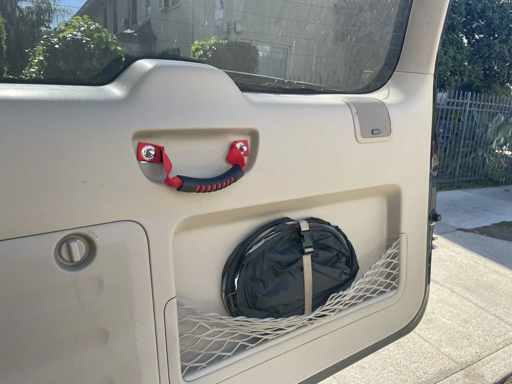

10-minute upgrade today. Finally got all the hardware for the back door handle replacement and followed the directions here.
As you can see, next up is doing something about the sad net.

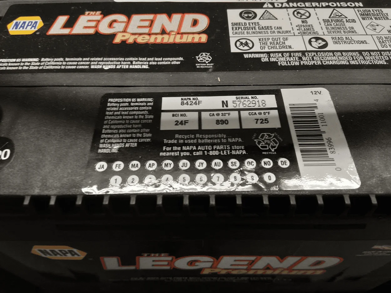

battery talk.
Replaced Car Quest Autocrap silver 27f (expired in 3 years)... had 24 mo warranty (unknown if any prorated), the interwebs suggests CQ has Die Hards not not Autocraft (rebadged same-same? 🤔
with Napa legend premium 24f with 24month free replacement and 84 month prorated warranty.
My NAPA doesn't have a 27f in legend premium, just legend, which is only 18/72 and lower specs.
