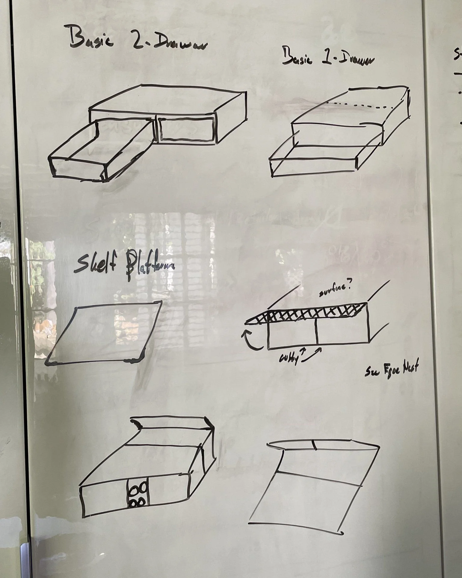

When I purchased my GX, I knew that I wanted some sort of storage solution for the cargo space. I have zero need for the 3rd row seats and I like the idea of tucking gear out of site as my rig is street parked. My original plan had been to build a set of drawers, but I was consistently bothered by the amount of space taken up by the frame. And the build process seemed like more than I wanted to deal with (not daunting, just not something that excited me). So I started measuring and sketching to figure out some other options:
One thing that stood out to me was the need for "long, skinny" storage for things like camp chairs, a ground tent, a sleeping pad/mattress, etc. Each of the designs that I explored took that need into account as well as a desire for "out of sight, out of mind" storage for a tool kit, etc. I started researching existing drawers, some all-in-one ideas like the Egoe Nest, Landshark drawers, and of course Steve Foltz's design. I ultimately landed on a flexible, removable platform that would create a sleeping platform when needed and otherwise increase storage.

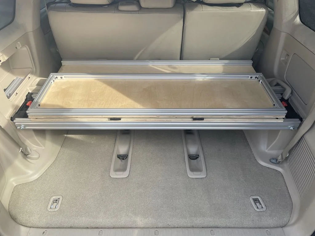

Here's what I ended up with:

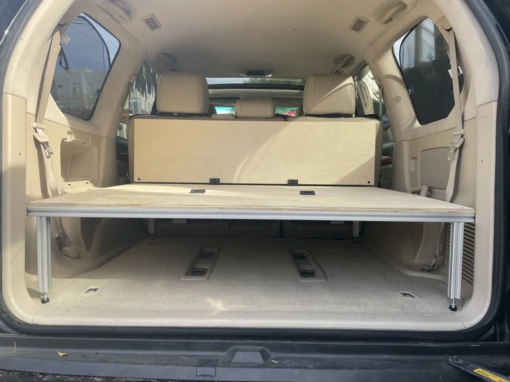

The unit is primarily supported by the 3rd row seat mounts, but also has 4 removable legs for added support. It can be easily installed/removed in just a couple of minutes by one person. Total cost of materials is ~$300. I learned a ton building this version, including a few things I'd change.

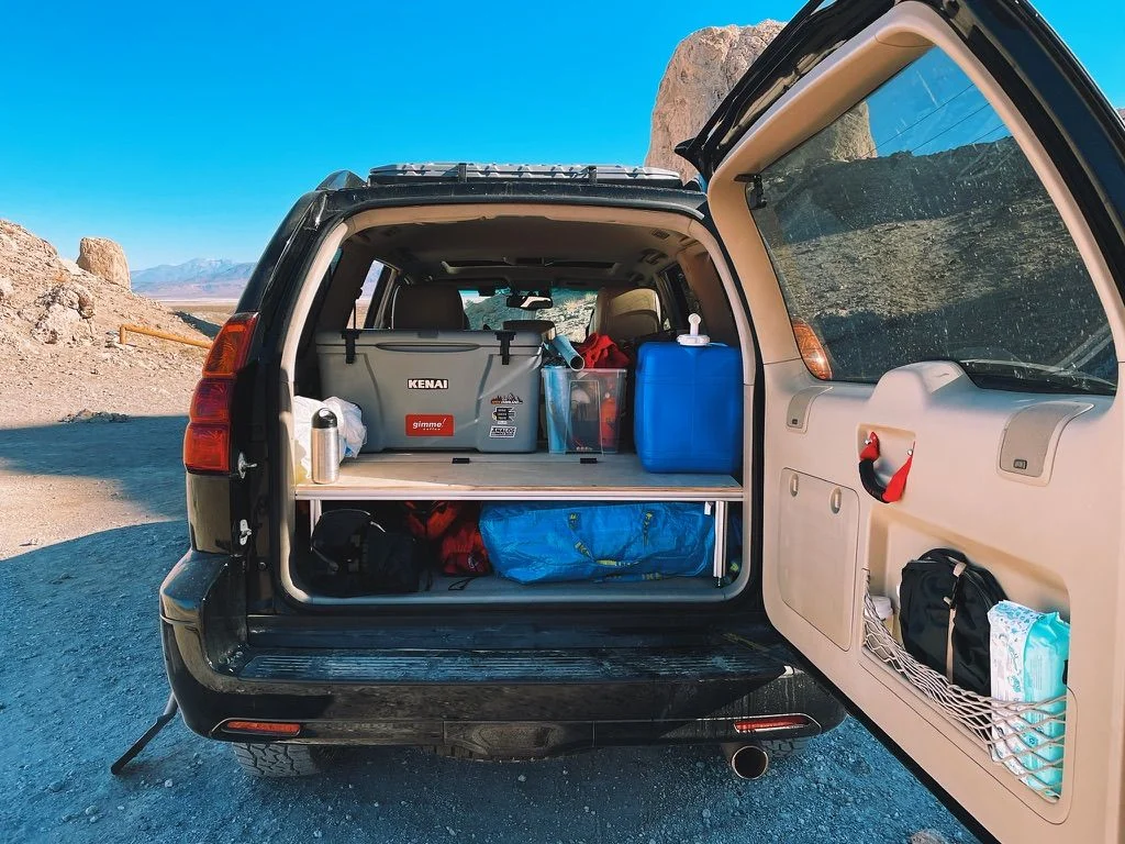

Measurements are on the FAQ's page. They may change slightly as I'm working on a "v2" design which is what the plans will be based on. The new design should increase the under-platform space by ~2 inches.
Much appreciated - found what I was after (recognizing V2 will be somewhat taller - nice).
That said, do you have any target storage packs/crates/whatever (e.g. Action Packers) you're working with that will be ideal with your V2? Sorry for being impatient, I'm ready to get going with this....
I have a few in mind, but I haven't designed the platform around a specific container. The goal was to get as much usable space underneath as possible while maintaining the ability to create a full size sleep platform in conjunction with the 2nd row seat backs.
That said, I'm currently working on organizing my own gear under the platform, and part of that process is finding the perfect bin solution. I'll be exploring a few options over the next few weeks including the wolf/cub from Frontrunner, some solutions from Milwaukee and Rigid available at Home Depot, the black/yellow Home Depot bins, and whatever else I can find. I'll be sure to update once I figure out what works for me, but YMMV.
It's also worth noting that there will be a fair bit of flexibility in the platform design. I'm creating plans for what works for me, but once you see how it comes together, there's plenty of room for customization (part of why I went the 80/20 direction). You could augment the design to increase space under the platform, for example, if you're willing to forego the sleeping platform functionality (or you could easily change the platform to accommodate both if you'd like).

Lots of measuring, test fitting, measuring, trimming, measuring, etc. I used cardboard to mock-up a prototype before ordering the initial set of 80/20 pieces for the frame. By the time I put the 80/20 together it all fit perfectly.
Finished the v2 build and install yesterday. This version increases the under-platform storage by 2 inches compared to v1 (sounds like a little, but it makes a notable difference). Currently working on finalizing plans for distribution.
