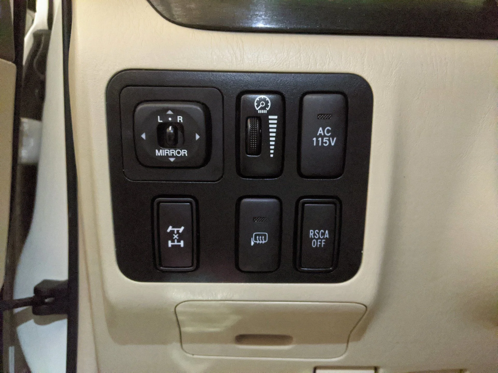

Reorganized the switch panel to have better access to the CDL. Eventually I would like to extend the wiring and move it to where the DAC button is and move the DAC to the the AUX location. I don't remember the last time I used the AUX anyway.
