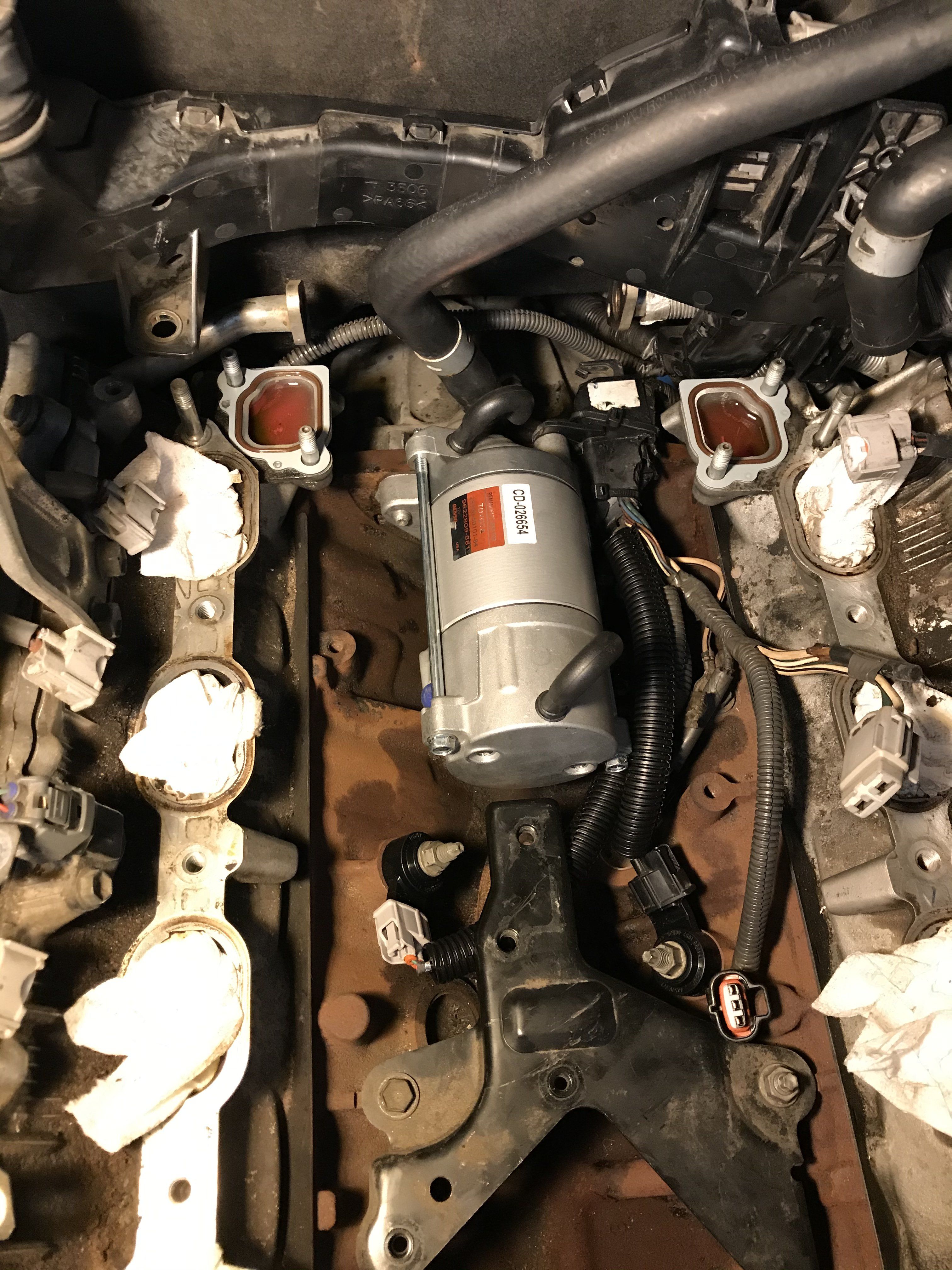

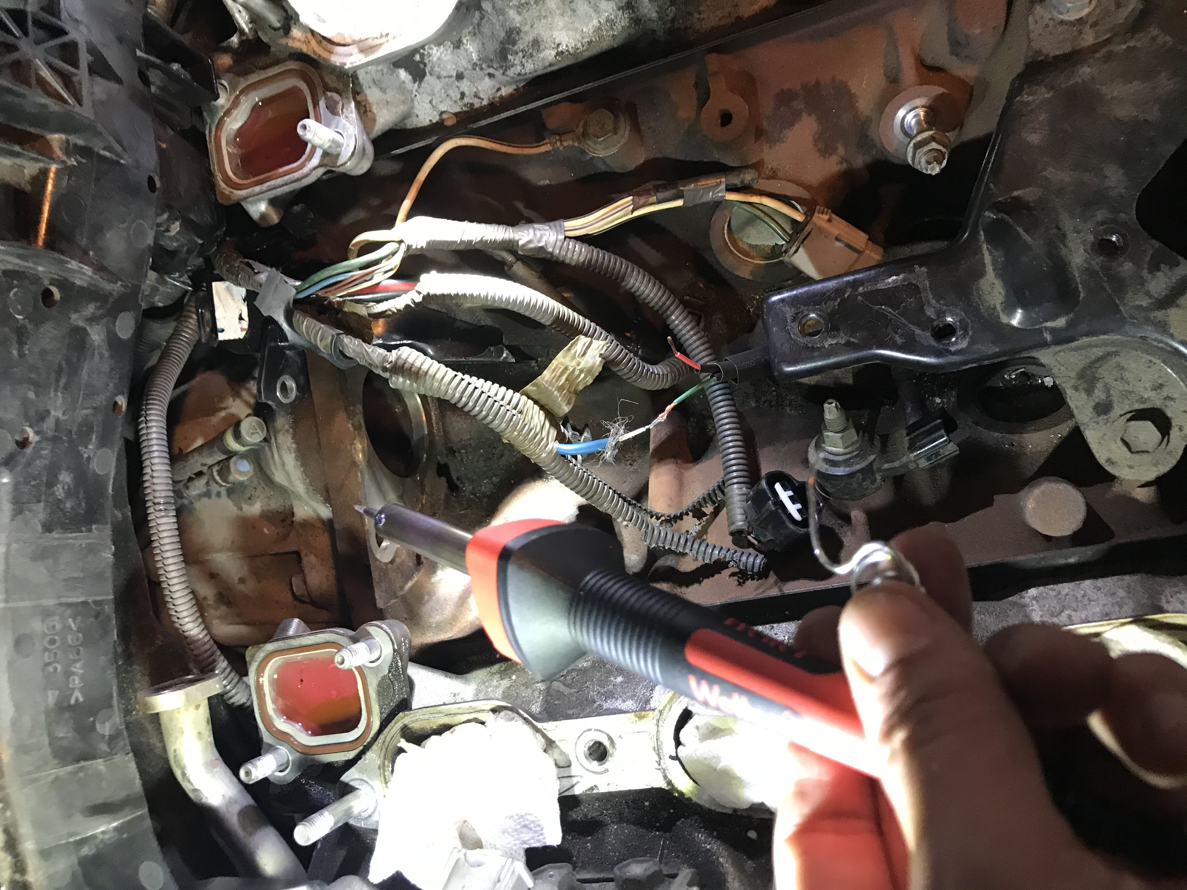

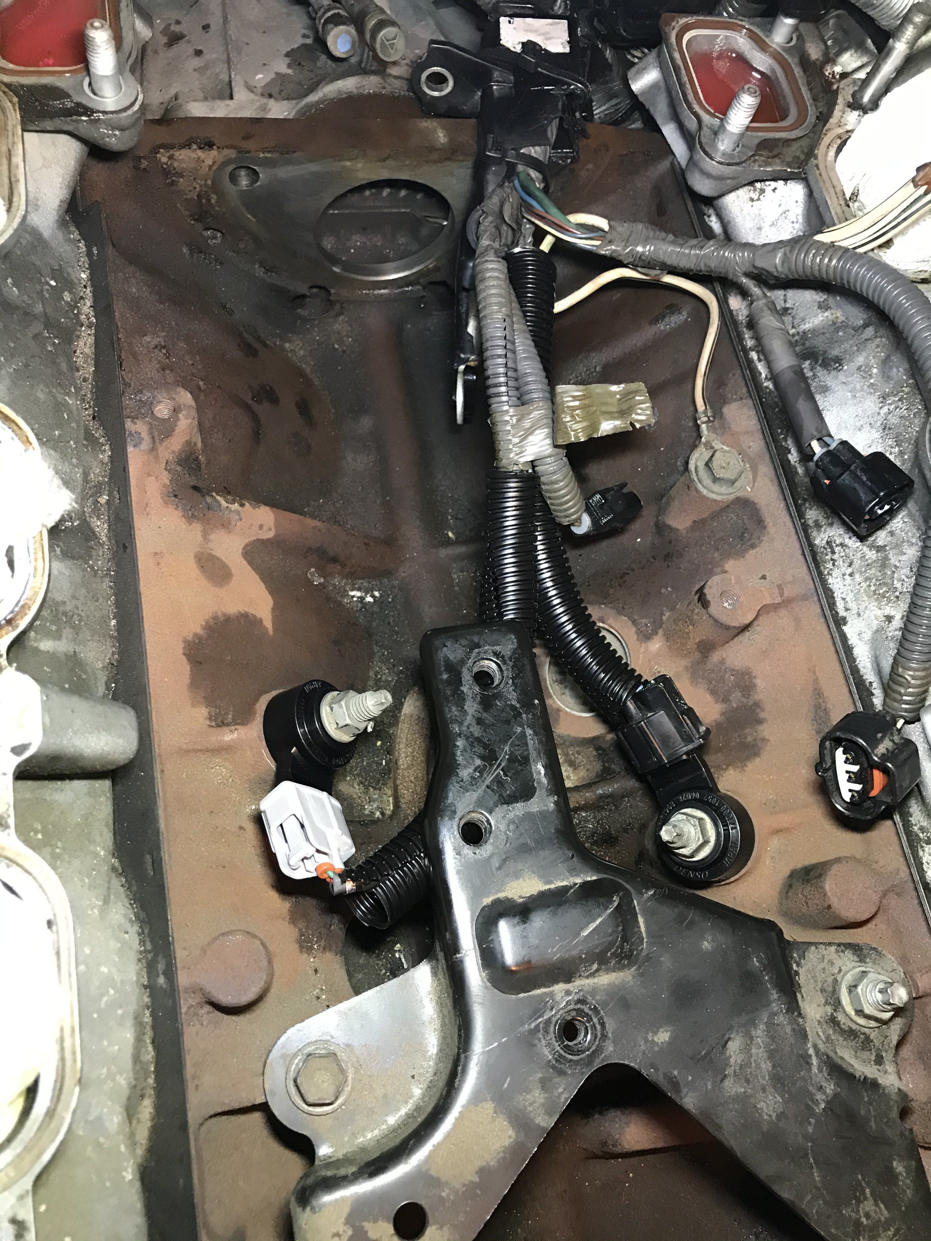

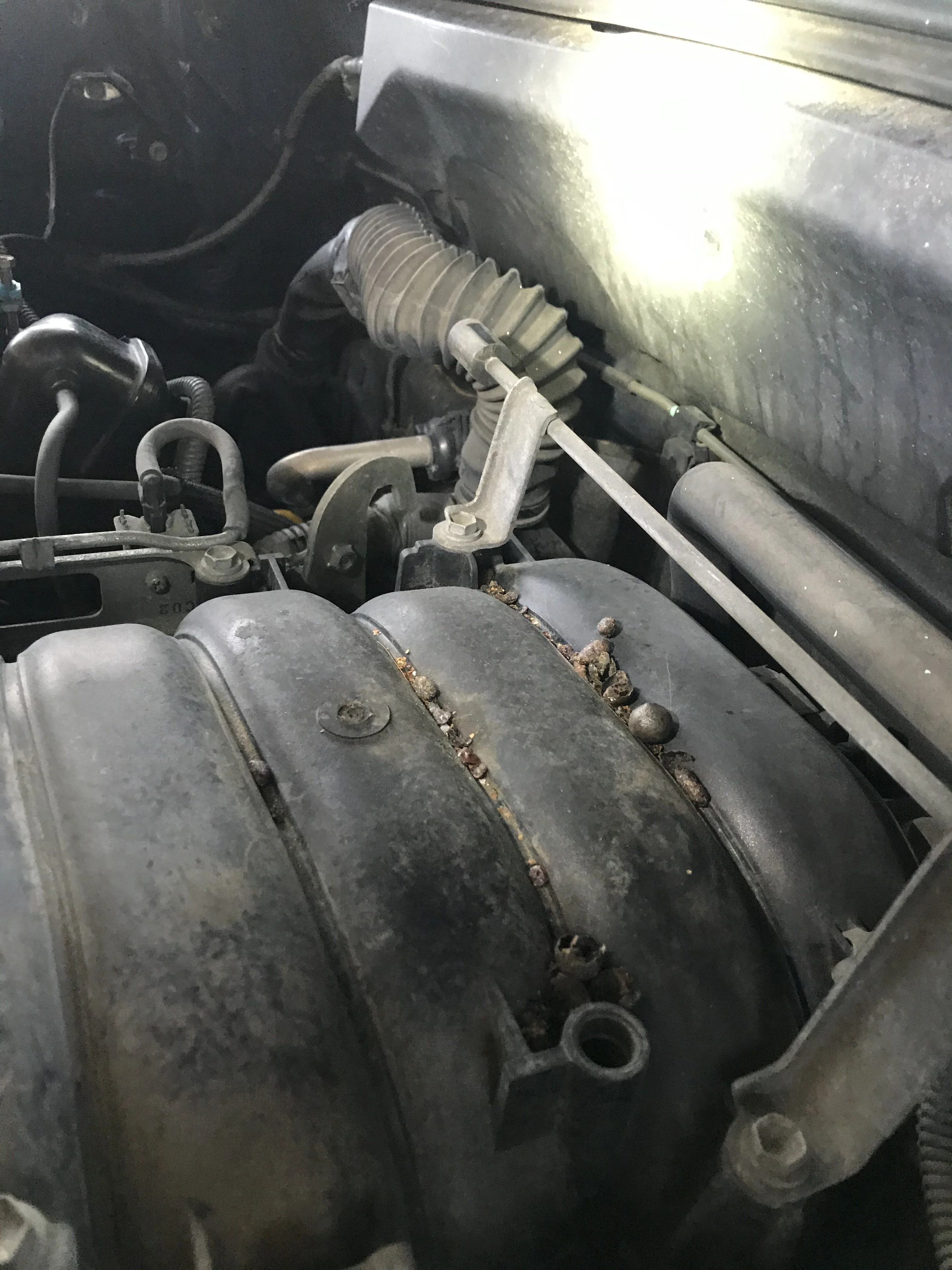

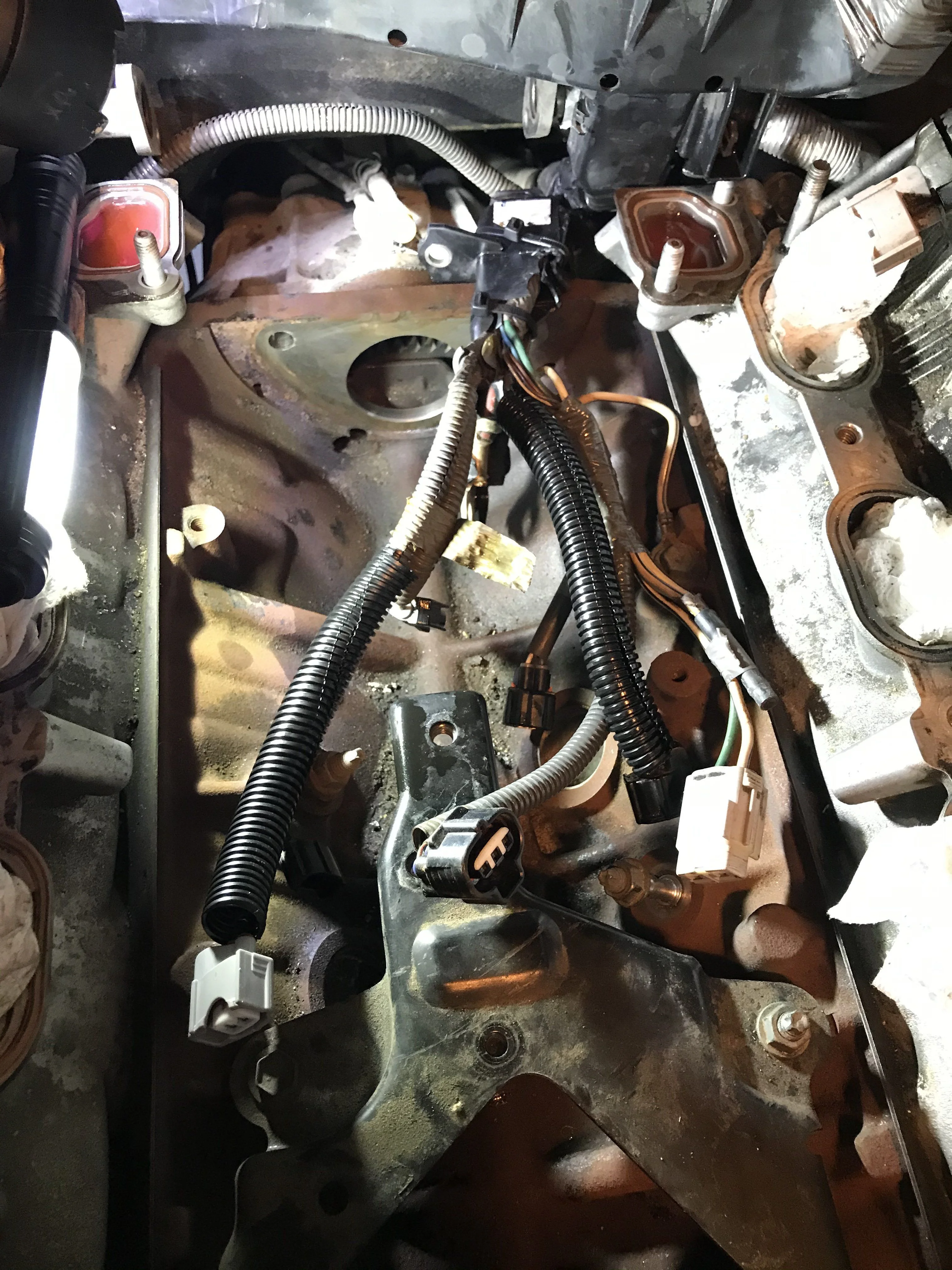

Fixed some rat damage the other day. Initially started out with a CEL, showing a knock sensor fault. Pulled the manifold to find the wires completely severed. I bought a new wire harness hoping to plug and play, but it was wrapped up too well. I ended up splicing it in. Soldered, heat shrink. Then aluminum/metal tape for shielding, electrical tape, and new plastic wire loom coverings. I sprinkled some peppermint oil on the wires as I heard rats don’t like that. Lol not sure if it will work.
While the manifold was off, I threw a new reman starter in, replaced coolant cross over-gaskets, o-ring on coolant tube, new manifold gasket. All is well for now lol.
