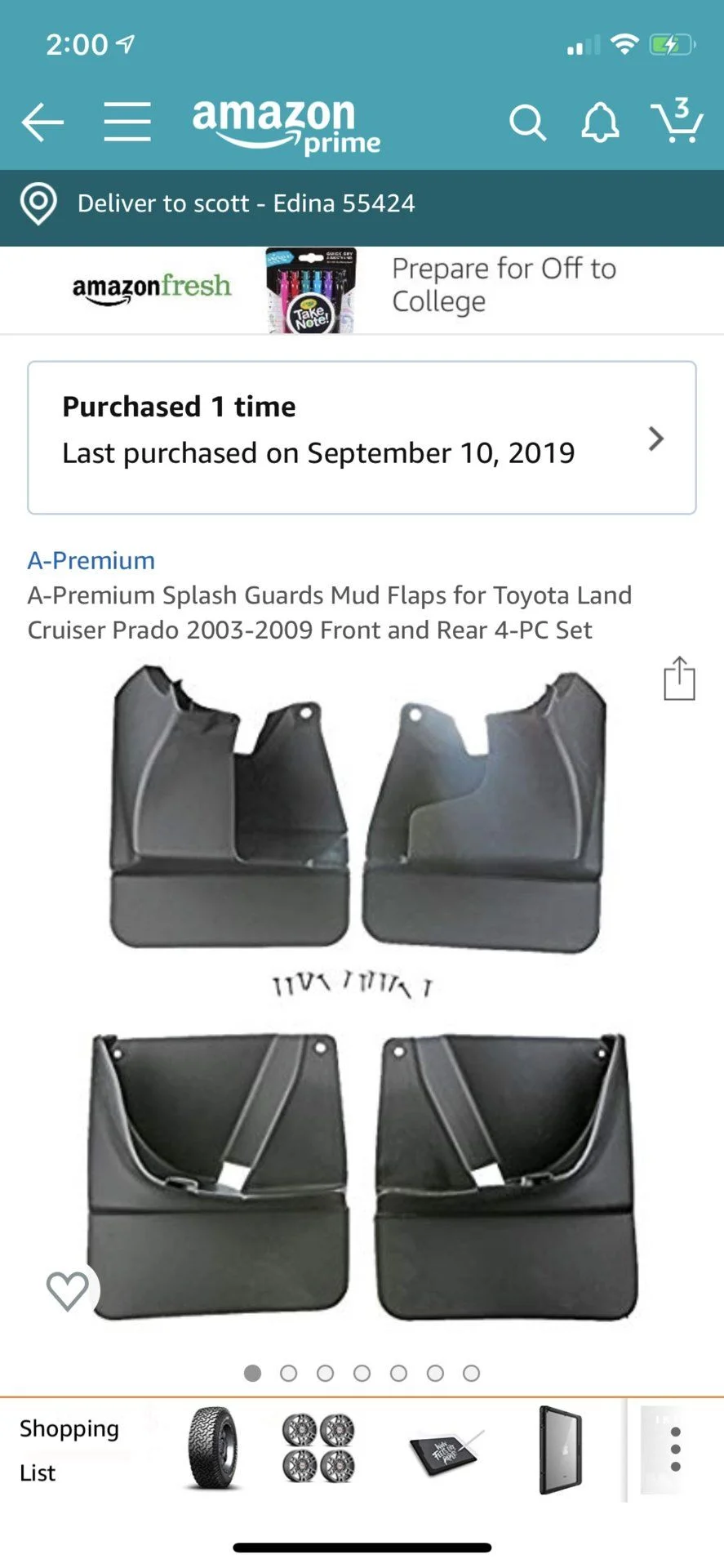

Found an elegant solution using Prado fender splash guards after running board removal!
No need to hack up the boards to get a tiny little trim piece when you can have complete
splash guards styled to fit the GX470. About to install rails and these functional pieces will fill
the "cosmetic gap" with a functional replacement. Amazing what you can find on AMZ these days!
What do you think?

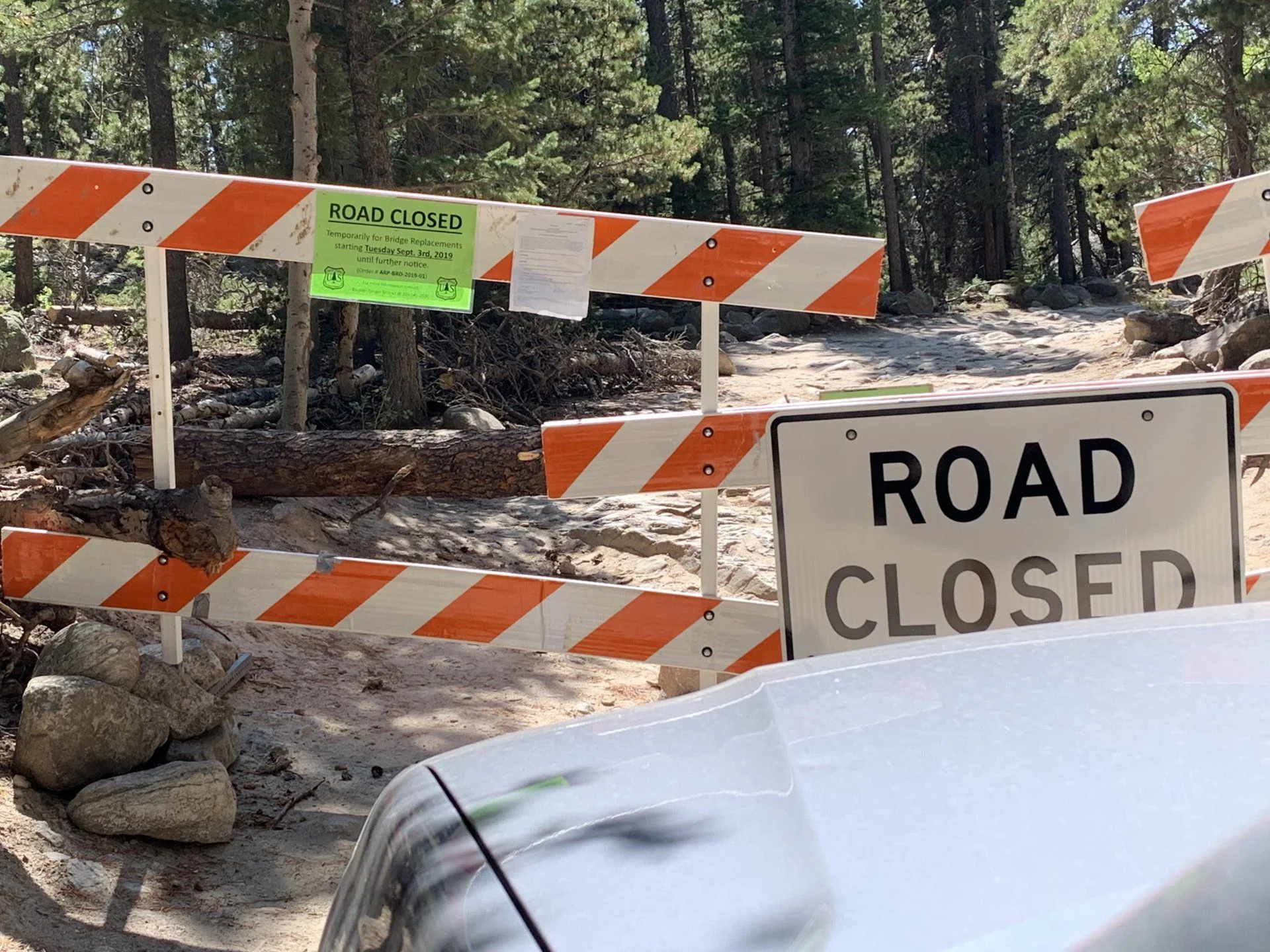

Did my 12th trail from the NOCO fun treks book. I have only once gotten a MVUM and have never called a ranger station to check on things. Kinda wish I had. They closed the trail two weeks ago right by the end for bridge maintenance. I’d planned a day around popping out the other end and ended up having to go all the way back the way I came. Still fun but wrecked my big plans for multiple trails today. Maybe worth that phone call tot he ranger station..... also, I’ve wanted to discuss this for a while here but didn’t want to come across a “way”. Now I don’t care how it’s received. I have. A request for all members. Maybe you do this already and if so I thank you. If not, can I please implore you To carry a trash bag and pick things up trash that is within your reach. I filled up a bag today (as usually) but the trail today was disgusting. I can’t believe people do what they do. It’s behavior like this that gets trails shut down. We already get weird looks being in lexuses so who cares what someone thinks you look like? I’ve read it: leave the trail better than you found it. I try every time and im
Asking everyone here to do their part. Sorry. Soapbox over.
Trail was Bunce School House Rd outside Lyons
I did bunce school a few years ago in my old Toyota mini truck and I must say it’s a fun trail so that’s a bummer that you didn’t get to do it

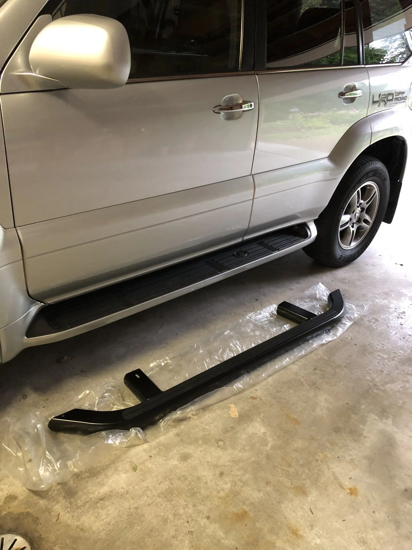

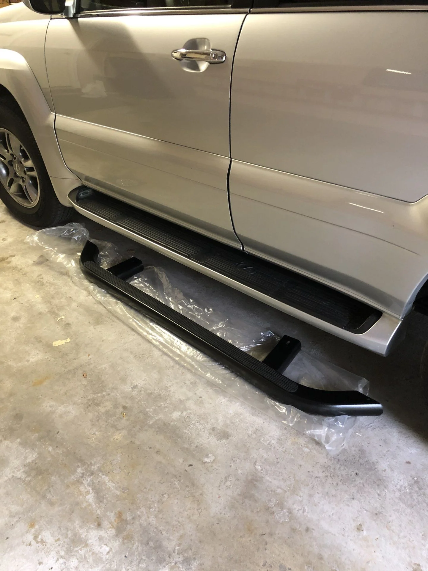

See photos attached, they are not sliders as I see on other GX which “hug” the body and protect against serious bouldering damage. So far the rear splash guards are identical to original and can be painted. Once my welder fashions retrofit brackets for the “rails”will see if front splash guards fit w/o trimming.

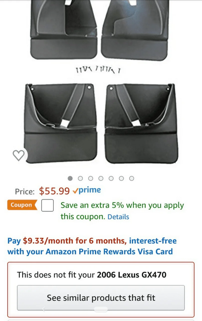

I'm very interested in this follow-up. A buddy just looked and Amazon says it doesn't fit a GX.
I know The Prado running board trim is different from the GX, The Prado is much more like the Land cruiser 80 + 100 + 200, where it's just straight across and doesn't have the notch the GX does.
I dig the rail and will be psyched to see it completed! 👍

Im most interested to see if the rears fit... these look like a good solution to trim these for the rear bumper and save the stock ones to put back on later.

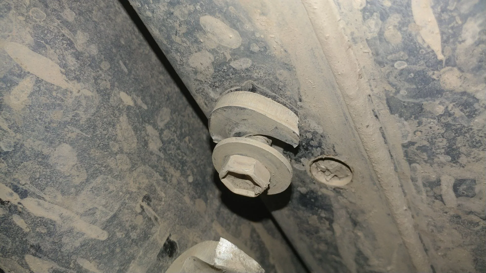

Will do so once the rails are modified to fit in place in a few weeks. I am using the existing brackets that support the current boards-are they bolted onto undercarriage or just less secure tap screws?

added note: re: I saw that but for $50 and return option I wanted to try. The Amazon "doesn't fit GX470" msg. I got also. Likely refers to it with the running boards in place (some high end Prados have same running boards as Lexus GX). The rear ones are a complete fit now. And will be used as MN winter approaches...
If I get the time next weekend I'll try to pull the run. boards and see if the front splash guards fit as they appear they will. The welder's rail-step bracket mods are in process and may take awhile before ready. So we will see...to be continued

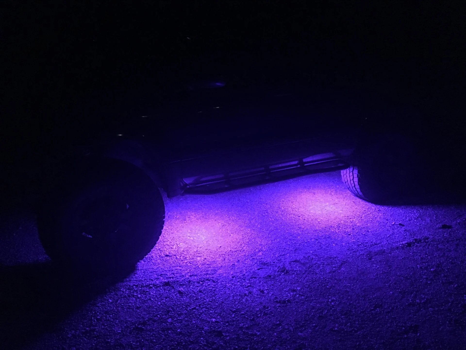

havent finalized my lights yet but I did test them. Remove lighting harness from running boards and cut off both ends. Get a volt meter to see what is positive and negative and splice on new lights. Super simple. Here is a terrible picture. The lights are actually blue.

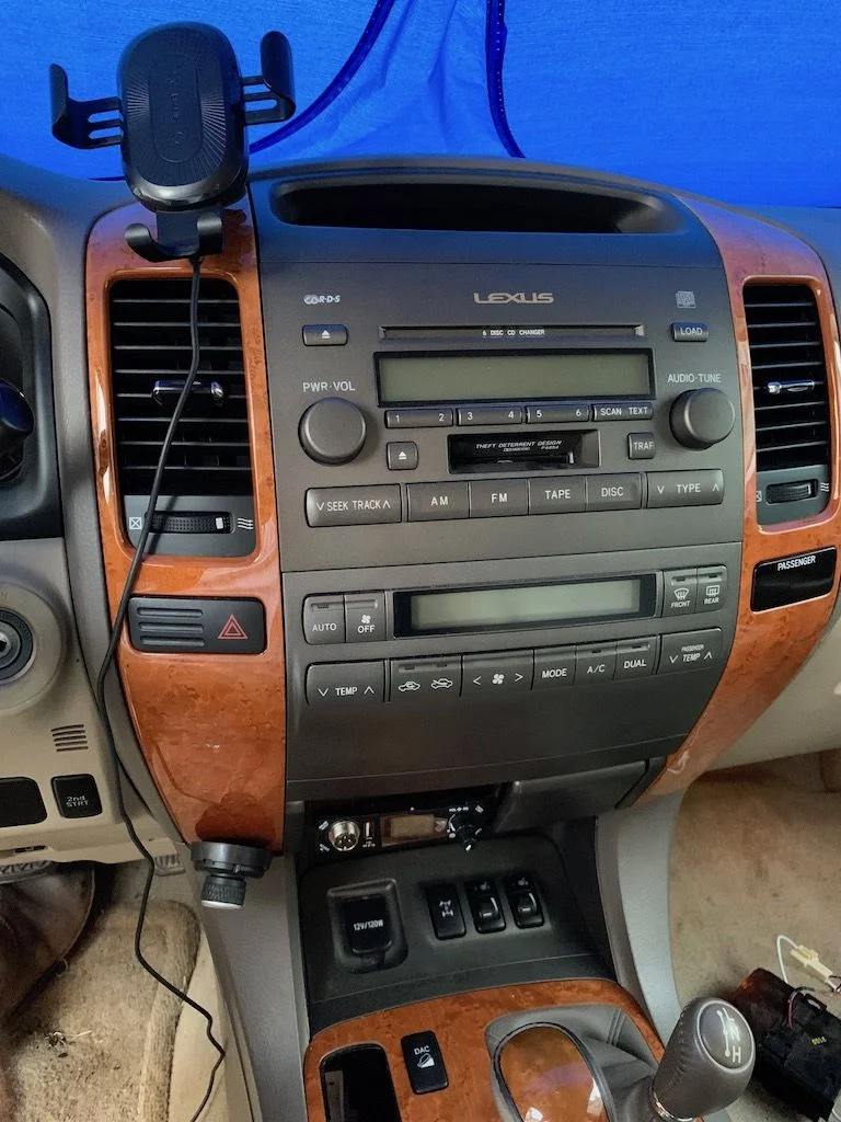

Installed the President Bill CB in lieu of my ashtray.
It is 4x4x1. It has 2 different mounts for different configurations. The mount that allows the CB to be removed was too wide to fit in the space left from the ashtray by about 4mm. It is simiar to that of a hot swappable server hard drive. I used some scrap aluminum to fill the space above the radio (I can't paint to save the world :( )
Nice! Did this a while back with a LUX lighting sale. Got amber lights.

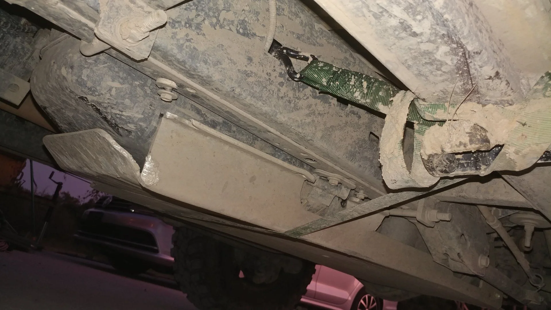

We tried to relocate the fuel tank over the weekend.
PSA: if you live in the southeast and plan to wheel your rig, go with steel skids. Aluminum is awesome, but I'm just not sold on long term durability under moderate use on the offerings in the SE.
I went with cheap $8 lights from eBay to see if I like the blue or not. Still haven’t hooked them up for any period of time.
Mine are just hooked to the valet lights for now. Got into the tech stream and set them for the max time. For the most part they are just for around camp.
