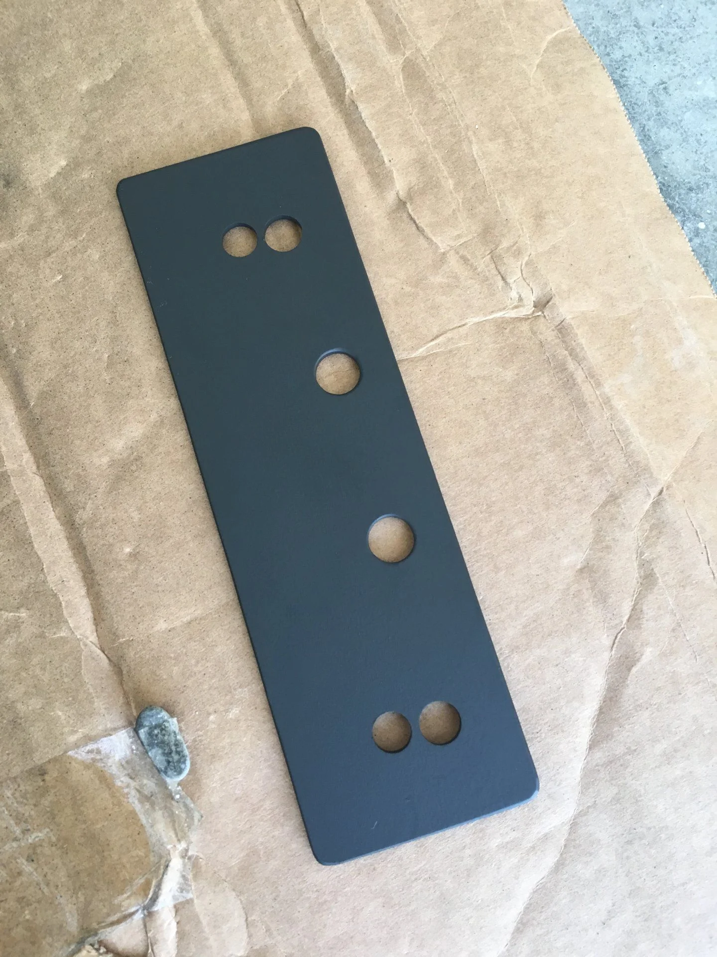

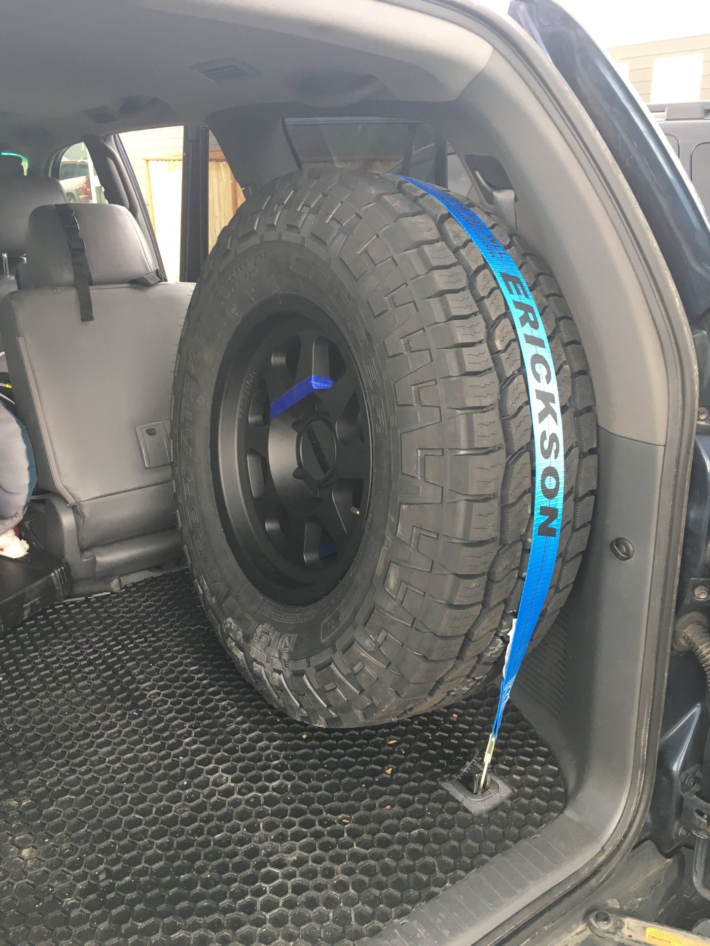

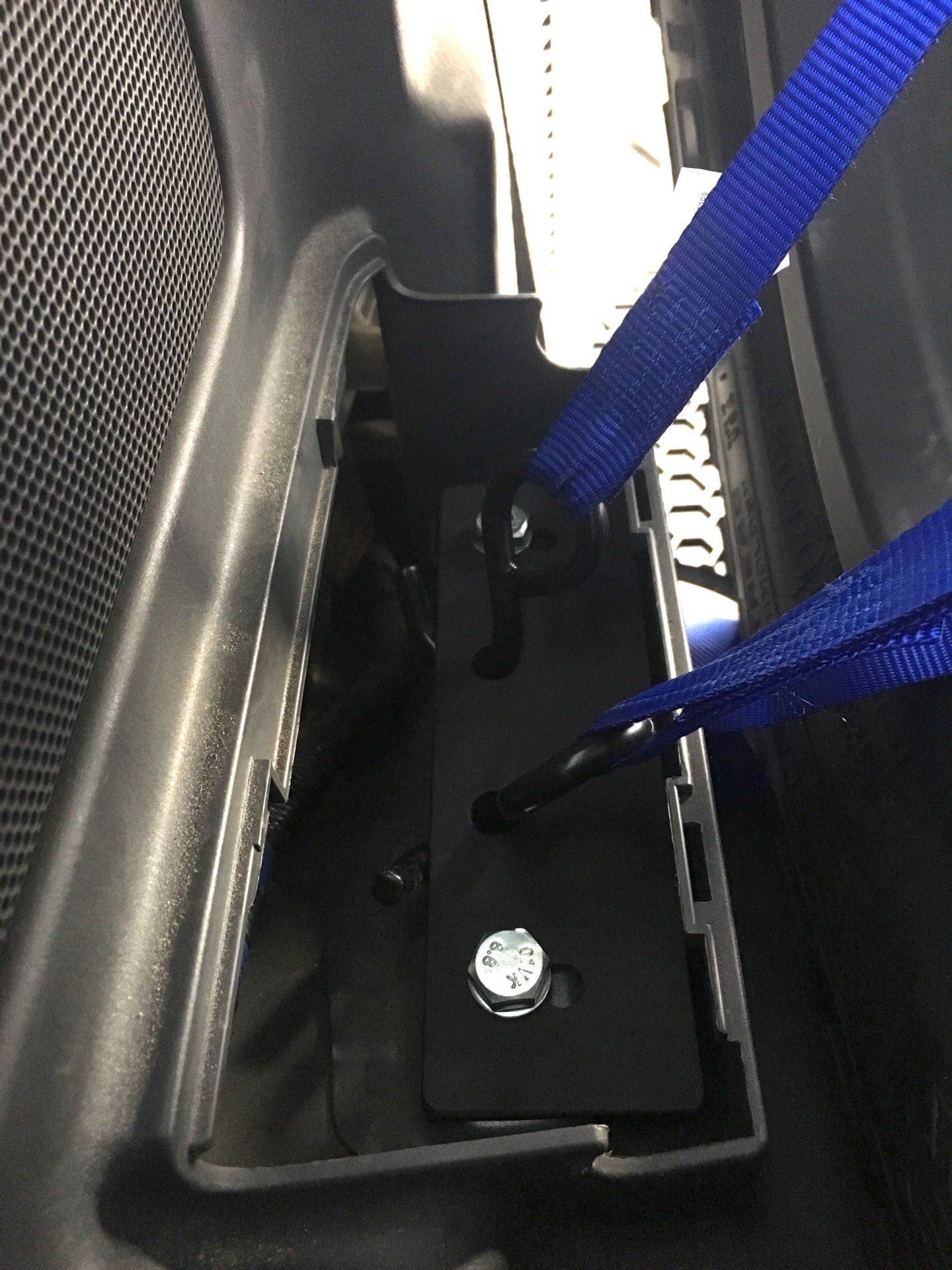

Jerry rigged a spare tire tie down system. Wife said there is no reason why the spare should be inside the cab. Guess I am getting a rear bumper come tax return time!

I like it! Did you have to fabricate the plate for the side tie down (the one that's in the rear seat mount)?
Yeah. Had some 2 1/2” wide 1/8” steel laying around so I drilled some 1/2” holes in it. Started with the mounting holes in the center but I liked it better offset, makes it easier to attach the straps.

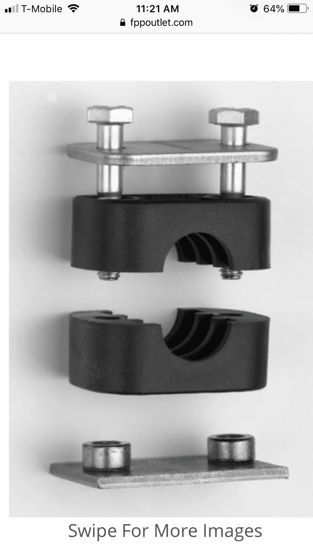

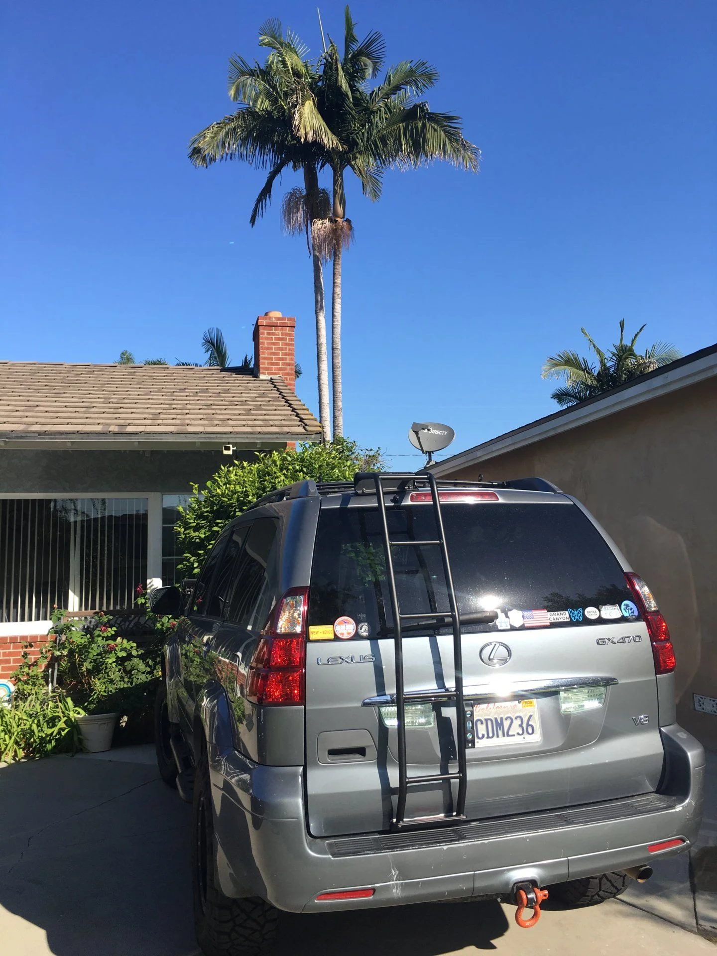

Researching tube pipe metal clamps with rubber bushing to attach a plate to my Gobi ladder...for hanging specter gas can.

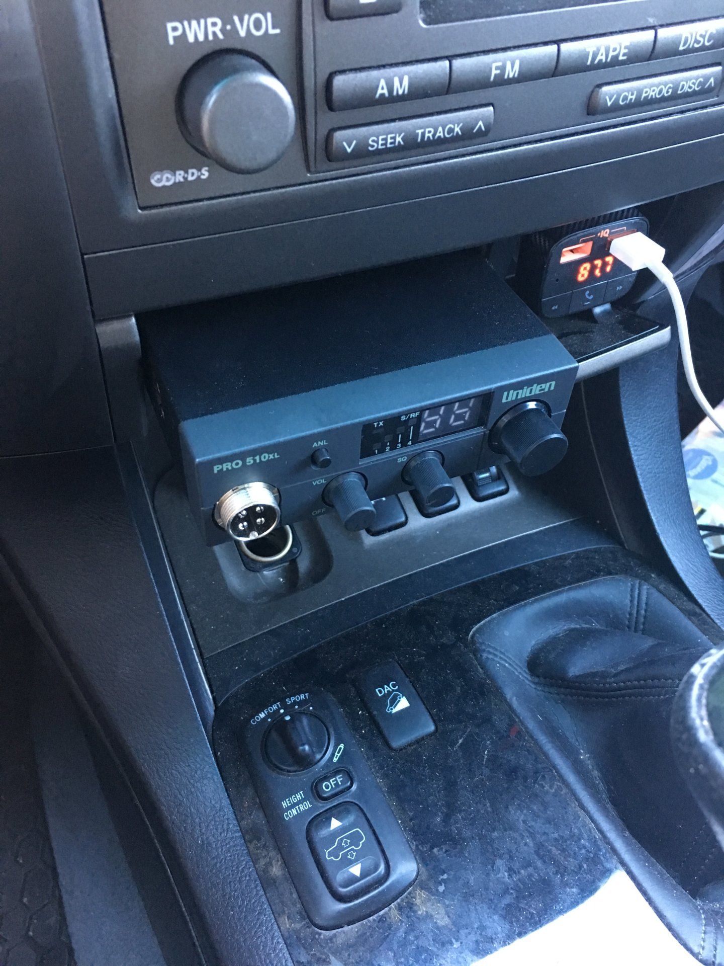

Installed a CB radio. It’s sticking farther out than I would like but it’s not terrible.

Word on the street (from the 80 and 100 crowd) is modify the back (pigtail the wire or add a 90° and a hole) to flush-mount it further back. 👍
