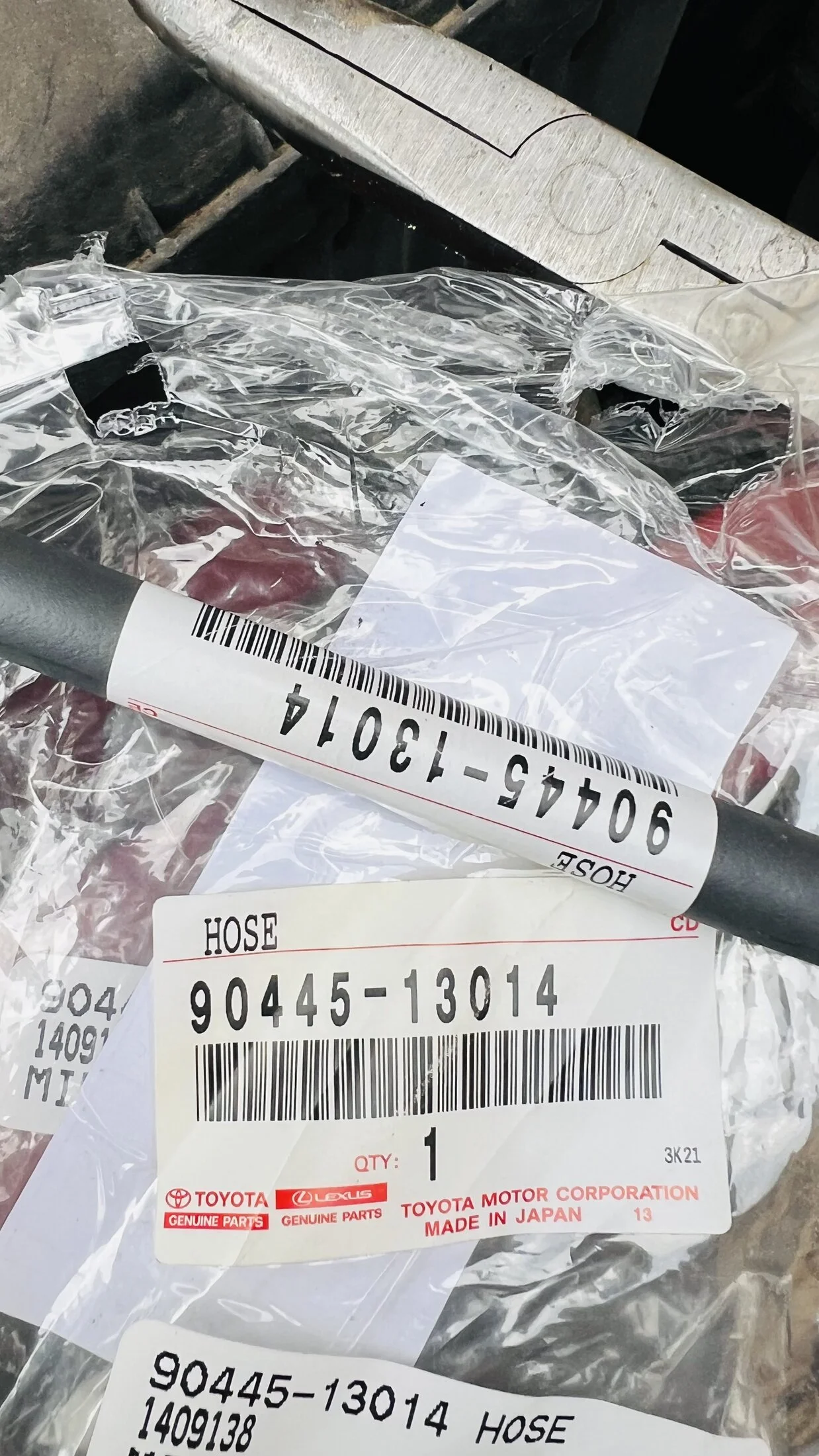

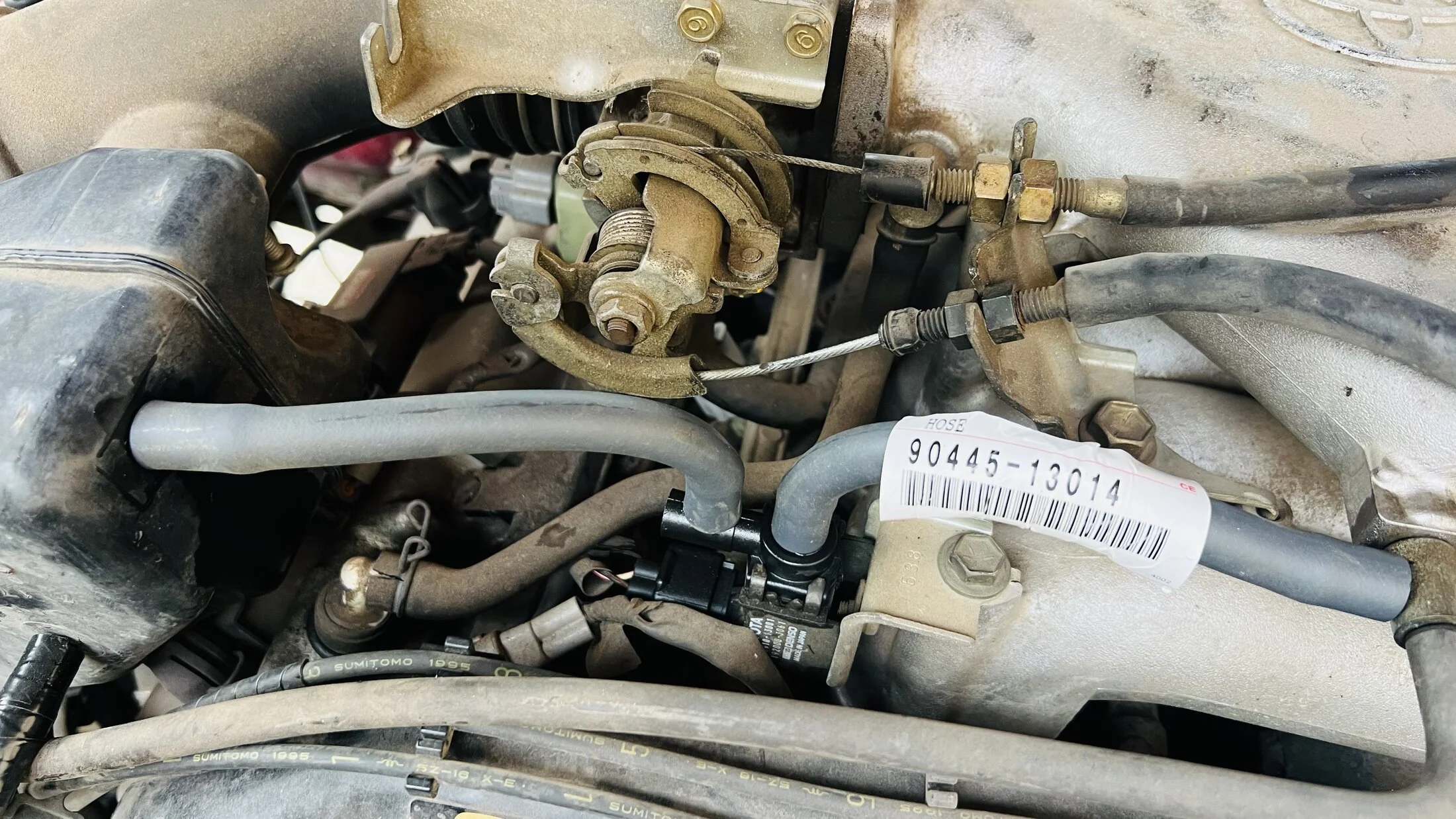

Don’t forget the small things….

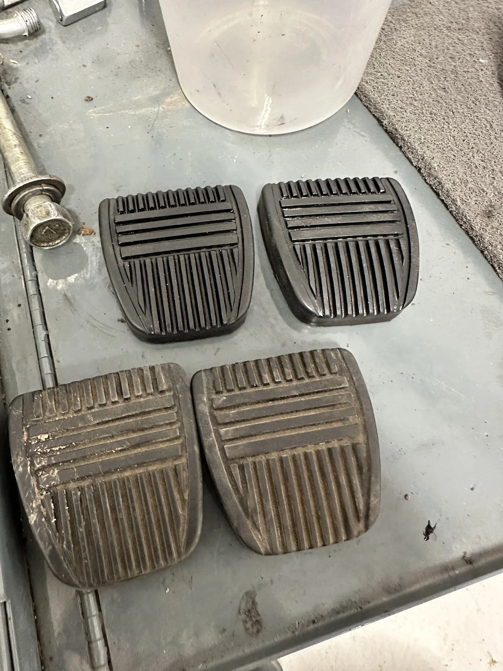

New pedal pads:

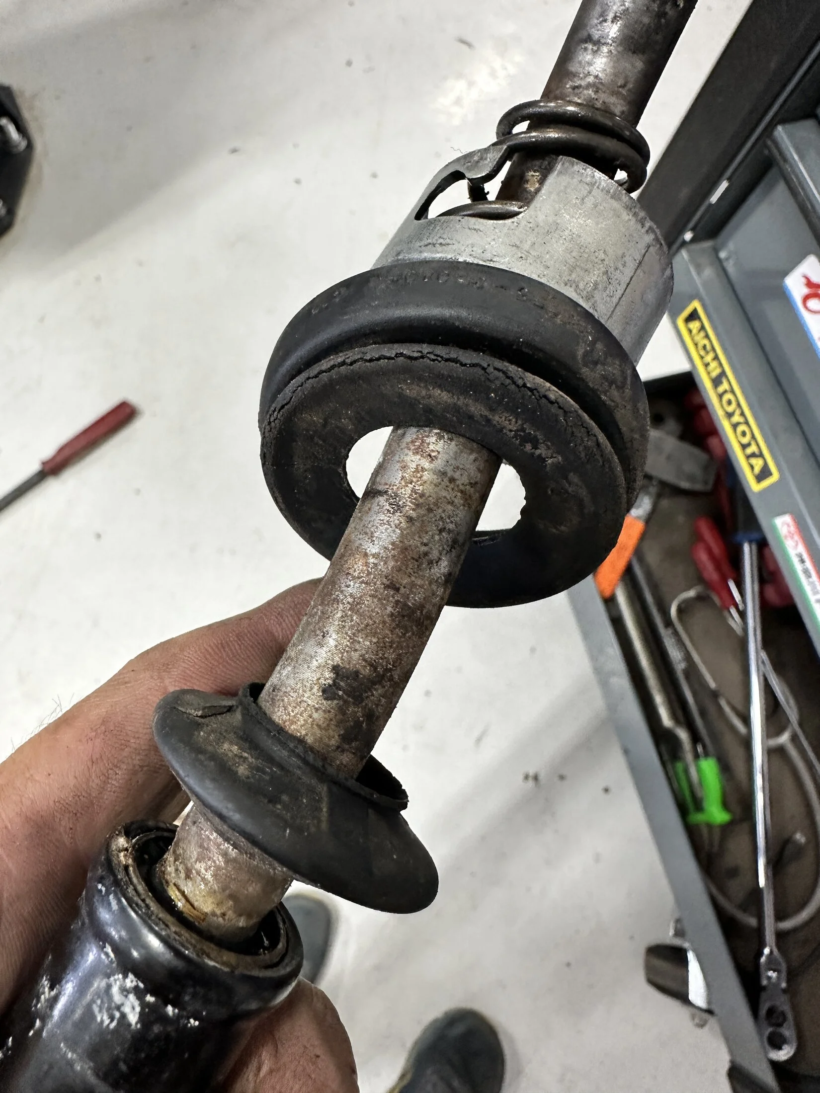

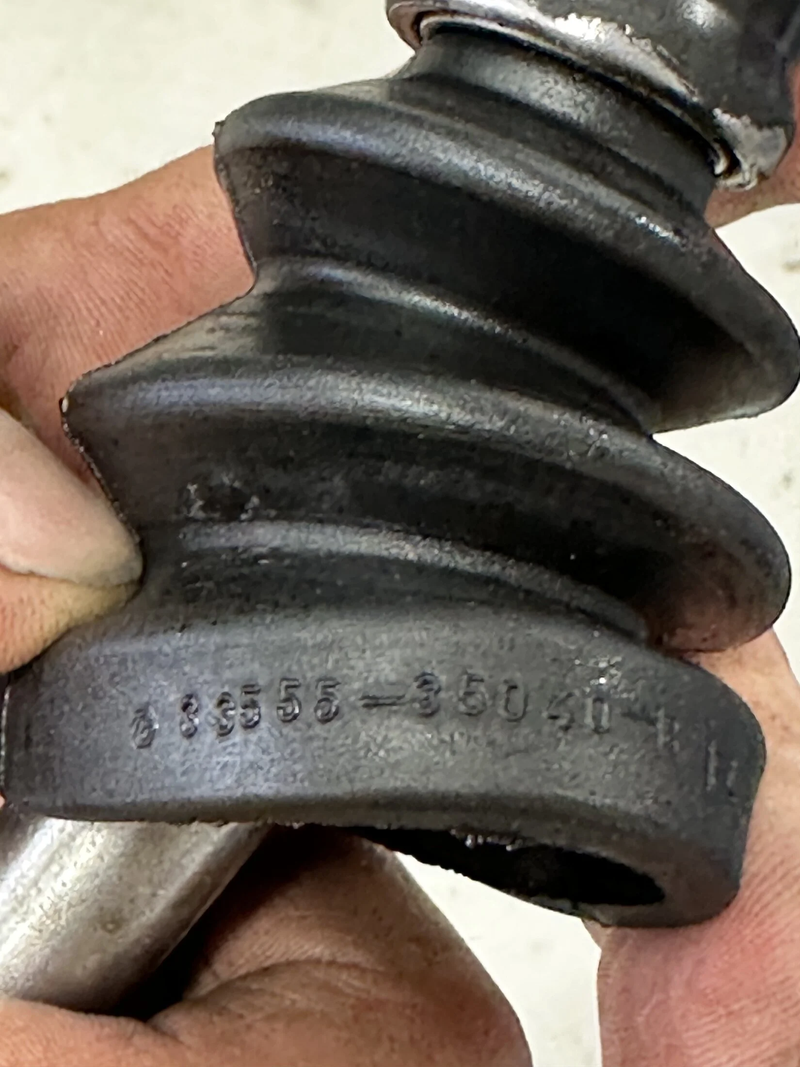

Transmission lever boot was torn:
Replacement:

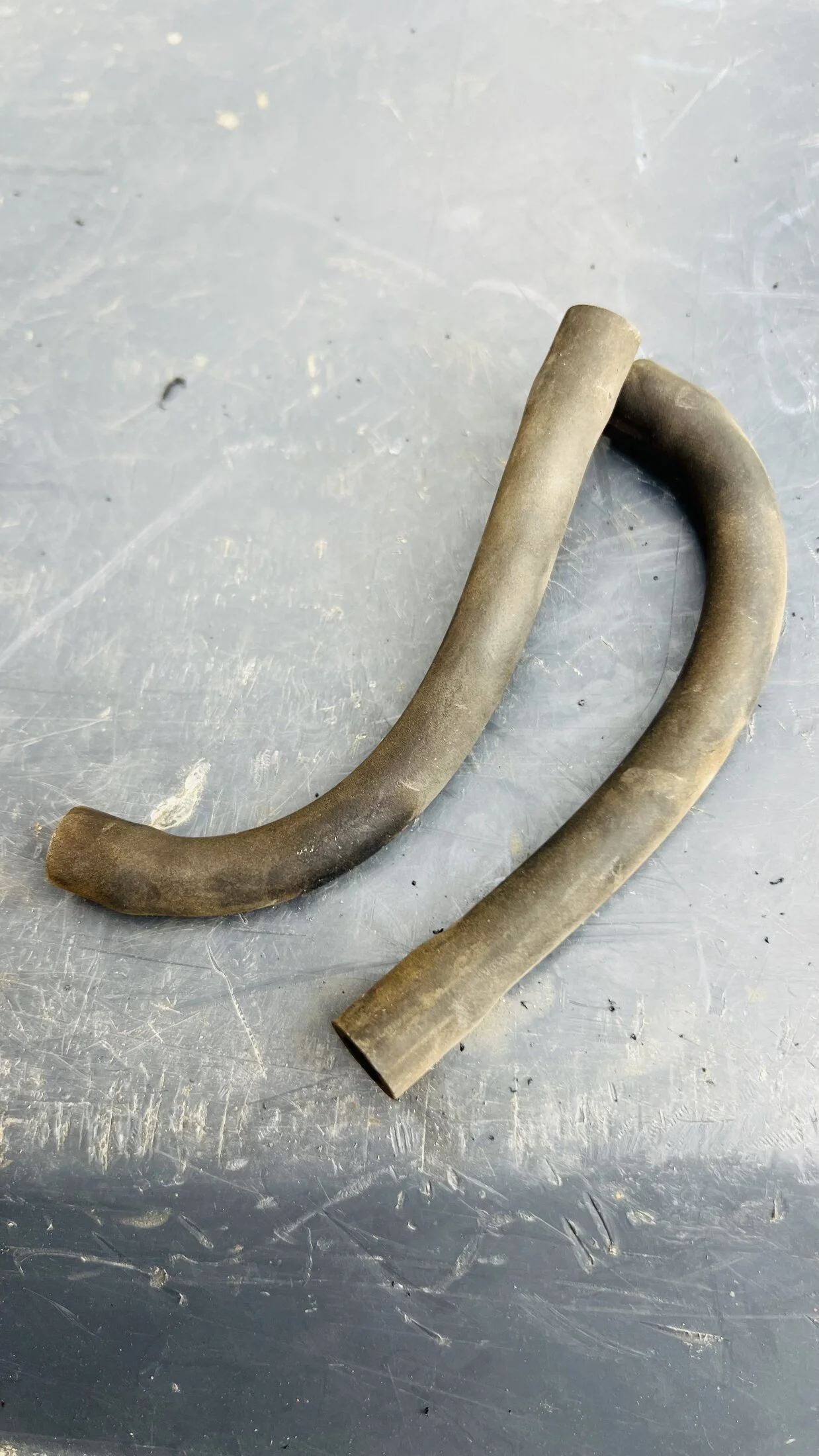

Finished up the mild cooling overhaul in the t100 earlier. Ended up putting a new tstat and large coolant hoses on while I was doing the other work along with the rad, fan clutch and water pump I did a few days ago.
Overall the whole cooling system is still looking great. No buildup in the passages and no sludge/milk/ cloudy liquids came out when I drained the original rad.
I am still impressed with the fit and appearance of the koyorad. It came with mounting brackets which is something I have read some other rads don’t have and the factory brackets must be moved over. I kept my old brackets if someone ever needs them.
This maintenance parts list:
KOYORAD C1512 radiator- no cap included
Aisin FNT005 fan blade
Aisin FCT013 fan clutch - modified by me
16571-62050 Upper Hose
16572-62050 Lower hose
90916-03075 tstat
16325-62010 tstat gasket
90467-37003 2x clamp
90467-37005 2x clamp
16401-63010 Rad cap

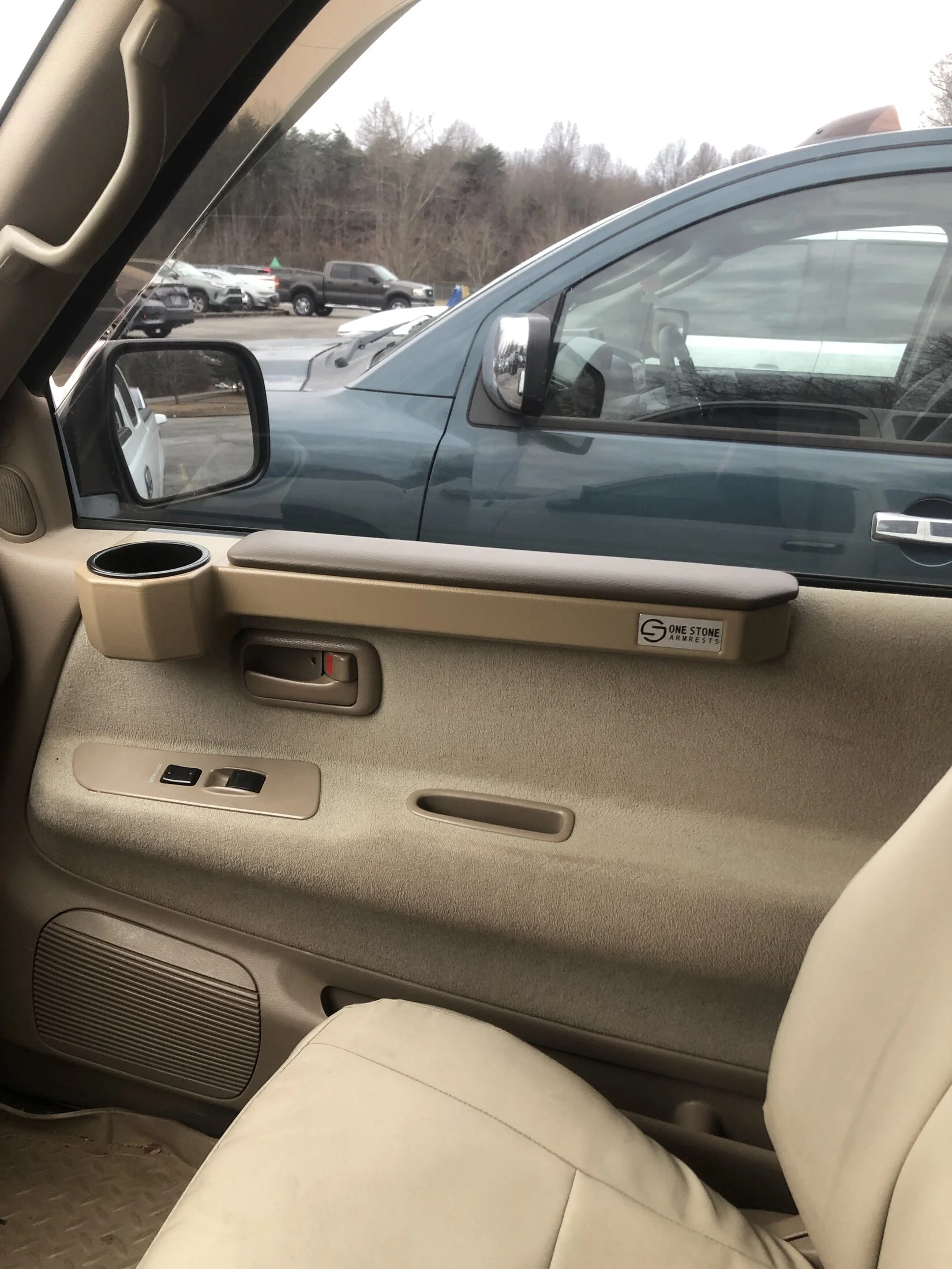

I have Onestone armrests in my 80 and like them so I decided the T100 needs them as well. These are for a 70 series and needed some modification to fit. These are the browns painted rustoleum dark taupe.
